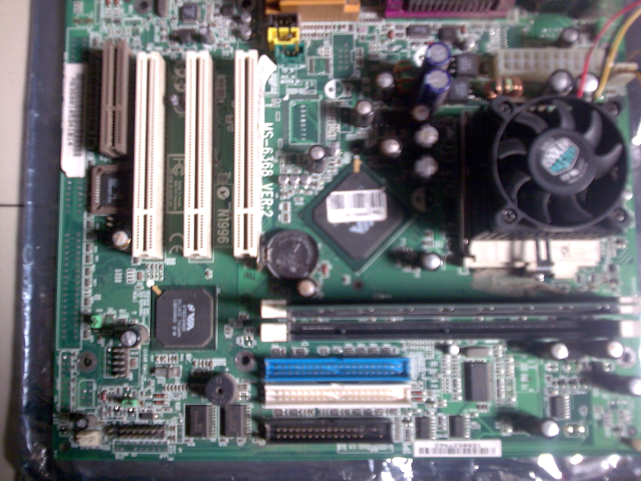

    After an abnormal power shutdown of my Pentium 3 computer(stuck with it as i had to postpone my new build), the system hangs after PCI device listing. No messages like updating ESCD or verifying DMI etc. are displayed. POST is normal and i'm able to get into BIOS. Tried all the boot sequence with floppy, cdrom, hdd. It is not even reaching the point where it looks for any media to load the OS. All the 1000uF, 6.3V, G-Luxon caps are slightly bloated. I will post the picture of the mainboard soon. RAM and CPU was tested in another system and found OK. Can it be the BIOS got corrupted or due to bad caps?
    Re: MSI MS-6368 mainboard freezes before loading OS

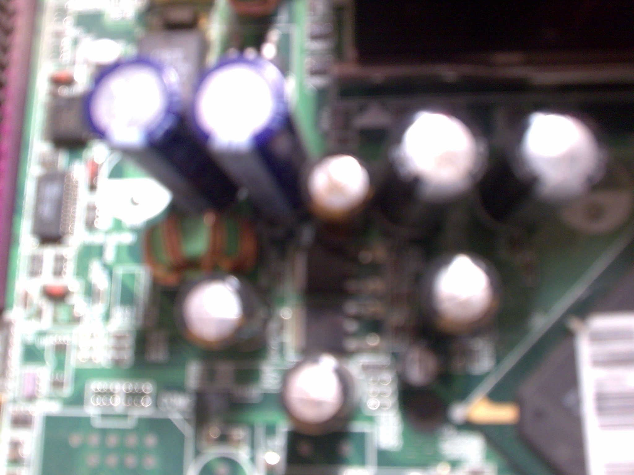

    start by replaceing all the caps.
    this is a very old board now and g-luxon are not fine wine that gets better with time.

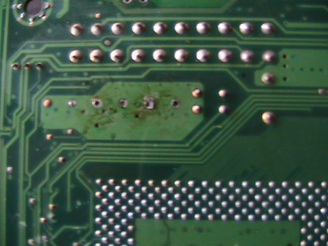

      I have attached some snaps of my mainboard and capacitors taken from mobile phone camera(slightly out of focused). At the soldering side of the mainboard, the traces are running very close to some capacitor mount holes. If i mistakenly place the hot iron on these traces will it be permanently damaged. I'm not much experienced in soldering stuff, but i can practice with a pci modem card. Should i go for a conical tip or chisel tip iron? I'm planning to buy a standard 40W iron like goot and hope that it will suffice. A slight brownish tinge was seen on some 1000uf caps, but i could not differentiate whether it is rust or electrolyte? When i scrapped, it came off easily and could not find any leaky holes. i will post some more clear photos.

        I prefer a small chisel tip to a cone. You can use the side of a chisel for tighter spots.
        Clearer pics would definitely help.

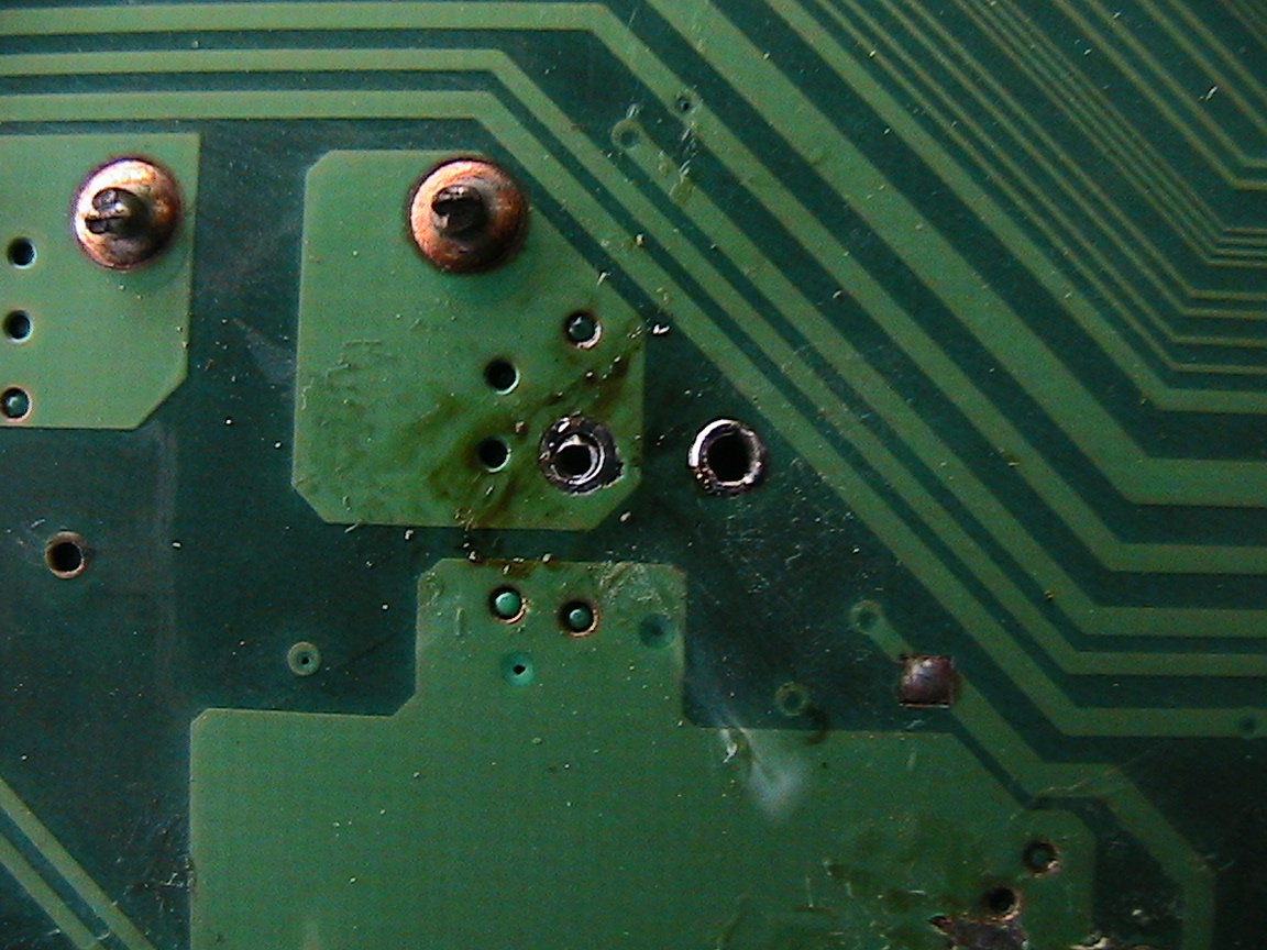

                                Heating on solder side and inserting a needle from the opposite side cleared one of the holes. one down, two more to go. Due to other works, i could not devote much time and finish it in one stretch. To me, it has now become more like finishing the mess i have started in the first place by going straight into it without much practice. Still i continue and thanks to all of you guys for guiding me when i got stuck up. This served as a good experience and even if i scrap the board, i should say i won't feel dissatisfied.

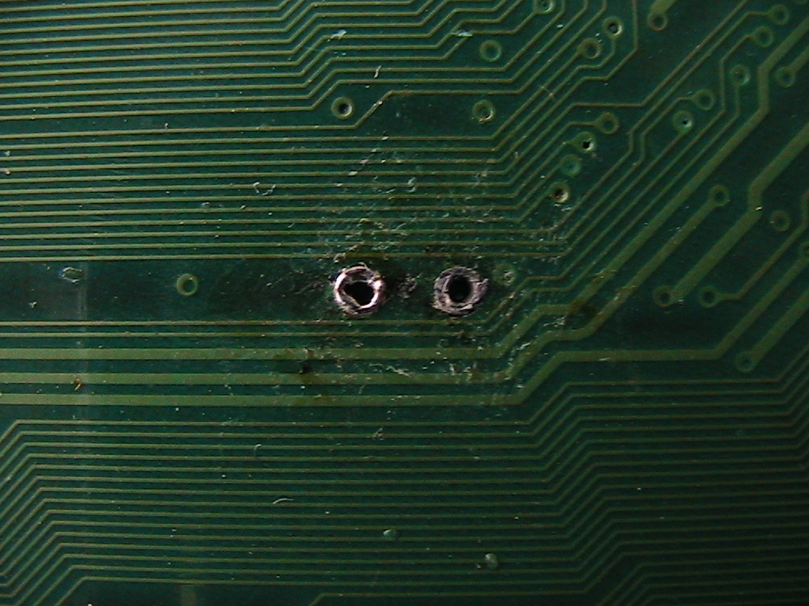

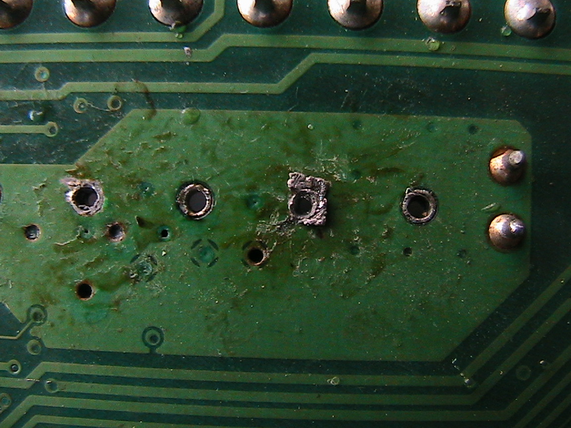

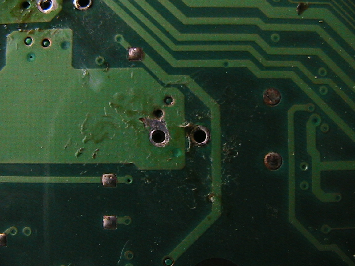

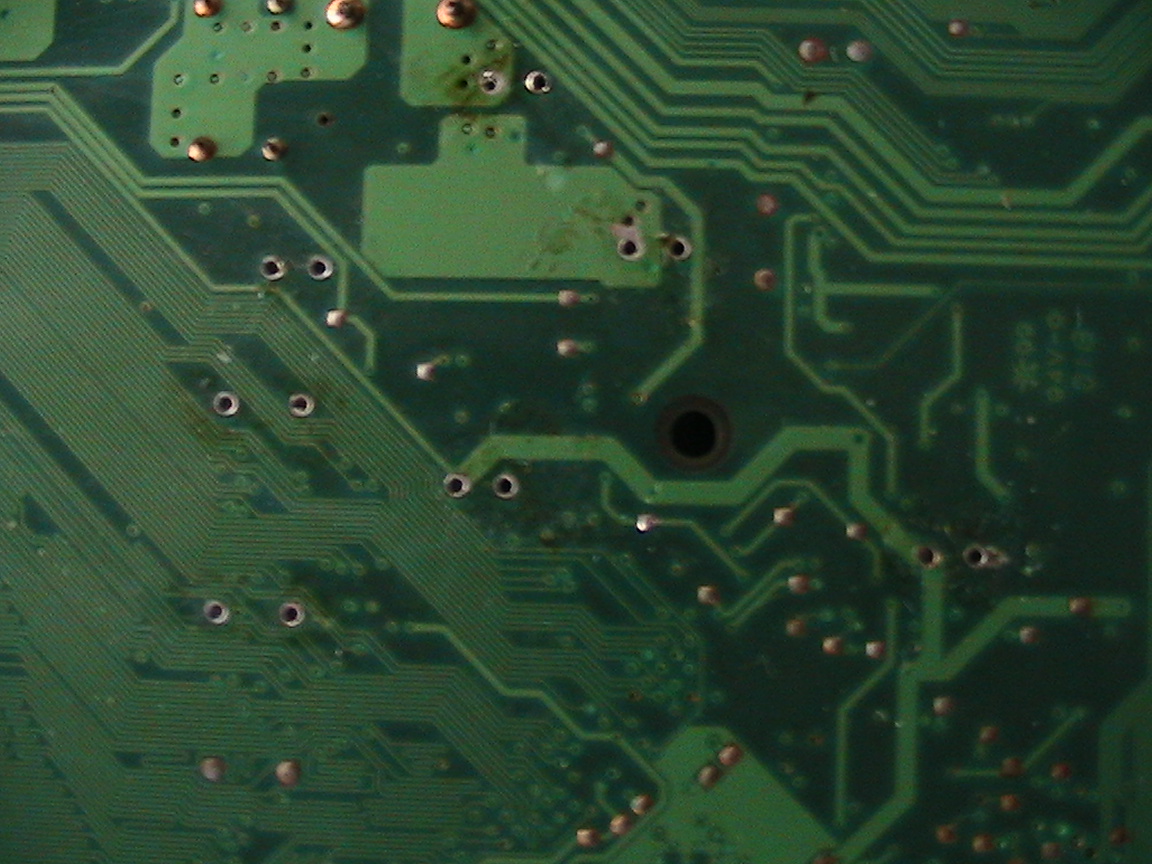

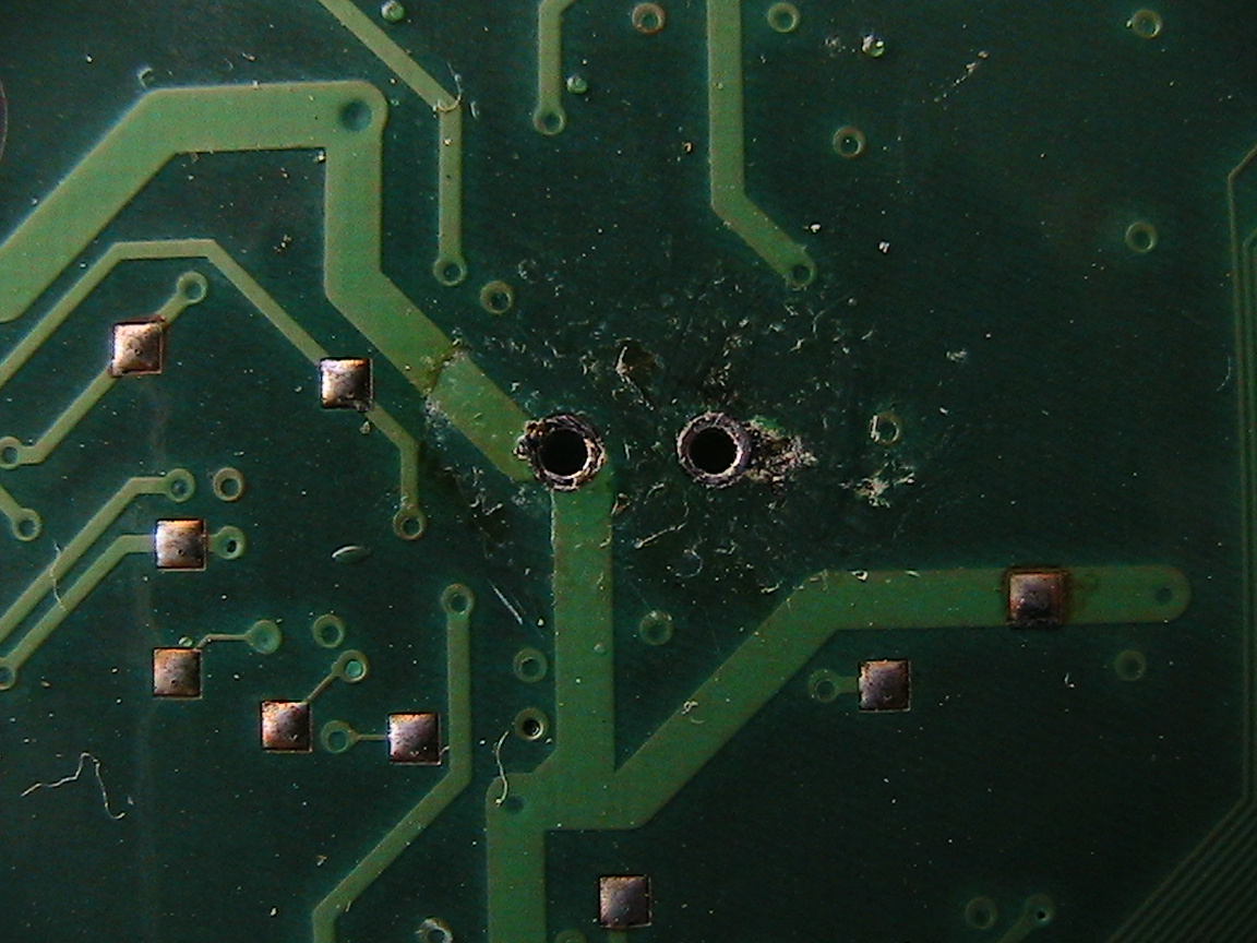

                                  The remaining two holes could be cleared by the needle method. But the motherboard is almost confirmed to be scrap now. I have attached some close-up snaps of the cleared holes.
                                    The board looks rough but I don't think it's anywhere near scrap.
                                    Your joints need more heat. Try pre-heating the motherboard a little before soldering on it.
                                      It worked !!! It went past the PCI device listing and displayed messages 'updating ESCD' 'verifying DMI' and finally 'disk boot failure' as i had connected only cpu and ram. I was actually shocked more than surprised that the mainboard worked right away after the abuse i had dished out to it. My heartfelt thanks to the forum members especially to momaka. Actually i have another similar mainboard with SiS630 chipset (very poor performance) which i'm using right now. That is the reason i took the trouble to recap this MSI mainboard to gain some performance though i know it won't be much. Will continue with further testing of this board as this is only the first step and hope it holds well together till my new build, say, for a year or so.

                                        On hindsight, a chisel tip iron would have saved me a lot of trouble probably. I don't have any specialized tool to preheat the mainboard. I didn't intend to spend much on a soldering station or other tools as i was not very sure that the issue might be in the caps. Now that the job is completed, it feels like a simple job. But definitely not at that time.
                                        Just to understand,
                                        1) Can anybody tell me what the colour(dark and light green) of protective lacquer on the mainboard signifies?
                                        2) In the attached pic, the left pad looks different from the right one. Protective coating is gone and i thought the solder pad also got completely lifted and in another 1 or 2 holes too. That's what i feared most, that the connection between the layers might be broken due to excess heat. Am i not guessing it right? If i'm right, then how it worked???
