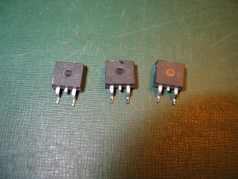

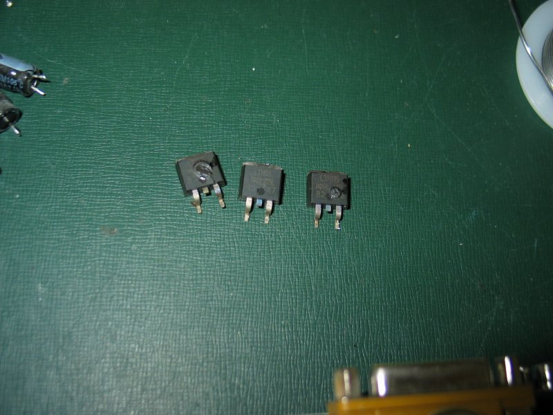

    Thoroughly fried MOSFETs
    MOSFETs are removed
    Diodes' legs disconnected for testing
    They tested all OK so they're soldered back
    Holes cleaned, new solder added to the pads
    Here is one step missing - testing and replacement of the small SMD transistors that drive the MOSFETs
    New MOSFETs
    The MOSFETs came from this dead Chaintech board

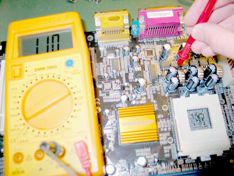

    Measuring voltage without CPU
    Measuring voltage with CPU
    And finally it's alive

                i am somhow suppriesed, as the K7s5a i recaped lately has measured the exact same 1,69v instead the exact 1,65 the duron should get. Strange, may be this board is desinged for badcaps, not for god rubys Mcz.

                  I measured that at diode's tab - before the inductors. And there is a voltage drop across them. This Duron should have 1.6V (at least I think). The hardware monitor in BIOS displayed 1.619V. Most of boards I've fixed with this type of VRM display exactly 1.600V.
