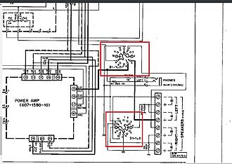

                  Let me ask you this: Please look at the schematic on my post before yours. To me according to the schematic it looks like there is a jumper from A- left to B+ left and one from B+ right to A- right. Right now I have a jumper from A- right to B+ right and A- left to B- left. These jumpers are suppose to facilitate the A+B trigger on the switch so I have both A and B speakers working at the same time. Can you tell me if the jumper positioning is currently correct? I just have nothing coming out the A side. Thank you.

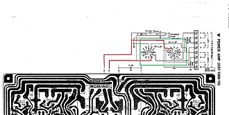

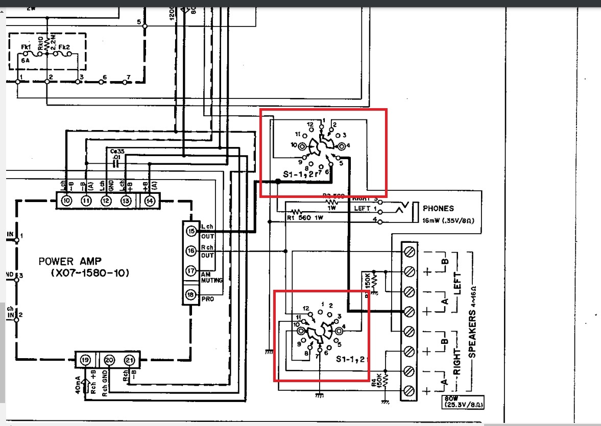

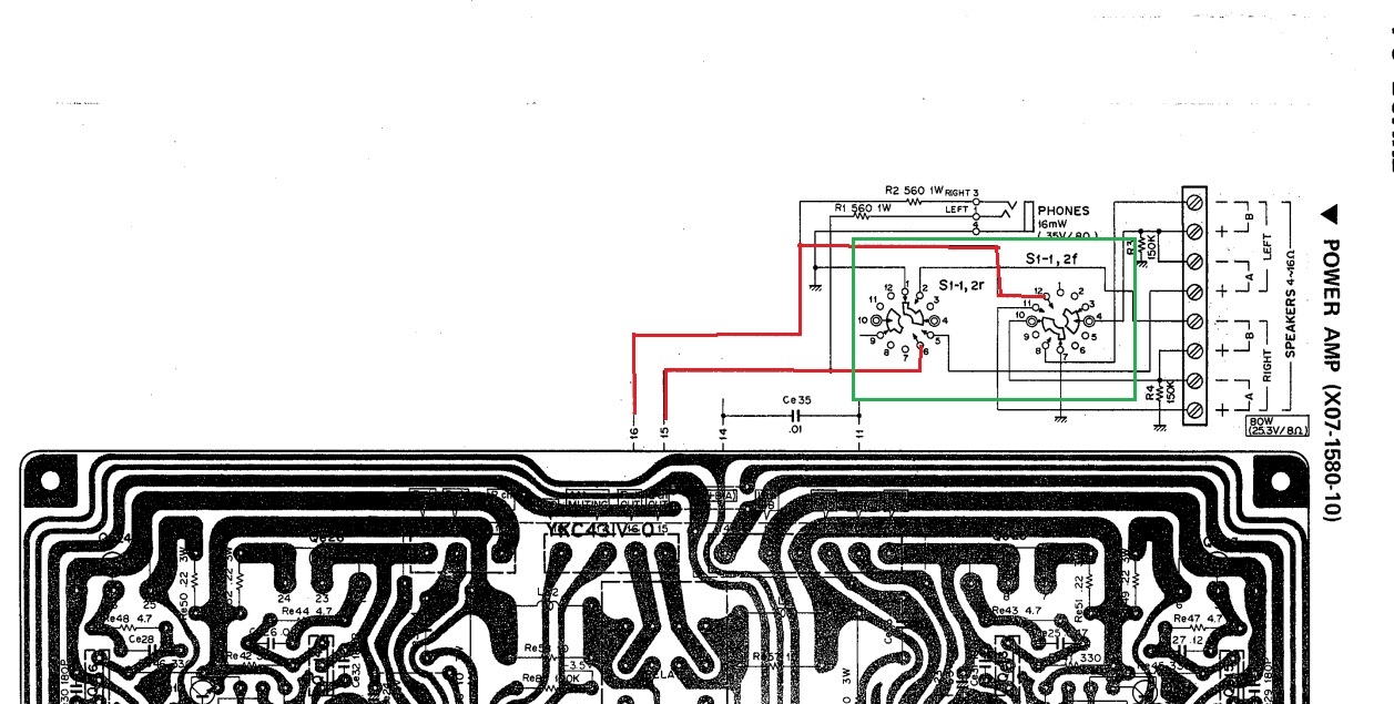

                      Forget about the power board.
                      The speaker selection happens in lever switch S1 (part number ss33-2034-05). There are at least 2 plates/wafers inside that do the magic. The power switch is also in the same sw itch (I do not understand why tf someone would put mains right next to the speaker outputs, but I guess the japanese engineers know better).
                      The switch physically must be right behind the power/speaker selector knob.
                      The board from the attached photo is the power amp board - service manual page 15. The speaker signal then goes to the lever switch. I could not find any good photos of the amp insides, but I guess the board and the switch are connected just by wires. If no one else has been inside the amp, then leave everything as is and focus on the switch. Otherwise you will have a bowl of spaghetti to trace and deal with.

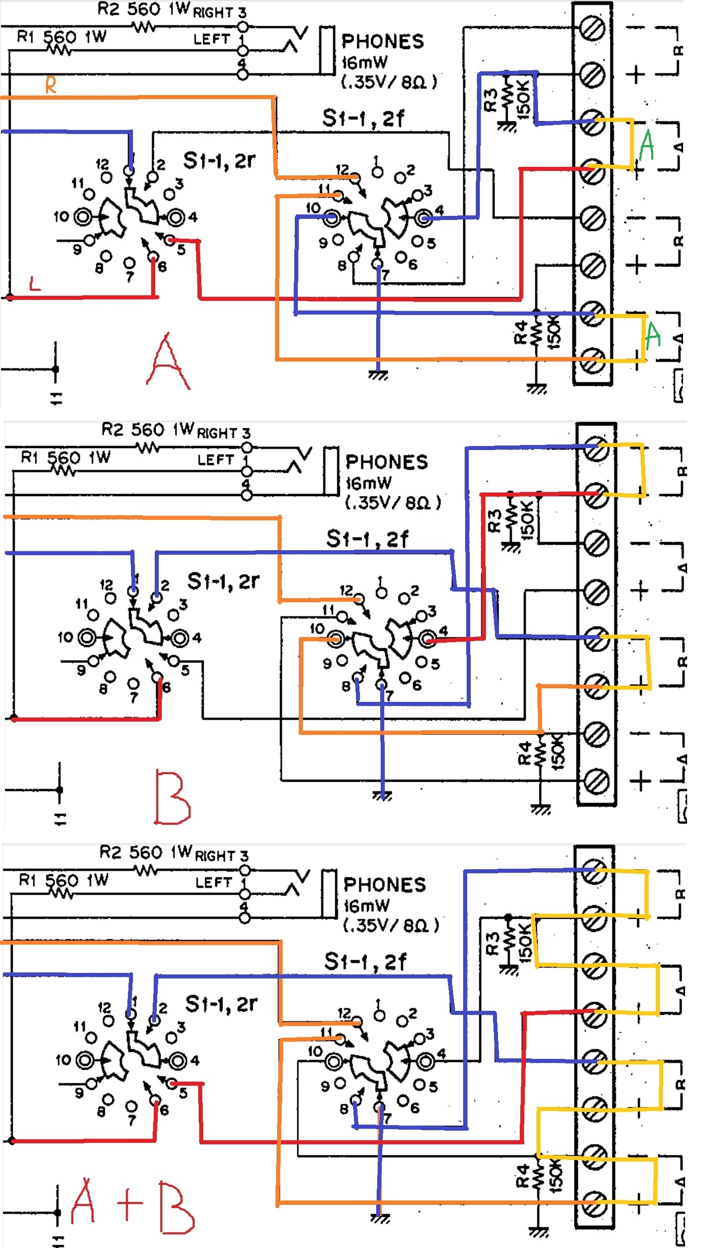

                          You can check the continuity in the different positions - in position SP A the + terminals for SP A should have continuity to the signal wires and the - to ground. Then on position SP B same but for SP B terminals. In position A+B the signal should go to terminal + on SP A and ground to terminal - on SP B. Terminals SP A - and SP B + should not be connected to anything apart from each other. Basically in position A+B the two sets of speakers are connected in series.

                          From the schematics, it looks like pins 10 and 4 are shorted between the two plates.

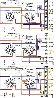

                              WOW! Okay my friend. I think something si wrong. I put the switch in the A position I get per switch pin starting a #1 ground (black wire) =A- right and B+ left and right. On switch pin 2 (gray wire) I get B- Right. Pin 3 is empty. On switch pin 4 (orange) A- right and B+ left. On switch pin 5 (yellow) I get A+ left. Pin 6 and 7 go to lights and power board. On switch switch pin 8 (purple) I get A- and B- Left. pin 9 goes to power board. On switch pin 10 (Green) I get A- right and B+ right and left. On switch pin 11 (blue) I get A+ right. Pin 12 goes to lights and power board. When I say (I get) means I get continuity from the pins to those specific speaker wires. I'll stop here because it doesn't look like the picture you posted. Would you like me to continue with speaker B and A+B settings?
                              • DrDos
                                • Aug 2025
                                • 93
                                • U.S.
                                Alright, lets check the B side: On switch pin 1 (black) I get A- Left and B-Left. On switch pin 2 (gray) I get A- Left and B- Left & Right. On switch pin 4 (orange) I get B+ Left. On switch pin 5 (yellow) I get A+ Left. On switch pin 8 (purple) I get A- Left and B- Left and Right. On switch pin 10 (green) A- Right and B+ Right. On switch pin 11 (blue) I get A+ Right. That's where the continuity goes from the switch. I hope it makes sense to you, because I'm kinda lost.
                                Now lets check the A + B side: On switch pin 1 (black) I get A- Left and B- Left and B-Right. On switch pin 2 (gray) I get A- Left and B- Left and B-Right. On switch pin 4 (orange) I get B+ Left. On switch pin 5 (yellow) I get A+ Left. On switch pin 8 (Purple) I get A- Left and B- Left and B- Right. On switch pin 10 (green) I get A- Right and B+ Right. On switch pin 11 (blue) I get A+ right. That's it except for phones and I have those too if you like. Please help me to understand this debacle. Thanks.

                                  let me ask you this, as I see it according to the schematic A- left is jumped to B+ left? and A- right is jumped to B+ right? I believe that is to make the A+B work but maybe I am wrong. It looks like there is a jumper to those wires on the schematic.
                                  • madan1
                                    • Nov 2016
                                    • 726
                                    • Bulgaria
                                    see the image I attached above, it explains the connection between A and B.
                                    If the schematics do not correspond to what you have, there are the following options:
                                    -the schematics are wrong
                                    -someone has already made modifications/repairs to the unit
                                    It is an old unit, with old and brittle PCBs and parts, if it works - just leave it as is. If you want to get it fully working then you will have to deal with the spaghetti - desolder the switch, check if it switches the correct pins in the different modes and then solder it back according to the schematics.
                                    If you just want to play around with electronics - this unit is a wrong choice. As I mentioned above - it is old, the parts are brittle and you can not buy replacements if something brakes.
