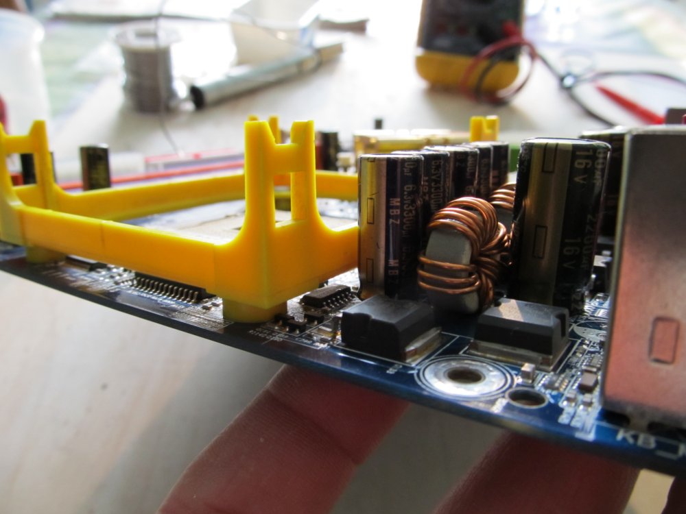

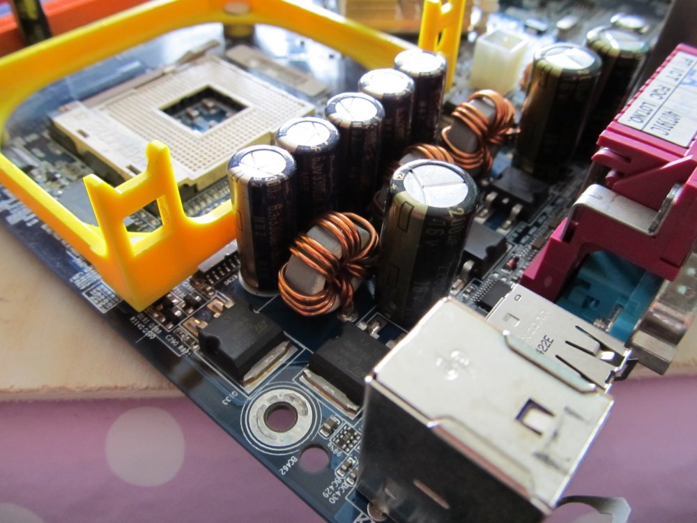

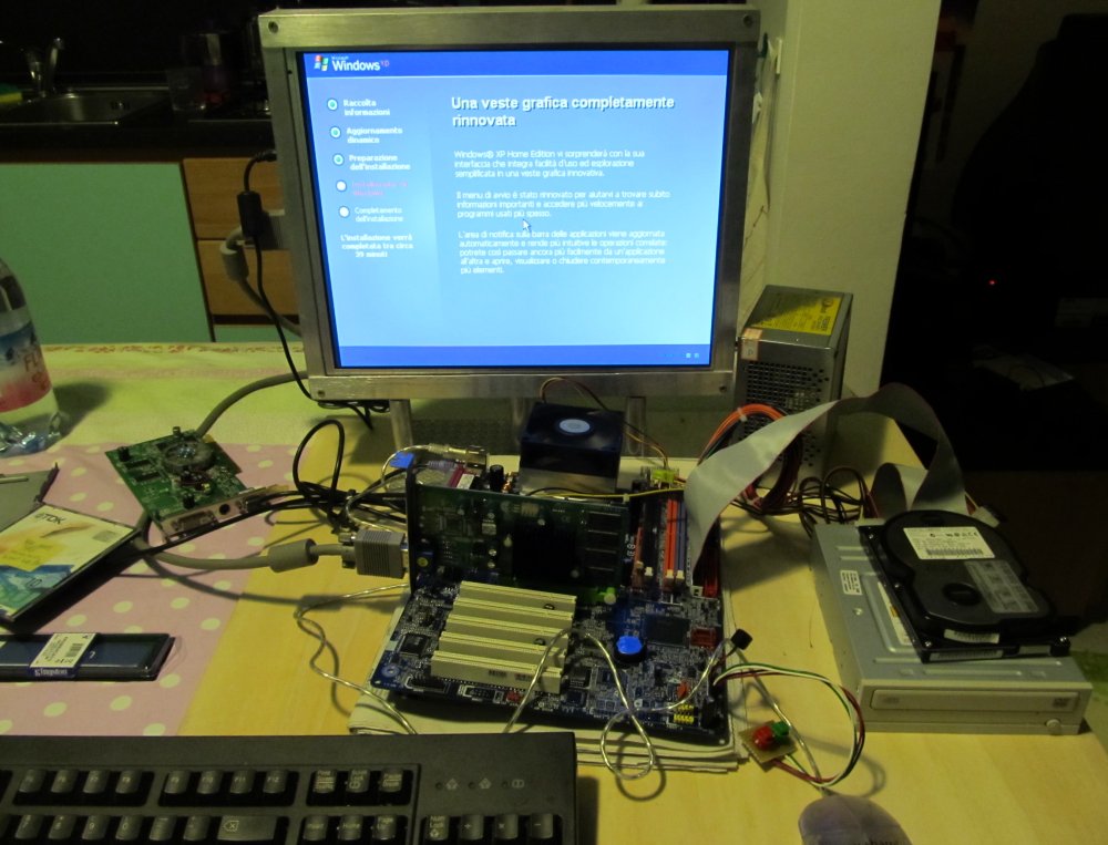

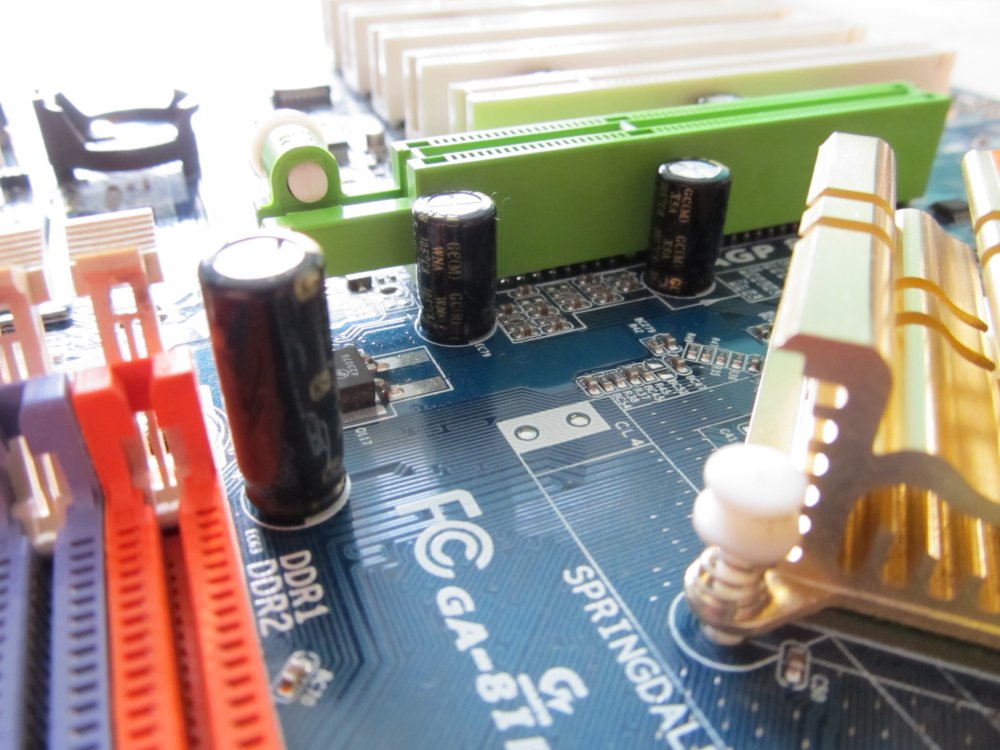

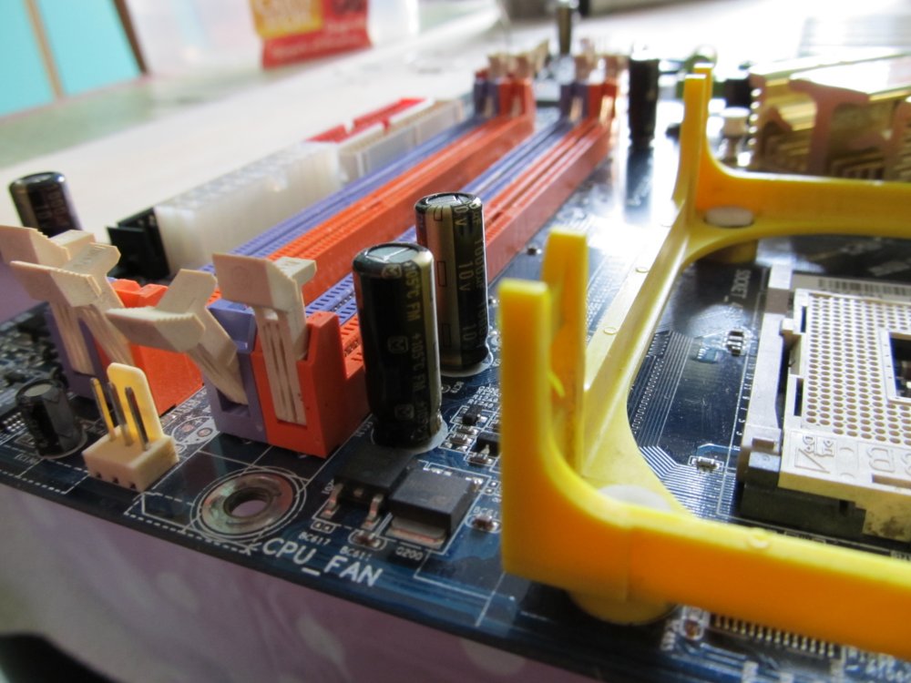

                                      mockingbird at the and I followed your suggestion and I bought MBZ. I have checked them in my lab and everything is ok.
                                      This afternoon I had time to solder them: I have used 3300uF 6.3V MBZ on VRM, 2200uF 16V FM on input VRM, Samxon GC 1000uF 6.3V around PCI/AGP and 1000uF 10V FM in other position.
                                      I had not enough 1000uF of GC or FM to recap the board so I used both type, hope this will not be a problem.
                                      Anyway I manage to install XP successfully but I don't want to celebrate the victory till I have fully tested the MOBO.
                                      Due to lack of time I had only time to finish to install XP, I still have to install some missing driver.
                                      Here few pics of "work in progress"
