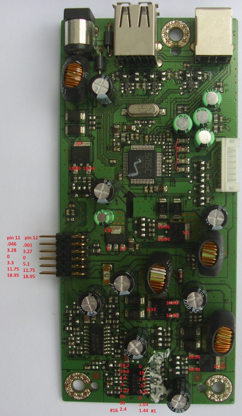

      There is a center pin it's the tab.
      This picture may be easier to read the voltages.

            Hey Plainbill,
            I tested all 8 diodes and here are my readings. With my DMM set to diode, I placed the black lead to the cathode side and the red lead to the anode, on all the diodes I'm showing 137 on my DMM. When I reverse the leads I get numbers climbing up in the hundreds then changes to a single 1, in other words 200s,400s,900s,1600s,1900, then 1.
            They all do this with the exception of 2 of them, Fd7 & Fd8. With the leads reversed, the the numbers climb and stop at 1054 every time.
            Don't know if I'm reading them correctly because they are on the board, perhaps I'm reading through the board and not getting a good reading but so far that the only difference I've been able to find.

              The behavior of the first six is normal. I would say that the behavior of FD7 and FD8 indicates something is different on that supply and is a clue that there may be a problem.
              If you have a variable output power supply, I would CAREFULLY increase the voltage on the cathode end of the diodes while monitoring the current. If this is a 'hard' limit, there definitely is a problem. Alternatively, test the diodes out of circuit and also see if you get the same effect on the solder pads with the diodes removed.

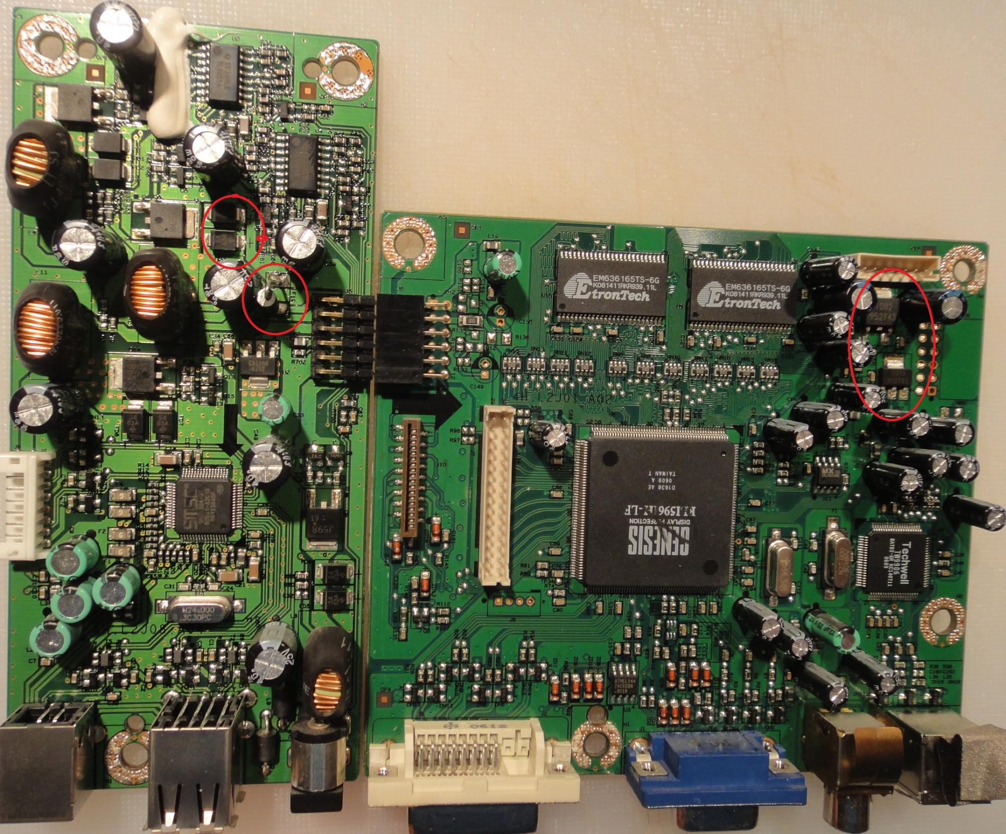

                          So this week, I became the proud owner of a Dell 2007WFP that has no signs of activity at all, and the power indicator light does not work either. I have spent some time during the past couple of evenings reviewing some of the troubleshooting above, and I believe I am heading in the right direction but request the benefit of the collective list experience to finish it. I have attached a photo of the logic and USB boards, and in summary:
                          Fuse F19 on the usb card (circled) was blown. I replaced it with another inline fuse, and optimist that I am, I put it all back together and hoped for the best. Well, it didn't work. I do however have 19v at the base of the fuse, but now that it is blown again, the voltage gets no farther.
                          Diodes FD3 and FD4 (circled) on the usb card are shorted and less than an ohm across them and in both directions. Can these be replaced with a regular 1000v diode that I have in my spares box? Or do I need special smd ones?
                          On U13 on the logic card (circled), the first and third pins have 82 ohms across them. Shorted?
                          On U5 on the logic card (circled), the first and second pins have 82 ohms across them. Shorted?
                          Can anyone recommend anything else to check? Or should I put those generic diodes and a new fuse on the usb card and give it another try?

                            19VDC feedind USB HUB board sound kind of high since USB uses 5VDC max. You may want to trace that voltage connections to see if it goes back the power supply board.
                            Those two diodes look like they are part of the switching power supply, so more likely to be Schottky Diode, you may want to check that MOSFET next to it to see if it is shorted out.
                            The two linear regulators, we need the numbers, more likely you are measuring the resistor network resistance for setting the output voltage.
                              Welcome to the club. I have the exact same monitor with the exact same 5 bad components.
