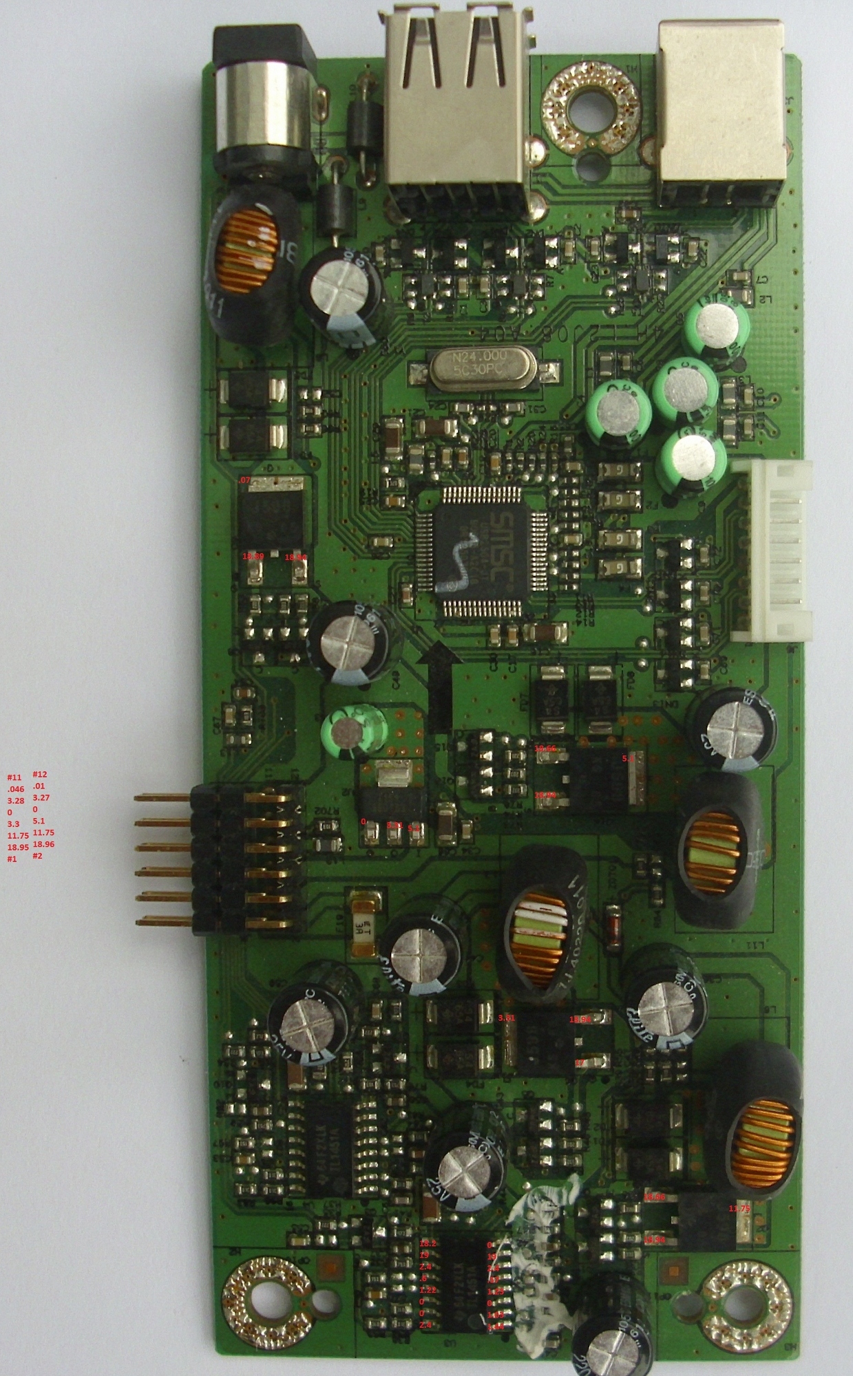

      Re: Dell 2007WFP Won't Power On
      I have a 2007 WFP that I am going to be working on today, the only problem it has is with one of the back lights. Initially when I was testing this on the bench I neglected to have the USB board attached, and of course the monitor would not work, so like pedro and PlainBill state it plays an important role in generating the other voltages.
      If you need to know what any of the good pin or component voltages on the USB board are let me know.

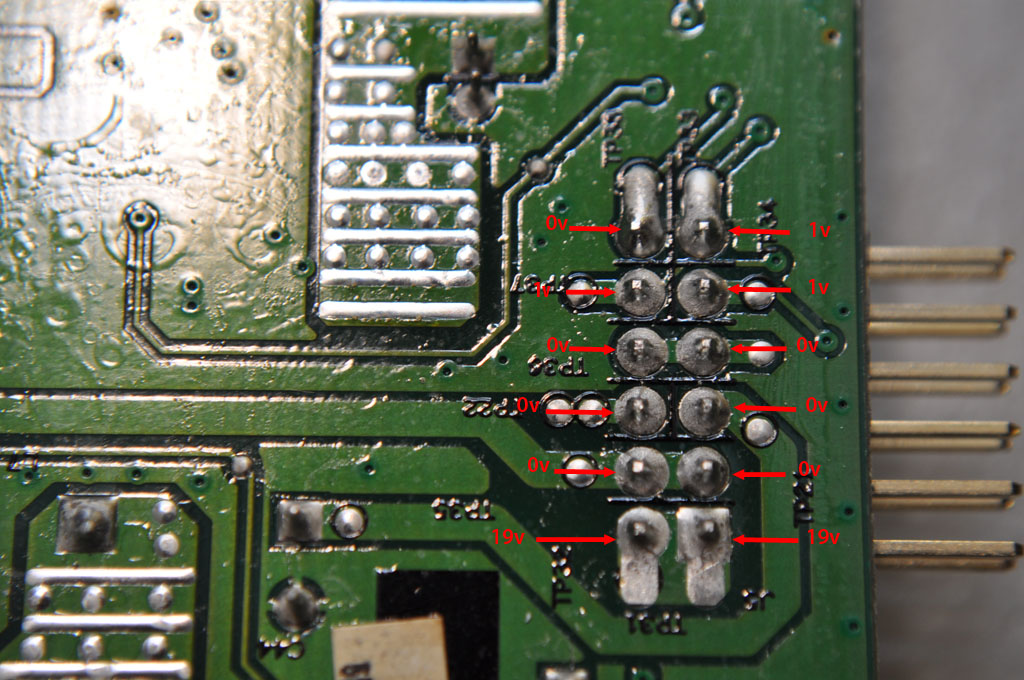

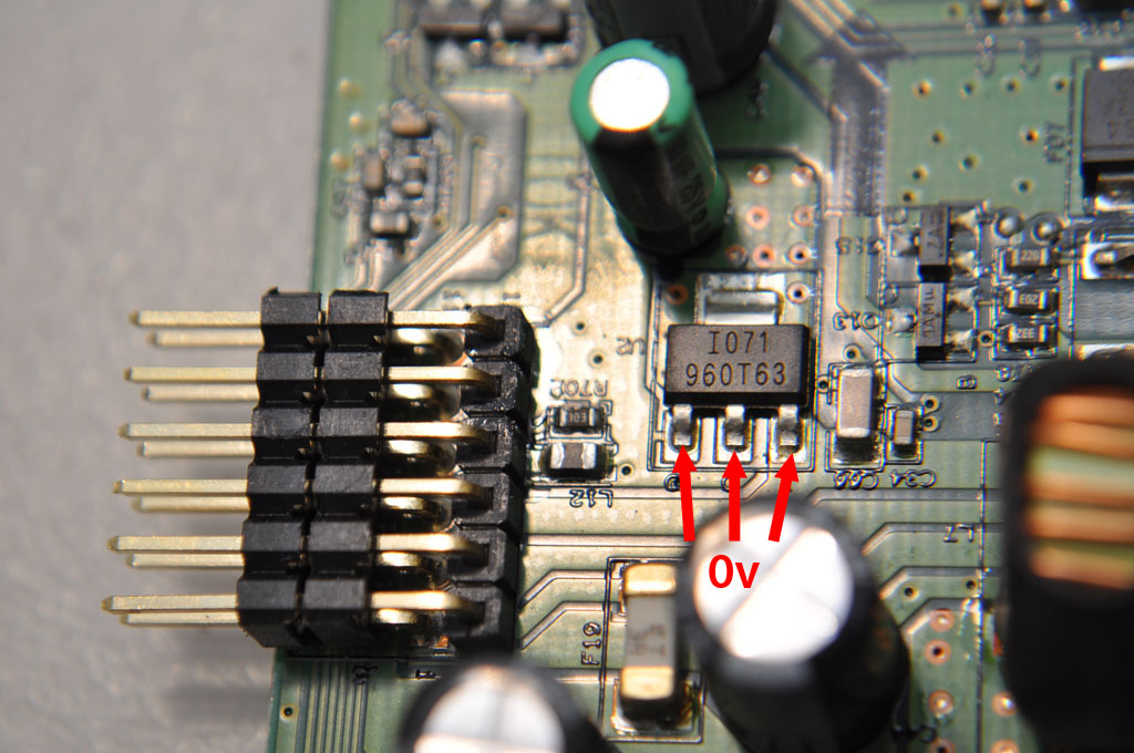

            Next, what are the voltages on each of the 12 pins connecting the signal card to the USB card?
            There are 4 regulators you have indicated have 19V on two pins. What are the part numbers of those 4 ICs?
            Last, what is the part number of U2 on the USB card. What is the voltage on the three pins?

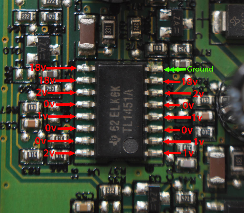

            PlainBill
            Retiredcaps I re-tested with the USB board disconnected but had the same results.
            I've uploaded some additional pics, one shows the bottom side of the usb board indicating the pins getting voltage,(took the picture first then plugged the board in ) the other is the U2 chip. The 4 IC's with 19v are part# J598.
            I'm trying to be as detailed as possible with pictures guys , but if its too much I'll tone it down. I figured pictures tell a thousand words!
            Thanks for jumping in on this Plainbill and Pedro.

                I for one appreciate the detailed pictures. It makes it a lot easier if I can SEE what the part number is, and it makes it a lot easier if I can say 'What are the voltages on pins 9 and 15 of U3 and U4?' rather than have to download a picture, load it into Paint, circle ICs, and ask what the part number is.
                Which brings us to the next step. What are the voltages on pins 9 and 15 of U3 and U4? Does 19 volts appear on any of the pins of the white connector on the left side of the USB board? What connects to that connector?
                Briefly, these boards are a step back from what I was expecting. U3 and U4 are dual pulse width controllers. The J598s are 2SJ598, a P-Channel FET.

                  #88
                  On both U3 and U4, Pins 9 show 18v and pins 15 show 0v. The connector at the end of the board is for the actual USB ports (2 ports mounted on a small board with 4 small caps). That connector reads 0v on all 8 pins.
                    What are the voltages on every pin of U3? U3 and U4 are the controllers for the DC-DC converter. As closely as I can determine, for some reason the gates of the J598's are not being driven.

                      #90
                      I've uploaded another picture detailing the leg voltage on U4, U3 also has the same voltage.
                        OK, I'm going to have to figure out how to get a real live TL1451 to measure.
                          Here are some measurements I took on my board,
                          The inverter is not installed so there is very little load.
                          The row of 'g' fuses all have 5.12v
                          U3 and U4 have almost exactly the same pin voltages.

                            Alexanna, if you power up just the logic board (with out the usb board) which pins have voltage & what do they read?

                                Without the USB hooked up I see 19v on the black and brown wires at the logic board
                                on pin #9 of the 12 pin conector to the USB right about .5v

                                    It can get confusing; I will call the USBs big and small.
                                    The small board doesn't have to be installed for the big board to generate voltages for the signal board.
                                    However 5 volts is on the row of โ€˜G' fuses going to the connector for the small board.
