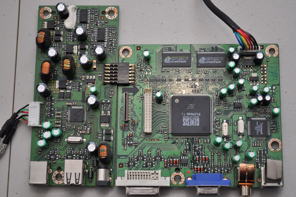

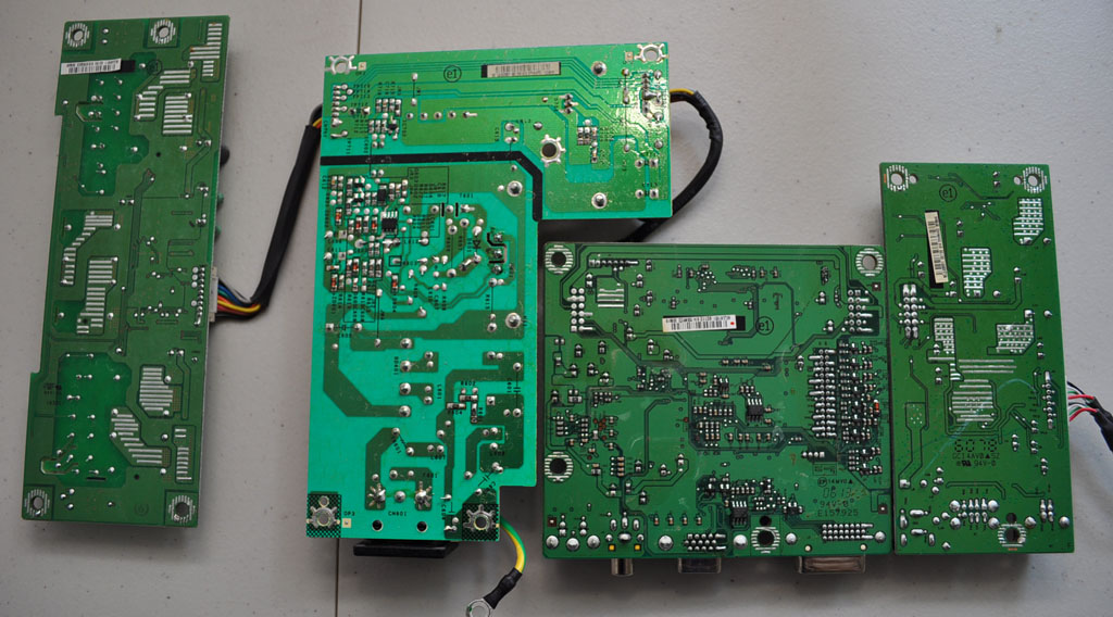

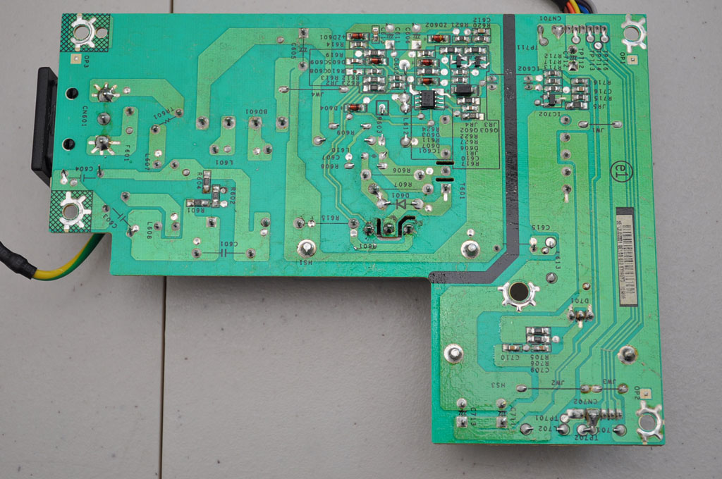

      Re: Dell 2007WFP Won't Power On
      Hello All,
      I realize this post has been quiet for about 10 months now and I hope some one out there can still help me out.

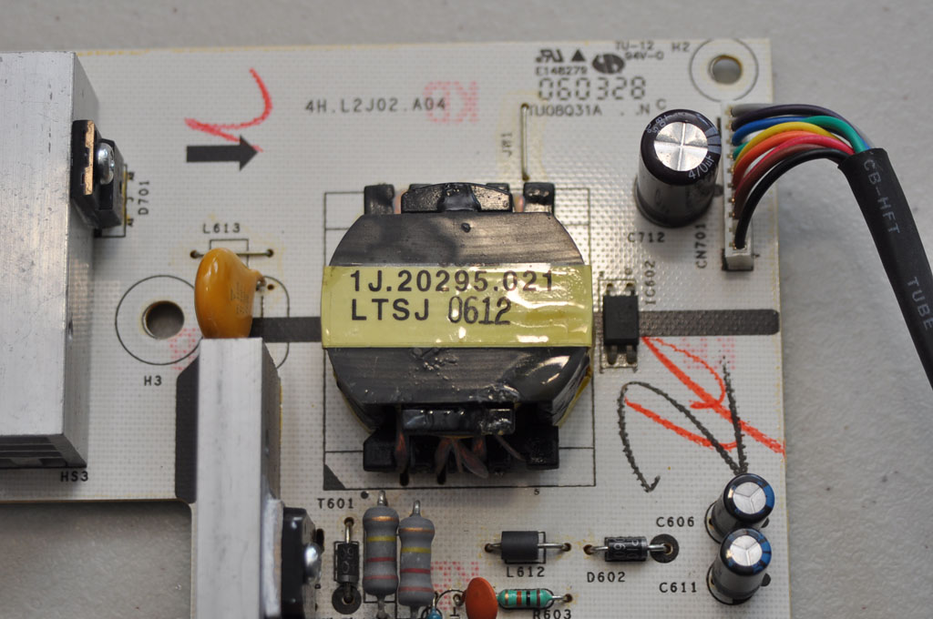

      I"m having a problem with my monitor, came home from work one day, try to turn the unit on but it didn't, I'm not even getting the pwr button LED light (orange or green)
      I do have some electronics knowledge however not a pro.. I've taken it all apart and took some basic readings with my DMM. I've also posted some detailed pictures with my findings.
      for starters I"m getting continuity across the fuse on the Power Supply board, at the end of the PS (Power Supply) board I'm getting 18V at each side where CN701 and CN702 are.
      This is where I'm confused, the transformer on the PS board doesn't seem like its showing correct reading. look at the close up of the transformer contacts, I've edited it to reflect what my DMM is showing. Other than that I could use any advise or help. Thanks guys!

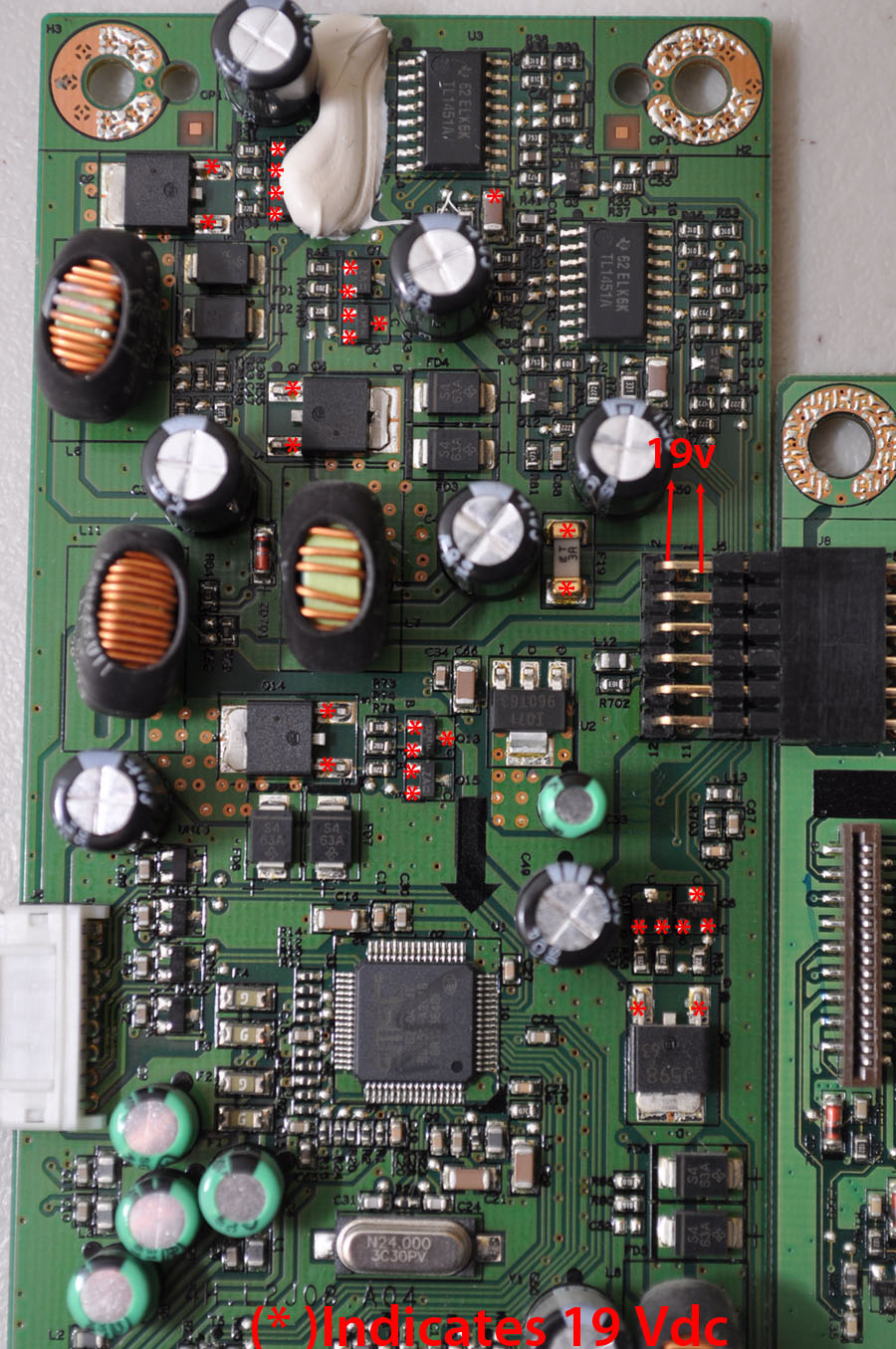

        First, those are excellent clear focused pictures. The composition is excellent showing both sides and the relationship between boards. I wish more people would provide such great pics.
        Second, I have this exact same monitor taken apart waiting repairs/parts.
        I found that the logic board (with the Genesis chip) had two bad voltage regulators (right by the connector). U13 and U5 are both shorted.
        On the USB board, I found 2 diodes (FD4) shorted.
        Lack of proper solder equipment has prevented me from repairing this monitor so far.
        PS. I think I got 19V DC if I remember correctly on the power board.

          The 160V on both pins of the transformer is probably correct,and one of thos normally goes to the Large Filter cap,and the other to the Mosfet on the Heatsink.Provided the SMPS chip ( the 8 legged one )next to the transformer,is functioning correctly,then this drives the Mosfet to feed the transformer. On the other side then,where you are getting 0 volts,is probably not the best place to check.D701 looks like a Schotky diode,and the rectified voltage from that,feeds C711 and C713..measure the DC voltage across the caps and check the diode by using the diode test funtion on your meter(if you have one)The latter with the power OFF.Also advise the part code of the 8 legged smps chip ?

            retiredcaps, Thanks for the compliments on the pictures, I realize how critical it is when working on an item that you don't have in front of you. I"m a big fan of close up detailed pics.
            I've checked the U13 and U5 components on my board and they read ok, not shorted. Also read the the 2 diodes (FD4) on the USB board and they too were not shorted (i also checked every diode of the same Part# number as FD4) .
            And yes you're correct, 19V is what I'm getting.
            Rtech, I removed Schottky diode (D701) to test out of the board and it checks OK. I put it back in and plugged the board in, Both caps C711 and C713 read 19 vdc across.
            I was able to read the part number off the 8 legged chip, it is 200a6, I also hunted down the datasheet for it witch I uploaded. I'm not exactly sure what to look for in that datasheet so your more than welcome to talk a look at it.
            What I did find is a shorted diode on the bottom side of the power board, (D604). its to the left of the 8 leg SMPS chip (if looking at my pic). other than that I can't seem to find anything els.
            Thanks for helping out guys, anything else I should be looking at?

              #66
              If you are getting 19V DC at CN701, that implies your power board/supply is working.
              On the logic board, now measure the DC voltage each pin on both voltage regulators. Even though these regulators are not shorted (like mine), they still could be out of specification.

                  #68
                  No I'm not getting any voltage on any of the pins of the regulators (U13 and U5). I've got 19v on the 2 far right wires (brown & Black )at the connector above the regulators.
                  The fact that you are getting 19V DC on the wires shows that voltage is getting to the main board, but the voltage regulators are dead.
                  If you are not getting any DC voltage on U13 and U5, that would explain the lack of the power led going green. That means U13 and/or U5 are both bad. If you have junk boards laying around, you may be able to desolder an old one and use it. Or just order them from digikey or mouser.
                  On mine, U13 is 952T43 (a 1.8V 1A)
                  http://www.alldatasheet.com/view.jsp?Searchword=952T43
                  U5 is 950T65 (2.5V 1A)
                  http://www.alldatasheet.com/view.jsp?Searchword=950T65
                  1.8V and 2.5V DC is what you should get if the regulators are working properly.

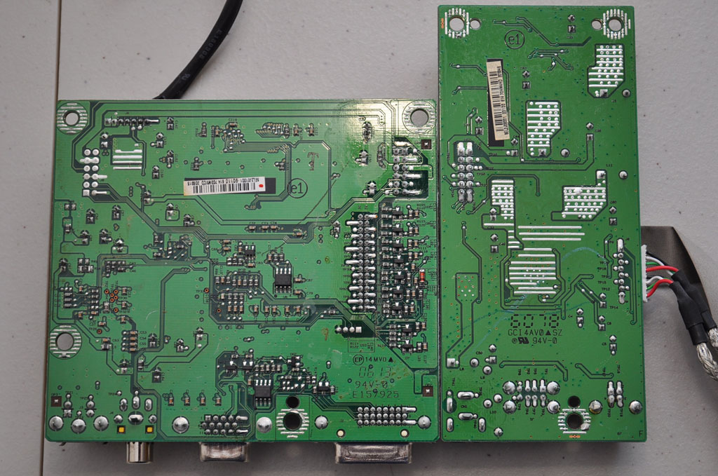

                                  I just traced the circuit on the board for those 2 wires (brown and Black) coming into the logic board that read 19v. They go directly to the connector that connect to the USB board.
                                  they don't energize the logic board at all. I've tested several other components on the logic board they they all read 0v, the entire board has no voltage. The usb board however is a hole slew of components reading 19v.
                                  This leads me to believe that there has to be another wire that energizes the logic board, however there isn't. take a look at the USB board. its hot. the logic is dead.
                                    On one yet to be solved monitor, whenever I hooked up the logic card, my power supply went from 12V DC to 0V DC.
                                    I wonder if the USB board is shorting out the logic board? Try removing the USB board and re-measuring the logic board for DC voltages?
                                    Of course, my monitor is dead so I can't even measure voltages. Looking at the power board, there is only one 470uF 35V cap which leads me to think that 19V DC is the only secondary voltage provided?
                                        I've been pouring over the pictures for the last 15 minutes, getting more frustrated by the minute. First of all, if you have 19 volts on the USB card, the power supply is working.
                                        Next, what are the voltages on each of the 12 pins connecting the signal card to the USB card?
                                        There are 4 regulators you have indicated have 19V on two pins. What are the part numbers of those 4 ICs?
                                        Last, what is the part number of U2 on the USB card. What is the voltage on the three pins?

                                          #80
                                          The USB board obviously produces a regulated +5V from the 19V supply. Is it a possibility that THAT is the supply for the logic board, and NOT the 19V? If they are going to use 3-terminal linear regs for 3.3v etc on the logic board, that would make sense.
