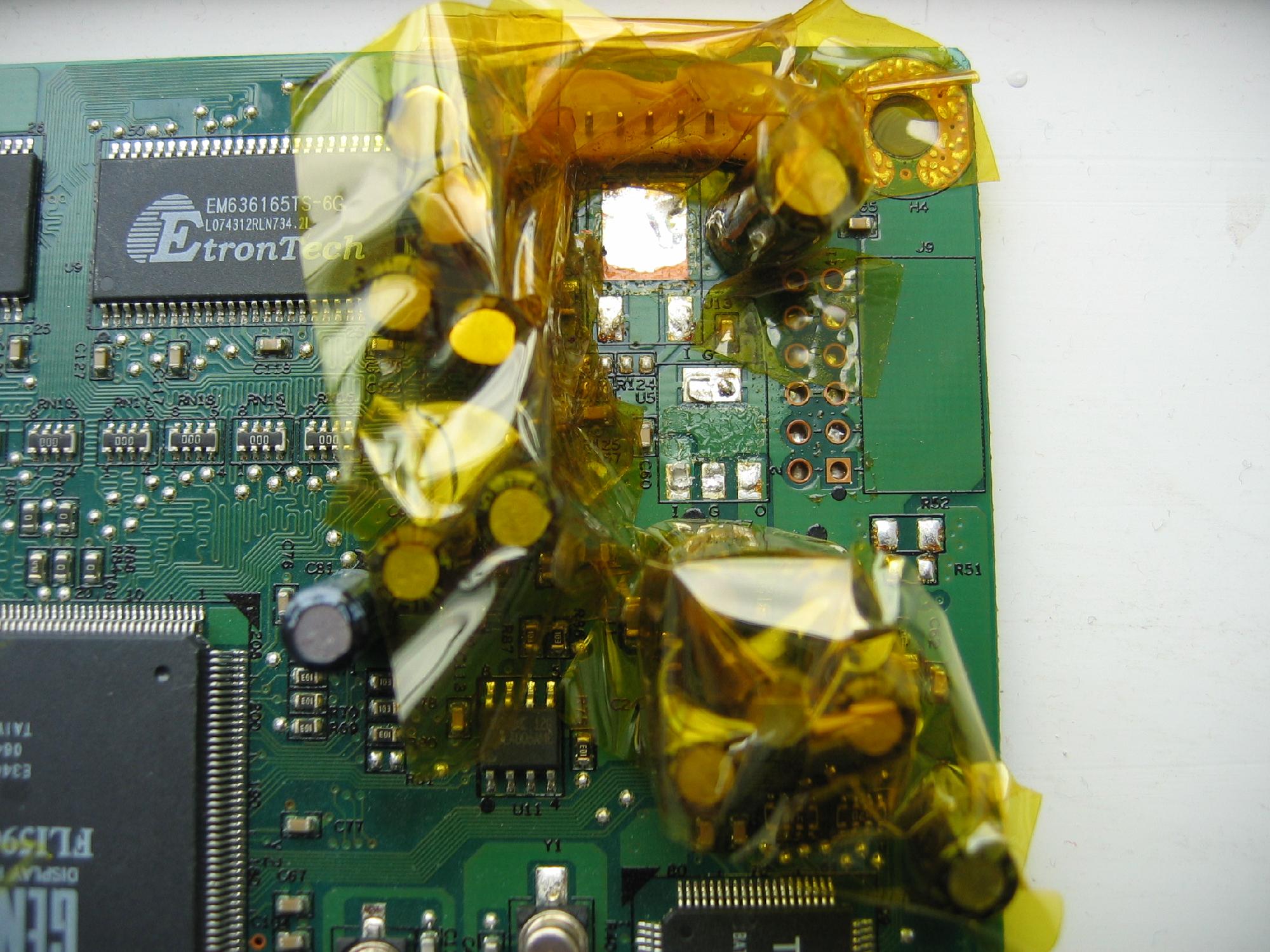

                                Update on my project...I'm sorry to report that my logic card fix did not go well. The existing solder was the closest thing I've found to cement, and the parts just would not budge. I tried all the usual tricks - adding a little solder, adding a little flux, pressing the turbo button on my iron - and the board was damaged, and I screwed it up.
                                I started by removing the cap C155 next to the voltage regulators to make some more room. I ultimately got it out but it took one of the pads with it. And I've probably done fifty caps in the past year, and never had a problem.
                                Voltage regulator U5 went in cleanly, but the U13 was more difficult. And in the process, I damaged the microscopic C156 next to it. It just popped off, and it was so small I barely noticed it. And now either it's bad or put in badly - probably both but I could barely tell which side is up.
                                Anyway, they can't all be winners in this game and I already have my eye on another project for this weekend. But no doubt this one was a learning experience and the next one should go better. LAS.

                                        Originally posted by LAS
                                        IThe existing solder was the closest thing I've found to cement, and the parts just would not budge.
                                        Before I went to sleep last night and before your update/post above, I took out the heat gun to desolder both voltage regulators. I have tried in the past to desolder these 252 and 223 packages without success so I switched to the heat gun (aka poor man's hot air rework station with no temperature control).
                                        To protect everything around, I ordered 100 feet of Kapton tape ($4) and use it as a heat shield as you can see in the pictures. Both regulators came out with no problems after about 90 seconds of heat.
                                        Now remember, my in circuit readings suggested both U13 and U5 were shorted. Well U13 and U5 are fine. There are no shorts and I tested it with a 9V battery and both output the correct voltage.
                                        With both regulators removed, unfortunately, the pads still show a short. So there must be something else shorted on the logic board.
                                        Anyway, I wanted to share a tip about using Kapton tape in the future whether you use a soldering iron or heat gun.
                                        Note to self: Avoid this Dell model, even free, at all costs.
