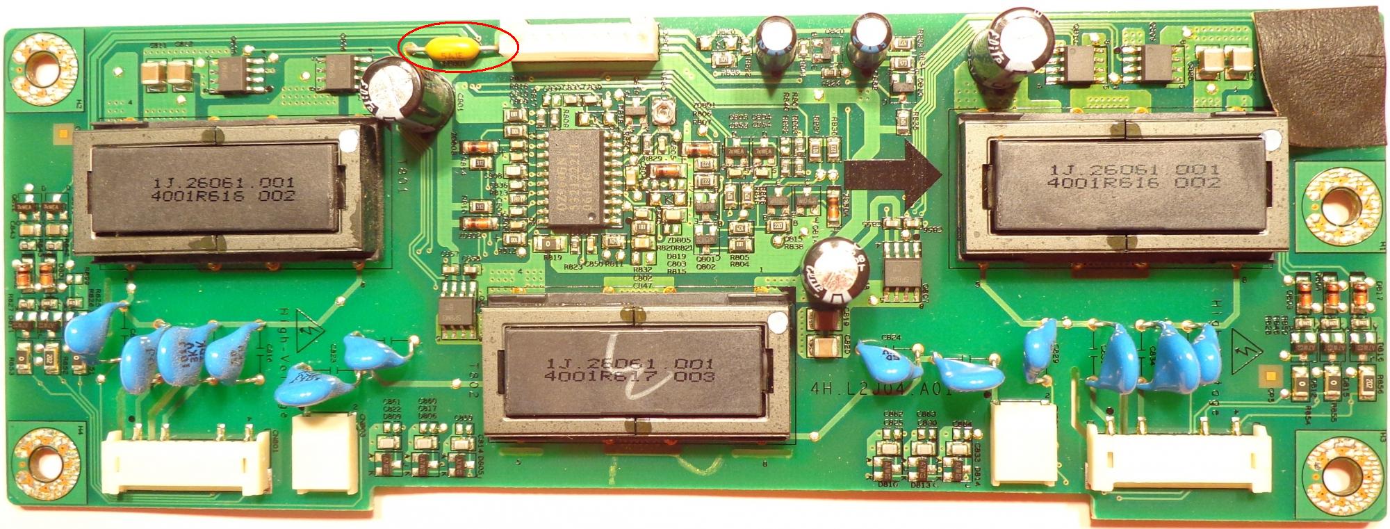

                    I am having trouble finding a fuse. Unless it happens to be this FP801 which I have circled on the attached photo. If that is a fuse, I am reading around 10V on one side of it.
                      #170
                      Re: Dell 2007WFP Won't Power On
                      That is the fuse, it should have 19VDC which comes from the main power supply board, that power supply board has only single output, 19VDC.
                      • MEB
                        • Sep 2013
                        • 371
                        #171
                        You are right. It reads 18.95V. Fuse is open and removed from board. It is obviously a 5A Littlefuse from the markings but being unfamiliar with this type of fuse I couldn't find whether it is a fast or slo blow so didn't obtain replacement yet.

                          Jumping into this thread. I have the same board. I've removed this fuse and testing it on the multimeter ohm setting shows nothing. So I am assuming it is blown. Did you ever find what the replacement part is for this and who to order it from?
                            #173
                            Littlefuse PICOII fuse, Fastblow, that is what I use. You can get it from DIGIKEY or MOUSER.

                                    The fast blo may trip due to the in-rush current when the caps on the inverter board are first charged up. I would get the same as original.
                                    One thing you need to do is to verify that the board does not have shorted out MOSFETs.

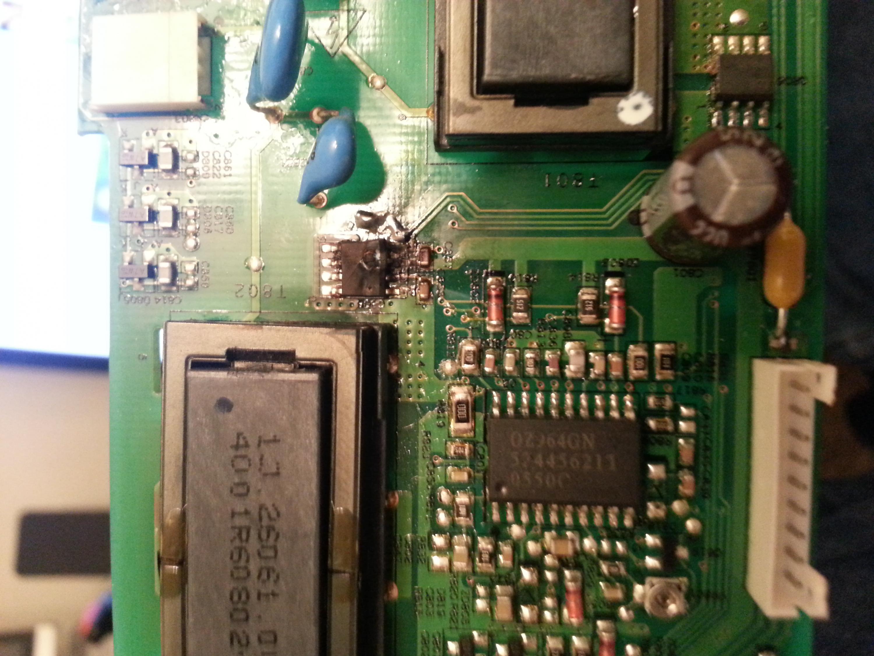

                                        Wow, what a light show. The littlefuse came in today so I soldered it to the board today. All the caps had been replaced on this board and the power supply. Well once it was plugged in sparks flame and the smoke is out of the chips. I did not have good enough lighting to get photos of all the boards.
                                          #180
                                          @MEB, I ran out of idea for you to check (I love that show).
                                          @craftman, it probably has shorted MOSFET's so it blew the fuse the first time.
