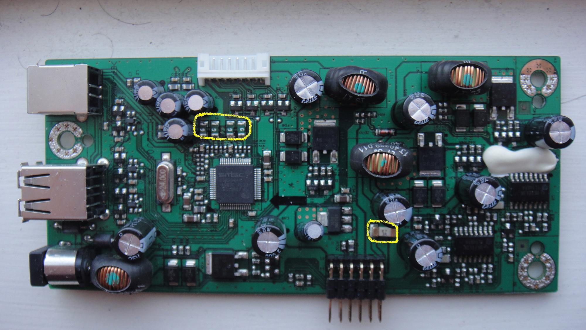

                        Try checking the fuses circled below. With power off and your meter set to resistance, place your probes across each fuse. Reading should be around 0 ohms.

                          All the fuses read .00 to .02 Ohms, they also show continuity. Could one of the capacitors have failed?

                                  One thing you could try is measuring the voltages at the power connector of the usb board. It looks like the pins are labeled 1-6 and 7-12. Try measuring the voltages with the "good" board installed and again with the "bad" one installed. Also, measure voltages while pushing the on/off button on the front panel. Compare the voltage output of the two boards. If you find a major difference, then try to trace what that pin is connected to.
                                  Yes, a cap can be bad. However, since you have no way of testing them, you'd be replacing them based on a "hunch".
