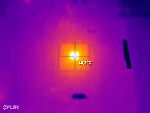

                        So similar symptoms, IC401 did not get hot, but little warm, so it stuck out on thermal camera. The short near audio jack turned out to be pull-down capacitor. Probably it's shorted when there is no audio jack inserted in the port. But also IC401 had no output voltages, so the device acted dead.
                        I replaced my IC401 with part named MP2149GJ-P (the original part has been retired) and the monitor started working. YAY!
                        The MP2149GJ-P is also rated 2A (original part was rated 1A). Not sure if this is total amperage or per channel. But if someone still has burned IC401, I suggest giving the MP2149GJ-P a try, it might be better version with more overhead.

                                    Hello and welcome. I got the same model for repair. Initial Diagnosis no voltage on IC401, replaced with a new voltage returned to L408 - 1.8V L407 -1.2V. However, the monitor does not turn on. The rest of the voltages L405 - 3.3V, L601 - 5V, L602 - 19V, L410 - 0V (IC402 also replaced) Is it possible that the processor has failed? Current consumption 0.055A. No response to the switch, the status LED is off.

                                        I took measurements in all possible places. The L408 has a fairly low resistance of 28 Ohms. I don't know if it's supposed to be that low.
