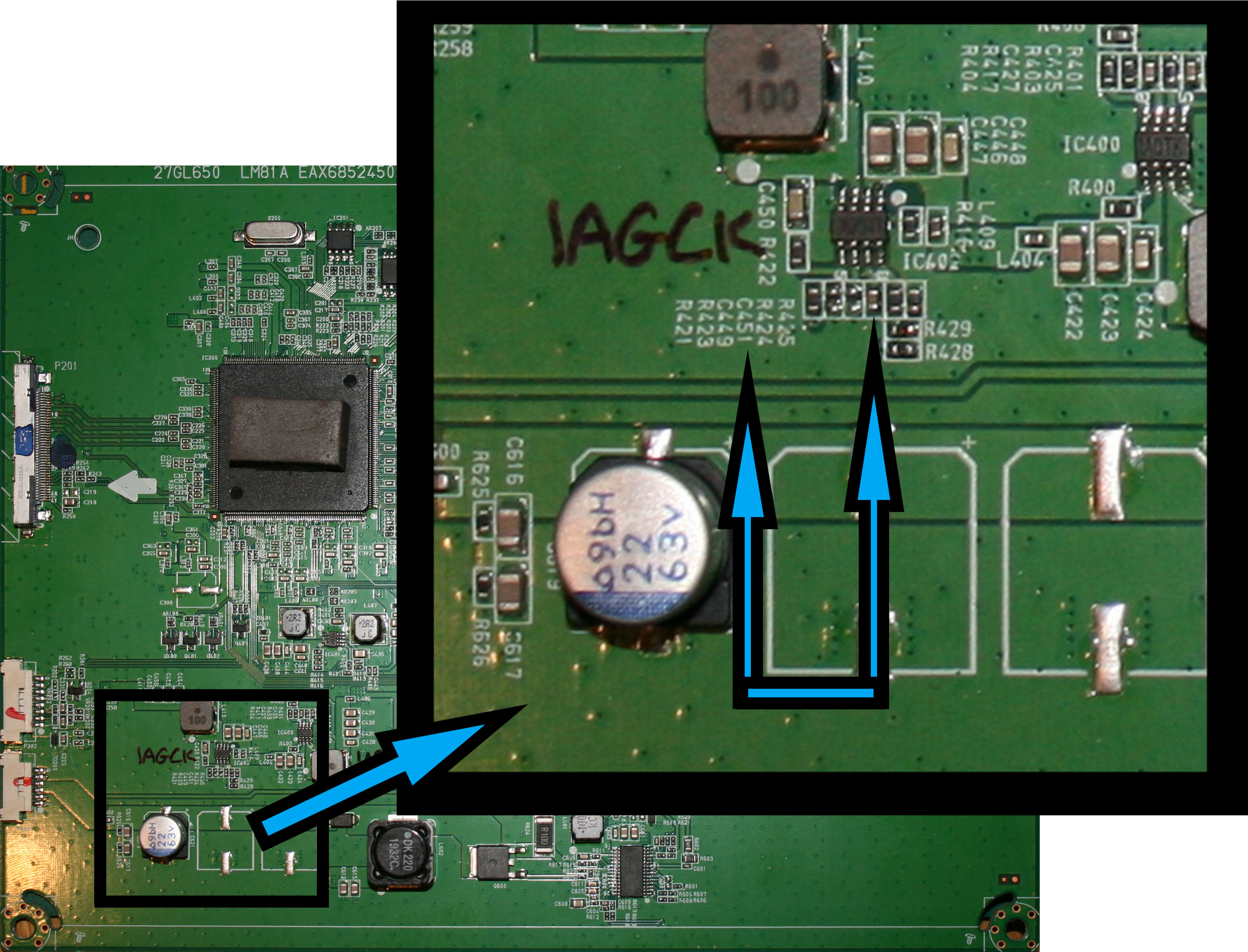

            • markismus
              • Mar 2023
              • 18
              • netherlands
              #46
              I've blown c451 of the board while I replaced IC402 (|AGCK). Can't find it anywhere.
              Would anyone be able to tell me the capacitance? Thanks!

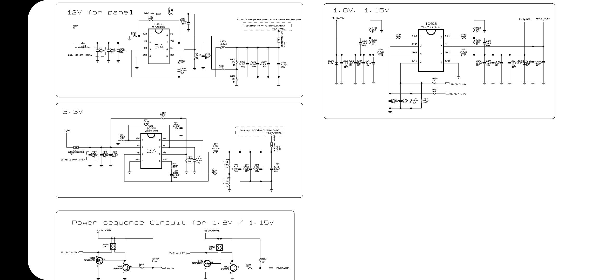

                          #52
                          My expected output voltages were based on the LG 27gl850 service manual posted in this thread. I assume the voltages should match... as this model doesn't differ that much.
                          Click image for larger version  Name:	guide.png Views:	0 Size:	84.3 KB ID:	3206090

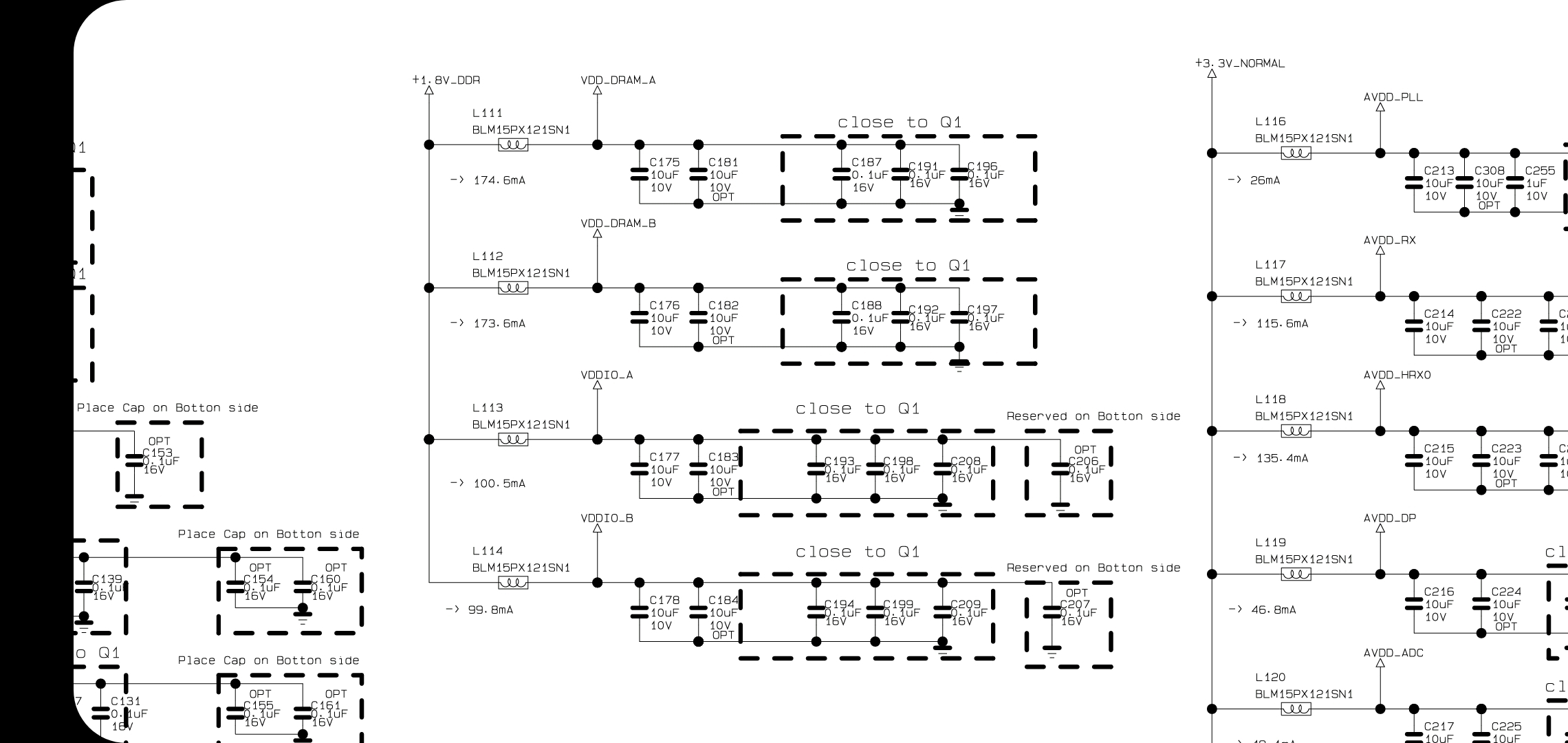

                                #55
                                Originally posted by Pandor
                                I believe that would be the AKX. The ic numbering might be different, but the general power rails seem to match. The AKX is the only dual output, so hence my assumption.
                                For me the AKX seems to start at 2v output briefly, but goes down to 0.08v on SW1. So it could be going into safe mode/protect. The weird thing is that the SW1 side does not seem to have a short on my board, but the SW2 side has a rather low resistance to ground. If anyone can confirm it should be 2.5v, i might try injecting that after the coil.
                                markismus the abcence of 5v input at the AKX is worrying though. In my case the 5v is present.
                                the powerrails actually match up in the service manual. Only IC401 seems to be IC403 in the schematics. This also explains why IC 402 would be low, as that seems to generate the 12v for the panel.
                                So i seem to be missing 1.8v, or rather it drops out at power up. I'll dig some more on that rail.
                                I'll just inject 1.8v into that rail and see what gets hot, and the power draw. Something on that rail seems to bring it down as soon as it powers up. Resistance on the unpowered rail seems fine though.
                                I just hope its not the CPU, as the 1.8v seems to split into VDD_DRAM and VDDIO and those just go through a capacitor cluster, and then into the cpu..
