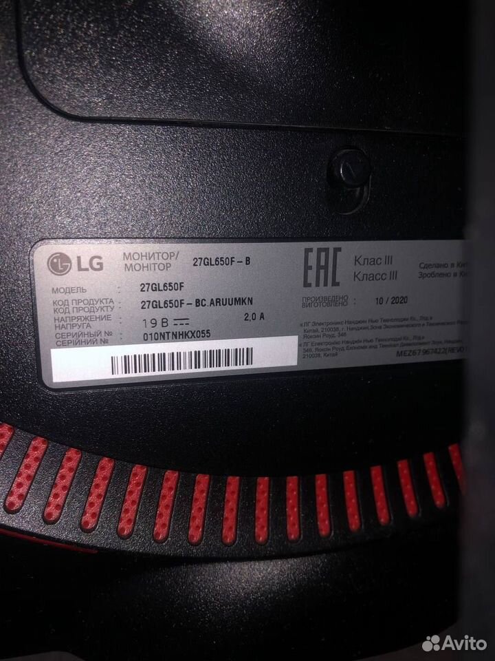

    #81
    Compatible with my monitor. Connector locations are different https://60.img.avito.st/image/1/1.r0...ePXQmQIR8-yrVU
    https://60.img.avito.st/image/1/1.BX...JP1LefPFcHN_5A
    • falkikowski
      • 8
      #82
      I think the locations of the external connectors are not the problem. New openings in the shell can be made and the old opening can be closed with 3d printed caps.
      But from what I saw on eBay listings the lvds connector to the panel seem to have different pin amounts and different connectors.
      Even if the pin amount is correct I'm not sure how well the connector can by adapted.

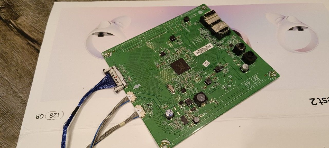

        #83
        Hello everyone, there was low resistance on the memory power supply pin on the processor, I ordered the processor from Alibaba and the PWM controller, I replaced it, everything works
        • markismus
          • Mar 2023
          • 18
          • netherlands
          #84
          voveo Could you post links to your ordered ic's?
          • Pandor
            • Oct 2016
            • 24
            • Belgium
            #85
            I'm afraid my problem is also the cpu. Do you have any resistance measurements with the new cpu?
            markismus this should work: https://a.aliexpress.com/_EuyUHWv​

              #86
              Hello everyone, I'm sorry, I bought the processor on Taobao, I made the order to Germany through Ukraine, on the non-working processor there was a resistance of 39 ohms, on the removed processor the same 39 ohms were on the 106-107 leg, on the installed new processor and kilo-ohm PWM controller, https://ua-tao.com/ua/item/749397100...RfcHJpY2UiOjB9 https://item.taobao.com/item.htm?spm...cket=15#detail
              • Pandor
                • Oct 2016
                • 24
                • Belgium
                #87
                So, if I understand correctly. The low resistance on the memory power supply was not the issue? The low resistance measures the same on the new CPU? But replacing the CPU revived the screen? I'm currently waiting on my replacement MST9U35Q1 from aliexpress.
                • voveo
                  • Oct 2023
                  • 4
                  • Украина
                  #88
                  Hello, sorry, I’m writing through a translator, the burned-out processor had 39 ohms when it was installed and 39 ohms when I dismantled it, on the new processor kilo-ohms

                        #91
                        Its finally here. At first glance, it looks fake (comparing the logo), but anyway. Wasn't aware this chip would have a bottom ground plane, so that's going to be a p.i.t.a. i'm not overly confident. I've done bga cpu's, but qfp chips don't tend to just flow in place under hot air... we'll see.
                        • Dannyx
                          CertifiedAxhole
                          • Aug 2016
                          • 3912
                          • Romania
                          #92
                          How much was this ? I'm just curious if it's a viable option to fixing one of these (IF it works, that is). If it ends up costing half the price of a replacement board, factoring in the effort required to replace it, I'd say it's not worth it, especially since this is the second board that dies on me (or HIM, since it's my friend's )...
                          Wattevah...
                          • Pandor
                            • Oct 2016
                            • 24
                            • Belgium
                            #93
                            I have a link up in post 85 for the ali platform. They go for around $20-35. Voveo also posted a taobao link.
                            I'm curious as to what soldering technique voveo used.
                            Unfortunately i can not find a replacement board for the life of me, so this is a last resort. If this doesn't work i'm binning the monitor.
                            • max-power
                              • Mar 2023
                              • 6
                              #94
                              I was having the same problem with a LG27GL650F that use the same board, I replaced the IC401 ( with the R414 fly off in the same time, it was fun to put it back ), and so 5$ on aliexpress and its working again, thanks

                                #95
                                Как думаете, доска подойдет? https://30.img.avito.st/image/1/1.rU...V8VYggda6c-Fk?
                                https://60.img.avito.st/image/1/1.7N...eRUkEu8ceMrds?
                                https://00.img.avito.st/image/ 1/1.PUOMI7aNhaq6lBOn-jdgN4SB05ED5vGZD-P3zFzkopwM4qORCLKizAKyppwO46HJWOL2qA.Fm0PLbR9hb6MoB1AhMc13-mRSp9vTxxBTgL0I2adVJM?
                                • alex1918
                                  • 5
                                  • Россия
                                  #96
                                  changed the board. bought for $20 with delivery. another board LM20Y EAX69488801 (1.4)
                                  It fits like a original. The board's operating time is 1300 hours. But I've already updated the monitor to an Acer Nitro XV272UVbmiiprzx
                                  .unfortunately lg was not close to him in terms of picture quality.I also removed the matte film from the screen​
