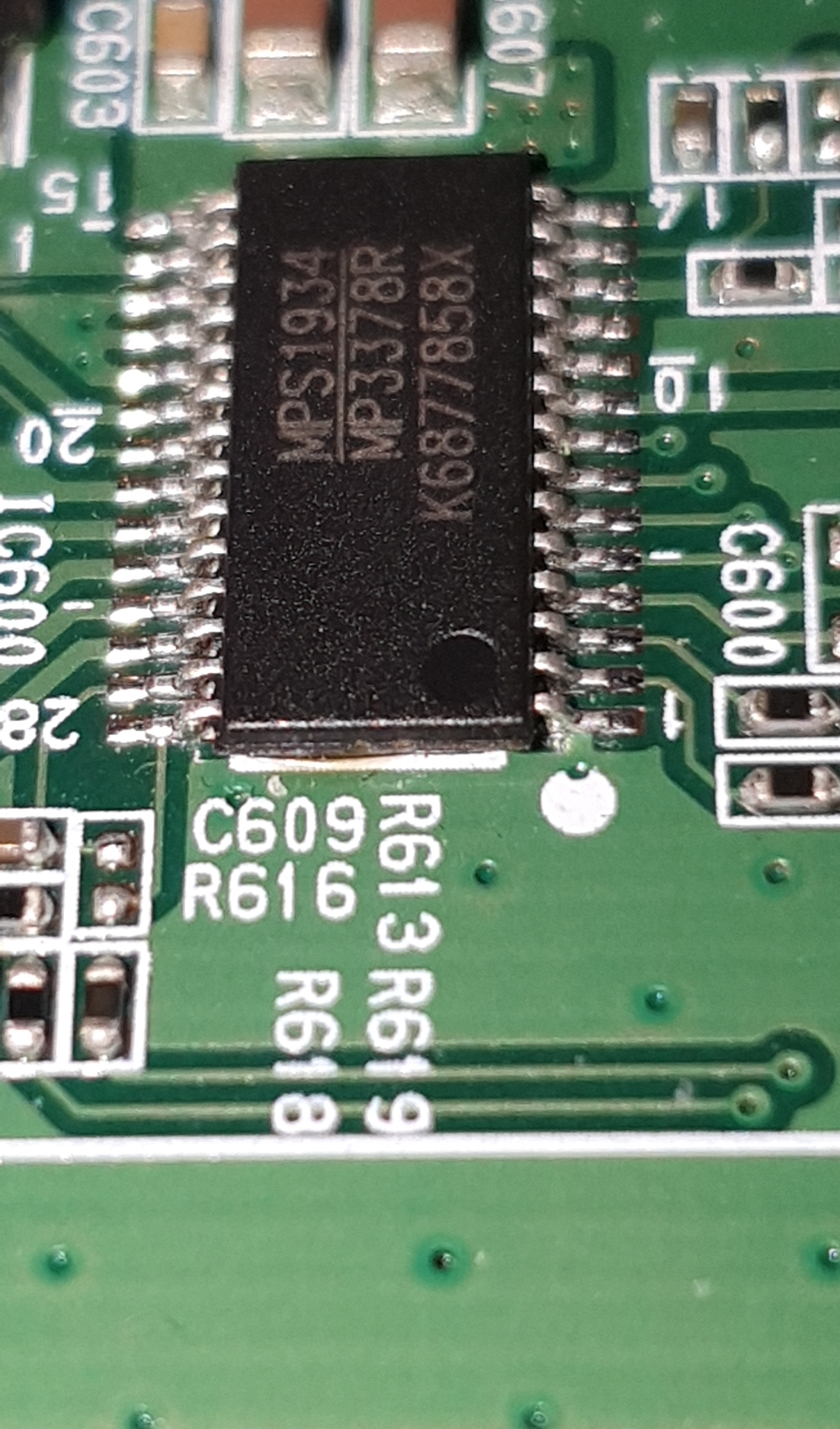

            So the next thing on the flowchart is the flash memory. I have the ICs:
            IC201 FT24C32A 9eHBAC Two-Wire Serial EEPROM
            IC202 BE1941 25080CSIG (Tags rechecked with microscope.) 3.3V Uniform Sector
            Dual and Quad Serial Flash
            IC500 98TG4 CISZ TPA6138 40-mW, stereo, analog input headphone amplifier with
            adjustable gain
            IC600 MPS1928 MP3378R K4871538X 24V, 4-Channel WLED Controller Plus High-Efficiency Buck Converter
            The IC202 is called the flash memory, however the EEPROM seems like flash memory to me, too. If I remember correctly, I have a flash memory programmer/reader laying around somewhere. So I should be able to check whether those still work...or maybe rig up an Arduino to read them....
            As the LED's are out, it could also be the IC600. I remember that it used to get really hot. Which it doesn't do anymore, so either that's been helped with the replacement of the AKX and AGC buck converters or it's died on me, too.
            Pandor Did you replace the AGC buck converter(, IC402 on my board&image from a few posts back)? I did a crappy job at it without the microscope, so I am wondering whether I shouldn't replace that one again.
            I could give it 2.5V on EN and see what SW does. If it changes to 5V, I should expect it to work.
            How could we check IC600, though?
            All three IC's are not that expensive, though. Just hard to see which parts offered on AliExpress are actually the same and which aren't.

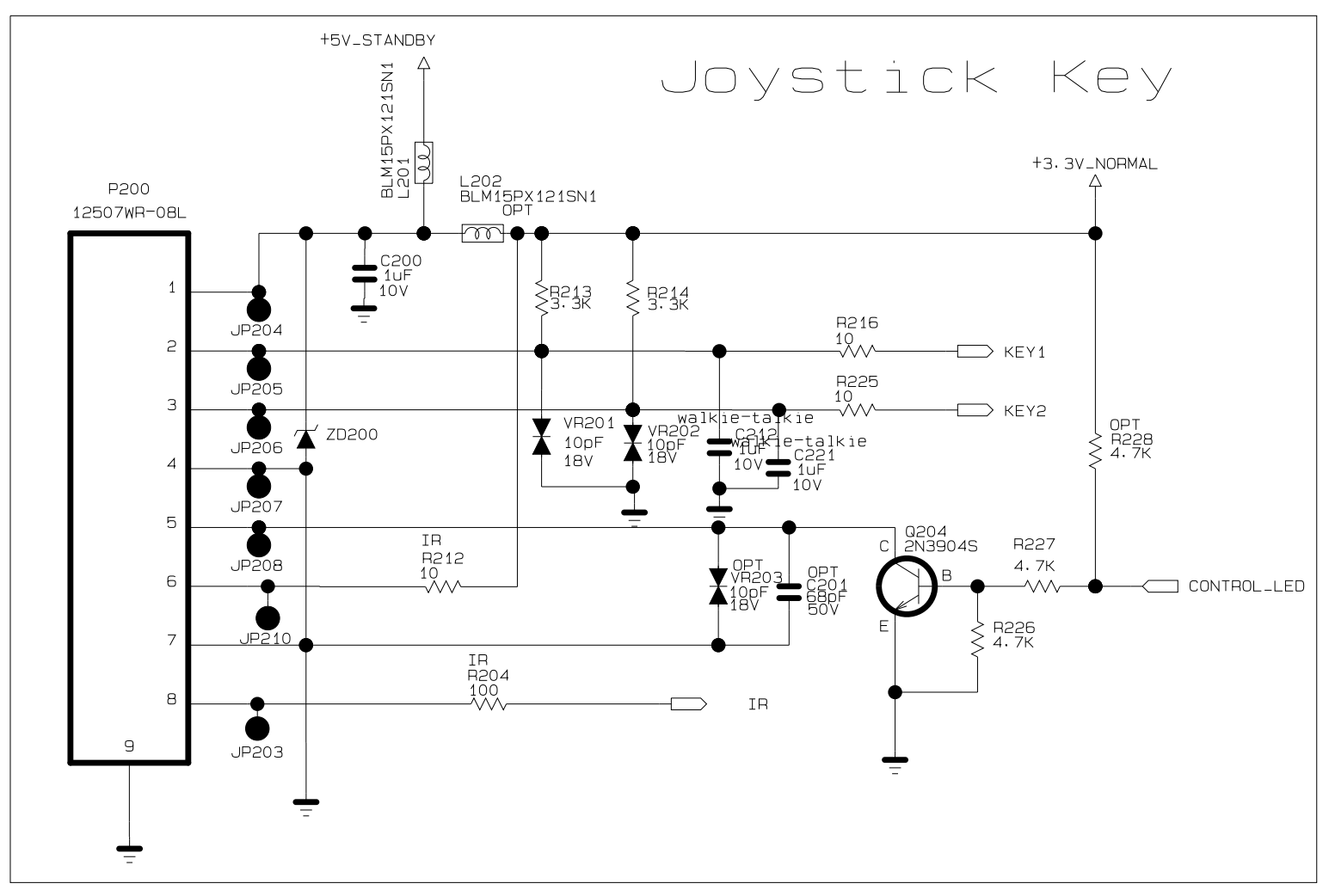

            Looking at CapLeaker's post #4, we could also try the 4-pin header (P200) and see whether we can get a TTL-connection going. Google doesn't really help for now for a working approach. Up till now I only used 3-pins for a serial connection and this page suggests there could even be 5 pins. Well, I begin with looking at the voltages, so that I at least don't damage my interface-board.

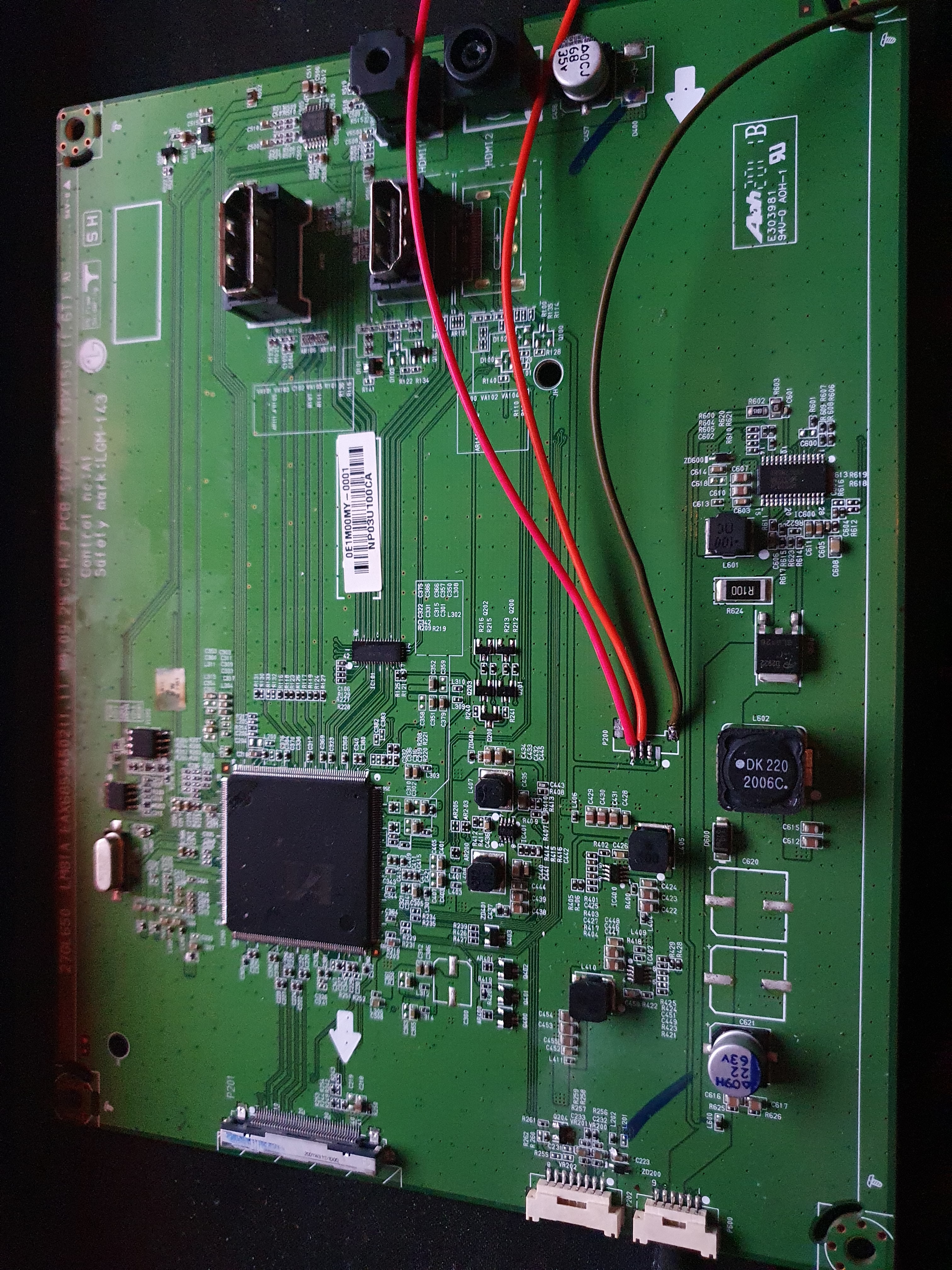

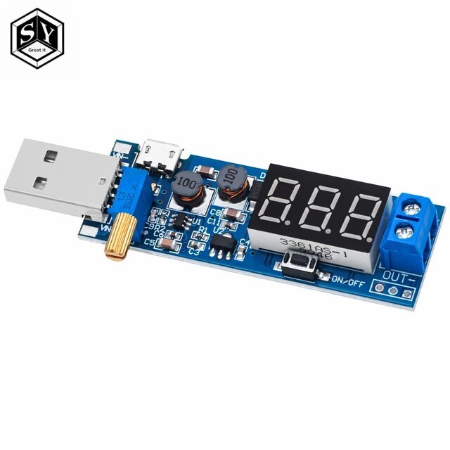

                Click image for larger version  Name:	S9a1aa675ef9348f4b0ba7a9740b854ffb.jpg_640x640Q90.jpg_.jpg Views:	2 Size:	42.1 KB ID:	3209752
                Testing MP2315 a.k.a. IC402.
                I have 18V on pin 2 (IN).
                I used a USB buck converter (See image) set to 2.0V and connected the negative to GRD (The metal of one of the connectors, JK102) and the postive to pin 6 (EN/SYNC).
                I get 12.0V on pin 3 (SW).
                So this one works. Pandor Do you get these test results, too?
                Currently all three buck converters work as expected.
                Next step is apparently flash memory.....

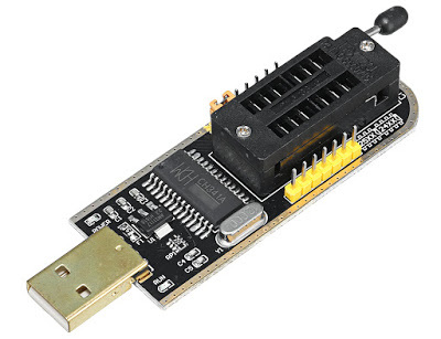

                  Click image for larger version  Name:	blackminiprogrammer.jpg Views:	0 Size:	37.3 KB ID:	3209907
                  I used a CH341A Mini Pro programmer and read the EEPROM IC201 (24C32A, 4KB) and the SPI Flash IC202 (GD25Q80C, 8MB). The data didn't appear totally random. (See attached IC201READ4KB_24C32 and IC202READ1MB_GD25Q80.rar.)
                  Comparison of the result of GS25Q80C reading 1MB with the binary file uploaded a few posts back shows differences but also a lot of identical data. So it rather looks like different firmwares/settings than a corrupted IC202.
                  No idea what the data on the EEPROM is meant to be.
                  Could anyone post a dump of their IC201 EEPROM for comparison?

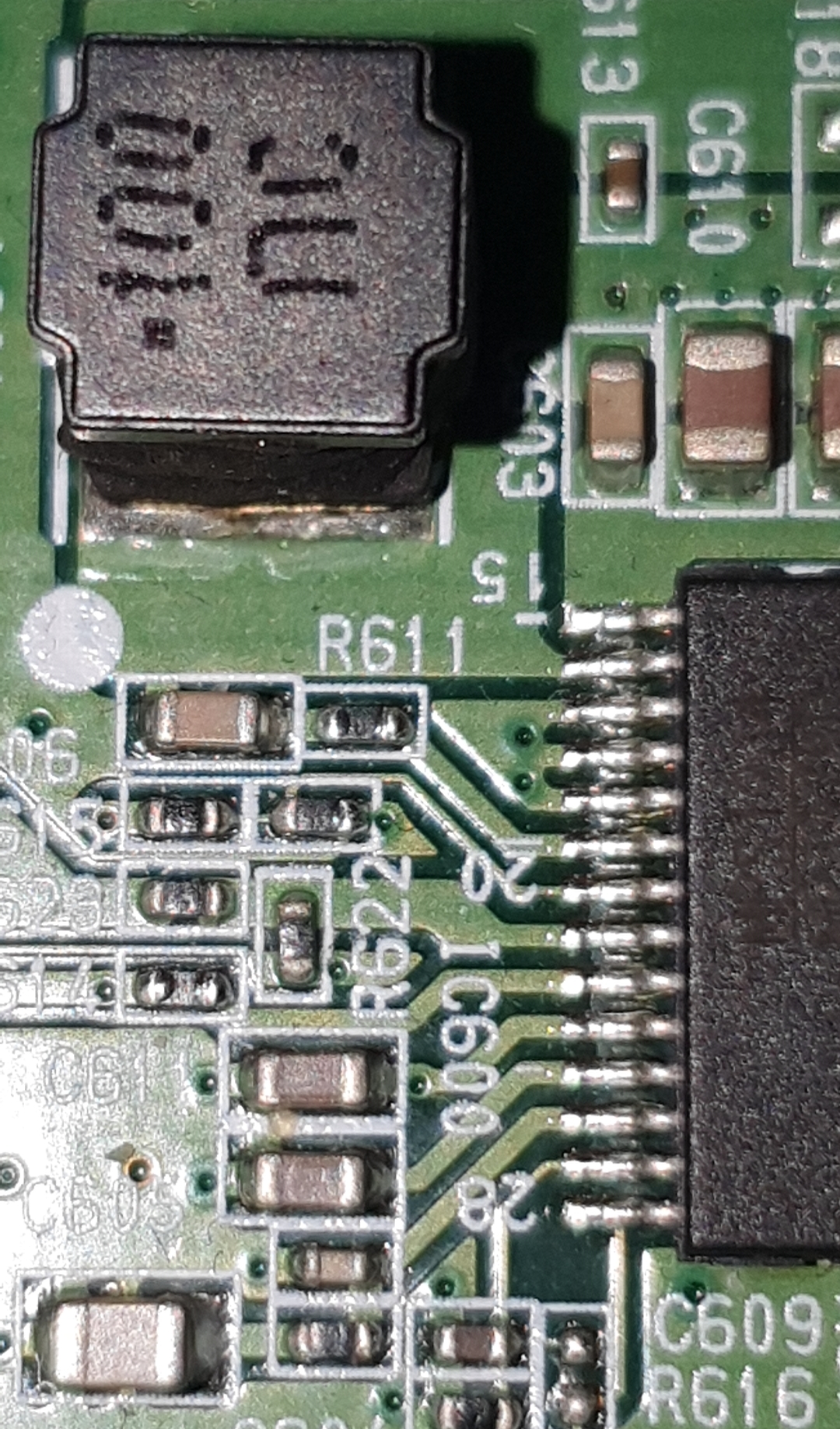

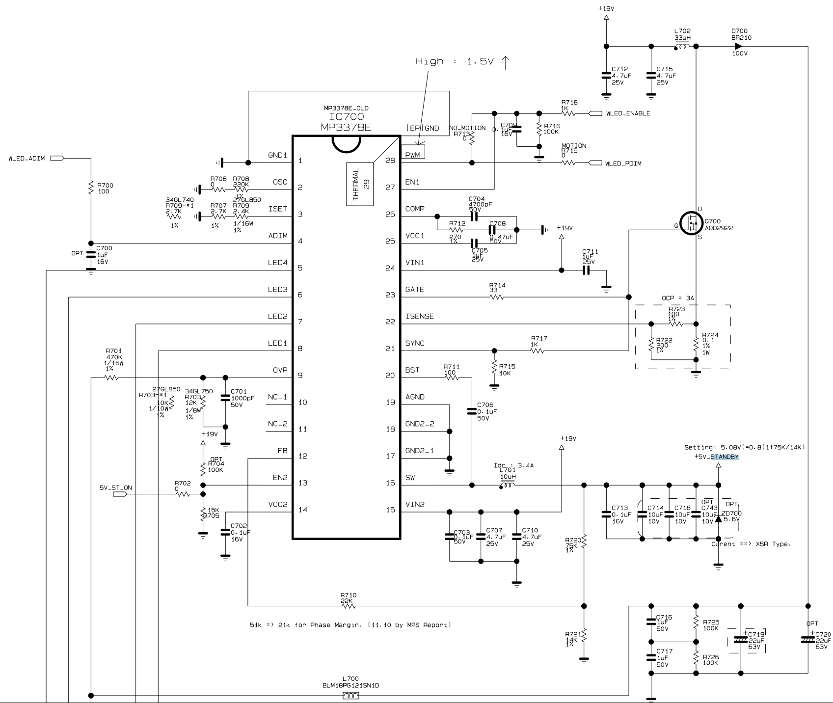

                              Pandor Well, the IC600 is a buck converter and LED driver, so if that one is broken, we would also be seeing no response. But it does seem that we narrowed it down to IC600 and CPU.
                              If we could connect to header P200 with TTL we could see whether the CPU is responding.
                              Still have to reread the datasheet for the voltages and pins on the IC600 to see how I can test it. That one is cheap, though.
                                #75

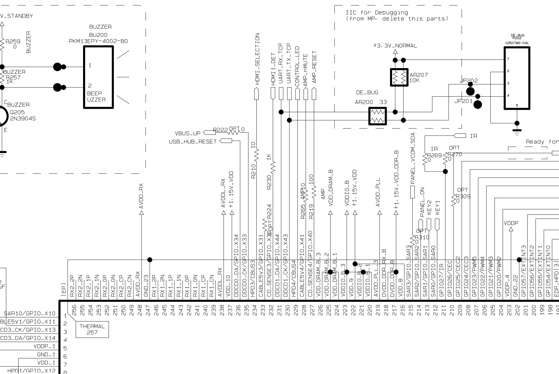

                                markismus you're correct about the IC600 function, but it is creating the +5V_STANDBY (pin16, going to L601), so in my humble opinion, that would/should be enough for just standby. No leds should be driven when the screen is off/standby, so I'm not convinced. iI doesn't seem to have any other purpose. Just as IC402's 12v is only needed if the panel is powered on (driven by the "PANEL_ON" pin from the CPU). What is interesting, is that i have 3.3v on the joystick/led connector, and normally the CPU also drives the standby led through its "CONTROL_LED" pin (Q204 near the connector), yet, no standby led... so a CPU problem?
                                I tink i'll desolder the serial connector, hook up some wires, and see if I get anything on the 3.3v TTL UART output. Or I'll just flame torch this board..
                                Sidenote: hooking up a USB to serial always confuses me... What does the silkscreen on the adapter actually mean? "This is my RX" or "the other device's RX goes here"???
                                  #76
                                  I hooked up my USB to TTL adapter, and no output at all. I could hook up my logic analyzer, but this is getting nowhere... I'm getting fed up with this LG cr*p. I feel like just taking the loss and tossing it.
                                    #77
                                    Pandor How did you know how to wire it up? Couldn't find anything in the 29gl850 service manual. A logic analyzer is new to me. Nice! But at least I would understand how you got the pinout.
                                      #78
                                      I find the service manual for the 24GL600 quite helpful. The naming is not 100% correct but the voltages seem to match.
                                      I swapped the IC401 and the 12 MHz quartz and getting the right voltages on that coils, but I get no high signal on the pin 2 of the LED driver IC.
                                      Do you think it is possible to check the IC200 and reflash it?
                                      Or is it alternatively possible to get a hole new board that just works with that panel?
                                        #79
                                        The 27gl850 service manual posted on the first page is virtually identical, minus the USB and buzzer stuff. most of the schematic matches the 27GL650 board we have. I've been using it as a reference.
                                        Here's the UART part:
