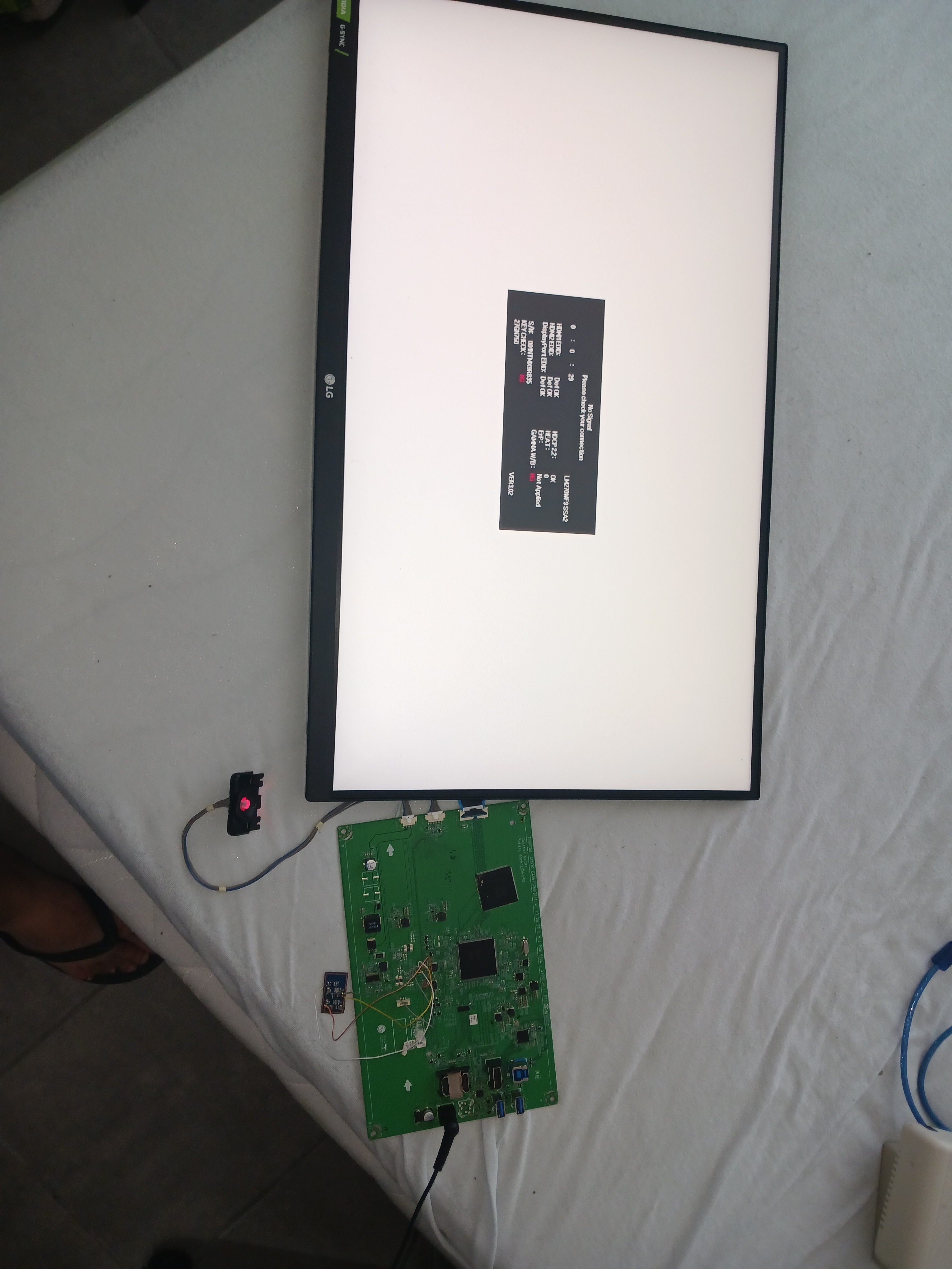

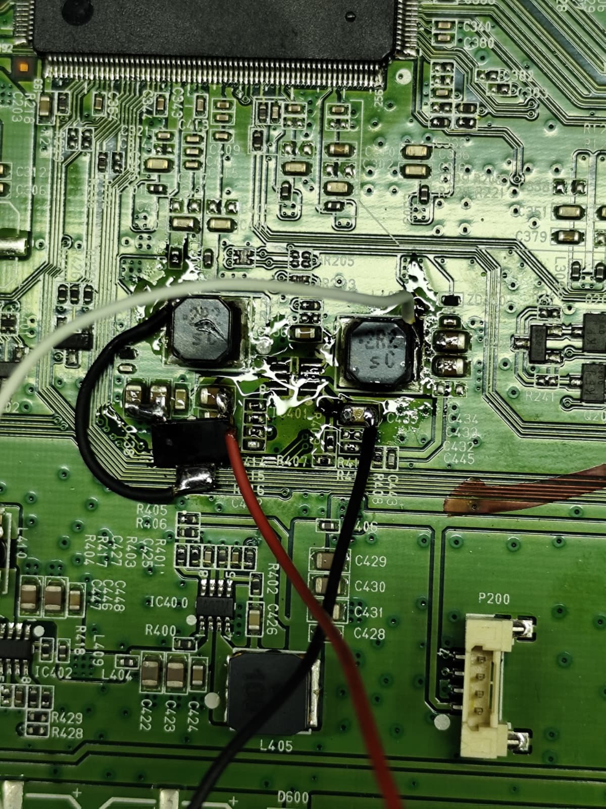

      I finally had some time to have a look at replacing the CPU. And it worked.
      So for me, the fix was replacing IC401 with MP2122AGJ + CPU.
      So i can finally vouch for the aliexpress link i posted. The CPU is good.

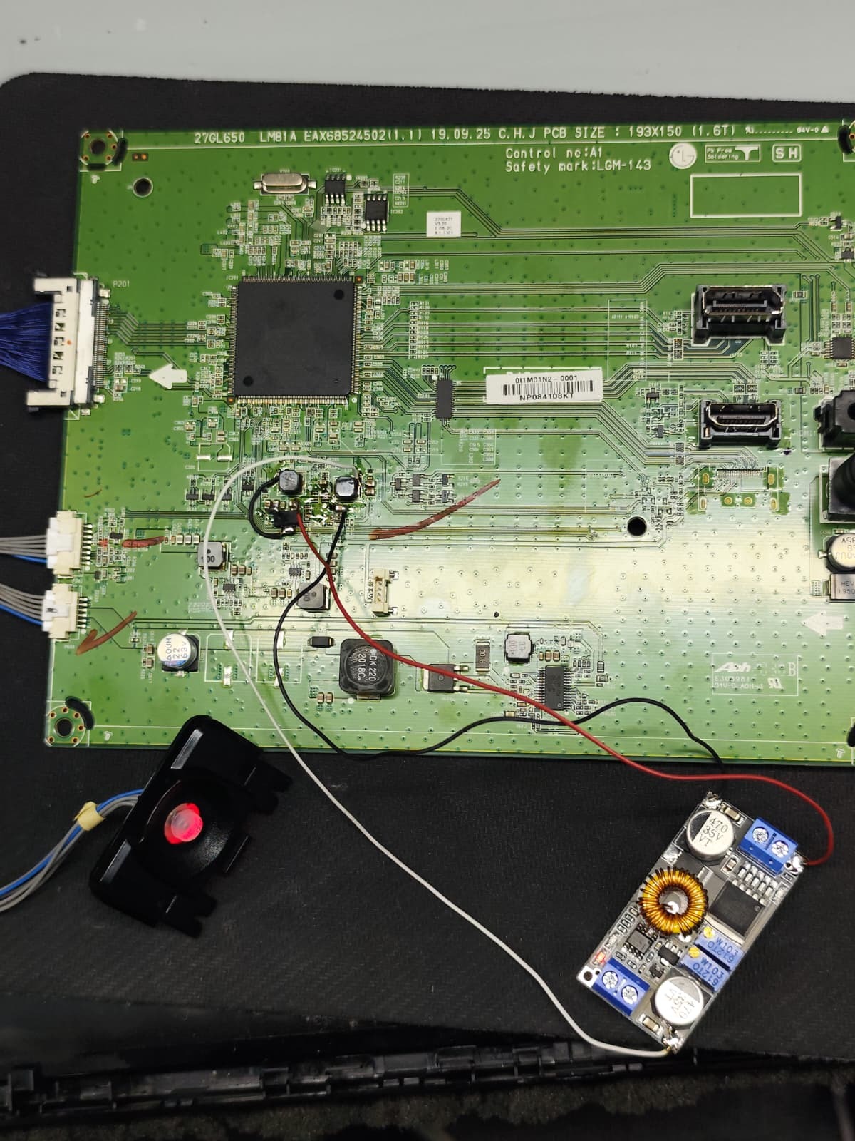

        Hi all!
        Im here for the same problem, 27gl650 dead...
        I think my problem is IC401, it gets extremely hot in less than a second.
        Reading here, the MP2122GJ can be better than the original and perfect for a replacement.
        However, I would also like to order some spare ICs for IC402 and IC400 but i can't find what they are.
        I have IAGCN for the 402 and IAQTP for the 400.
        Can someone help me identifying those?
        Thanks!
        PS. I have a lot of cap shorted to gnd around the 401, like C438 C439 C444 C403 C401... i will desolder the ic and test again later in the day

          Removed IC401, all shorts on caps disappeared!
          Ordered new components for IC401 and 402 (not shure if is working or not).
          For the C508 shorted near the audio jack: if you plug a jack, the short will go away. i think is intended to work this way.

            Great news, found some MP9148 (the original IC401) lying around and tried to replace it: MONITOR WORKING!
            I take some measurement for the IC401, 402 and 400 if someone need them, from pin1 to pin8:
            400: 300mV 19V 3,3V 0V 8V 2,4V 5V 790mV
            401: 609mV 3,3V 1,1V 3,3V 0V 1,8V 5V 609mV
            402: 286mV 19V 12,8V 0V 15V 3,3V 4,8V 800mV

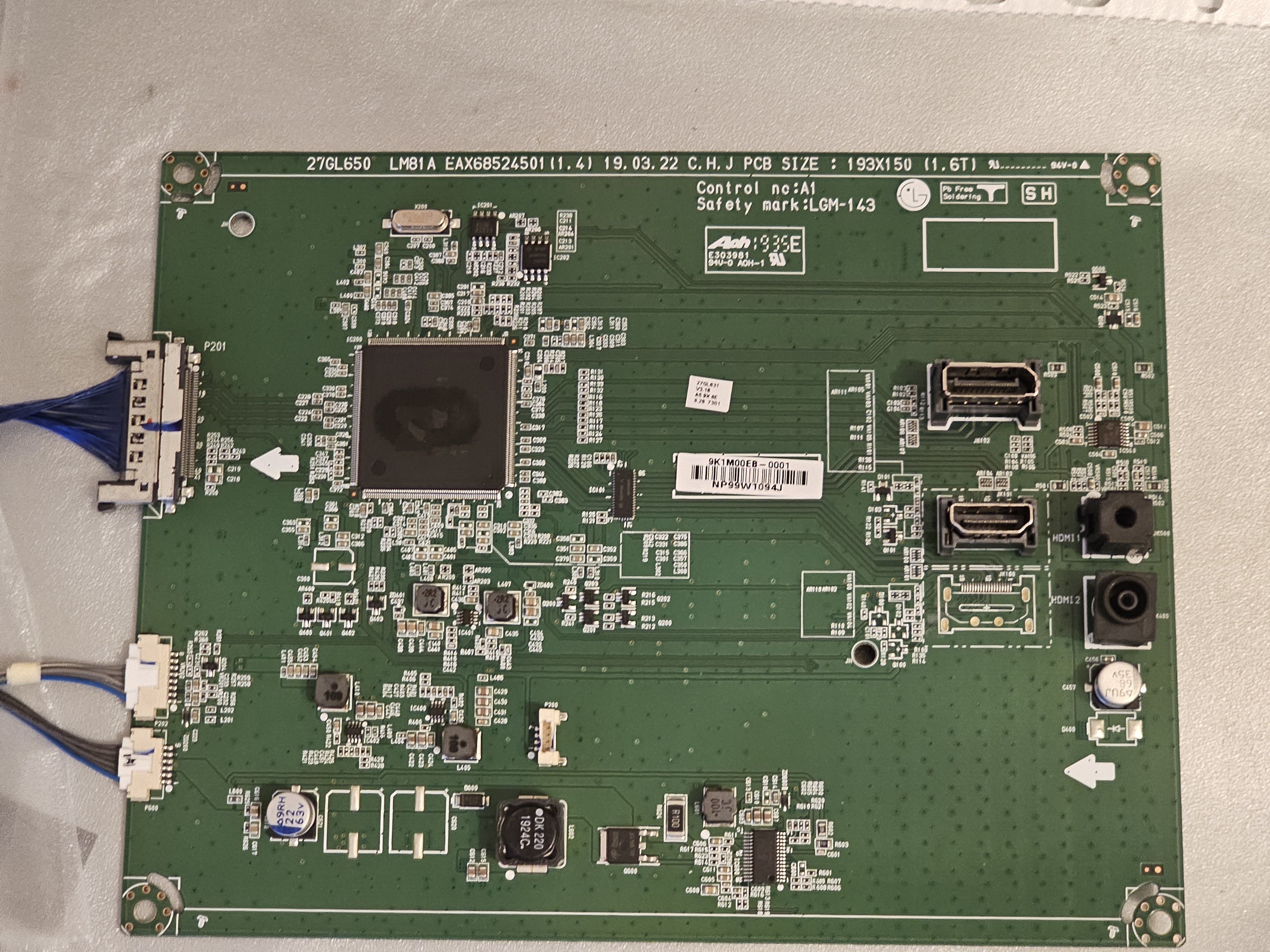

              My CPU, the big processor on the Board is getting very very hot until seconds.
              I cant find where to buy the PCB.
              I have an LG 27GL63T-B
              but my board is from LG 27GL650.
              My case only has ONE hdmi port.
              where can i buy an PCB compatible with mine?
              I can also buy an PCB with 2 HDMIs instead of 1.
              I think if its working i can modify the case if needed.
              The seller from non business has already opened the TFT i think.
              The TFT is from 2019. On the Board is written 2022 and some screws are missing and so on.

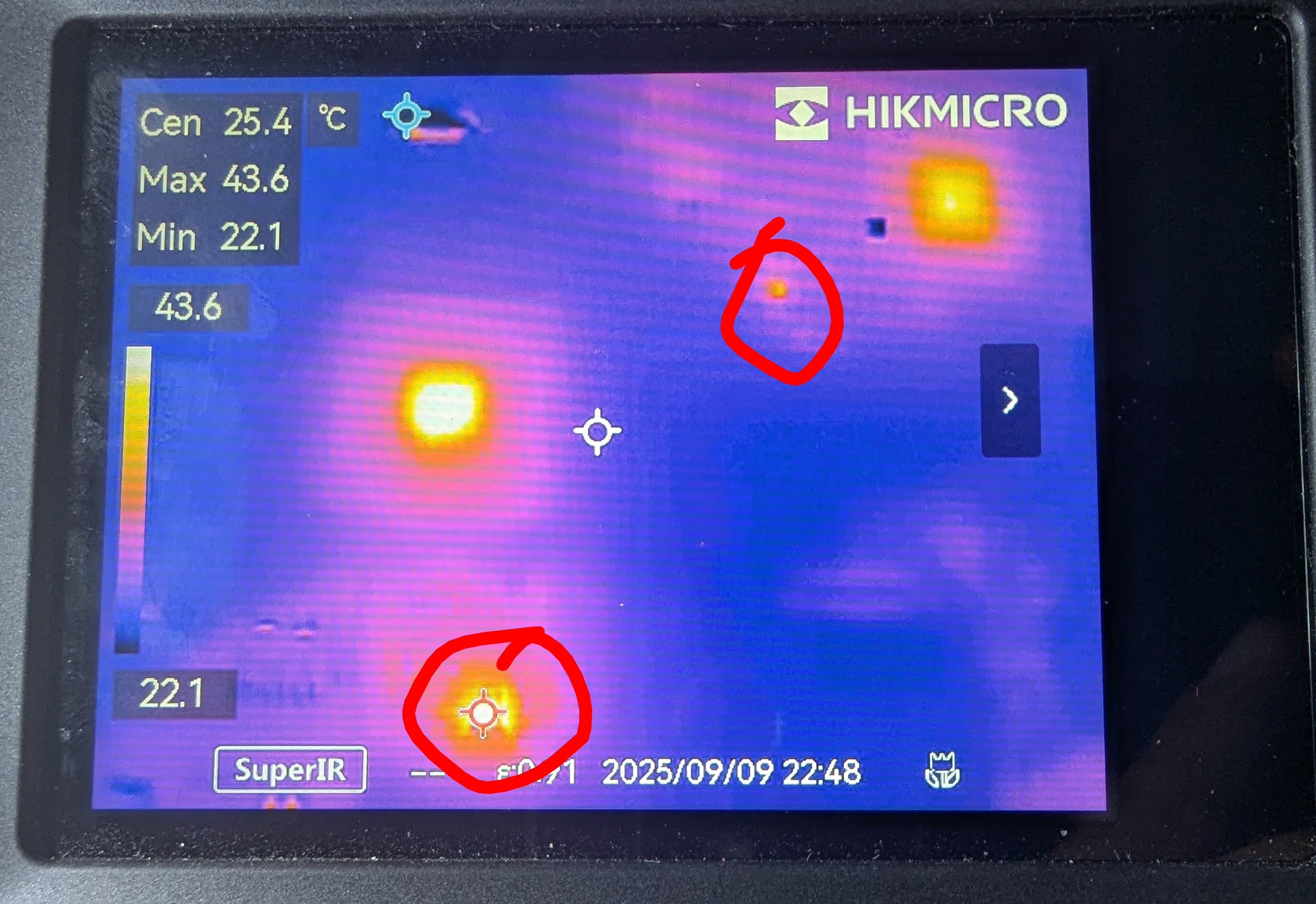

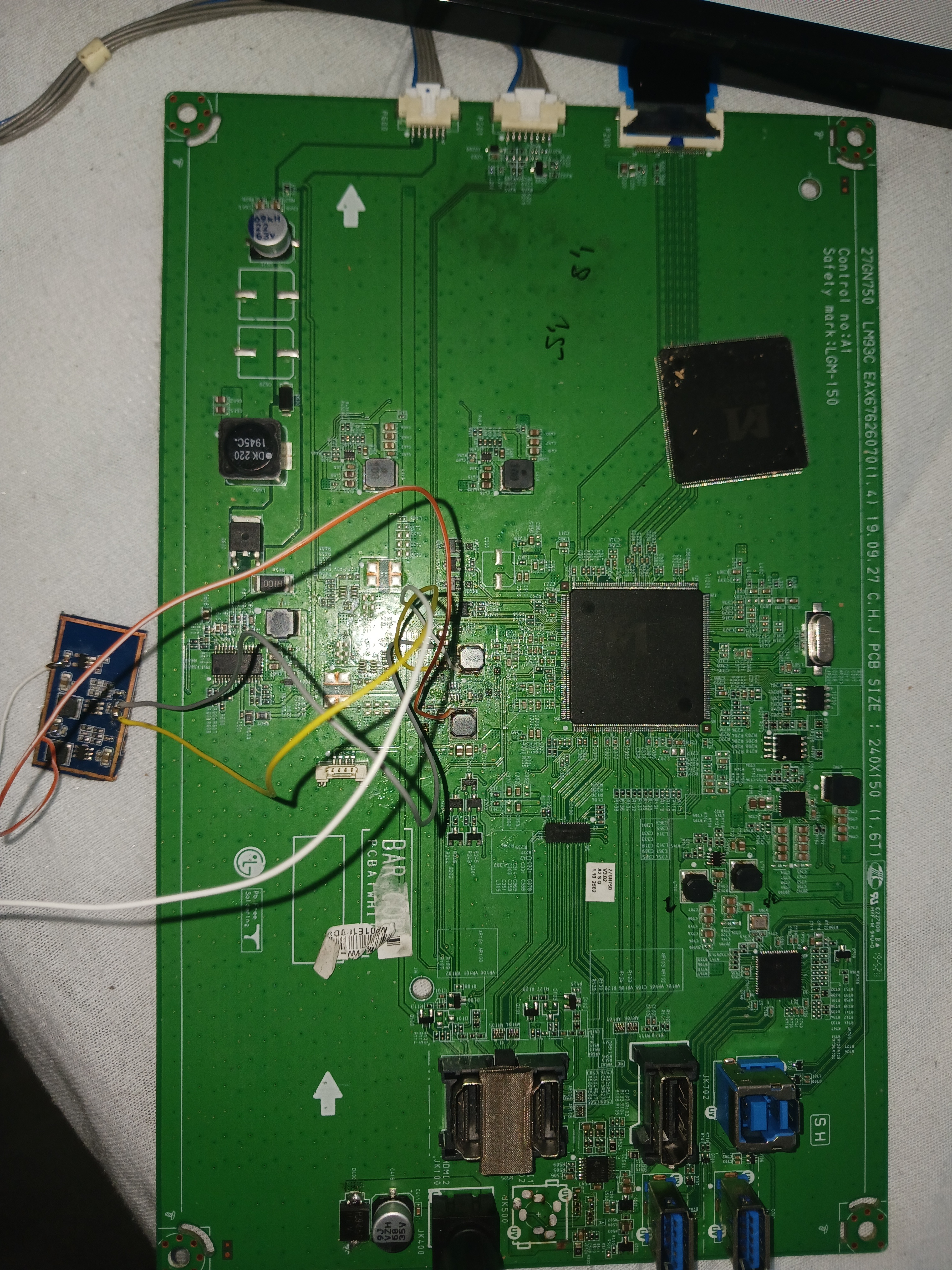

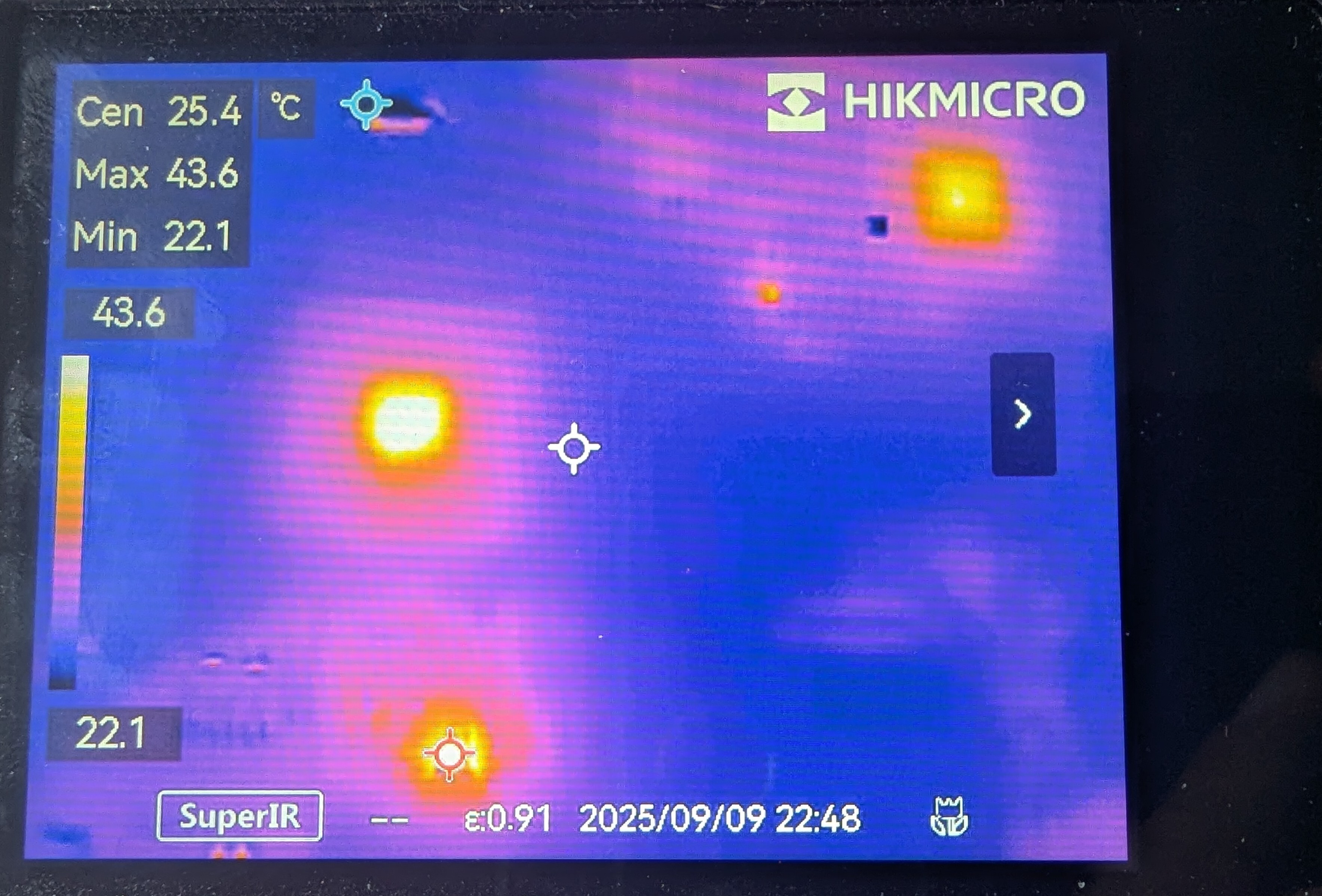

                            my 27GN750 also died. The board shows 4 hotstops.
                            IC202 (CPU), IC701 (marked TUSB8041I) and both buck converters close to the two bigger chips. The one under the CPU in my pic is the biggest hotspot. Would you change the converters before changing the CPU? Around 40c on the CPU doesn't seem too hot since it also has a big cooling pad.
                              Well, 40 degrees on the processor doesn't mean anything (this is a normal temperature, when it works its temperature is even higher), it's the processor that should be heating up, you need to check the voltage and resistance on these inductors relative to the ground.

                                #115
                                Thank you for your help. I had too much focus on the thermal cam. I found L407 (in by board L408) short. Removed the inductor and got 24 ohm back. So should be fine for a low voltage rail? Short on converter side stays.
                                • dbuergi
                                  • Jul 2024
                                  • 139
                                  • Deutschland
                                  #116
                                  Working again! I replaced IC402 and IC700 and got a standby LED.
                                  Just in case anybody else has this fault. All components in my thermal pic have around 45c with the CPU beeing the hottest spot.
                                  But the fault is caused by the buck converter.

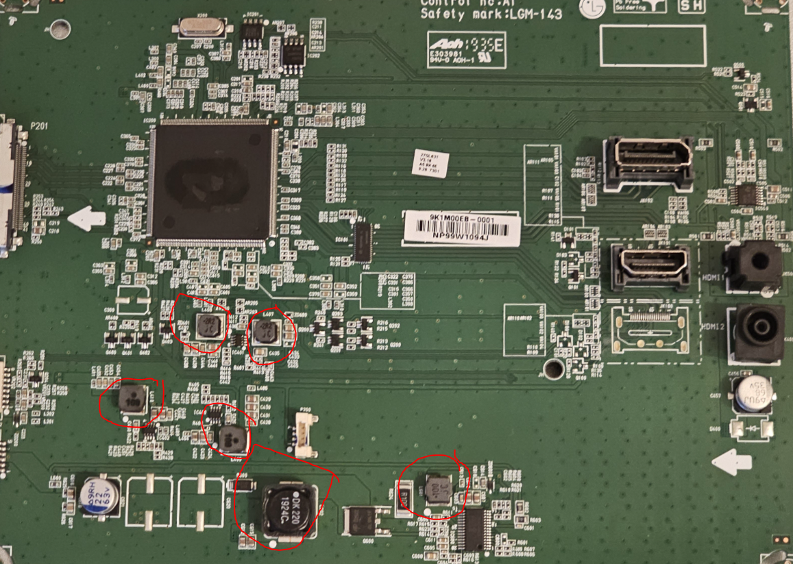

                                      LG 27GL63T-B - EAX68524502(1.1) - IC401 = IAKXM. L407 - 1v2 and L408 - 1v8. Shorted to GND on L407, but only when you plug it in, not always. I used LM1117 for 1v8 and an ups from Aliexpress for 1v2. It's not the only one that i repaired this way (when was about IC401), so you can trust this method.
