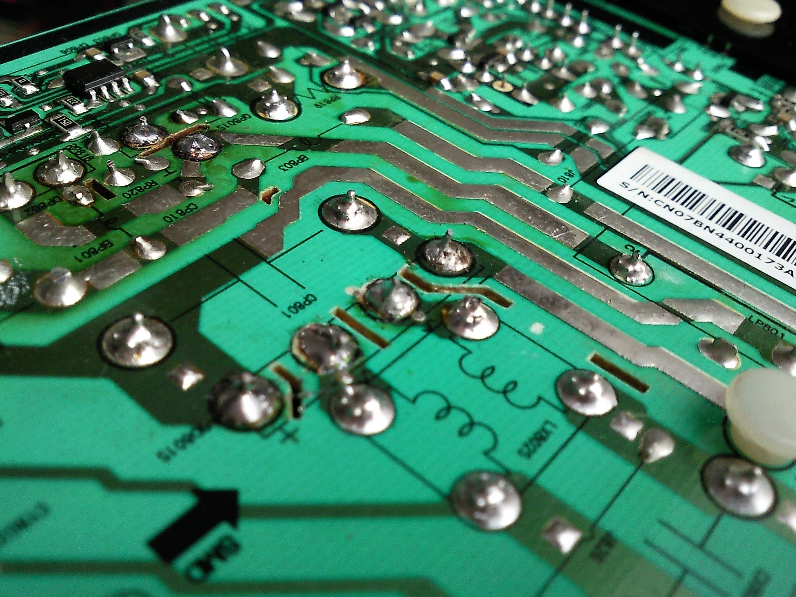

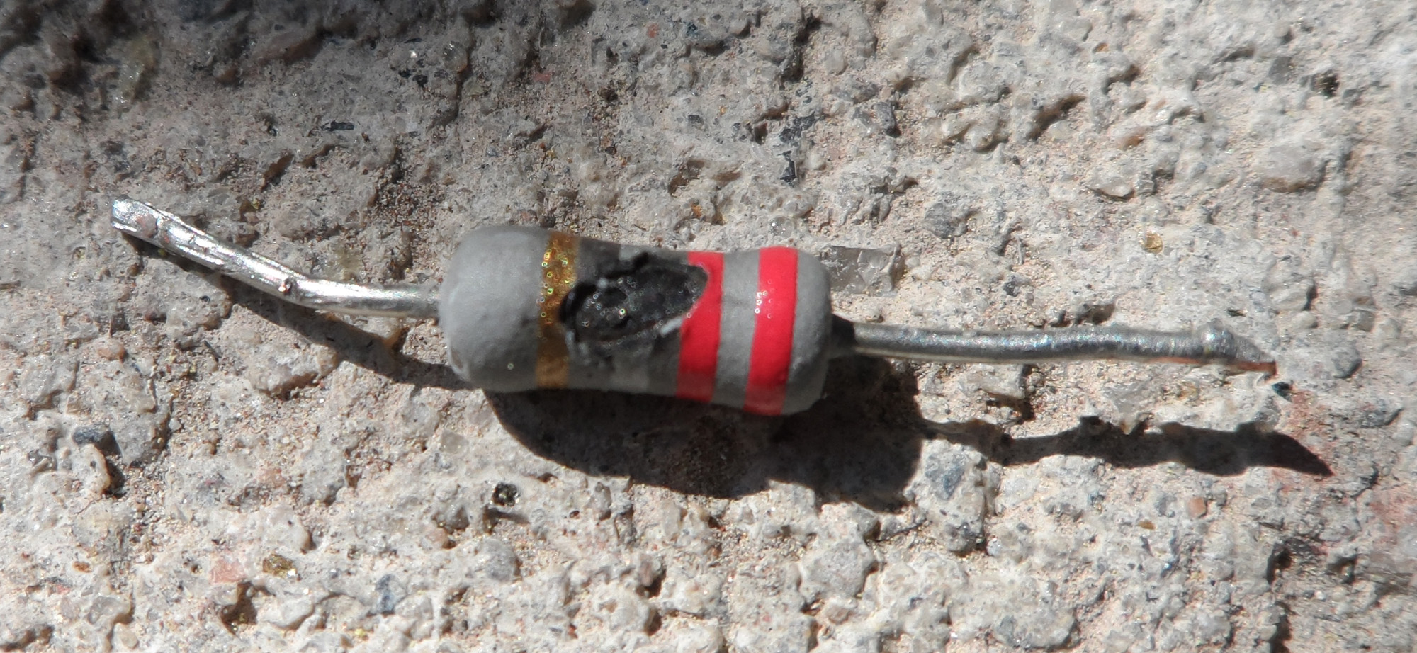

            First of all thank you all for posting and thank you operators of this site... marvelous job everyone... I have 3 of these 245BWs with 173A PS, one stopped working with same symptoms as OP described... I changed all the caps, except the big one, and the 3 resistors as described by some of you and no success.... so I took it apart again removed all the caps, except the big one, LOL and measured the values, they all checked fine on the plus side (slightly over posted values)... then I checked the big cahuna CP803 82uP 450V and it read low so I removed it and measured again, showed 71uF so I figured that could be it...
            ordered new one and while waiting I looked closely on the PCB around the area of the CP803 an noticed some gray traces coming from under the RM801... measured it and it is blown open... had I not removed the big CP803 I could not see the damage so I got lucky by being persistent... that area between the resistor and big cap is impossible to see without removing the resistor or the cap... attaching photos of the area... and the hidden damage... the resistor looked fine from the top, only after removing it you can see the blowout... LOL
            I do have a questions however, this .22 ohm resistor is fusible? meaning it will blow to prevent more damage to surrounding components? function sort of like a fuse with assigned resistance? what should I replace it with if I can't find exact replacement, since I do not know the wattage? and what other components could have been damaged by the blowout if anyone knows? thank you
            so as they say, you never know which little 50c part will fail, best to look real good all around and test as much as possible all the components, may save you a bit of time and headache in long run... good luck all...

              Greeting everyone, seems I was a bit too optimistic while replacing damaged parts...
              My monitor is 245BW, PS boars BN44-00173A is bad… replaced the 3 resistors and all caps including 82uF CP803 and the blown fusible resistor RM801 but when I plugged the monitor into outlet I heard a big pop and few small pops... RM801 .22ohm 1w resistor blew again.... what I need help with is - what other parts should I check to find the short thats causing the RM801 to blow...
              I am not good at all reading the schematic diagrams... so if anyone has experience with how to trace the components and finding what parts are in line that need checking please let me know... I am good at some testing if guided properly and in replacing parts, just don't want to replace all parts, only the part(s) that is(are) shorted... or should I just buy a new(repaired) PS?... BTW, I read this thread and many others but could not find just the right answers...
              I am attaching pictures, really could use help with this one
              thanks

                            One more question, should I order fusible resistor for the RM801 or is any .22ohm resistor considered fusible... markings are the same - Red Red Silver Gold...
                            thanks
                              Re: Samsung Syncmaster 245BW
                              MOX (Metal Oxide) Flame proof power resistor can be used, when 0.22 Ohms connected across 380VDC due to shorted load, it will go open for sure without flame, so consider it as fusible, main key point is that it is flame proof.
