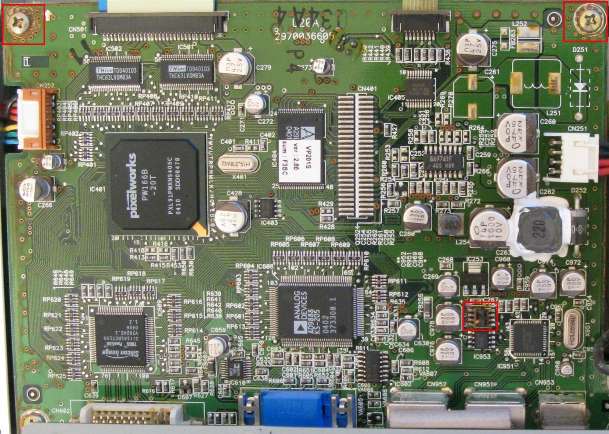

    Viewsonic VP201s powers up to a black screen (green power LED is on).
    Cracked open the monitor and found the following:

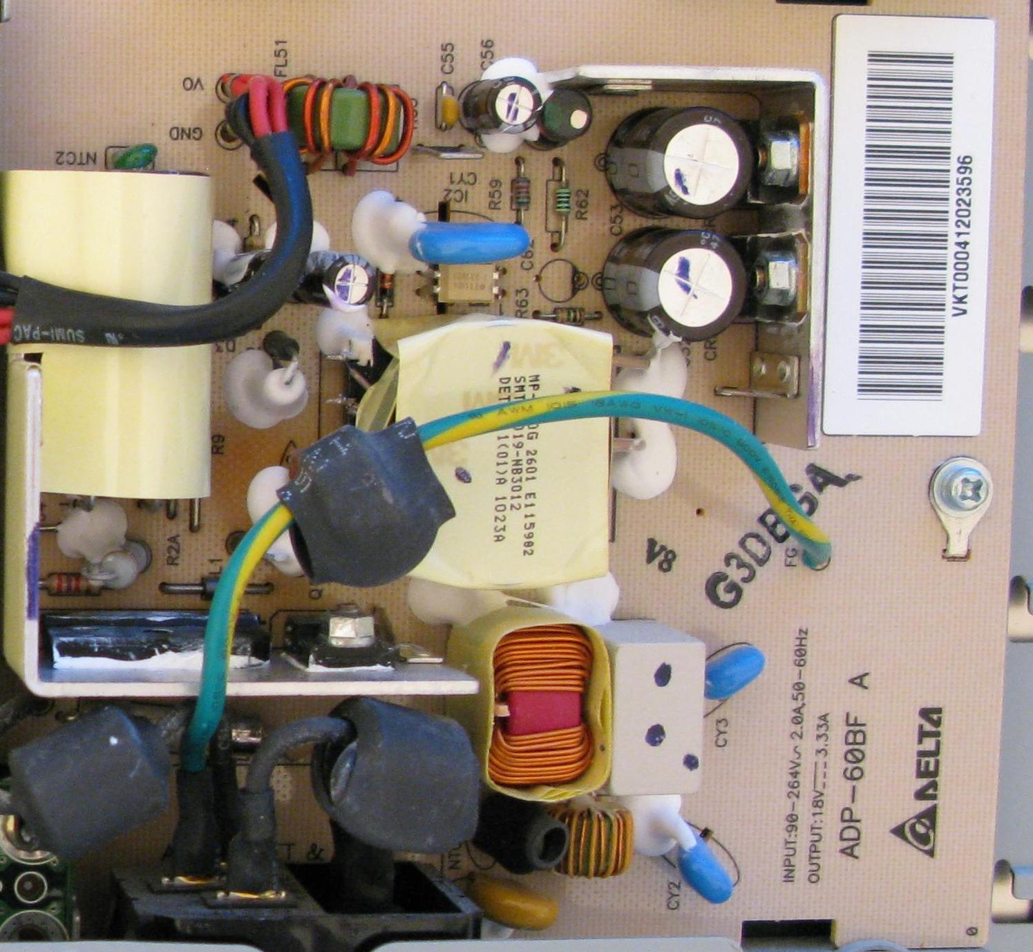

    1. Power supply area seems fine, Nichicon caps. None that I can see are bulging or leaking. Did not test output voltage levels of the power supply (18V).

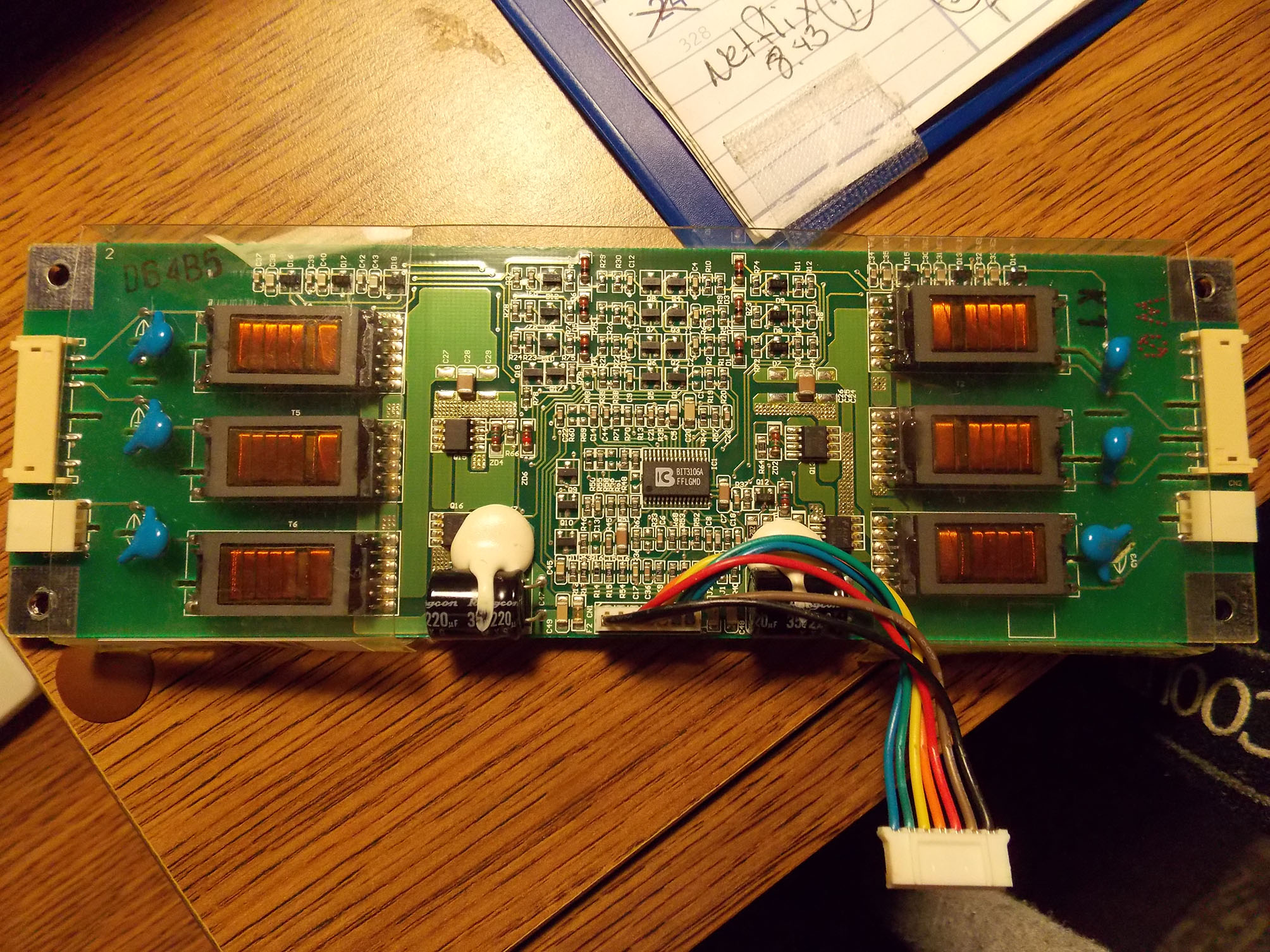

    2. Tested the inverter fuses, and found F1 to be blown (F2 was OK). Local shops don't carry 63V/2A surface mount fuses, but did have a 2A pico fuse that I can solder in its place. The caps on the inverter board are Rubycon and physically appear to be fine.

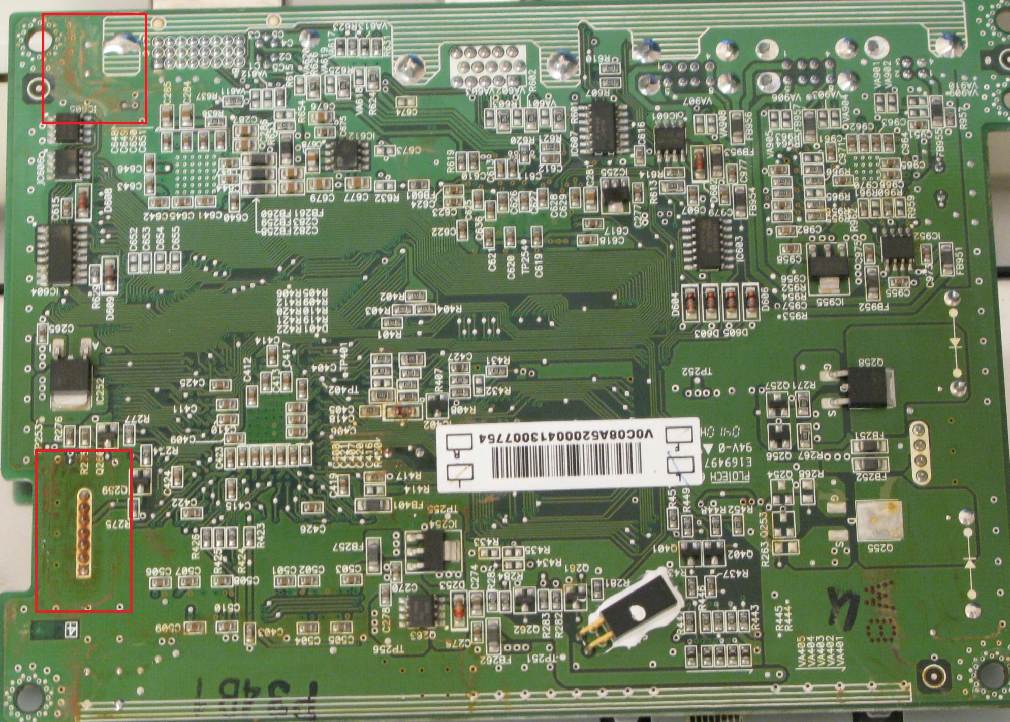

    3. In the mainboard area, there is a lot of what looks like some sort of rust-colored substance (maybe corrosion?). I've highlighted in red areas that seem to be the worst, like around the screws and IC954. I haven't taken the board off to check the bottom to see what that looks like yet to find the source.
    I'll post back later with more details, but if anyone has suggestions on what the substance could be in the picture, I'm interested in finding out what caused F1 to blow in the first place to prevent it from occurring again (even if replacing the fuse ends up working). Thanks for any input.

    Update: The bottom of the mainboard is more of the same rust-colored "corrosion" that can be scraped away by fingernail. It's particularly concentrated around the connector to the inverter and also by the DVI connector (marked with red rectangle). Guidance on the direction to go to troubleshoot this would be great, unless I should just replace the fuse and fire it up! Looking at IC954 (first picture above), I'm going to guess this is a big problem and it likely needs to be replaced (it's virtually covered in the rusty stuff).

      The inverter fuse blowing for no obvious reason is fairly common on these monitors. I used a variable power supply to apply power slowly before replacing the fuse. Alternate approach is to check for shorted transistors before applying power.

        Also clean the corrosion-like brown thing as it can cause problems.
        Resolder the inverter's transformer and all suspected points on the inverter.

          Clean your board with alcohol, an old toothbrush and a rag.Soak the rag with alcohol and place the rag over the board and then gently brush on top of the rag clean the board where you have soak the alcohol. repeat if necessary. your board will be nice and clean looking !!!

              Chalk up another success story! Replaced surface mount fuse F1 on the inverter and it fired right up. The replacement fuse part I ended up using was Digikey P/N F1457CT-ND, which is a Littelfuse 0466002.NR 63V 2A Fast Acting 1206. The toughest part was getting the darn thing open (that, and waiting 4 days for the parts to arrive!)

                  Hi - The fuses will be marked F1 F2 on the inverter board, If you post a picture of your board I can mark them on it for you.

                    The intermittent Power off, could either be Power Supply OR main Board,so you will need to identify which one is Faulty, as you have 2 of the same type,then by switching over the working inverter board,and then substituting the Power Supply and Logic in turn you can identify the fault down to the correct board,and then move on from there.

                      Is this the board you have? The Green PICO Fuse.

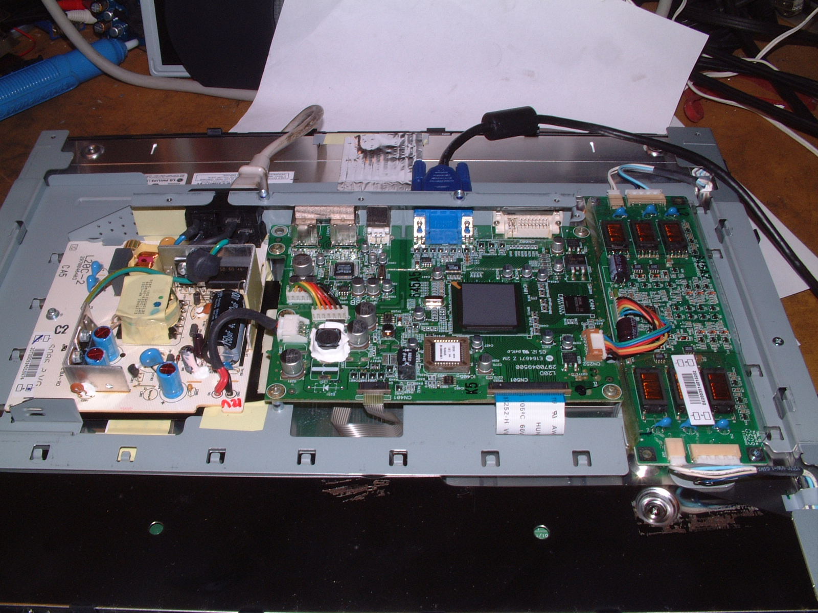

                        Gentlemen - Thanks for the quick replies. I'll need to get the bad inverter board back from an acquaintance that was looking it over so I can take some photos, but it appears to be the same board that is seen in Budm's pictures. Is the fuse that is the possible problem the green component on the left side of the board?
                        Budm - Great shots of the case dis-assembly and the components. I figured out how to open the monitors with no damage myself, but if I had seen your pictures they would have spared me a lot of apprehension.
                        selldoor - I do have an inexpensive multimeter. Will that work?
                        Rtech - I switched the inverter board from the unit that was having intermittent power problems to the unit with the bad board. Now that monitor is up and running and is not shutting down. It appears that the intermittent problem is not on the inverter board as you imagined. I'll have to do some more testing with the second monitor, but how difficult is it to diagnose a problem with the power supply or main board and fix it? Will the expense mean it would be wiser to retire it?
