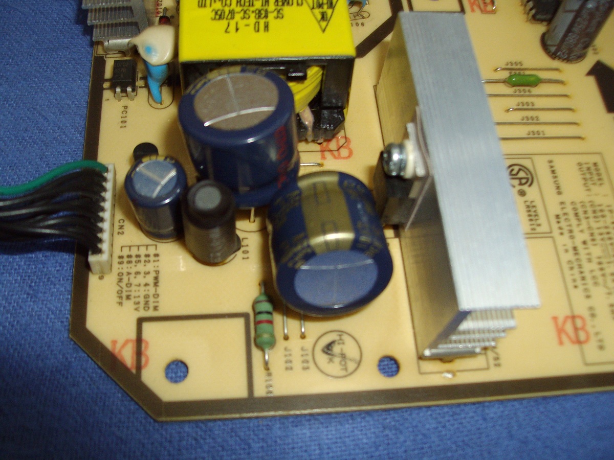

              Hey,
              i got the same problem!
              I life in Germany and i cant find a 820uf 25v cap on the german net to buy.
              Is there an other option to fix the 226bw? could i just use 2x 820uf 35v or 2x 1000uf 25v.
              I found the little 330uf 25v. ( http://www.conrad.de/ce/de/product/4...45812&ref=list )
              The 2 other caps (680uf 25v are looking perfekt)(but there available)

                Originally posted by Badcappy
                Hey,
                Is there an other option to fix the 226bw? could i just use or 2x 1000uf 25v.
                2x 820uf 35v if they fit (height) will be fine.

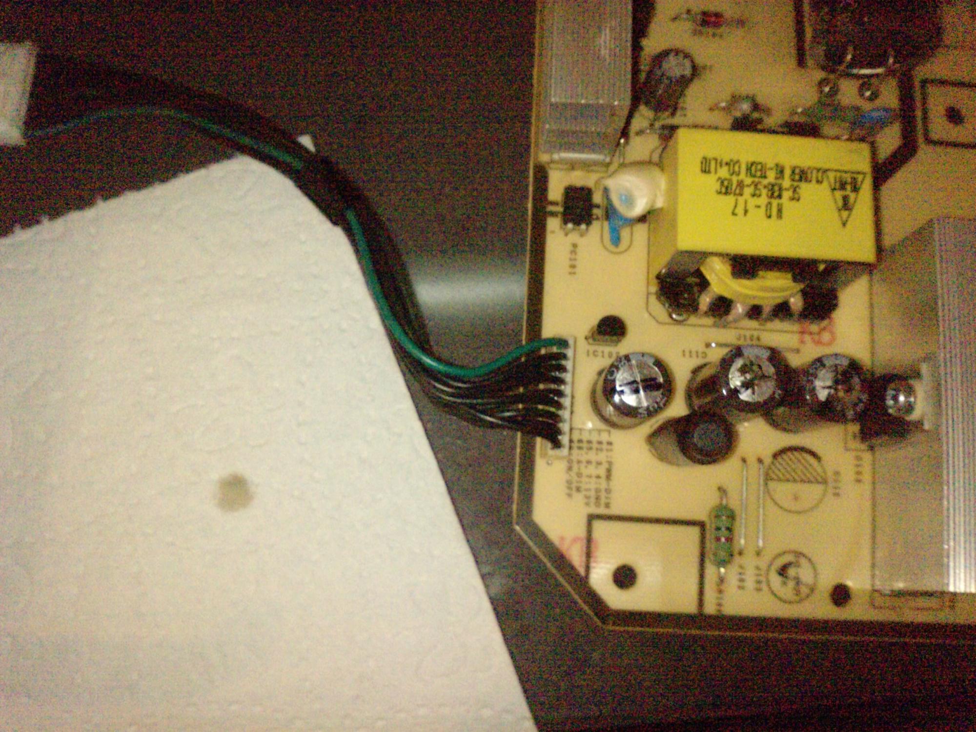

                  #228
                  Re: Samsung SyncMaster 226BW
                  Thank you guys, thank to you i saved 150 euro for a new display!
                  Here are some pics.
                  Dont be to rude on me, this was my first recapping.
                    you could have used 16V caps instead, as they're on the 13V rail.
                    http://www.reichelt.de/?ACTION=3;ART...91;PROVID=2402
                    oh and by the way.. just goes to show how expensive conrad is in comparison.. (same cap, same values)
                    http://www.conrad.de/ce/de/product/421932/
                    the output voltages are printed on the PCB
                    https://www.badcaps.net/forum/attach...4&d=1296137292

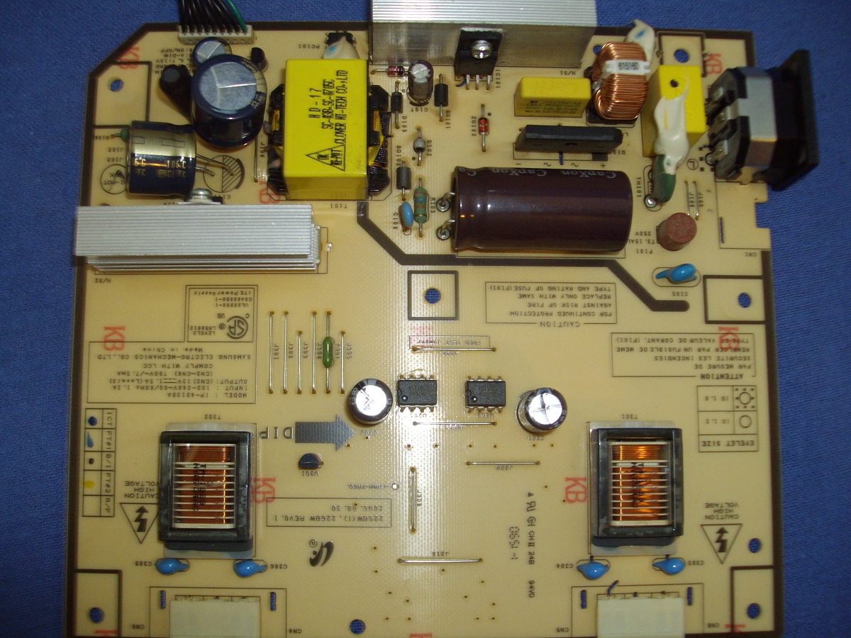

                        Hello all,
                        Another Samsung 226bw with bad cap problems. It has been ongoing for a few months but I've not had the time until now to try and fix it. Yesterday it took 3 hours for the monitor to finally warm up so that was the last straw. Opened it up, figured out which caps I had and what to replace them with from the info contained in this helpful thread.
                        I just placed an order at mouser.com for the following:
                        Mfr. #: 1 x EEU-FC1H2R2
                        Desc.: Aluminum Electrolytic Capacitors - Leaded 2.2UF 50V ELECT FC
                        Mfr. #: 1 x EEU-FM1H220
                        Desc.: Aluminum Electrolytic Capacitors - Leaded 22UF 50V FM RADIAL
                        Mfr. #: 1 x EEU-FC1H470
                        Desc.: Aluminum Electrolytic Capacitors - Leaded 47uF 50V
                        Mfr. #: 1 x EEU-FM1E331
                        Desc.: Aluminum Electrolytic Capacitors - Leaded 330UF 25V ELECT FM
                        Mfr. #: 5 x EEU-FM1E821L
                        Desc.: Aluminum Electrolytic Capacitors - Leaded 820uF 25V ELECT FM
                        Decided against replacing the big 150uF cap at position C105 as it looks to be in fine shape, and considering only replacing the five 820uF and one 330uF caps as they are the only ones that are bulging at the top... ordered the rest just in case.
                        Picture of my board below.
                        Will post with results when I complete the repairs. This is my first time soldering anything, wish me luck!

                                            Samsung SyncMaster 215TW buzzing / lightning in power board socket
                                            by nh2
                                            This is my first post here. I just fixed my first 2 broken displays by replacing broken capacitors (Samsung SyncMaster 226BW, and Samsung SyncMaster 213T). But I have a third one I'm unable to fix, and am eager to fix as well:
                                            My Samsung SyncMaster 215TW makes a buzzing / hissing sound when turned on.
                                            The sound is louder the brighter the monitor is, e.g. in the "Game" preset is is even louder than in a softer preset.
                                            Opening up the monitor and unplugging the small socket cables that run from the power board to the LCD, I can see a small blue...
