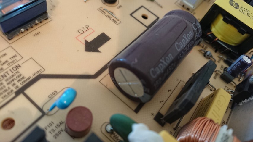

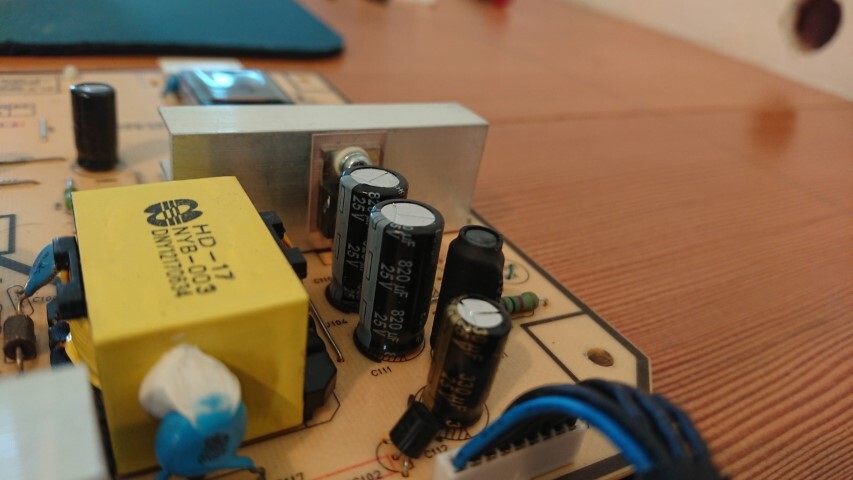

    I am working on repairing this Syncmaster 225BW for the second time. I don't remember if the symptoms were the same, but the first repair was replacing the caps of course. This time the monitor turns on for a couple seconds then goes black, but think I can still see a faint image. The power button does not seem to work, it just stays lit. Took out the power / inverter board and the tops of the caps seem completely flat. I do not have intuition about testing with a multimeter so was thinking of just replacing a part. I read somewhere that when the screen is on without being backlit, the inverter could be bad. Found a power / inverter board here, and am wondering if this could be a likely fix.

        the coils went bad on some inverter boards . also those blue caps .inverter receiving power ?

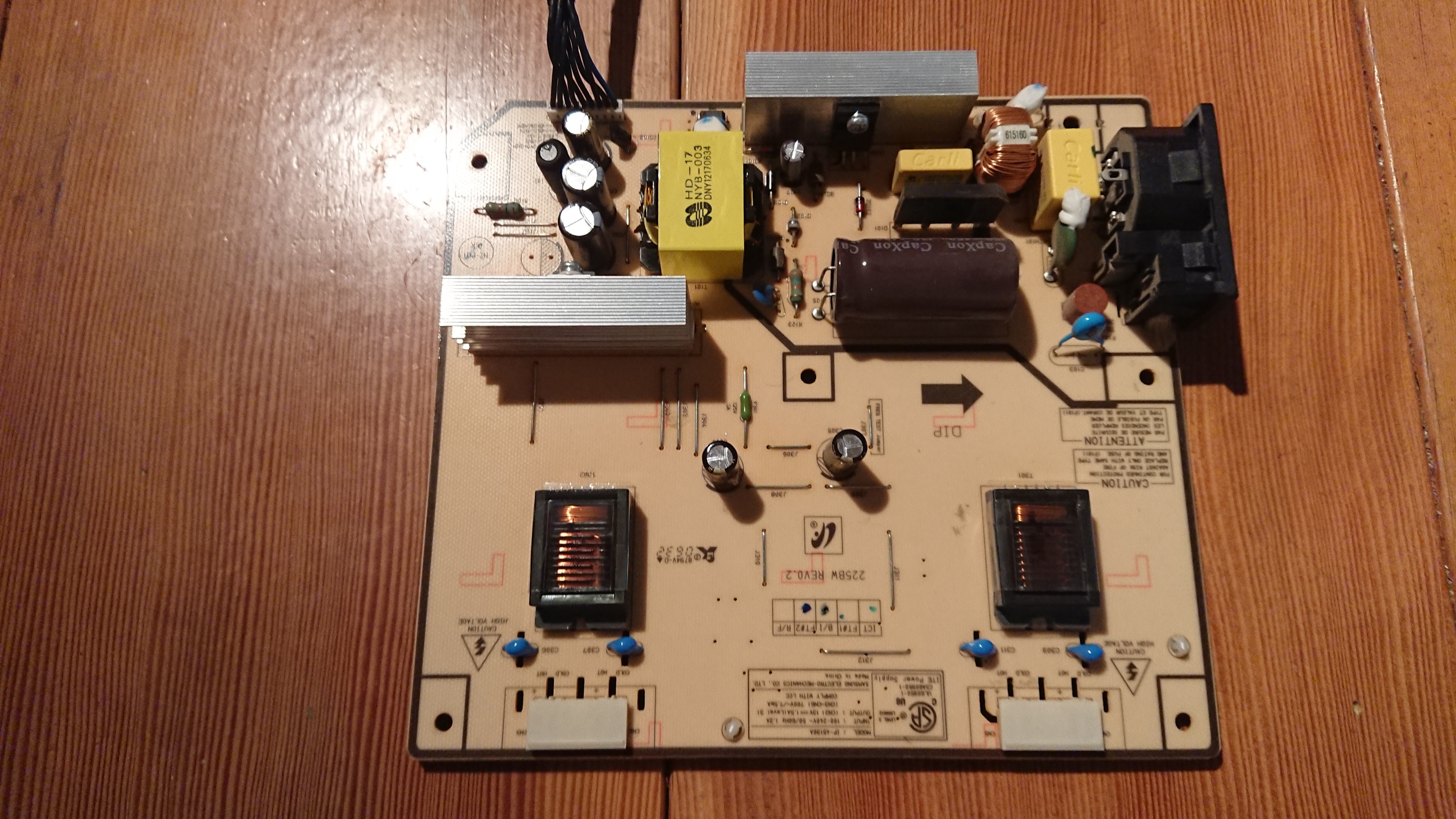

            its been a long time since i was repairing ccfl so i can't remember . post a pic of the whole board
            • jdfnnl
              • Nov 2025
              • 12
              are there any visual indications the coils are malfunctioning as with bad caps?
              image of whole board as requested

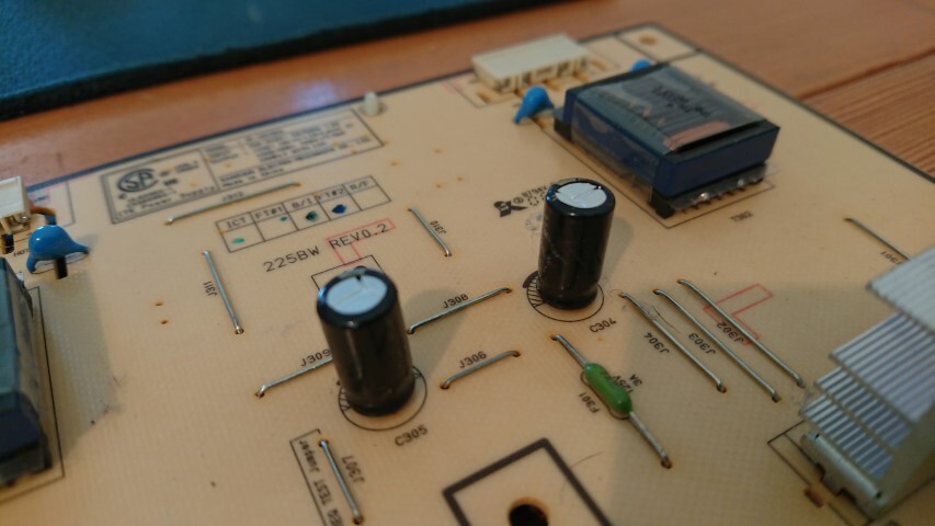

                Compare the two transformers resistance primary / primary and secondary / secondary. Note it down and ports the result.
                • jdfnnl
                  • Nov 2025
                  • 12
                  So I am not sure how to interpret the results but the primary circuit on each is 1.078 when on the 2K resistance setting, and the secondary on each measures 0.4 on the 200 setting.

                    Has that board also a back side? Look like short on secondary
                      You have your Pri and Sec mixed up, the pri is less than 1Ω, the sec. will be around 1KΩ
                      There is a way to check each ccfl simply disconnect them all and only plug in one ccfl at a time and see which one does not light, the ccfl will only light for a second before the protection circuit cuts in, but it should indicate which ccfl is bad. this will also show you if one of the transformers is not putting out any voltage as that transformer will not light any of the ccfl's
