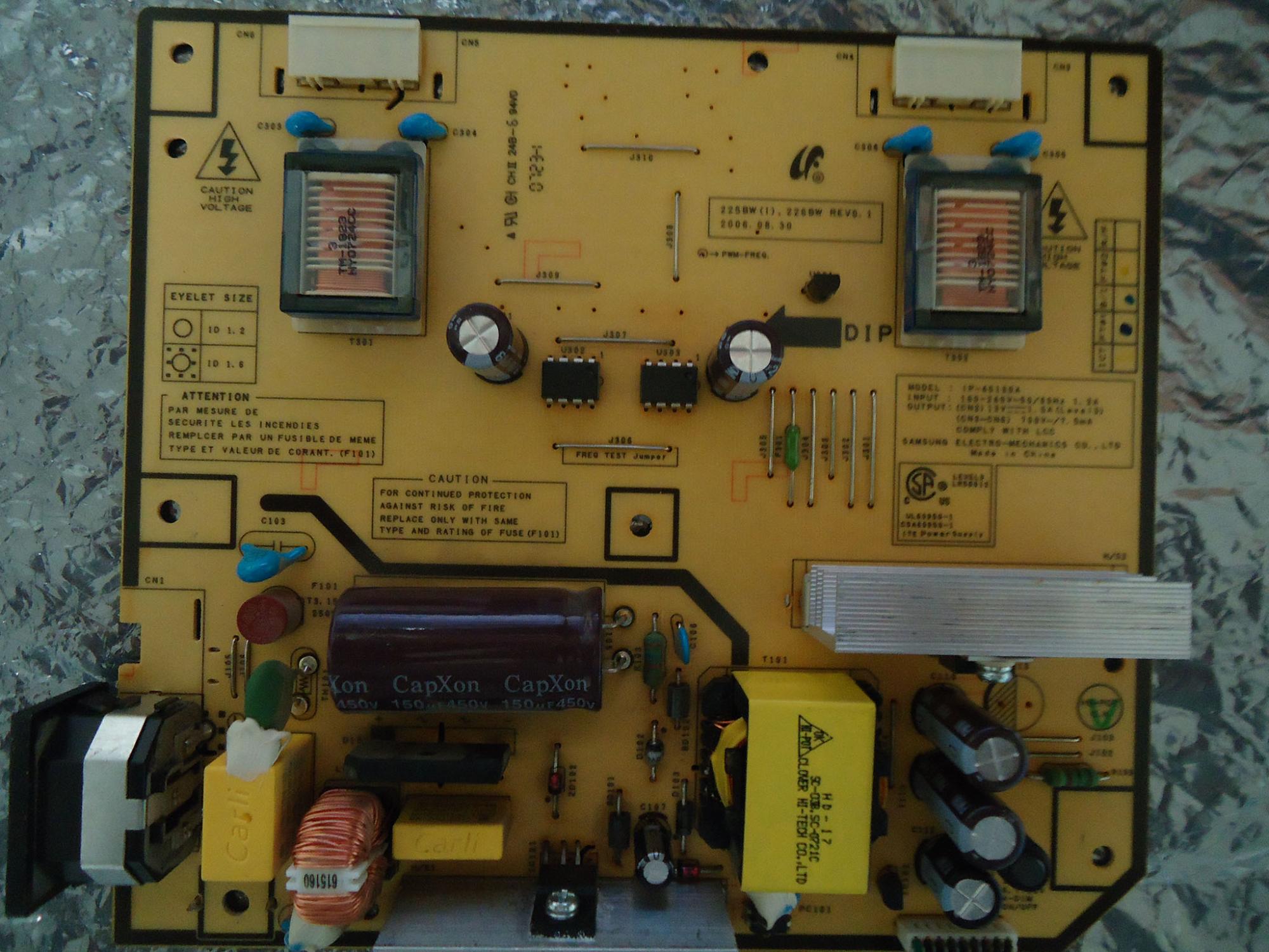

      Re: Samsung SyncMaster 226BW

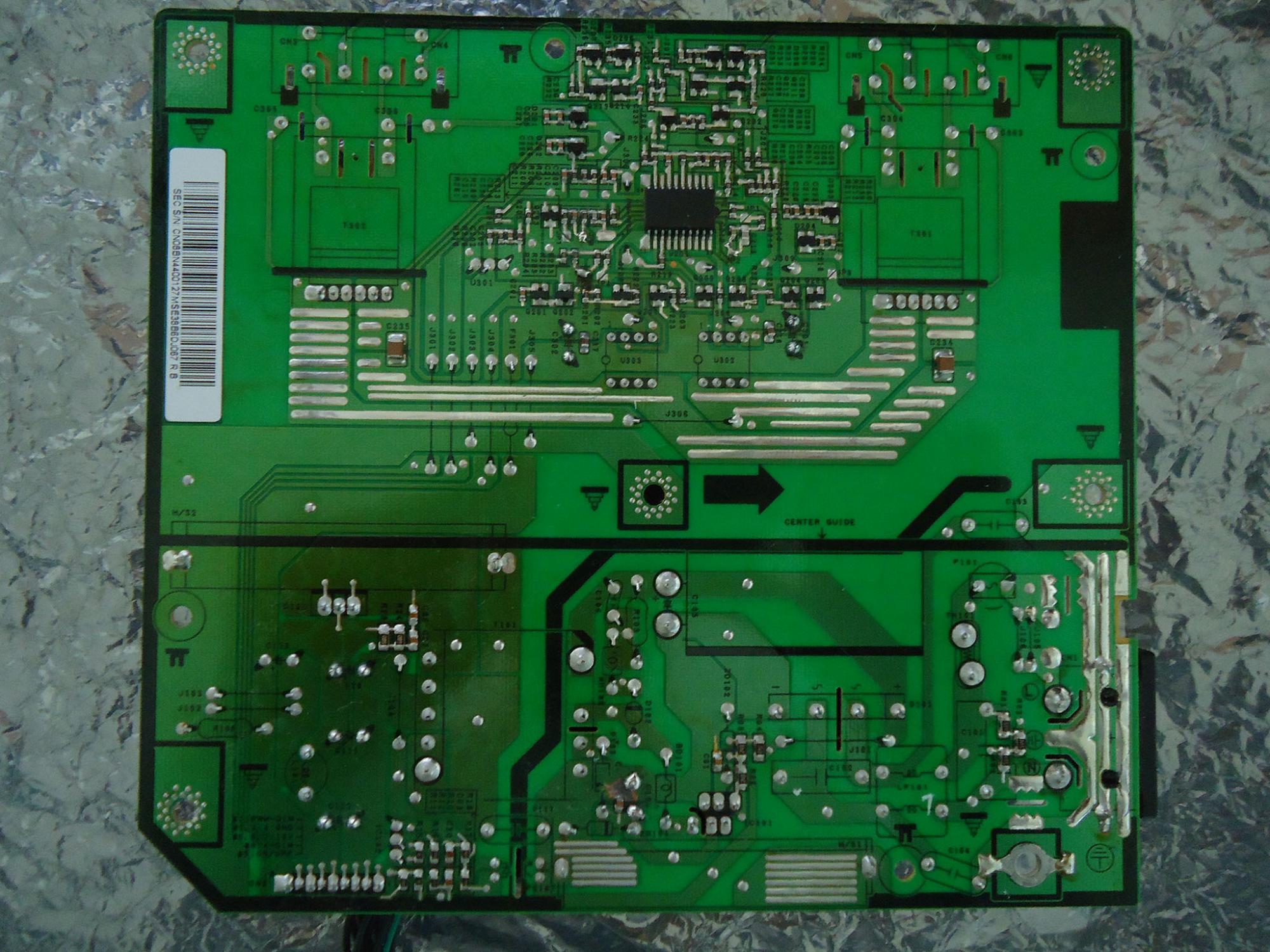

      Hi everyone,

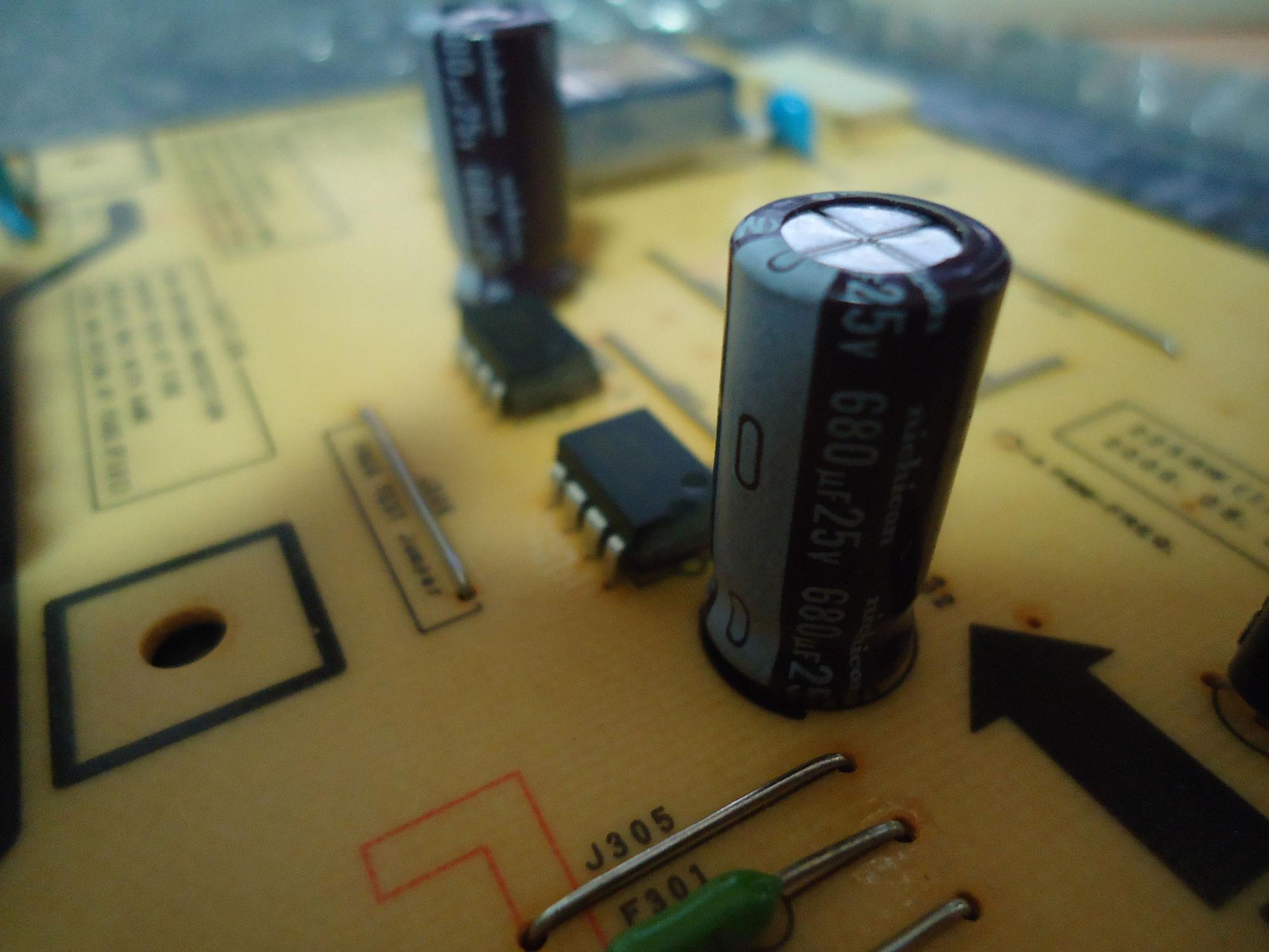

      I have a 226BW with the exact same problem, I opened the monitor and indeed there are some bad caps there.
      I ordered the nichicon caps recommended in this forum and other websites and replaced all 6 capacitors (820x2,680x2,330x1,47x1) successfully.
      I made sure the polarity is correct and all the connections (those ccfl connections) are good and in the right order.
      I closed the 226BW, powered it up, it was good, the backlight was working like new.
      However that only lasted around 5 seconds, after that it began to flicker so i turned off the monitor and then i saw a white screen (strange?)
      Now no matter what i do, the backlight just doesn't come on, however the monitor works, i can confirm that with a flash light.
      I'm desperate, any ideas or what can i test\measure?
      Thank you,
      mastertheknife.

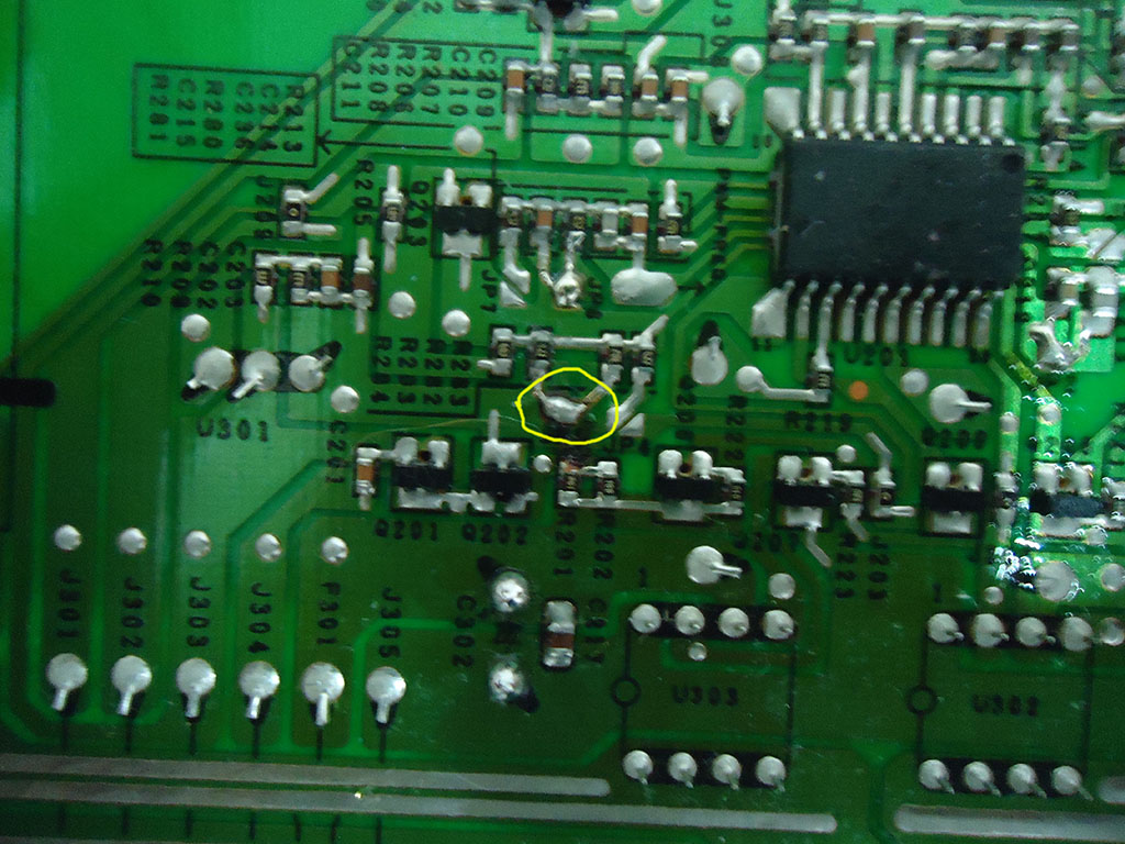

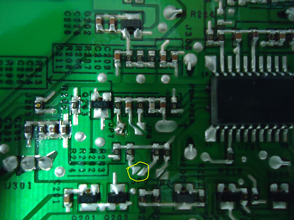

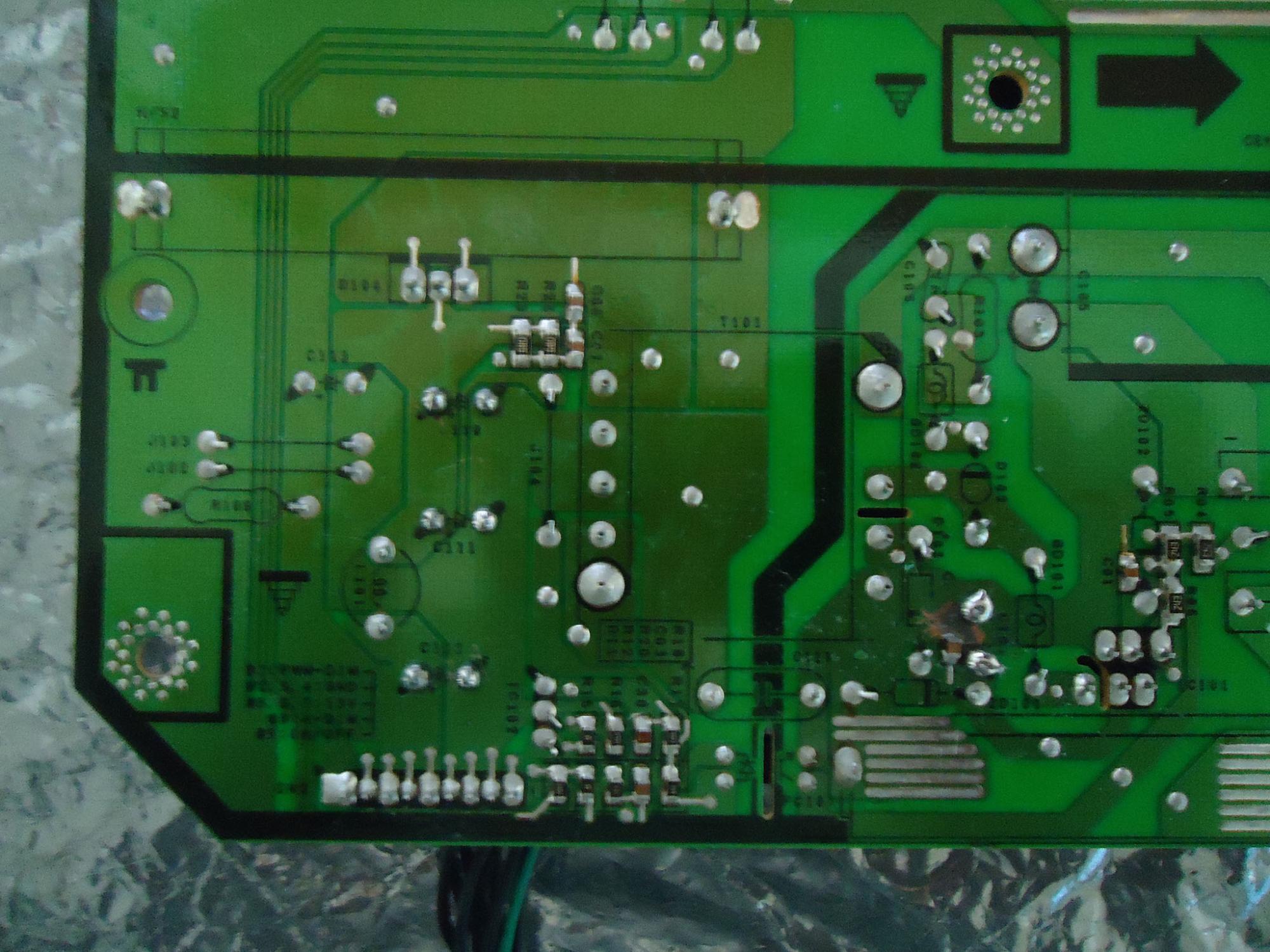

          When soldering the 47uf capacitor i accidently put too much solder, i think i might have caused a short, so i later i tried to remove the excess solder with wick, scratching the PCB a little on the way because it was almost impossible to get off for some reason.

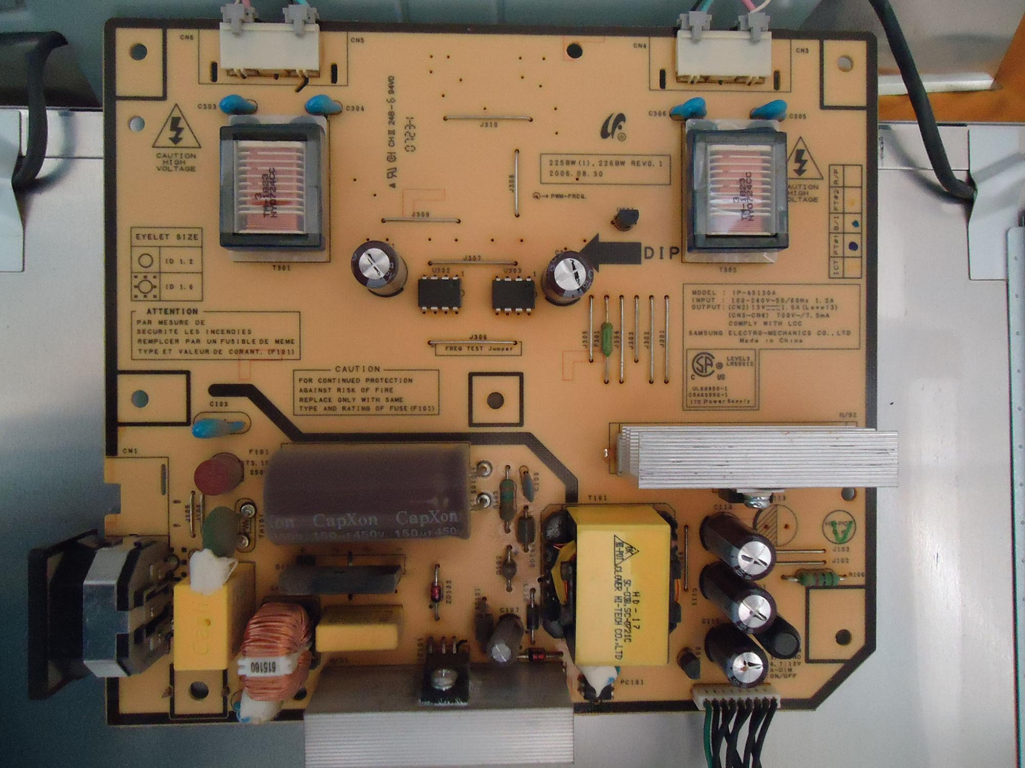

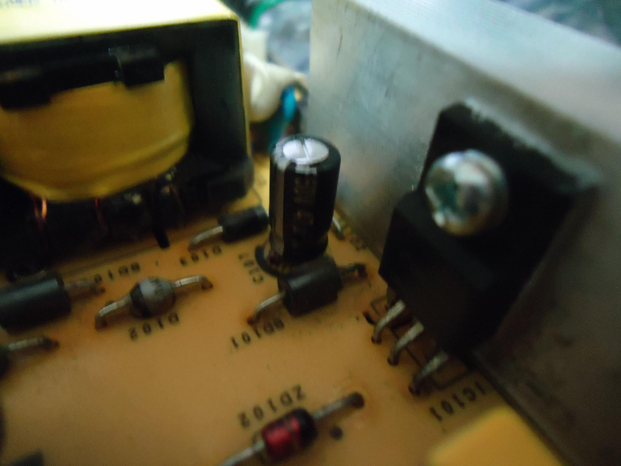

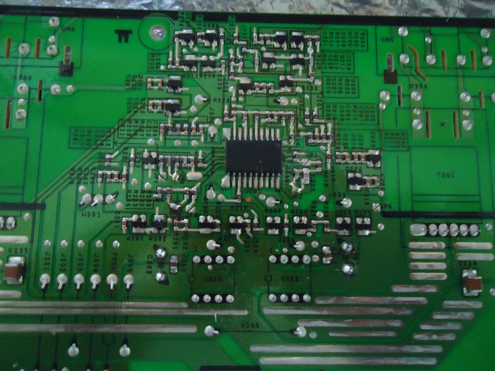

          I took pictures of the board, including the capacitors i used and the board prior to replacement capacitors.

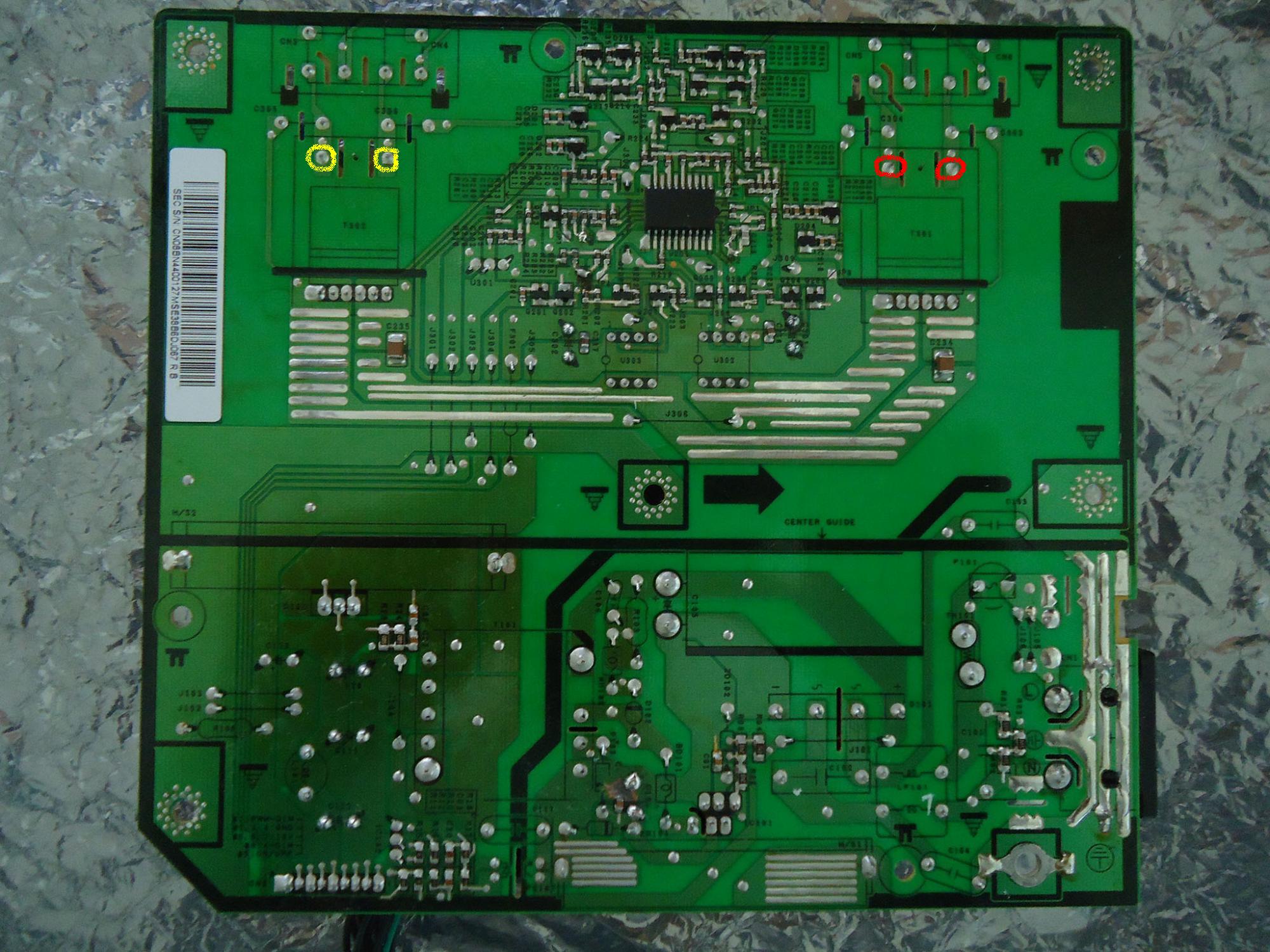

                  Changing the caps was the first step. The next is to measure your inverter transformers.
                  1) Put your multimeter on 2000 ohms (if manual).
                  2) Measure and report the resistance between the 2 yellow dots.
                  3) Do the same for the 2 red dots.

                    2) The yellow dots gives 1076 ohms in 2K mode (the multimeter actually displays 1.076)
                    3) The red gives 1089 ohms in 2K mode (the multimeter actually displays 1.089)

                      The two inverter transformers measure fine.
                      There are two 8 pin ICs just to the left of the dip arrow. I believe it is U308 and U309?
                      Look at the part number. Find the datasheet on the Internet. The datasheet should tell you which pins are source, gate, and drain.
                      Measure the resistance between S-G, S-D, and G-D. Report readings for all pins and both chips.

                        U302 and U303 are those 8pin ICs. Part number for both is AP4511GED and is a dual mosfet.

                            I opened up another 226BW (a working one) and tried its power supply board in this 226BW and the monitor worked like new, this rules out the ccfl, the panel or the signal board from being the problem.
                            both boards are identical. I tried checking things with the multimeter on both boards in order to locate a mismatch\problem but no luck in finding the problem.
                            I noticed a short in the bad board near an IC (I suppose its the inverter IC). After fixing that short and verifying with the multimeter, the backlight came on but only for a few seconds, because then it began to flicker and now its off again and power cycling the monitor doesn't bring it back on (just like before fixing the short).
                            The white screen for half a second still happens when the monitor is off, i noticed that the white comes from the center of the screen and then spreads to the corners.
                            This doesn't happen with a good power supply from another 226BW.
                            Can it be the new capacitors? can it be my bad solder near the 47uf cap?
                            Any ideas\clues?
                            Thanks, mastertheknife.

                                    • Jan 2011
                                    • 51
                                    #137
                                    I found something interesting, i found how to reproduce the backlight working and the white screen:
                                    If i discharge all capacitors on the board (by shorting them with a flat screw driver) and then plug in the monitor, the backlight is on and i see a solid white screen. If i hit the power button to turn on the monitor the white screen disappears and then i see the monitor searching for source(analog\digital thing - it was unplugged) and after few seconds the backlight flickers and then turns off (however the monitor still works, can confirm with a flash light).
                                    So it appears there are 2 problems:
                                    1) The logic board doesn't keep the panel off when it needs to be off (monitor off), this is probably the reason it displays a white screen, however, it didn't happen before replacing the capacitors and doesn't happen with another power supply from another 226BW.
                                    2) The backlight works if i discharge all capacitors, but only for about 5 seconds, then it begins to flicker and after 2-3 seconds the backlight is off.
                                    I took out the 47uf capacitor and put the original one back in, no luck, same problem.
                                    Ideas\clues are welcome,
                                    mastertheknife.

                                      Originally posted by jetadm123
                                      Looks like the voltage output of the power supply is stamped on the board, but I can't read it.
                                      Thats correct, on the board it says:
                                      MODEL: IP-45130A
                                      INPUT: 100-240V~50/60Hz 1.2A
                                      OUTPUT: (CN2) 13V (DC) 1.5A (Level3)
                                      (CN3~CN6) 700V~/7.5mA
                                      You also mentioned that you cleared a short near some IC. Why do you think it was a short and what IC was it near?
                                      I attached pictures of it in the good board and in the bad one. Maybe it was there, maybe i did it accidently with the soldering iron.
                                      I fixed it already but it doesn't seem to be the problem, the backlight working after that was probably because i discharged all capacitors prior to the soldering.
                                      Thanks again,
                                      mastertheknife.

                                        • mastertheknife
                                          • Jan 2011
                                          • 51
                                          #140
                                          I found a bad resistor on the power pin going to\from the signal board, on the good board it measures 91,000 ohms and on the bad board around 350 ohms.
                                          Can this be the cause of the issue?
                                          mastertheknife
