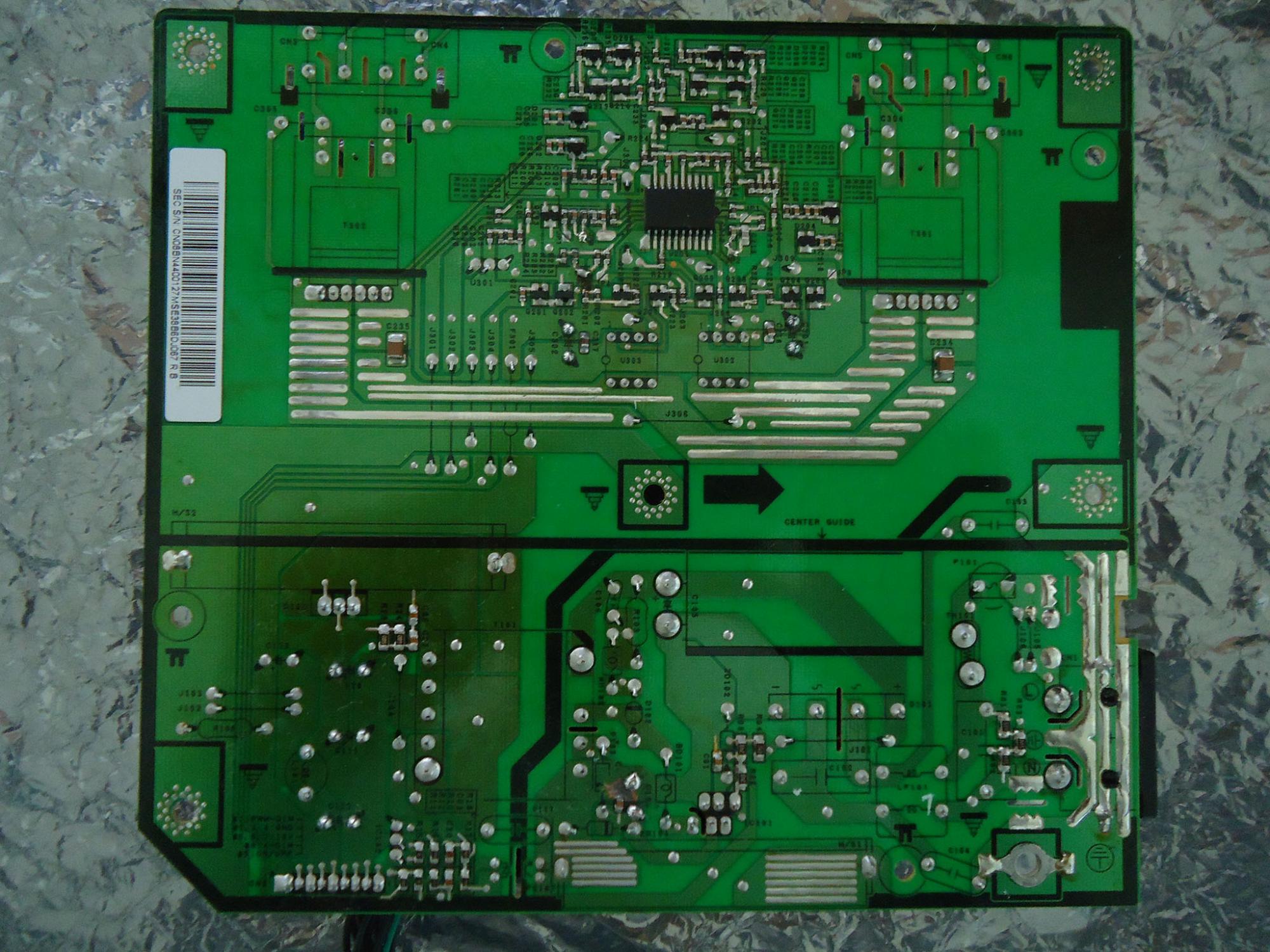

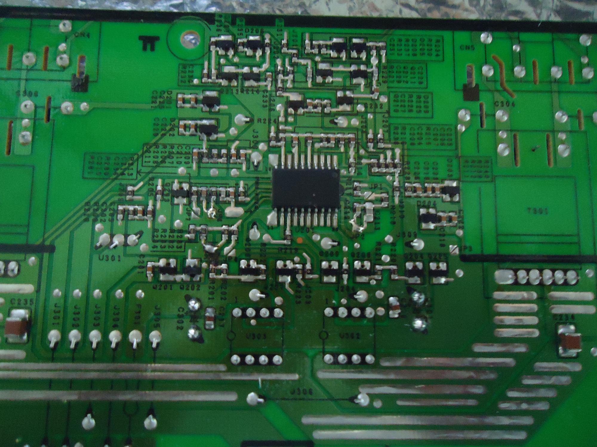

                              I will try summarize all the tests i've done in case anyone wants to join in and help, this should avoid reading the previous pages.
                              The Problem: Samsung 226BW, 2 seconds to black (backlight only) after replacing bad caps with new ones, the problem was the backlight flickering until the monitor was warmed up.
                              Sources of the problem eliminated:
                              1) The CCFLs, the panel and the logic board - Works perfectly when an identical power supply board from another 226BW is used.
                              Things checked:
                              1) Transistors for shorts - OK, no connection between any legs under 200 ohms.
                              2) Inverter transformers - OK, one measured 1094 and one 1080 ohms.
                              3) Bad solder joints - OK, Reflowed solder on pretty much every component on the board and verified all joints with magnifying glass
                              4) Backlight_ON signal - OK, signal board provides 3.94V at all times the monitor is on.
                              5) Overvoltage protection - OK, max measured voltage on OVP pin was 0.08V
                              6) Current feedback pin - OK, max measured voltage on pin was 0.17V.
                              7) Open-lamp protection - Not sure, max measured voltage was 2.7V!
                              8) Board voltage - OK, 13.24VDC stable, which is between the desired voltage of 13-13.5VDC.
                              9) Inverter section voltage - OK, 13.24VDC through fuse F301.
                              10) Inverter IC voltage - Not sure, unstable, jumps between 4.6V and 5.0V.
                              11) Fuses - OK, F101 and F301 are about 0.0 ohms
                              What i know so far:
                              -When the backlight fires up, there is a voltage drop. I measured the Backlight_ON pin from the signal board dropping from 3.94V to as low as 2.0V.
                              -Adjusting the brightness (e.g. from high to lowest) doesn't help.
                              -Monitor works perfectly when an identical power supply board is used.
                              -Putting back the old capacitors doesn't fix the problem, the backlight doesn't turn on at all with the old capacitors.
                              -Turning off and back on the monitor brings the backlight working again for a second or two.
                              -Hitting the source button also brings the backlight working again for a second or two.
                              Board: IP-45130A Rev 0.1
                              Inverter IC: OZ964GN (datasheet: http://www.alldatasheet.com/datashee...2/OZ964GN.html)
                              Pictures attached.

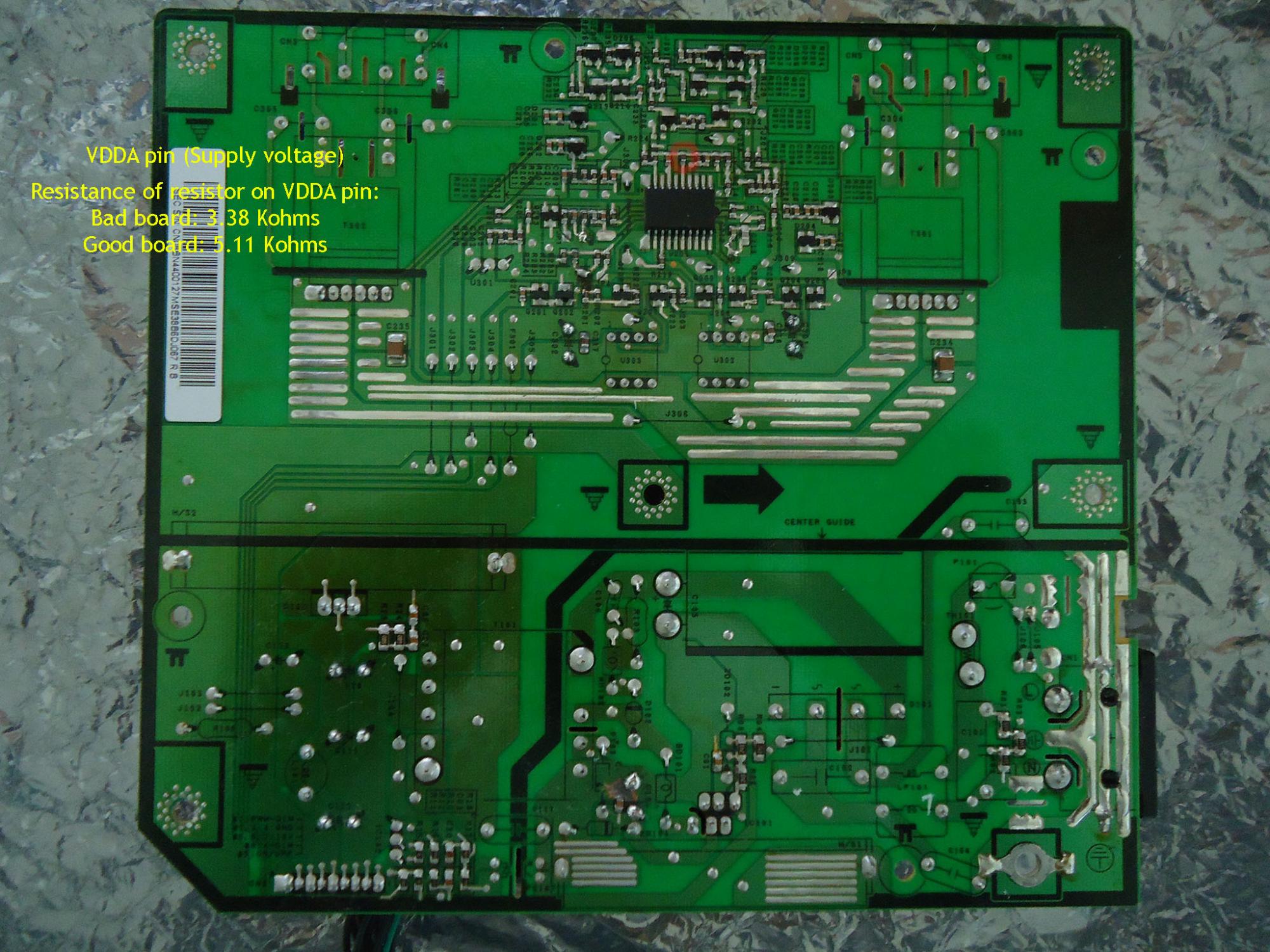

                                  I also followed the reference application in the OZ964GN datasheet and compared it to the board, the board's circuit is almost identical to the reference application but with some differences. I also measured many resistors on both boards and compared them, they pretty much all match except the one on the VDDA pin.
                                  There's something that puzzles my mind. I couldn't figure out how the inverter IC gets its voltage. The VDDA pin (Supply voltage) is attached to a resistor (5Kohms in the good board, 3Kohms in the bad) and the other side of the resistor is ground (0.0 ohms to ground). So how exactly does it get its 5V supply voltage and what steps it down to 5V from the board voltage of 13V? All i know is that power to the inverter section of the board is carried via fuse F301. I'm also worried why the supply voltage (measured at VDDA pin) was unstable, jumping all the time from 3V to 5V, mostly between 4.6V to 5V.
                                  I have attached a picture. I will try getting a closer one when i find some time and the camera's battery charger
                                  Thanks everyone for their time and willingness to help,
                                  mastertheknife.
                                    mastertheknife.
                                    Here's my guess. The power supply outputs 13V only. There's a wiring harness that connects the power board to the logic board. One of the wires on the harness is probably labeled 13V. The logic board usually requires 1.8V, 3.3V and 5V to function properly. I suspect the 13V feeds a 5V voltage regulator on the logic board, where the 5V output of the regulator is split between the logic board and the OZ964 through another wire on the harness (maybe labeled 5V?). Once you locate the 5V regulator, measure it's output to see if it's fluctuating.
                                      The logic\signal board runs off 13VDC (measured 13.24V) and theres no 5V pin:
                                      Pin1 = PWM-DIM
                                      Pin2,3,4 = GND
                                      Pin5,6,7 = 13V
                                      Pin 8 = A-DIM
                                      Pin 9 = ON/OFF (Backlight_on pin, measured at 3.94V at all times)
                                      Power to the inverter section of the board is carried through fuse F301 and i measured it to be 13.24V too, so there has to be something that steps the voltage down to 5V. Maybe its the resistor in the picutre, but why its other side is connected to ground? I'm confused.
                                      mastertheknife

                                        What is the part number for U310? It's on top of the board right above the black arrow marked "DIP"
                                        Oops! Sorry, I meant U301.

                                          You may be dealing with a multi-layered pc board, which has copper traces on different layers of the circuit board. This is used when the designer can't fit all the traces on the outer most layer. That may be why it "appears" that there's just that one resistor tied to VDDA of the OZ964.
                                          What's the part # of U301? It could be the voltage regulator.
