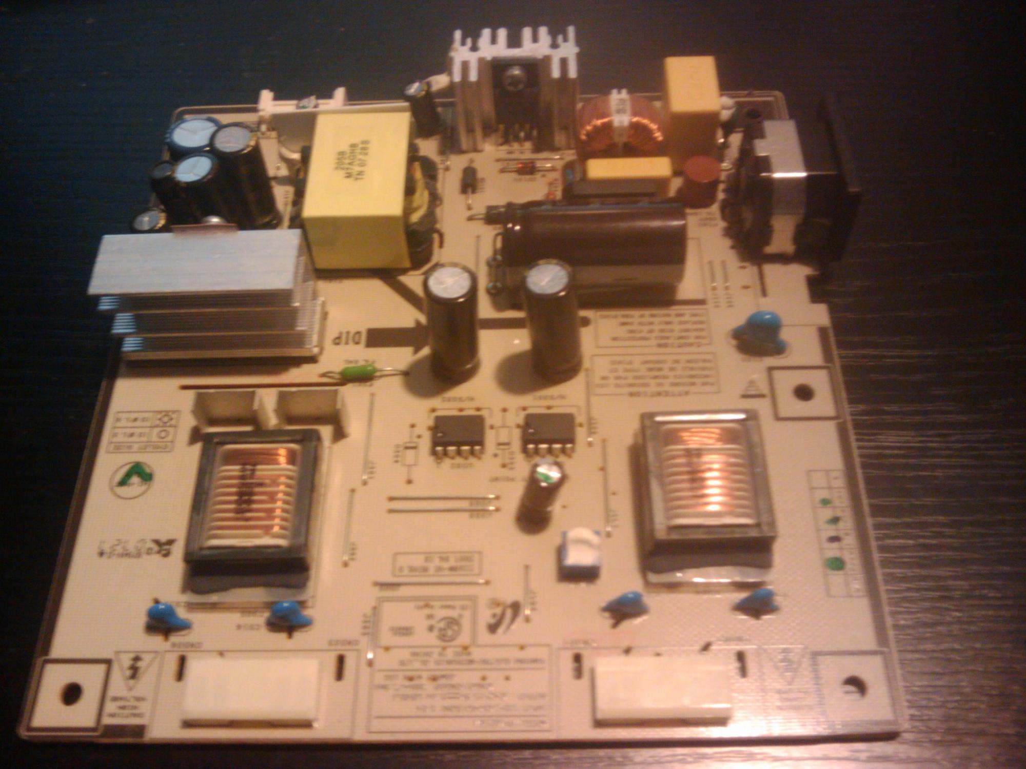

            i have a 226bw and my caps are bad
            so i need the 820uf 25 volt 10x25mm to replace the bad caps. in myc ountry i found the following:
            http://nl.farnell.com/rubycon/25zlh8...25v/dp/1712580
            would it suffice?
            im sorry for my bad english. enghlish isnt my language thanks in advance

              #106
              Re: Samsung SyncMaster 226BW
              Originally posted by swift
              first of all sorry for rbingin up an old thread.
              I'm new to this board
              would it suffice?
              Yes.
                        Oh, I'd already called around my town and there aren't any suppliers in my immediate area. Before finding this forum, I was resigned to ordering online anyway. Still, it was great to see the same symptoms described in this thread. Gave me a bit of confidence that I was on the right track.
                        Like others in the topic, I really don't want to touch the 150uF/450v big one though. Afraid of getting shocked. I don't have the gear to discharge it. Just want to get another year or so out of this monitor, budget being tighter than I'm otherwise used to these days.
                        -Γ¦sir

                          #112
                          The 150uF, 450V cap will discharge rather quickly if the power supply is working.
