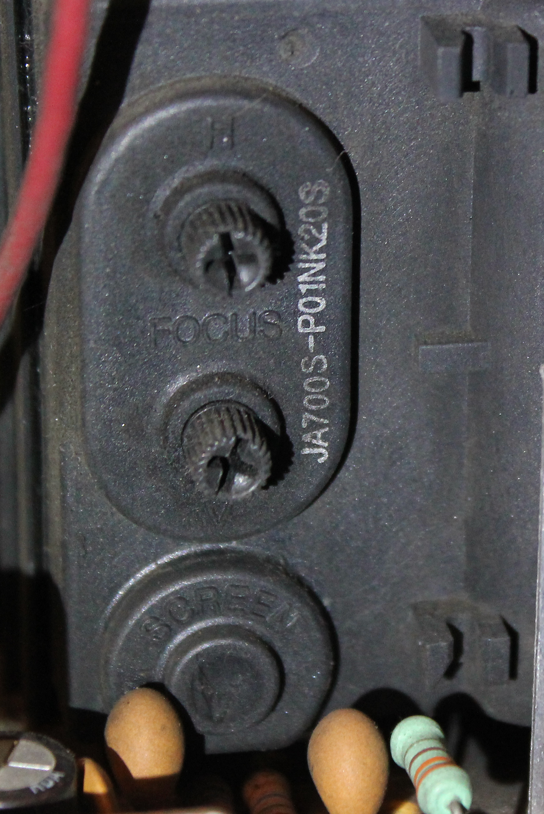

    If I remember correctly from when I opened my Samsung 955DF a while back, there should only be 2 knobs on the flyback: Focus and Screen (G2 adjustment.) Screen (G2) is the one to adjust for more screen brightness. And yes, you need to remove the plastic cover to gain access to those adjustment knobs / pots on the flyback. There is a metal case / shield around the back of the tube, but if I remember correctly again, there is a cutout on the left side of the metal shield (when monitor screen is facing you), so luckily you don't need to remove this metal shield.

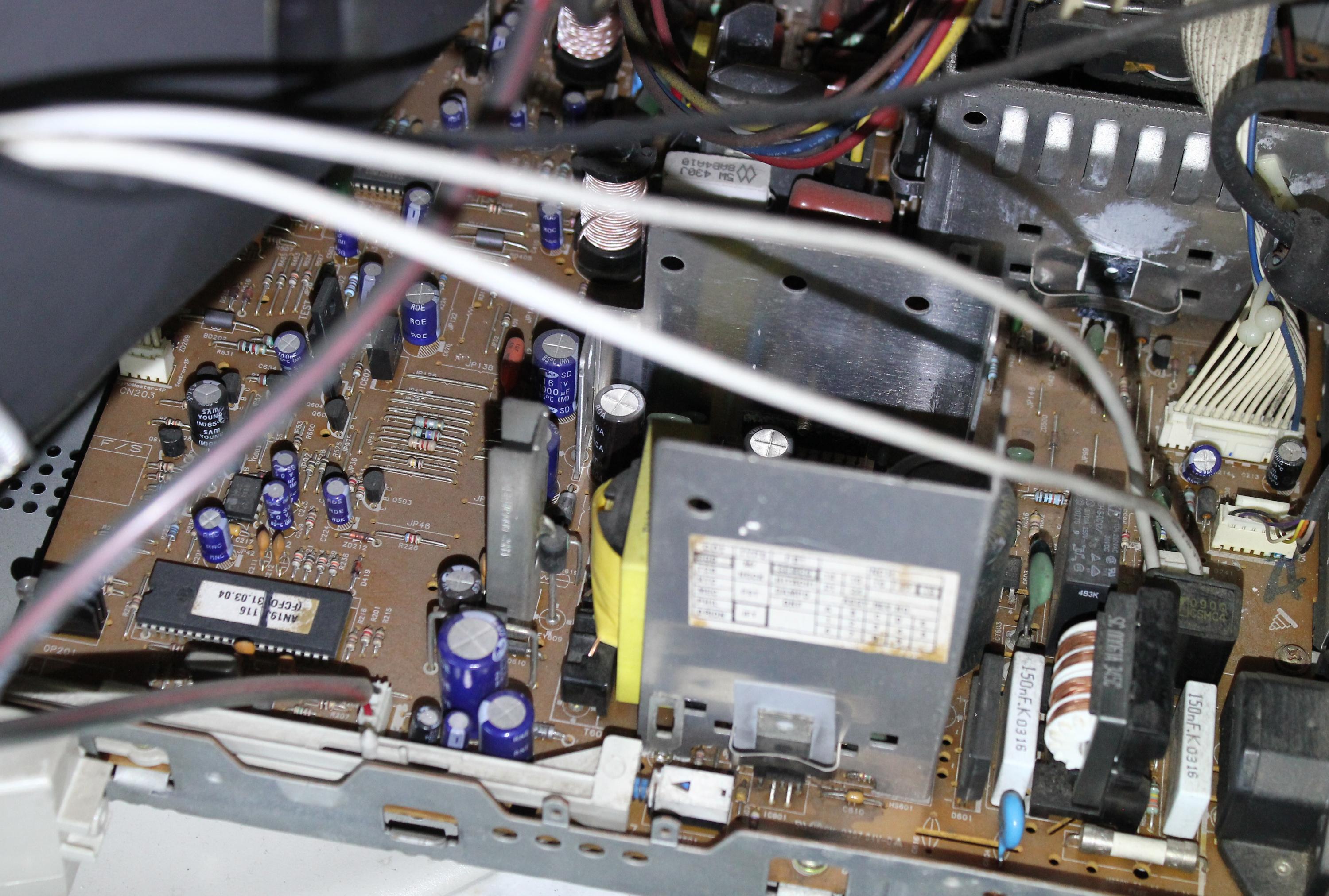

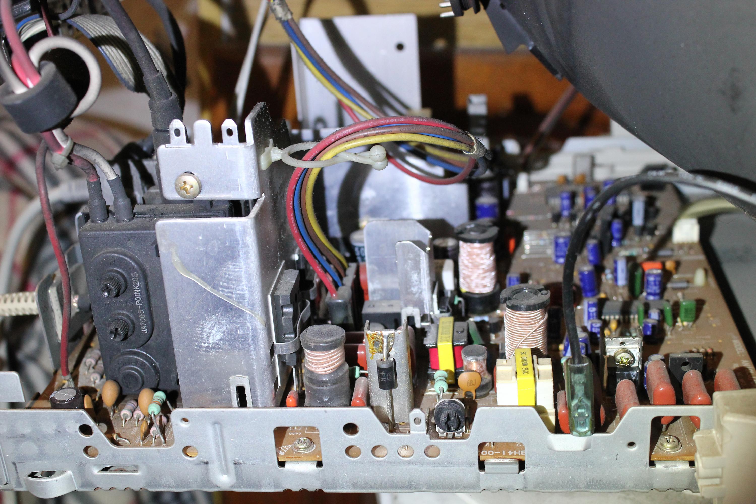

      I finally disassembled it, took many precautions, including pushing down the power button for several seconds and discharging the anode with a screwdriver + cable and an alligator clip to the chassis. It didn't make any noises or sparks at all. I repeated the process many times with a hand behind my back. Nothing. I discovered that the tip of the screwdriver had some sort of grease that comes from suction cup or around it.
      There was no cutout on the left side, so I had to remove the metal shielding, just 3 screws and then pull gently.

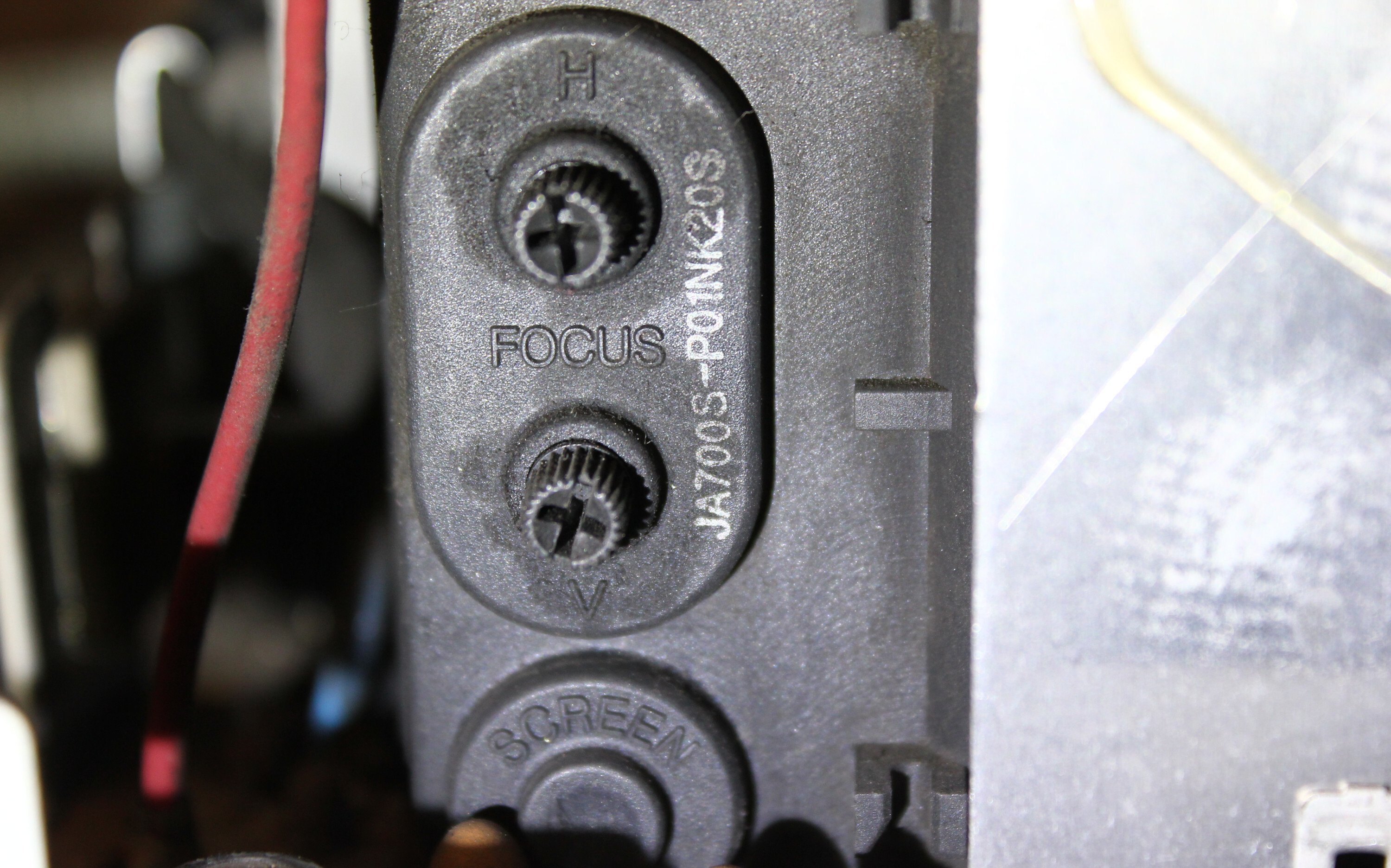

      Then I found the flyback. There are two focus potentiometers but to my dismay there is no "screen" potentiometer. Take a look:
      I thought that it was a just a plastic cover with a pot underneath but it's not the case. It's hard plastic, all one piece with the transformer. Like some bad joke =(
      I didn't touch the focus pots.

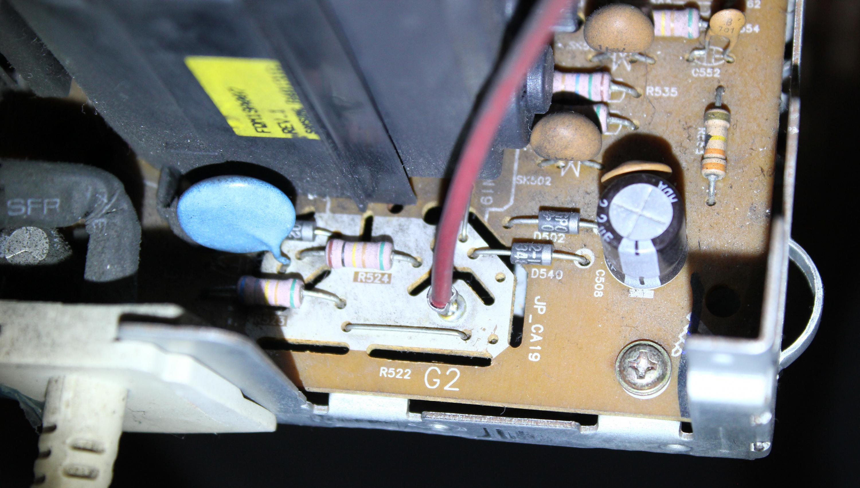

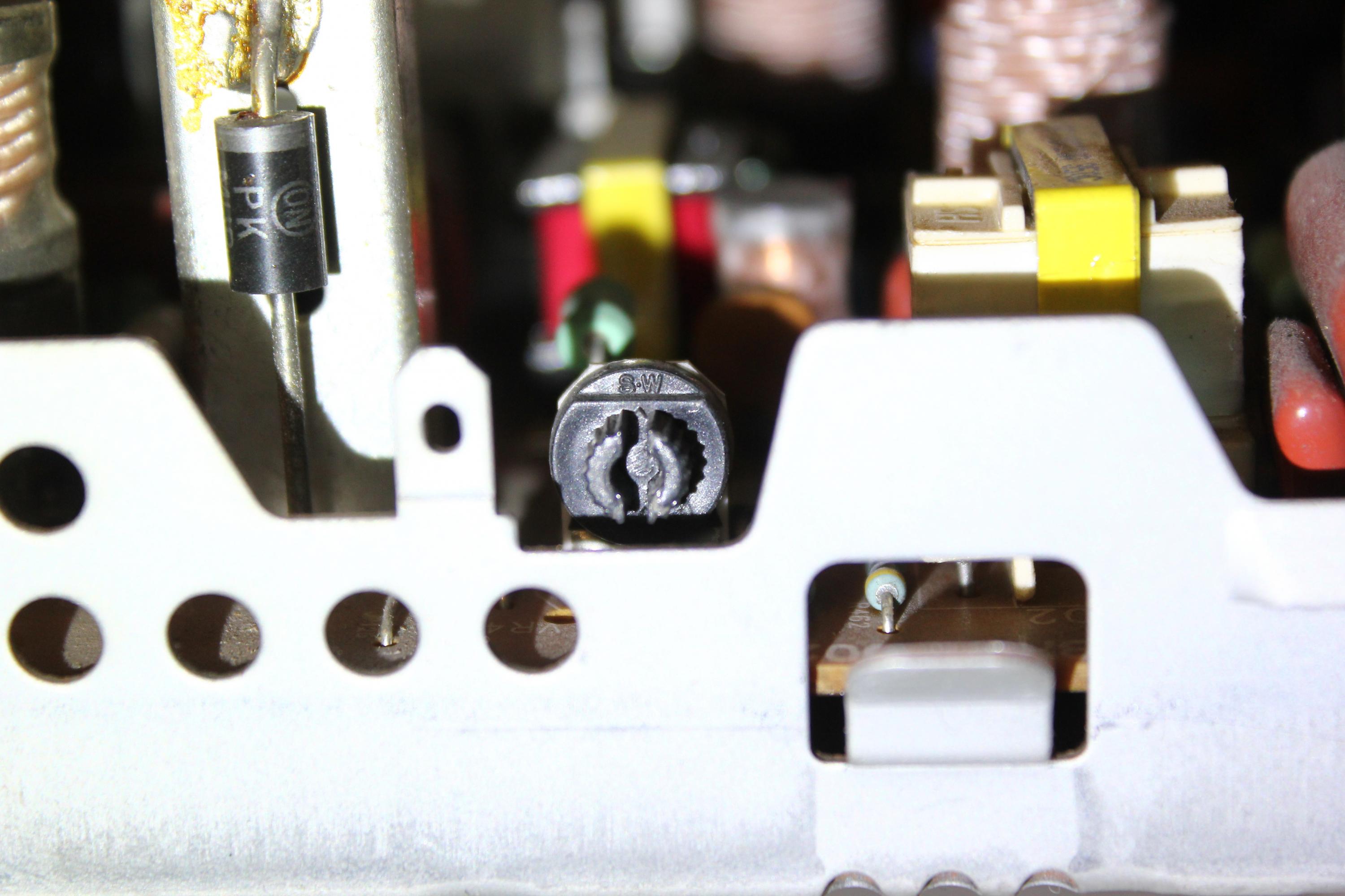

      A little further on the PCB there's a potentiometer labelled VR401. It only moves the screen on the X axis. I reverted it to its original position more or less. Is there any way to be sure? According to the maintenance manual that's the back raster pot.
      I found a reference to G2 in the back, but there's no potentiometer there either.

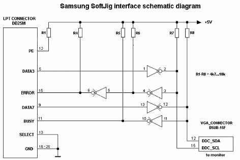

      Before reading your answer I had already disassembled it, and since I didn't find the screen pot, I started thinking to myself,
      "Is there a way to hack the logic part of the board so that it always uses this Highlight Zone mode?".
      Then reading the "confidential" maintenance manual (here it is, by the way) I was puzzled by so many mentions to functions/options that don't exist and the word "softjig" comes up a lot. Looking it up, I discovered that you can program the monitor's (EEPROM?) settings using the I2C bus.
      The only source of info and software that I found is in Russian and it's going to be tricky to get everything right, but I think that I already have figured out most of it.
      I'm going to try model 2, this one:
      The only IC I'd need is a 74LS05 and assuming I put it together correctly, then I'd have to find out how to adjust the picture intensity (luminance?) with the software.

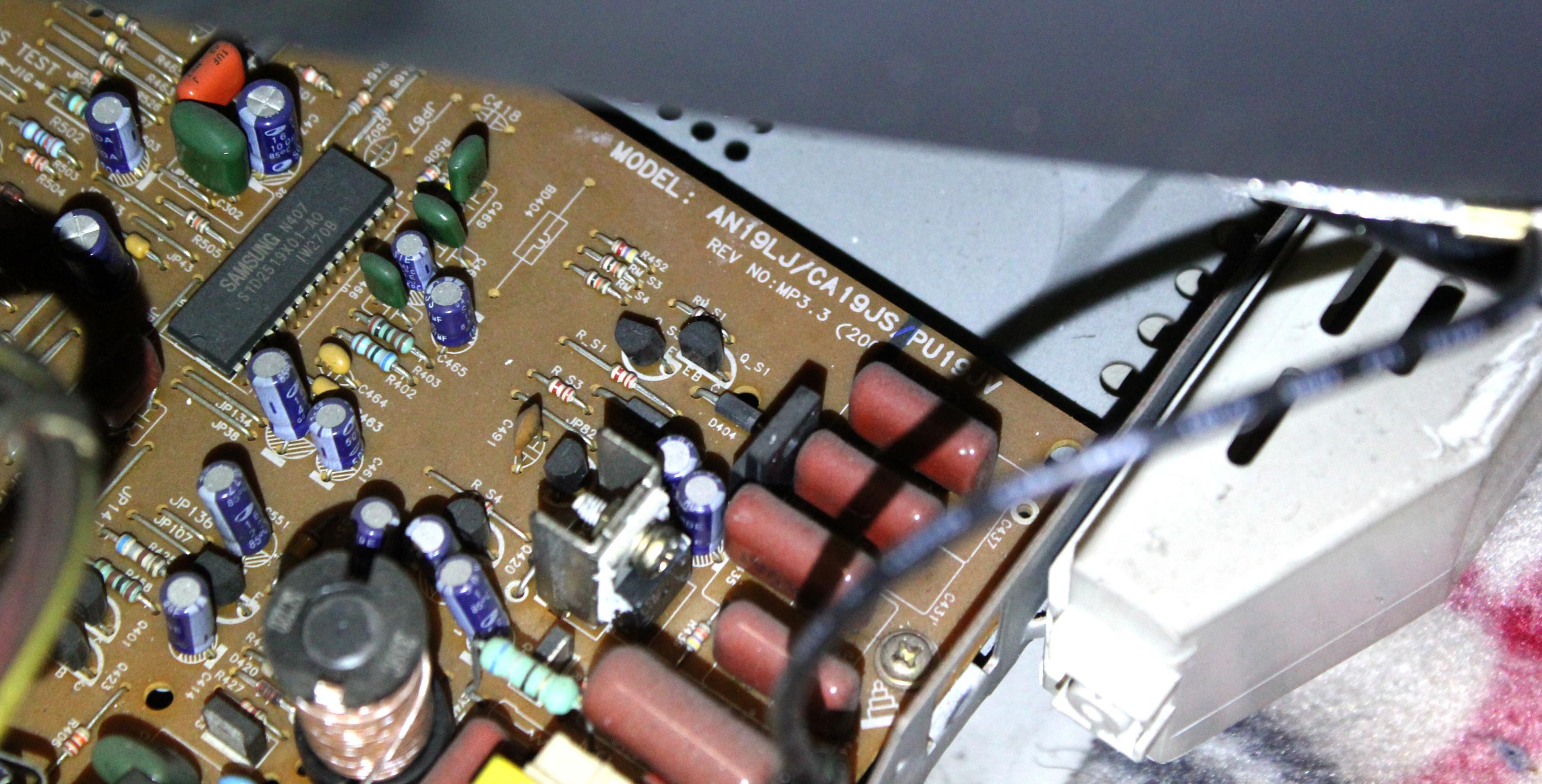

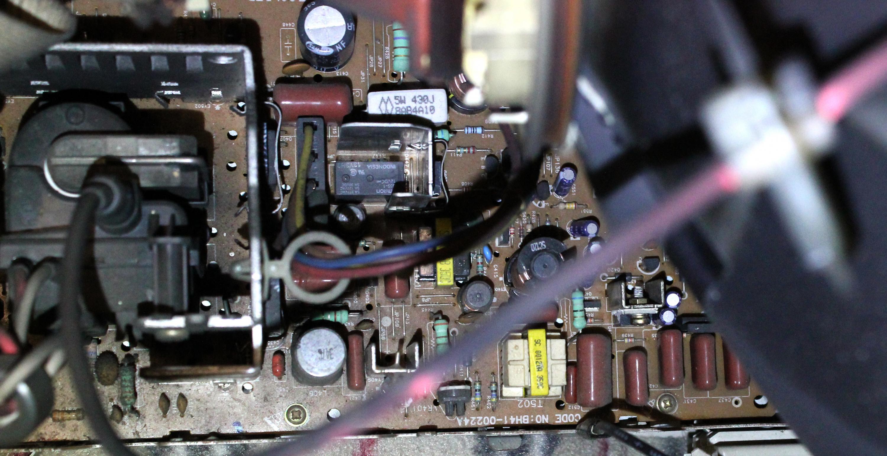

      Bonus info and pictures:
      The board model is AN19LJ/CA19JS/PU19JV
      it also says
      CODE NO: BH41-00224A
      it has two distinct ICs:
      *AN19J 116
      (FCFO) 31.03.04
      * SAMSUNG N407
      S1D2519X01-A0
      IW270B

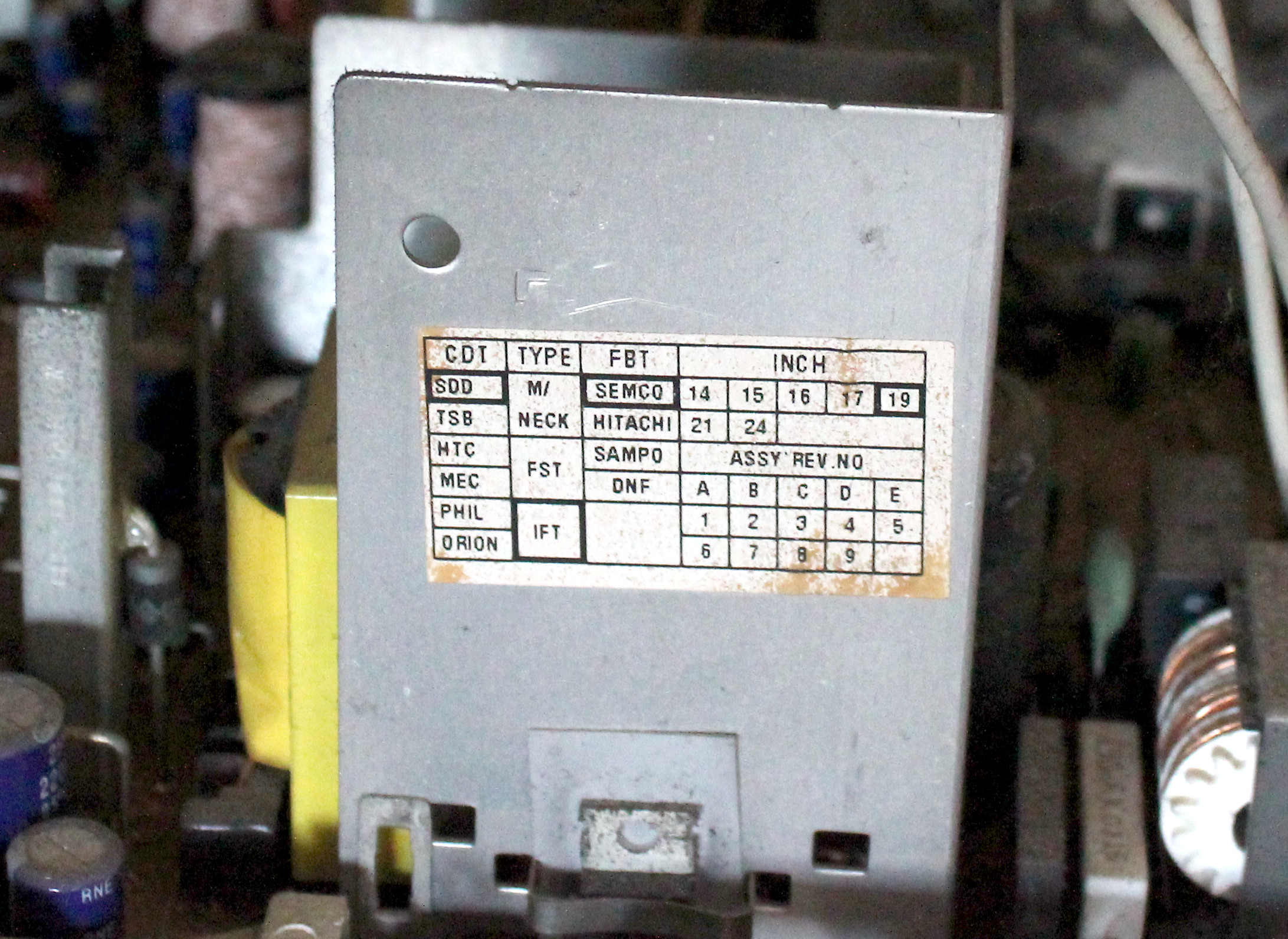

      Tube info:
      TYPE M46QCK761X214
      K-[M/T4/DFX] [SCD]
      F01 K 31201316
      According to a sticker on a heatsink:
      CDT = SSD
      TYPE = IFT
      FBT = SEMCO
      INCH = 19

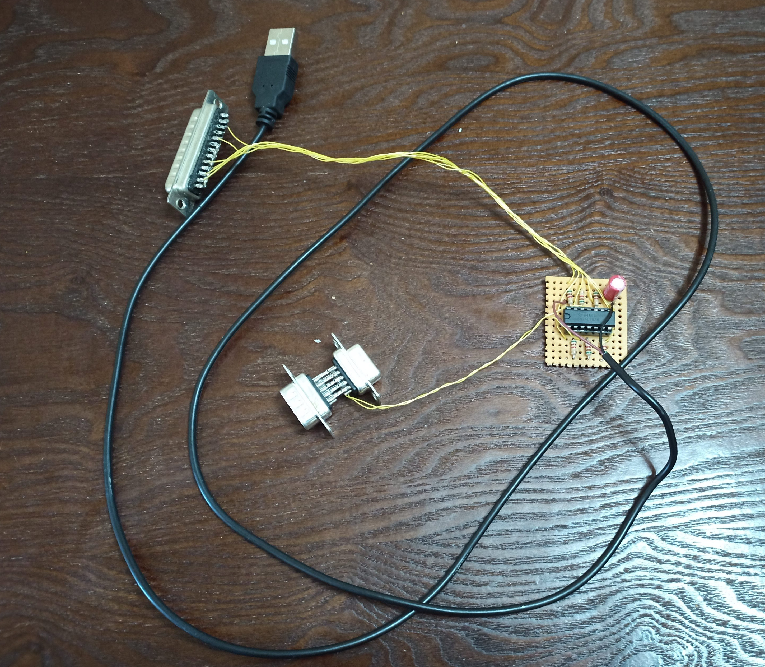

      The adapter I'll make:
        Yes, that grease is there to help create better seal between the high-voltage (HV) anode on the inside of the CRT and the HV tap on the flyback.
        I usually don't touch under there unless I need to remove the main board / flyback transformer. Most modern monitors also tend to discharge the HV anode within a few minutes of turning Off (that static sound you hear when the monitor turns off.)
        Actually, the one item to beware more of, if you ever try to service the mainboard of any CRT monitor, is to make sure the filter caps for the +B line and DC input (from the AC line) are discharged. Those are the ones that might not be discharged and give you an unpleasant shock.
        Oh wow, you're 100% right here and it looks like I have completely forgotten about this over time. Indeed way back when I was looking up the same information as you - how to tweak the G2 (in my case, I wanted to lower it, because even at 0% brightness, I still find the monitor has too much back glow / brightness) - I ran into the same "issue" relating to the SoftJig tool... so I just gave up and continued to use the monitor as-is.
        But you're correct, if you want to adjust G2, you have to use SoftJig interface. I imagine this is similar to WinDAS for Sony CRT monitors, which is also something I've never used but read a good deal about (in connection, again, with lowering the G2, as that seems to be quite the common problem on certain and/or more modern Sony CRT monitors.)
        Sounds like you're on the right track.
        I personally never got this far... but will follow this thread and still chime in if there is anything to add.
        Let me know if you need any help reading / figuring out anything through that Russian link. I don't know Russian... but I know enough cyrillic to sometimes understand / figure out fundamental things. Google Translate is really helpful these days... but sometimes it can't get everything 100% either.
