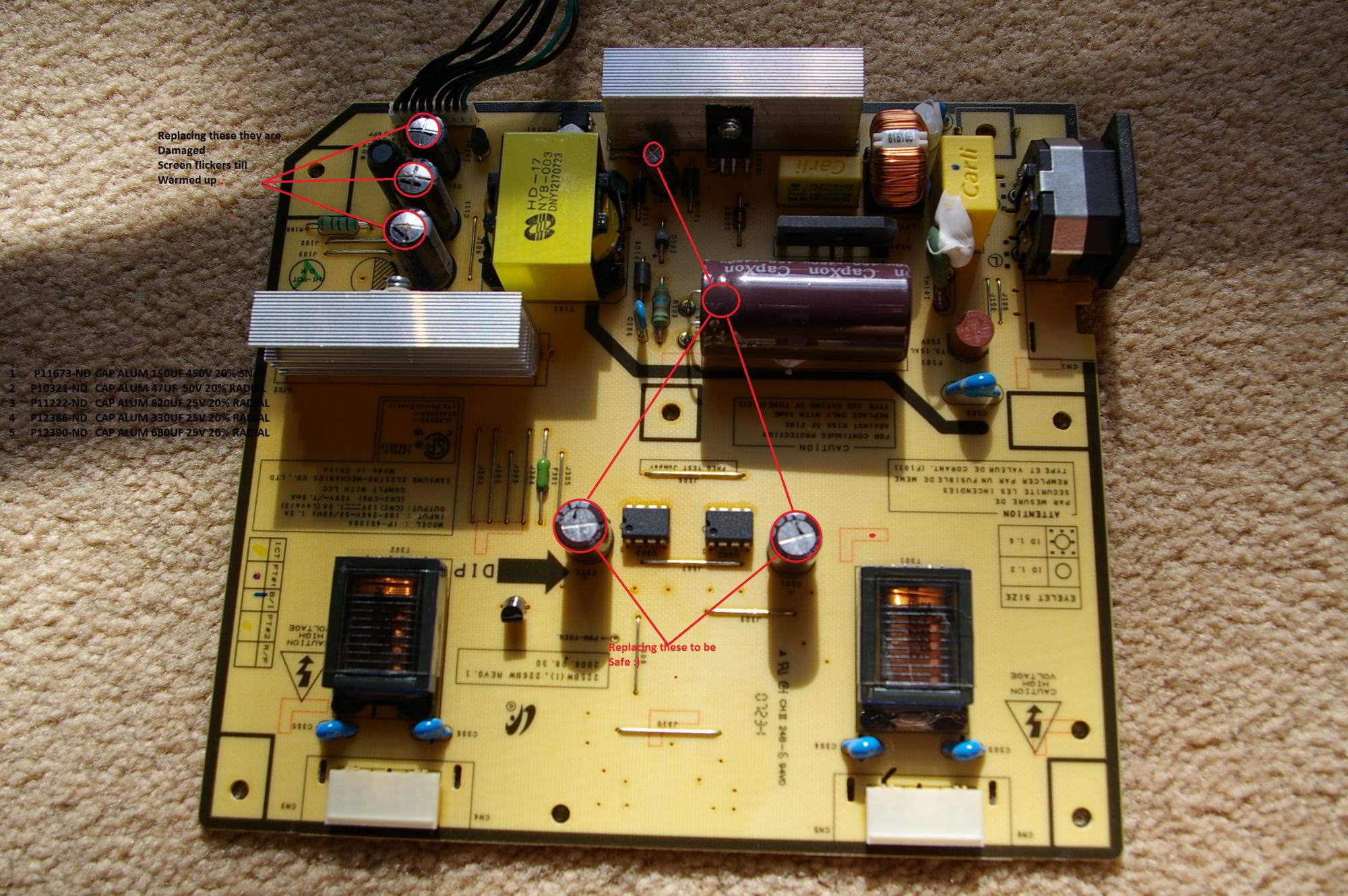

                          • darael
                            • Aug 2011
                            • 5
                            #273
                            Re: Samsung SyncMaster 226BW
                            Firstly, I'd like to thank PlainBill for their help - without it, I would be at a complete loss!
                            Secondly I want to thank everybody for providing others with such valuable information, and all for free!
                            Finally I'd like to say I got my monitor working. Being very amateur at soldering, it took me the best part of an hour to complete the process of desoldering the old capacitors, soldering the new ones on and testing. I can't deny being nervous, and expecting a blue flash as I plugged it in - when I met with silence and a blue flashing light, I was weary...so I turned the computer on, and it worked perfectly and first time round!
                            Those wondering if they should try this - I would tell them give it a go. There's about 10 screws to undo, 5 wires inside monitor to unplug, and that's it really. For the sake of about £12 (inc P&P), give it a go!
                            The parts I used from RS Components are:
                            Capacitor Al FR 820uF 25V 10x20 - RS Stock No. 708-3743 - http://uk.rs-online.com/web/p/products/7083743/
                            Al Electrolytic Cap 105C 25V 330uF - RS Stock No. 526-1519 - http://uk.rs-online.com/web/p/products/5261519/
                            Once again, thank you to everybody for helping me.

                              • oldgezzer
                                oldgezzer
                                • Aug 2011
                                • 2
                                #275
                                Would like to say thanks to everyone here for the information regarding the Samsung SyncMaster 226BW replaced all the caps on the power board !
                                Parts purchased from Digi-Key
                                P11673-ND =1) 150ouf-450v 20% Snap
                                P10321-ND = 1) 47uf 50v 20% Radial
                                p11222-ND = 2) 820ouf 25v 20% Radial
                                P12386-ND = 1) 330uf 25v 20% Radial
                                P12390-ND = 2) 680uf 25v 20% Radial
                                replaced all the above and everything is working 100%
                                thanks once again
                                Oldgezzer

                                        Hello again!
                                        Sorry, but I have no proper equipment to make quality photos.
                                        Anyway, looked up all the specs of the caps to be replaced:
                                        C111,C112,C114,C316,C317 : CapXon GL 820uF 25V 10x20 - Ripple: 1560mA @100kHz, ESR: 0.043 Ohm
                                        C113 : CapXon GL 330uF 25V 10x12.5 - Ripple: 720mA @100kHz, ESR: 0.082Ohm
                                        C118 : CapXon GL 2.2uF 50V 5x11 - Ripple: 33mA @100kHz, ESR: 2.6Ohm
                                        C318 : CapXon GL 22uF 50V 6.3x11 - Ripple: 135mA @100kHz, ESR: 1 Ohm
                                        C107 : CapXon KM 47uF 50V 6.3x11 - Ripple: 115mA @120 Hz!, ESR: ??? (general purpose cap)
                                        and after looking around at Farnell, came up with the following possible (orderable) replacements:
                                        C111,C112,C114,C316,C317 : PANASONIC EEUFR1E821
                                        C113 : PANASONIC EEUFR1E331 (so far, just as retiredcaps advised...)
                                        C118 : RUBYCON 50RX302R2M8X11.5
                                        C318 : RUBYCON 50RX3022M8X11.5
                                        C107 : RUBYCON 50RX3047M8X11.5
                                        (specs for the last three @ https://cdn.badcaps-static.com/pdfs/...b5c4dc5986.pdf)
                                        Basically now I'm asking if the Rubycon RX30 series is O.K. for C118, C318 and C107?
                                        I'm leaning towards these because they seem to have a longer than average life expentancy and good temperature tolerance. Their ripple current and ESR ratings should be O.K. (or else I completely misunderstood something). The few things that still worry me a bit about them:
                                        - the chosen RX30 caps all have a lead spacing of 3.5 mm, while on the board the thru-holes are 5mm from each other for all caps. Clearly they will not 'sit tight' on the board (but then, neither did the originals). Can this be a problem? Is there something to take extra care of while soldering?
                                        - The original C107 was a general purpose cap (ESR unknown), the replacement is low-ESR, and I recall that sometimes too low an ESR may turn out bad. Can this be the case here?
                                        • retiredcaps
                                          • Apr 2010
                                          • 9271
                                          #280
                                          Yes. See C107 at bottom.
                                          As long as you don't pull hard from the bottom, it should be fine. I don't think you will find too many caps with 5mm spacing in the 2.2/22uF 50V specs.
                                          See
                                          https://www.badcaps.net/forum/showpo...39&postcount=2
                                          Use Panasonic FC for Capxon KM series.
