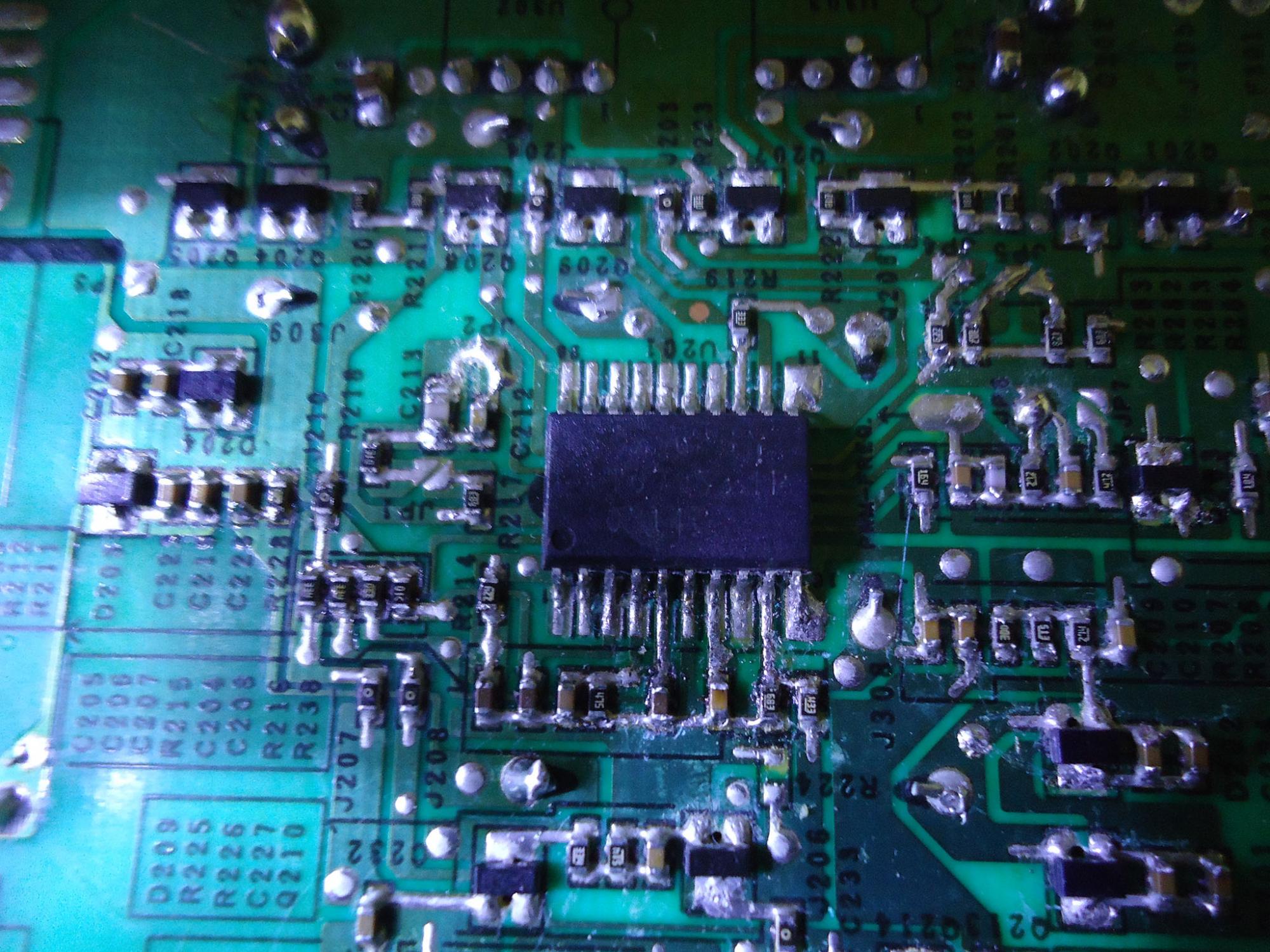

      Here are close pictures of the inverter IC (OZ964GN).
      I know the soldering looks terrible, its after reflowing the solder multiple times on everything out of desperation.

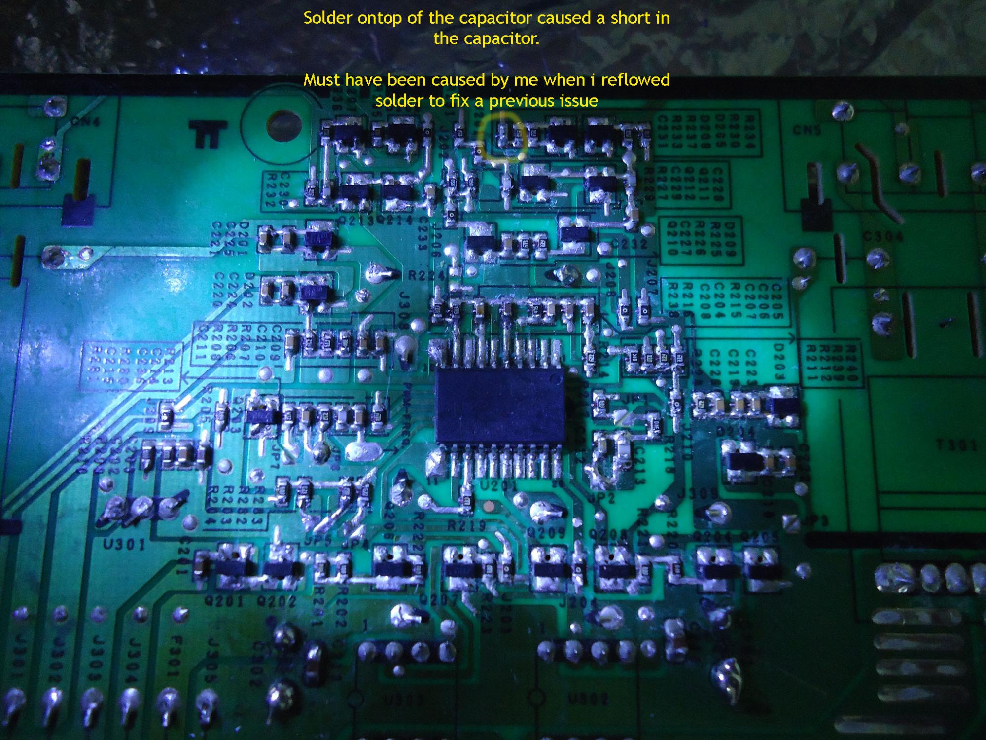

              All caps are nichicon PW except the 330uF one which is a VZ series. According to the internet and the datasheet, the VZ series has higher ESR so i tried to put the old 330uF back but the problem persists.
              After replacing caps again and testing other things such as the connections from the IC to the mosfets and from the mosfets to the transformers i am still unable to find anything.
              Based on my measurements, i am almost sure the open lamp protection is what shuts off the inverter. According to the datasheet, max voltage for this pin is 2.5V and i measured 2.7V with backlight on, maybe there is a short somewhere, this might also explain the voltage drop when the backlight is being turned on.
              For fun, what about the other way? That is "bad" power/inverter board inside the "other" 226BW?
              Same problem, the backlight starts and after 1-2 second its off.

                Is there a way i can bypass the OLP protection somehow temporarily just to be able to rule it out?
                Would shorting pin 9 (feedback sense\OLP) with ground do it?
                EDIT: No need, fixed the board, details and a picture in the next post

                  It works!!!!
                  With a better magnifying glass than i have, i noticed there is a solder ontop of a surface mounted capacitor. The multimeter confirmed a short, on the other board the two points measured 4.2Kohms.
                  After careful removal of the solder ontop with desoldering wick, i measured 4.2Kohms like on the good board.
                  I then put the board inside, plugged everything and fired up the monitor and it WORKS!!
                  I can't believe i didn't notice this earlier, must have been my poor vision.
                  Although i ordered new capacitors and new board just yesterday, i'm still happy it works, i will probably have use for the new capacitors in the "good" 226bw board (the 330uF cap has a plagued top, although for now it works)
                  The "bad" 226BW belongs to my brother and the "good" 226BW is mine. the "bad" 226BW is now back to my brother.
                  I have attached a picture of the "shorted" capacitor because of solder ontop of it.
                  Thanks to everyone attempted to help and to this great site, this forum is like a life saver for old electronics, i will definitely keep visiting
