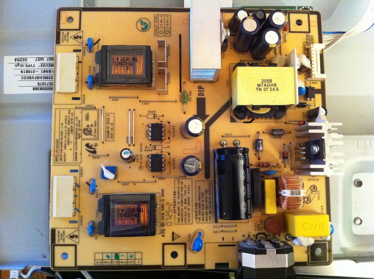

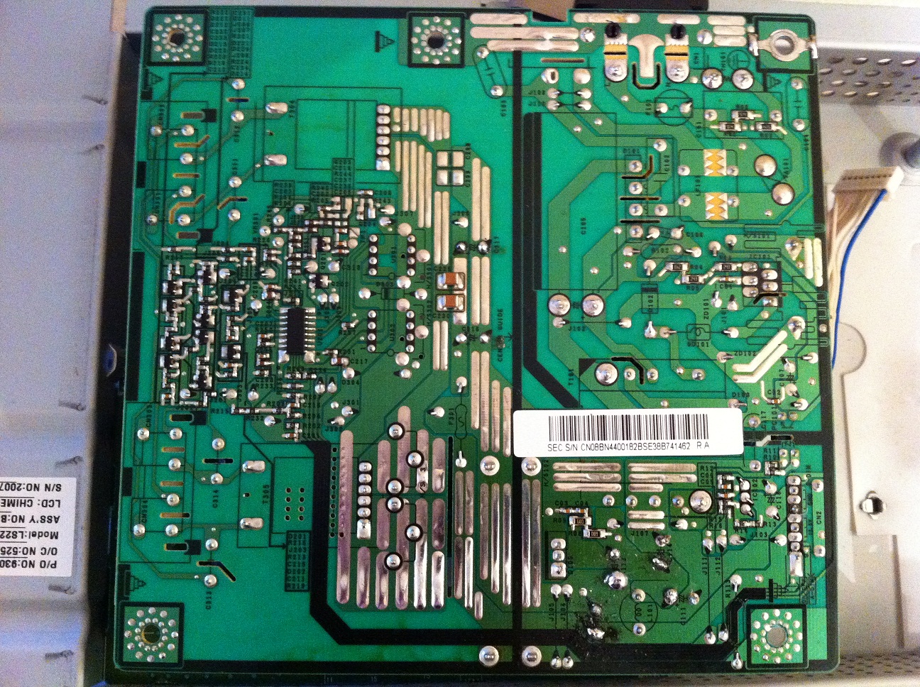

                                    • reflex
                                      • Jul 2011
                                      • 5
                                      #258
                                      Re: Samsung SyncMaster 226BW
                                      Plainbill: The boards I've found on ebay look quite different to mine, they're much more sparser in terms of the number of components for some reason. I guess would be a real challenge finding my exact one.
                                      I have attached pictures. You can see how shoddy my attempt at soldering is, but the solder touches both the caps and the board. I'm guessing I may have screwed it though, and I might have to resign myself to binning the monitor
                                      • PlainBill
                                        • Feb 2009
                                        • 7034
                                        #259
                                        F301 is the fuse for the inverter. On the first picture, it's the green component just to the left of the word DIP.

                                        • alexanna
                                          • Mar 2010
                                          • 1346
                                          #260
                                          Your soldering is repairable; I had problems when I first started.
                                          Getting good contact of the capacitor leads and solder pads is critical.
                                          One thing I always do is to gently rock the capacitor and watch for any movement on the solder pads.
                                          The inverter fuse is just to the left of the word “DIP”.
                                          Fuses should read very close to 0 ohms resistance.
