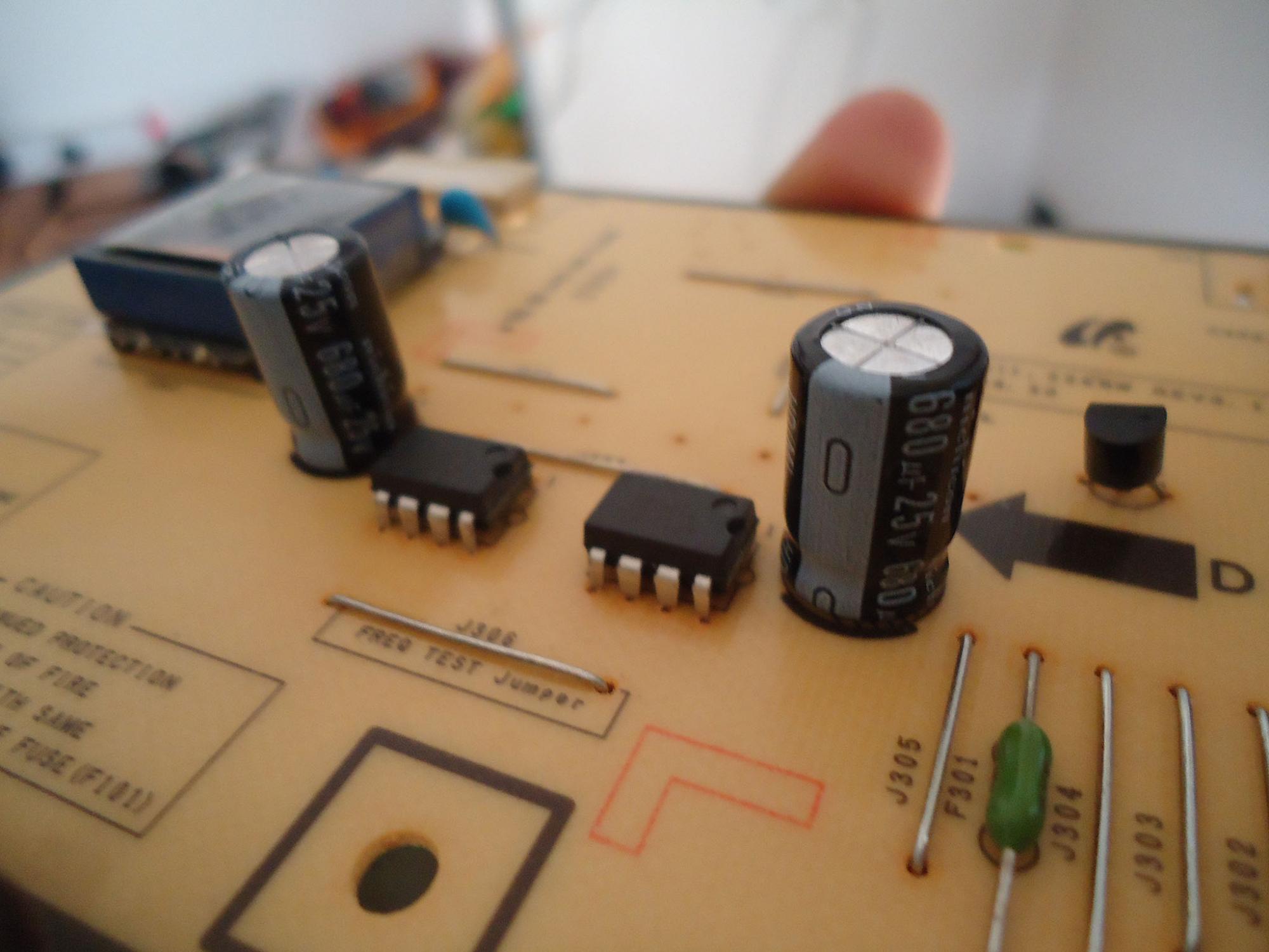

      Originally posted by mastertheknife View Post
      680uF New (Nichicon HD): ~730uF (can caps arrive overrated?)
      mastertheknife.
      Up to 20%.This is normal.

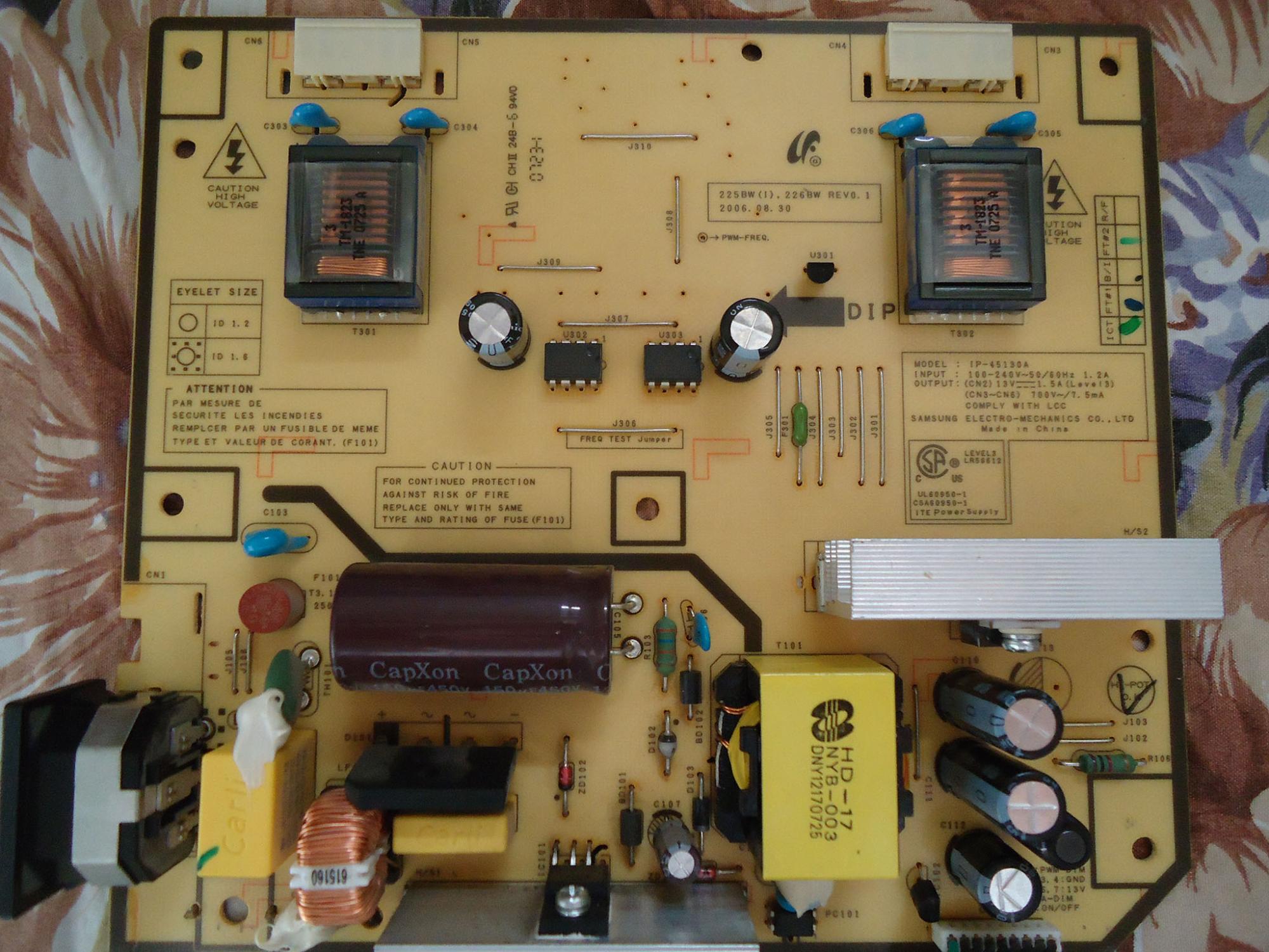

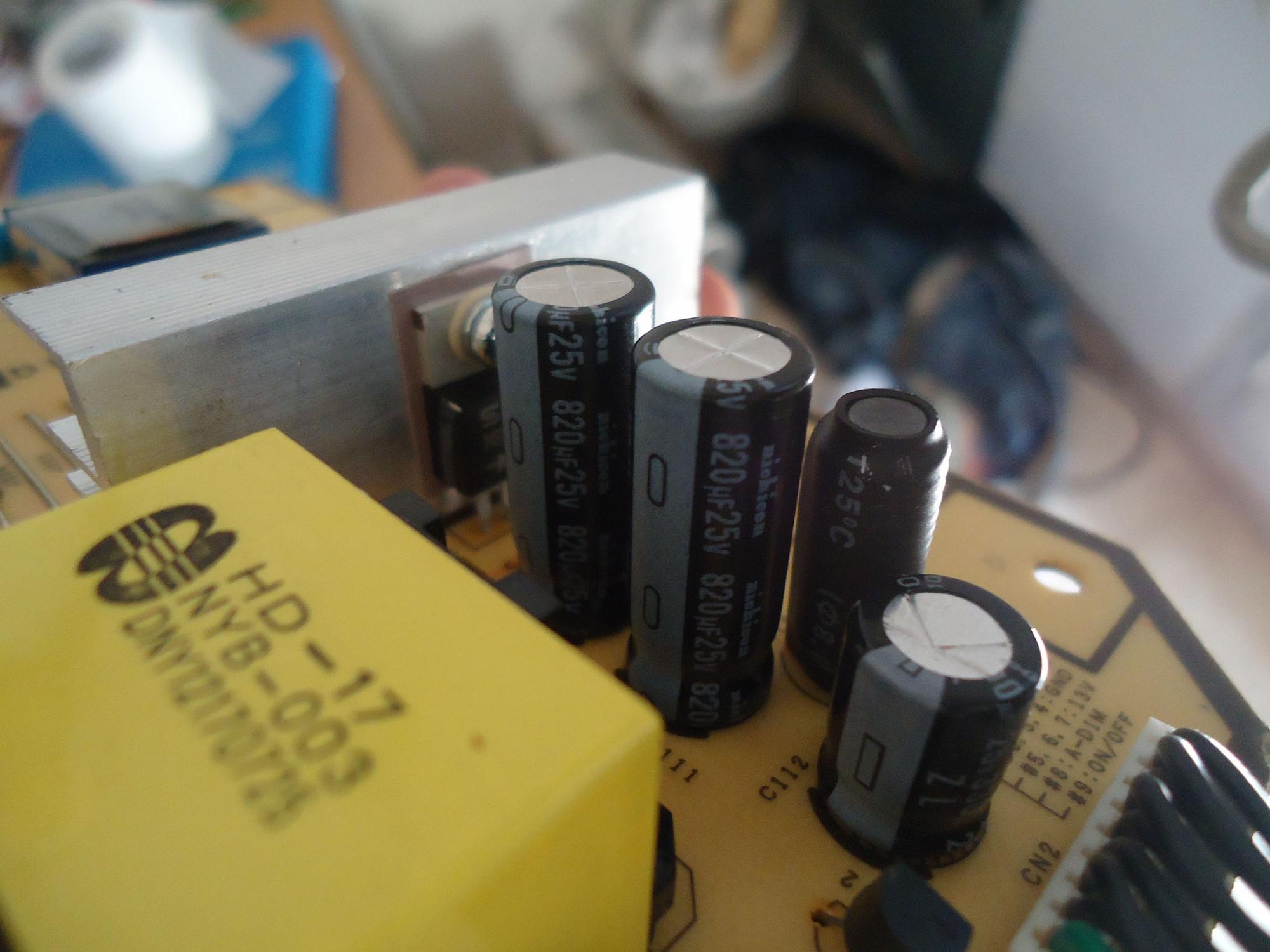

                      Re: Samsung SyncMaster 226BW
                      I messed up again, not sure even how.
                      When fixing the "bad" 226BW i opened up my own 226BW (good) to compare readings on both boards.
                      After fixing the bad board, i closed the monitor and the monitor works like new, and still works.
                      But i noticed the good board had a plagued 330uF capacitor, so i figured i will order caps from ebay to replace all caps while the monitor is still open.
                      Unable to order from digikey or mouser due to expensive shipping ($30+ because first class is not available for international orders) so i had to order from eBay.
                      I replaced the 330uF cap with Rubycon ZL 330uF 25V, the 820uF caps with Nichicon HD(M) 820uF 25V and the 680uF caps with Nichicon HD(M) 680uF 25V.
                      Made sure to clean the soldering joints with q-tips and alcohol to remove any dirt or flux, left the board to dry overnight and powered up the monitor today.
                      The monitor powered up, but after using the computer for some time, i noticed that the backlight dims for a 1/4 of a second often. After few more minutes, the backlight turned off and ever since, its off and won't turn back on.
                      I took apart the monitor again, took out the power supply. To my suprise, all of the caps are ok, however fuse F301 is blown (open circuit).
                      Could the new 680uF caps (the caps in the inverter section) be possibly bad?
                      I noticed they look a little different from the 820uF caps, and according to nichicon's datasheet, their height should be 20mm, but they are actually 16mm height. The seller told me not to worry and that casing for capacitors changes all the time (USA seller). Before soldering the capacitors to the board, i measured their capacitance with a capacitance meter: almost all 680uF capacitors measured ~450uF except two which measured ~730uF, which are the two that i chose to solder to the board. The date (H0912) from what i understand is december 2009.

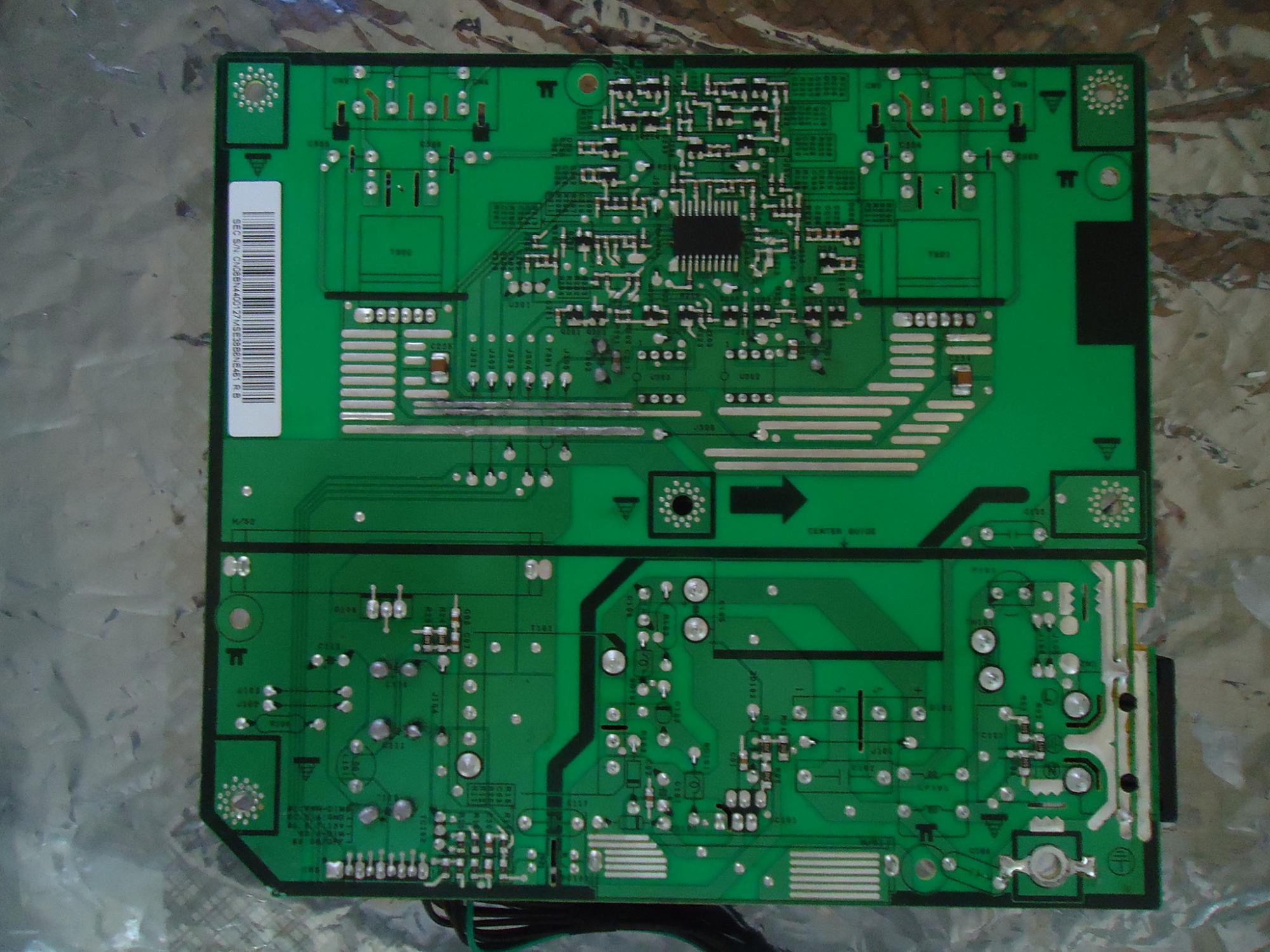

                      EDIT: Added a picture of the fuse and the back of the board. Ignore the solder on the long lines, i did that after the fuse blew.
                      Confused again what went wrong,
                      mastertheknife.

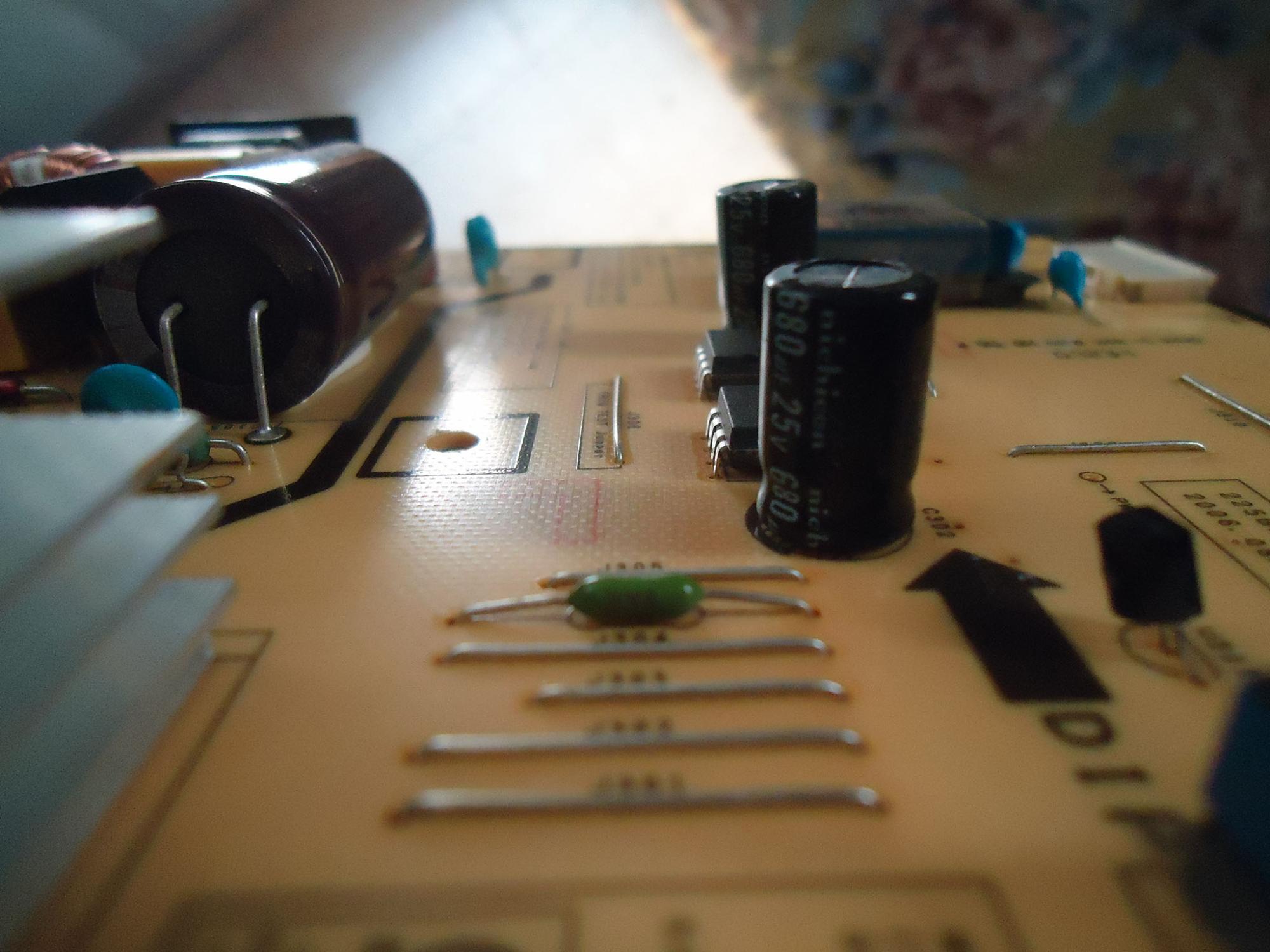

                              The caps that measure 450uF are out of spec. (M) indicates +/- 20%.
                              680 x 0.8 = 544uF.
                              --- begin sig file ---
                              --- end sig file ---
                                680 x 0.8 = 544uF.
                                Also, these Nichicon HD(M) 680uF 25V caps are all 10x16mm height, while the nichicon HD datasheet states 10x20mm for the 680uF 25V.
                                Is it likely that they are fakes, and perhaps they are the cause to the blown fuse? (They sit between positive from F301 and ground)
                                Also, this is what i received from the seller when i asked him about why these caps are 10x16mm instead of 10x20mm, this was his response:
                                "Yes these are HD(M) series.... Some case sizes are different but same Capacitance value. They change case very often depending on the manufacture."
                                Thank you,
                                mastertheknife.

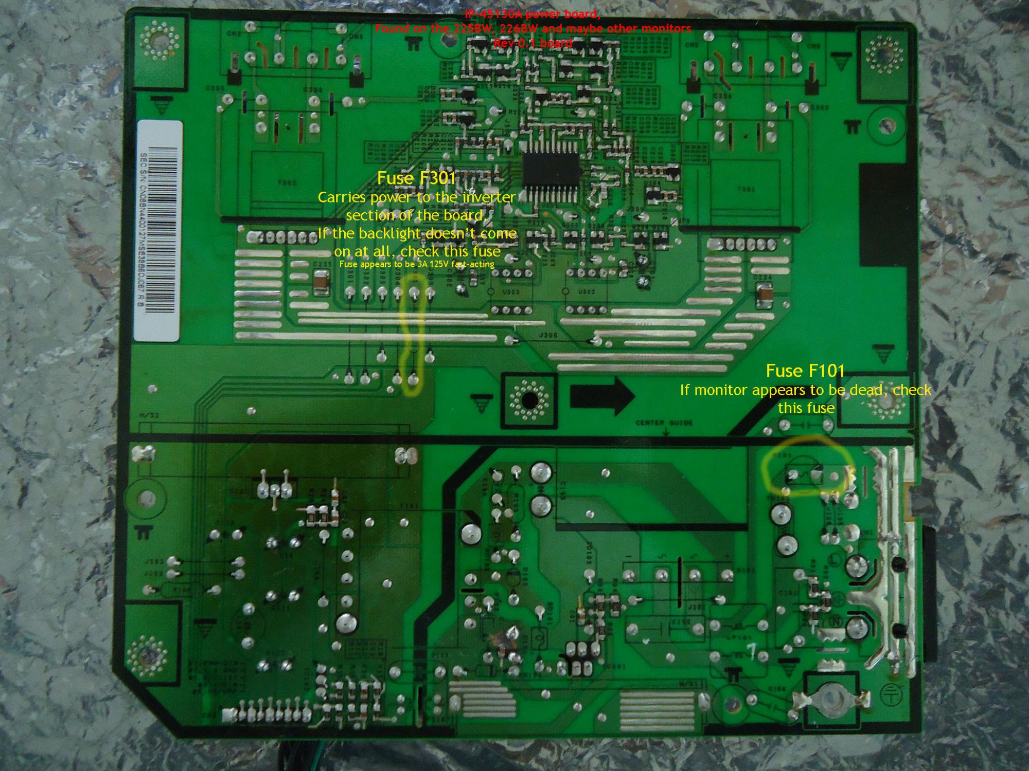

                                  Hi Mastertheknife!
                                  I can't find any fuse, can you help me to find it?
                                  Thank you
                                    I took a random sample of my Rubycon 1000uF, 470uF, 2200UF caps (MCZ and ZL) and tested them for capacitance. All measured higher than the stated values.
                                    If these are new 680uF caps measuring 450uF, I would say you got fakes or bad caps.
                                      Originally posted by pebe292 View Post
                                      Hi Mastertheknife!
                                      Thank you
                                      Hi, i circled the fuses in the attached picture.
                                      mastertheknife
