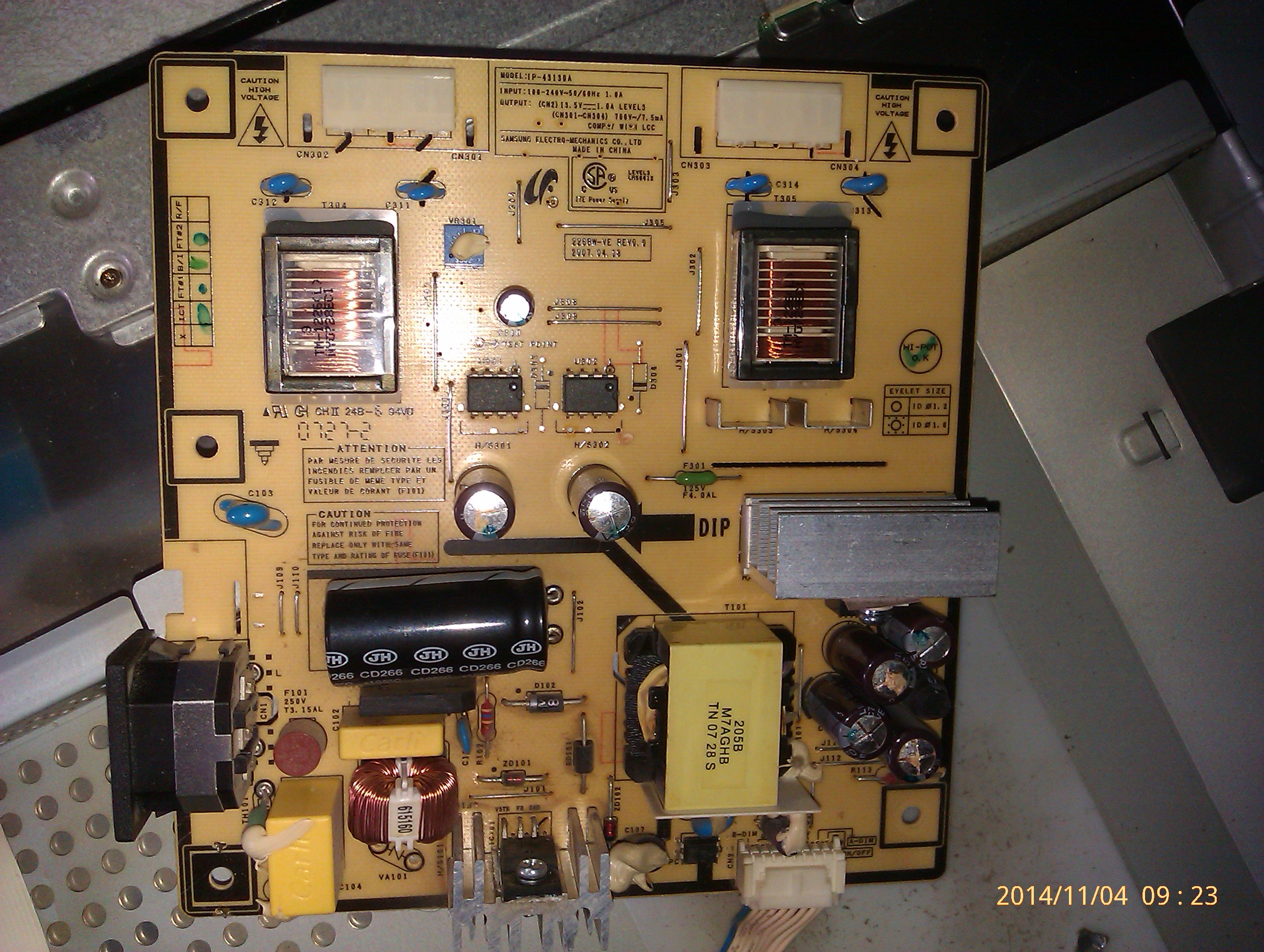

    I think that once I change all the capacitors change and large one just for sure.
    • selldoor
      Slow Learner
      • Dec 2010
      • 7870
      #402
      Re: Samsung SyncMaster 226BW
      Have you taken the BIG cap off the board it may say what value it is on the other side.
      • selldoor
        Slow Learner
        • Dec 2010
        • 7870
        #403
        Post 196 on overclockers forum
        http://forums.overclockers.co.uk/sho...8069187&page=7
        looks to have the same board as you and he has a 100UF
        Useful table showing panasonic FM/FC cap reference numbers.
        • stavros67
          • Nov 2014
          • 4
          • Greece
          #404
          Thank you! This is the same board. Problem solved
