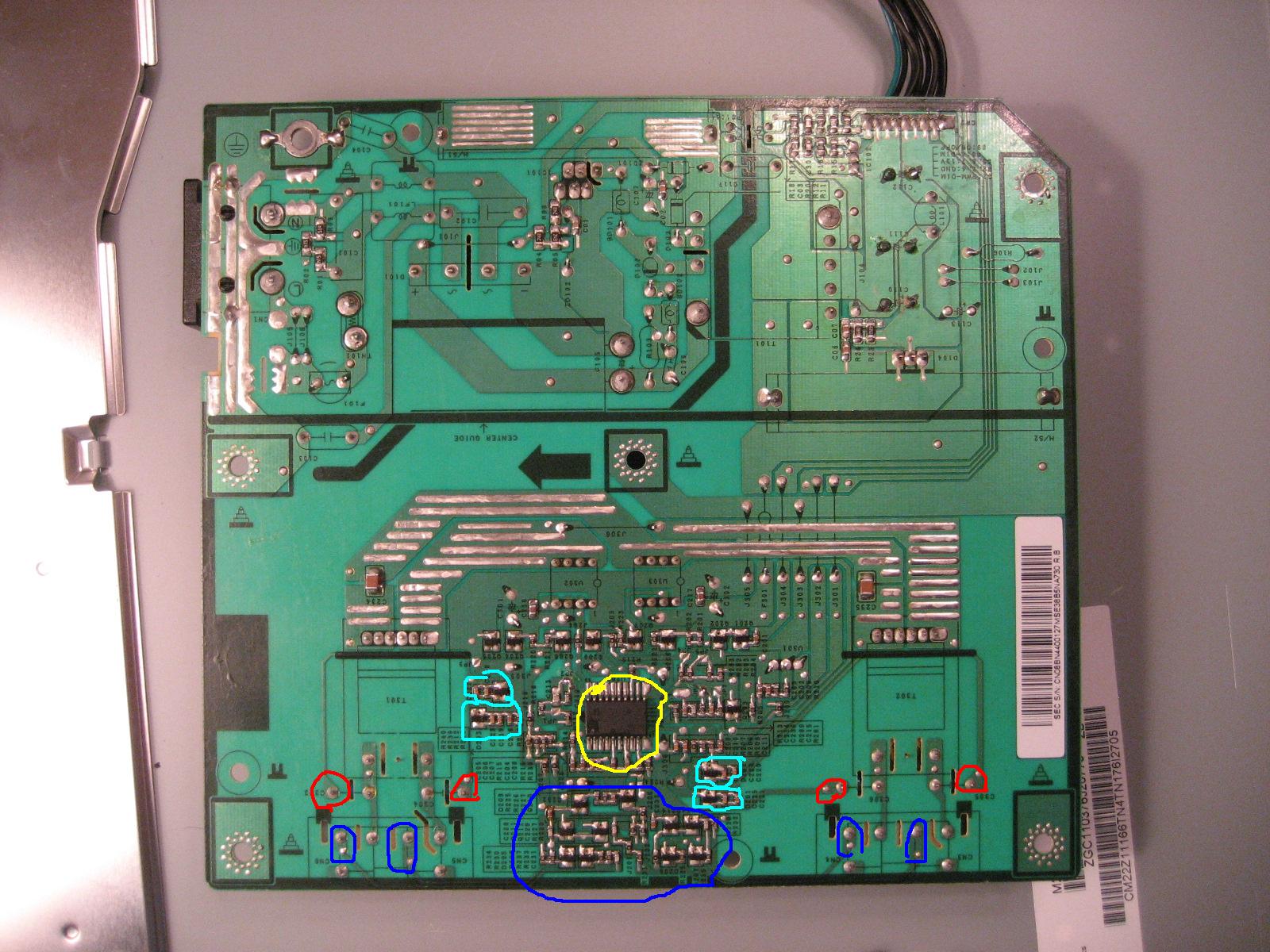

    I have attached the pics of the top and bottom of the power supply / inverter board.
    Nice pictures. I have taken the liberty of thoroughly marking up the picture of the bottom side of the board. Note the points circled in red. The outputs of the transformers go to the connectors for the CCFL leads. The voltage is reduce by means of a capacitive divider. Note the leads connecting the points circled in red to the points circled in aqua, the second parts of the voltage dividers. Those are combined and fed to the inverter controller (circled in yellow).
    Note the four connector pins circled in blue. Those are the return lines for the CCFLs. The voltage there is fed back to a circuit (also circled in blue - I was running out of nice colors) which combines the currents and feeds the sum back to the inverter controller.
    Inverter controllers can monitor the voltage across the CCFLs and the current through them. Depending on the design they can shut down if any of the following conditions occur for any CCFL: Voltage to low; voltage too high; current too low; current too high.
    The quick test I suggest is measuring the voltage at the return line. It should be under 1 volt. If any connector has a voltage that is lower or higher than the others, suspect a problem with the transformer, the CCFL, or the monitoring circuit.

      I measured the 4 blue return lines. They all read .023 vdc which seems low.

        You did want me to measure the returns back to ground?

          Yes. You're right, .023 volts does seem low.
          I wasn't explicit, however. This measurement is to be made while the CCFLs are working. This usually requires hitting the power button on the monitor several times to turn the CCFLs back on momentarily. Of course, it is easiest with a scope. Look for differences between CCFLs. If you look up the datasheet for the CCFL controller you can often determine if it is shutting down due to excessive voltage or excessive (or too little) current.

            Well pretty bad that I didn't think about testing when it first came on since it is shutting down. What can I say I am a mechanical engineer. I know just enough about electronics to be dangerous! Worked with electronics technicians for 30 years, but I mainly stick to the nuts and bolts stuff.
            Ok I checked them when they were turned on and the one on the far left was a lot different than the others. When the power comes on it would start out reading 3.3 mv dc for a second or two then jump up to 125 mv then go back down to about 17. mv.
            The other three would start out at 3.3 mv when it was turned on then go up to about 17. mv and then drop to around 10 mv and then go back up and stay at about 17. mv.
            The first increase in voltage was when the analog box come on after power up.
            Not sure if it makes any difference but I did check the one on the far left AC voltage and it was going up to about 1.3 v. The others were only going up to about 100-150 mv Ac.

              What is the part number of the inverter controller IC? That will give some clues as to what is happening.

                I read it 0Z964GN
                T07386 2G
                0707C
                I have attached a pic of the IC.

                              One correction. The IC is an OZ964GN (first character is 'oh', not 'zero'). Alldatasheet.com has a copy of the datasheet. Briefly, the IC provides two protection modes. Pin 2 is used to sense output voltage and will shut down the inverter if the output voltage goes too high. Pin 9 senses the CCFL current and will reduce the output if the current goes too high. Without actually tracing circuits I can't determine how the feedback signals are used. However, pin 2 appears to be the key. If that goes above 2.7 volts the inverter will shut down. Try to measure the voltage it reaches (repeat several times).
                              Also, if you would provide a somewhat more detailed picture of the components around the IC, I would appreciate it. Specifically, everything in the area between the two transformers, and extending down to the lower edge of the board.

                                I checked pin 2 with the VOM meter and the highest I saw it go was 900 mV dc. Not sure if I am seeing the entire picture with this meter! But it does spike and drop back off.
                                I have attached several pics. One shows the entire area around the IC. The other 4 show closeups.
