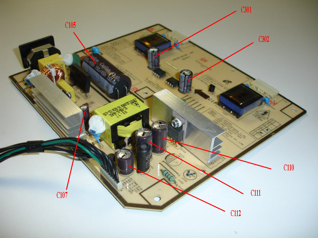

    I am completely new to the word of capacitors but recently my 2 year old Samsung SyncMaster 226BW [S] monitor began flickering during computer POST and go black. Sometimes I could turn the monitor off and on or switch from digital to analog and back to digital and normal picture would display but as days went by the monitor would flicker and go black, eventually the monitor would not even flicker but just show up black and the power button solid blue. Doing a google search of my symptoms led me to several helpful spots including this forum. I pried open the monitor and noticed several puffy capacitors, specifically C110, C111, and C112 as shown in the photograph.
    I want to try replacing the capacitors but want to make sure I do it right the first time. I've never soldered before so I need the tools for the job as well as the capacitors. I live internationally from any of the electronic stores and want to make sure I order all the correct parts in one order to get the job done. Any links would be appreciated.
    Here is a list of all the capacitors I could find on the PCB, all made by CapXon
    C105 150uF 450v GL 105 °C C640 VENT 20mm D x 42mm H
    C107 47uF 50v GL 105 °C C640 VENT 5mm D x 10mm H
    C110 820uF 25v GL 105 °C C646 VENT 10mm D x 20mm H
    C111 820uF 25v GL 105 °C C646 VENT 10mm D x 20mm H
    C112 330uF 25v GL 105 °C C638 VENT 10mm D x 15mm H
    C301 680uF 25v GL 105 °C C650 VENT 10mm D x 17mm H
    C302 680uF 25v GL 105 °C C650 VENT 10mm D x 17mm H
    C110, C111, and C112 appear bad but should I go ahead and replace any others? I was considering replacing all of the except the big fatty C105.

    Re: Samsung SyncMaster 226BW
    Here's what I would replace. I'm using Panasonic part numbers. Any low ESR caps from the other manufacturers on the 'Good caps list' would also work.
    C107 47uF 50v GL 105 °C C640 VENT 5mm D x 10mm H EEU-FC1H470
    C110 820uF 25v GL 105 °C C646 VENT 10mm D x 20mm H EEU-FM1E821L *
    C111 820uF 25v GL 105 °C C646 VENT 10mm D x 20mm H EEU-FM1E821L *
    C112 330uF 25v GL 105 °C C638 VENT 10mm D x 15mm H EEU-FM1E331
    C301 680uF 25v GL 105 °C C650 VENT 10mm D x 17mm H EEU-FM1E681
    C302 680uF 25v GL 105 °C C650 VENT 10mm D x 17mm H EEU-FM1E681
    * Check the height on these. You might have to use EEU-FC1E821S instead
    This cap has a low failure rate, but if I ignore it Toasty will get on my case.
    C105 150uF 450v GL 105 °C C640 VENT 20mm D x 42mm H EET-ED2W151BA
    As far as a soldering iron and solder, I don't have any specific brands. My favorite iron has been out of production for several decades. Something in the 30 - 40 watt range would be good for this job. For solder, I use Kester brand low melt eutectic (63/37)
          Thanks for all the info PlainBill, I have one more question. How much does lead spacing matter? I noticed on a few capacitors the spacing are either 3.5mm and 5mm. I'm going to pry open my monitor one more time and try to measure it with accuracy but was wondering how much it mattered in the first place.
              Ideally the lead spacing should match. While I haven't checked every cap's specs, in my (limited) experience lead spacing for a given diameter is constant across the different manufacturers. It's obvious why this is so. A manufacturer who adopted a different lead spacing would find themselves at a considerable competitive disadvantage.

                  I'm ordering the caps today but one question before I do. How should I go about replacing 150uF 450v capacitor? It appears to be laying on its side and glued to the board.
                  • PlainBill
                    • Feb 2009
                    • 7034
                    Carefully.
                    It is. The glue isn't very strong; it's to hold the part in place until it is soldered. Pry the old cap up (you could slit the plastic cover on it first), unsolder it, then carefully remove as much of the old glue as you can. Insert the new one (the glue is optional), then solder it in.
