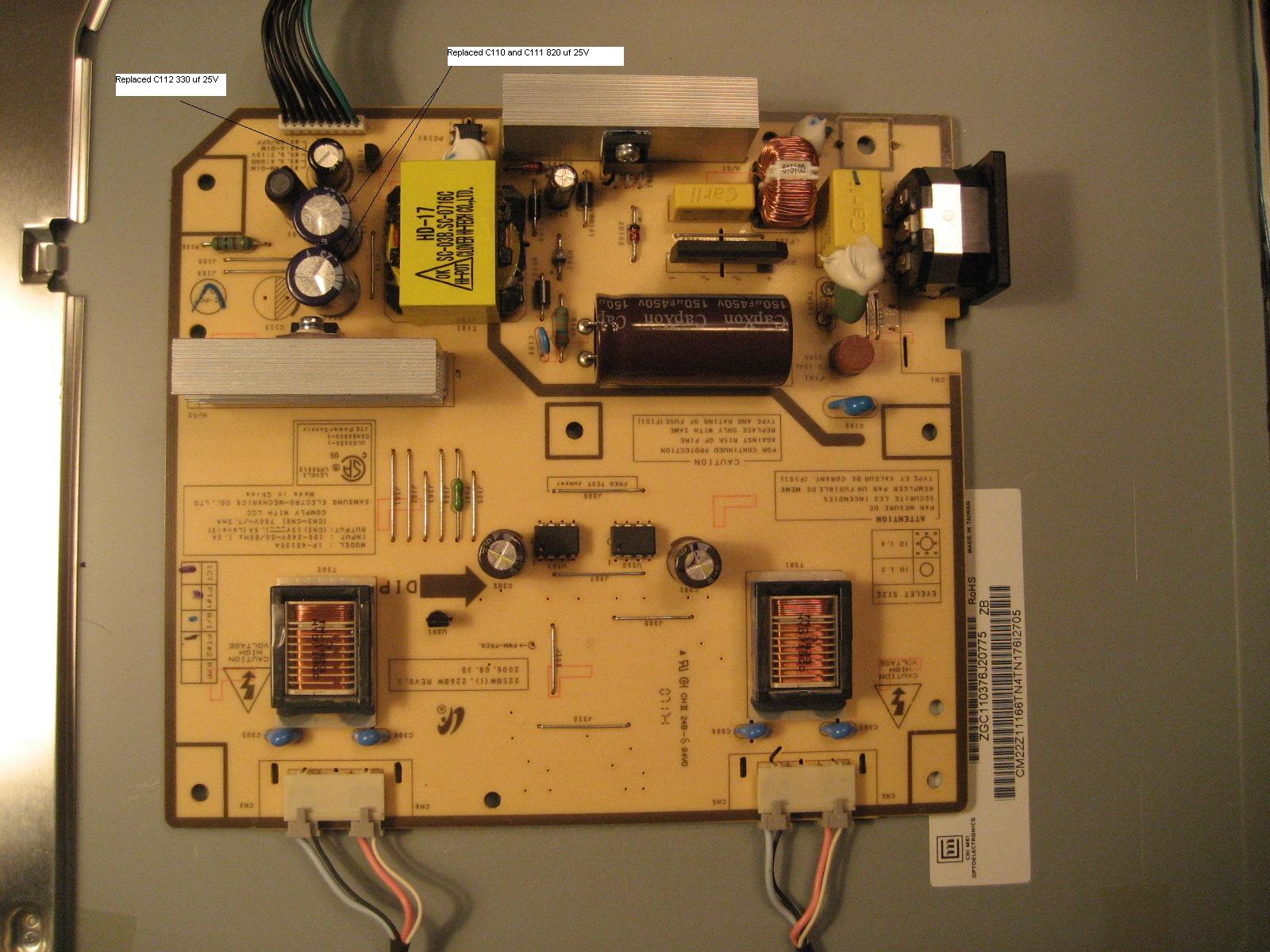

              For reference, can we get a pic of your board? I'm checking your choices and will post back later.

                Thanks Toasty.
                BTW, I just noticed that I mangled the locations in my list (e.g. multi C107s and C113s). That's "Cut-n-Paste" damage
                Upload shortly

                    THANKS TOASTY!!
                    Here is pic as well.

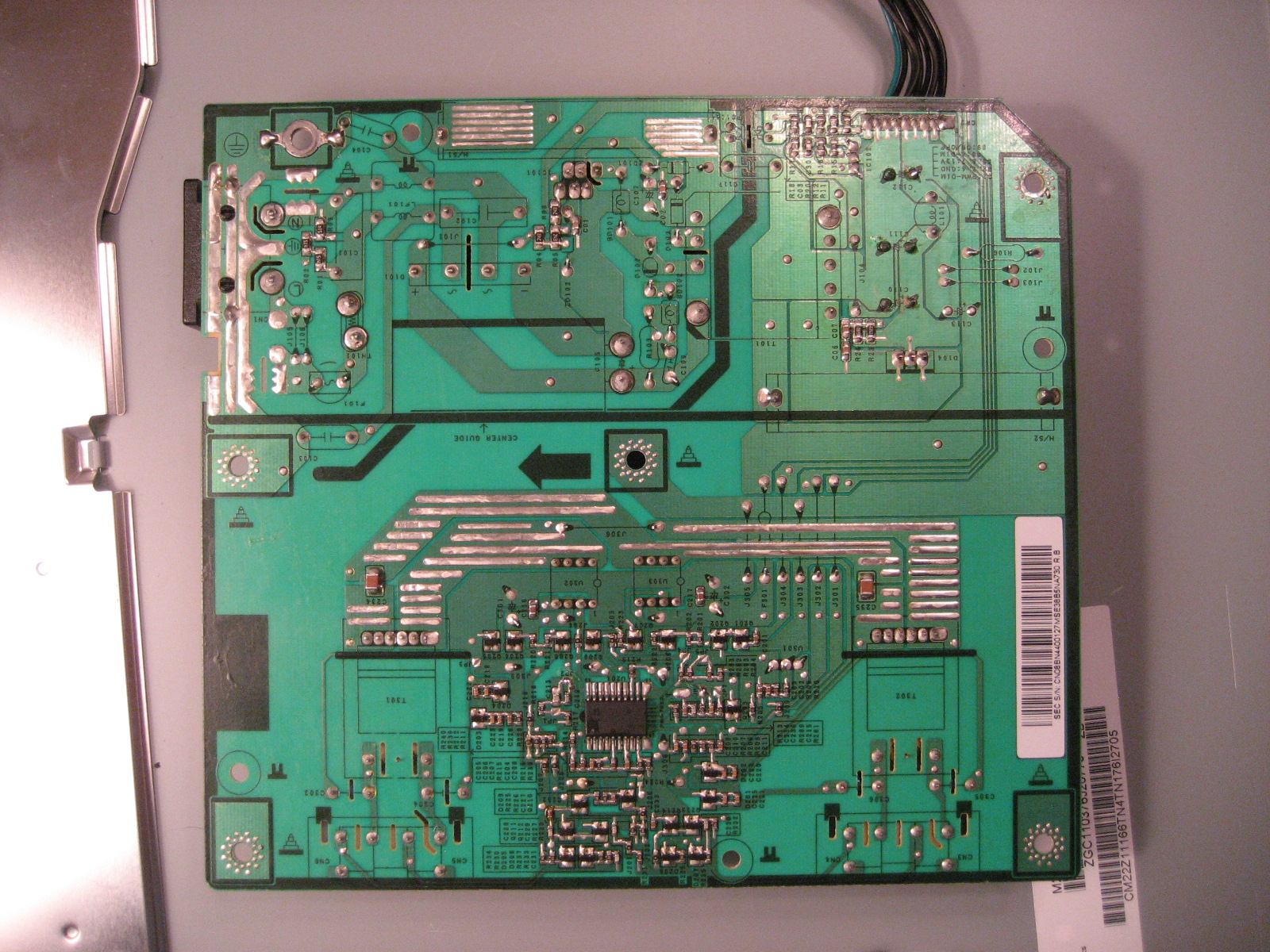

                                      My Son has a Samsung Syncmaster 226BW. When you turn it on it shows the analog box then goes black. The on button stays blue and does not blink. After reading the post for the 225 I took it apart and the caps looked good, but I replaced C110, C111 and C112. I then read further and found I can shine a flashlight into the screen and see the faint desktop. So it appears to be a backlight problem. I have checked the fuse and it appears to be good.
                                      Not sure if changing the other caps would help any at this point. What components are usually to blame for no backlighting? any further direction would be appreciated.
                                      Didn't know the warranty was 3 year, but my son has no record or receipt for when he bought the monitor.

                                        I'd check the date of manufacture lable on the back. If it's been less than 3 years, you might want to try to get it repaired under warranty.
                                        If it's been more, you don't want to wait for warranty, etc., then good pictures of the top and bottom of the power supply / inverter board are helpful. It is especially helpful if the picture of the top is taken with the CCFLs hooked up. Also, quite often the leads to the CCFLs are of two different diameters due to heavier insulation on the drive leads. Note this on the pictures.
                                        PlainBill
                                          #40
                                          Re: Samsung SyncMaster 226BW
                                          Thanks PlainBill
                                          The monitor is in Warranty. I have two problems though. First I don't have a receipt and second I have replaced some capacitors and managed to damage on of the old ones so it can't be put back.
                                          I wasn't going to work on it but since we had no proof of purchase I figured I had nothing to loose. Just fixed my 2 year old Samsung 46" LCD TV this week with bad caps and thought I would get lucky on the monitor.
                                          I have attached the pics of the top and bottom of the power supply / inverter board.
