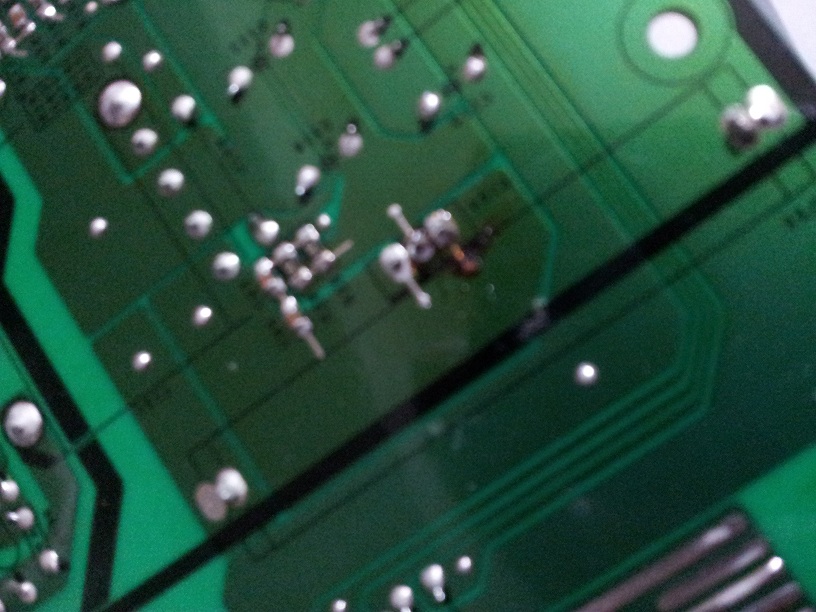

          I then was looking at the tracks and spotted the marks in the attachment. They are located by D104. Replace, clean it? I've got rubbing alcohol. I've got rusty soldering skills and a basic soldering iron as well. Been thinking might get a kit to test my skills out on as well.

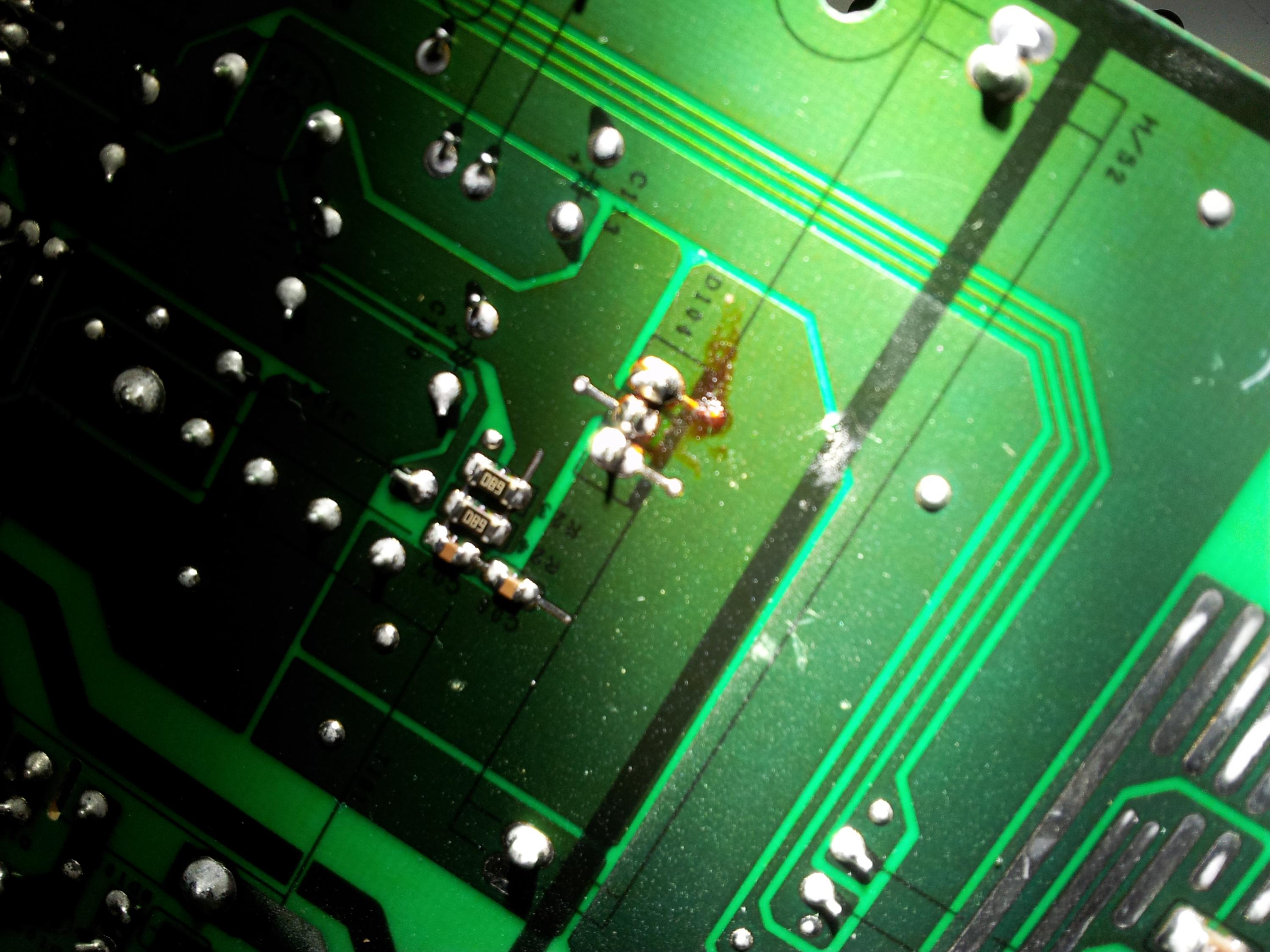

            Picture from above and showing that D104 chip as well. The legs of that don't appear too crash hot.
            Anyone replaced that before? Appears to have either glue or thermal paste on the rear of it onto the heatsink. Blulging caps are visible here as well.

              Bottom board pic is too blurred.
              The legs of that don't appear too crash hot. ?? Aus idiom?
              It will be thermal paste - may be ok when caps are replaced - it will have been running hotter because of them - (if its not gone altogether)
              If you do decide to take it off take care to replace any electrical insulation
              tabs or collars it might have ( Depending on type it might not have any so dont worry if it has not)

                Ok this photo appears better
                  Re: Samsung SyncMaster 226BW
                  So could the crud on the legs be thermal paste that has run hot and melted down the legs coating them?
                  If that is the case once I have the caps on, rubbing alcohol will sort that out and maybe some new thermal paste as well.
                    The brown on the back of the board looks like flux can be cleaned off with your alcohol. Still cant tell what is wrong with the legs - maybe just a bit of heat/oxidation - I dont think its a problem - might clean off if you want to try.
                    I would just get the new caps in then go from there.
