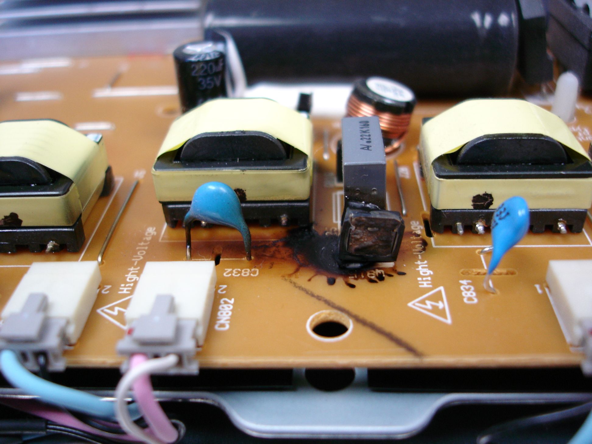

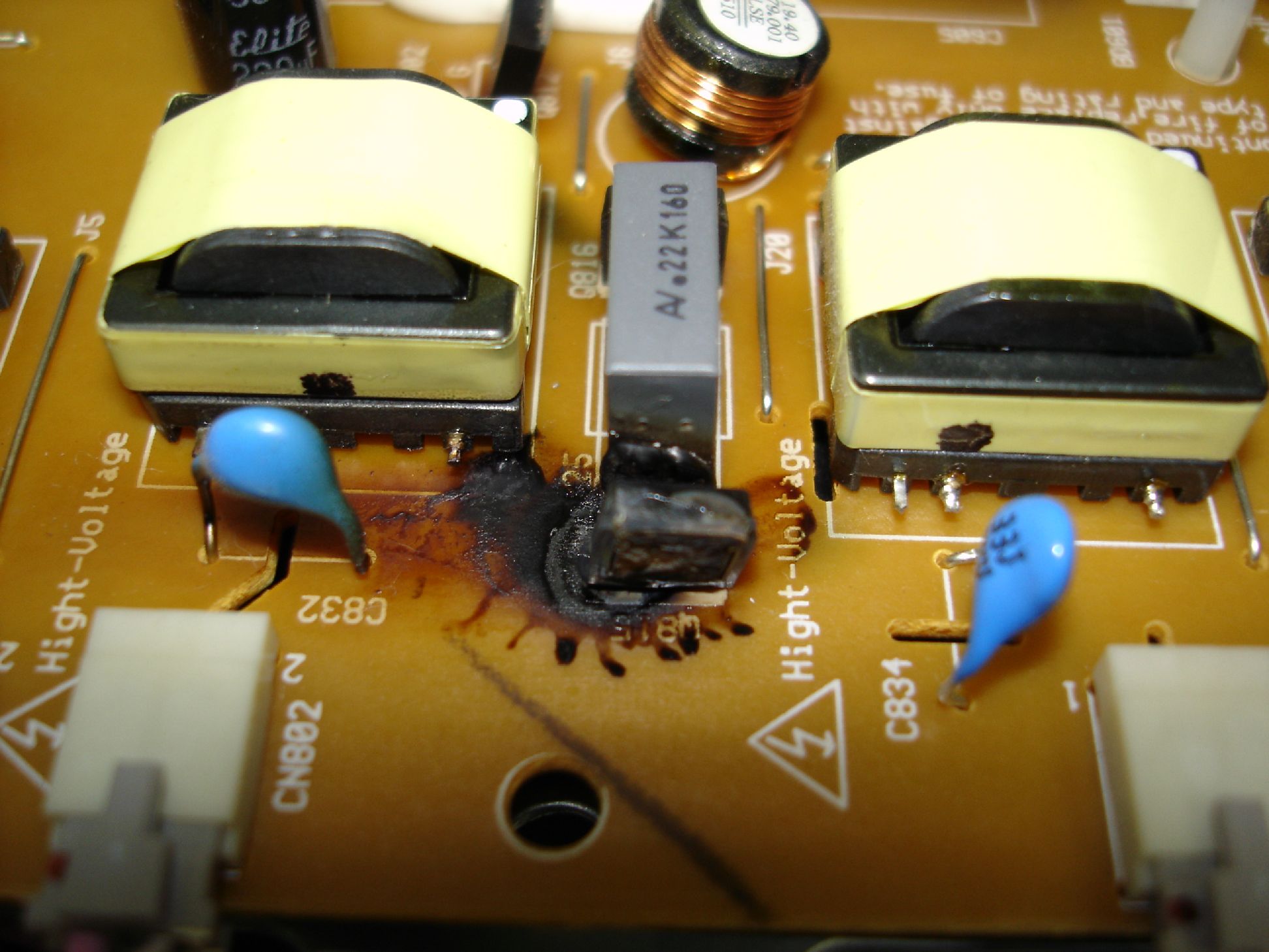

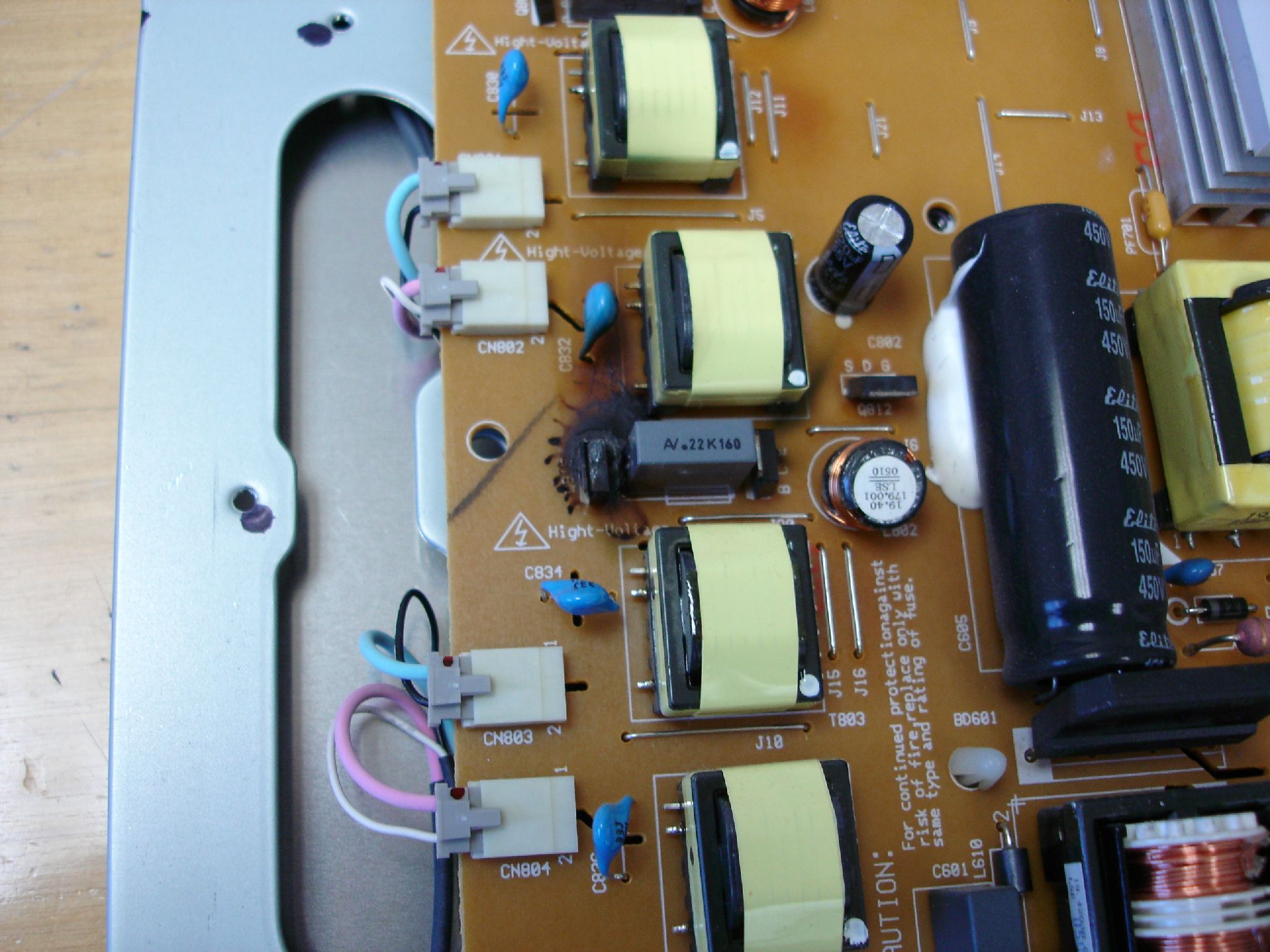

                                I have just recieved a dead HP 1955 monitor that once opened shows a spectacularly blown up c5707. Seems like a very common theme!
                                  Re: Another bad HP 1955 Inverter... probably
                                  Hello Simon
                                  You may have a bigger problem here by what you say above,
                                  2SC5707,s do not show any visual signs of damage even when shorted, when you examine them in my experiences, and I have never found a thread that had posted on that either.
                                  Best get some help, post Pictures of top and bottom of board, a lot of the lads would like to see this, and they will help you out as well.
                                  bob
                                      All right, bugger! Well here is the full carnage from this component letting out it's smoke. Any ideas? So you think if I replace it the same thing will happen again?
                                        Just noticed - how do you like the misspelled Hight Voltage right next to it haha
