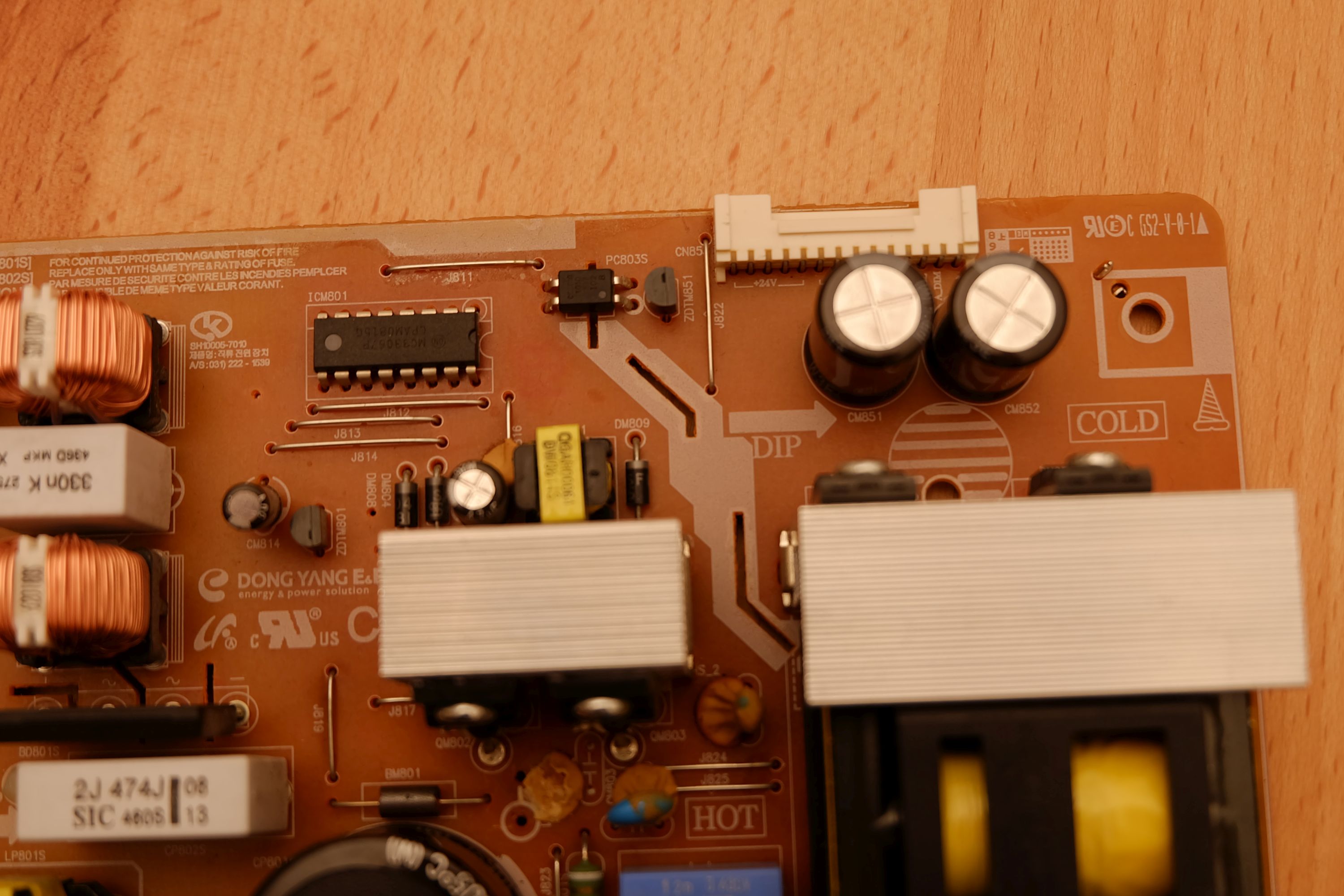

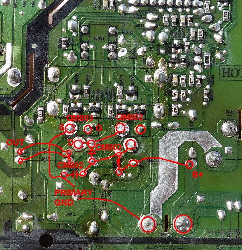

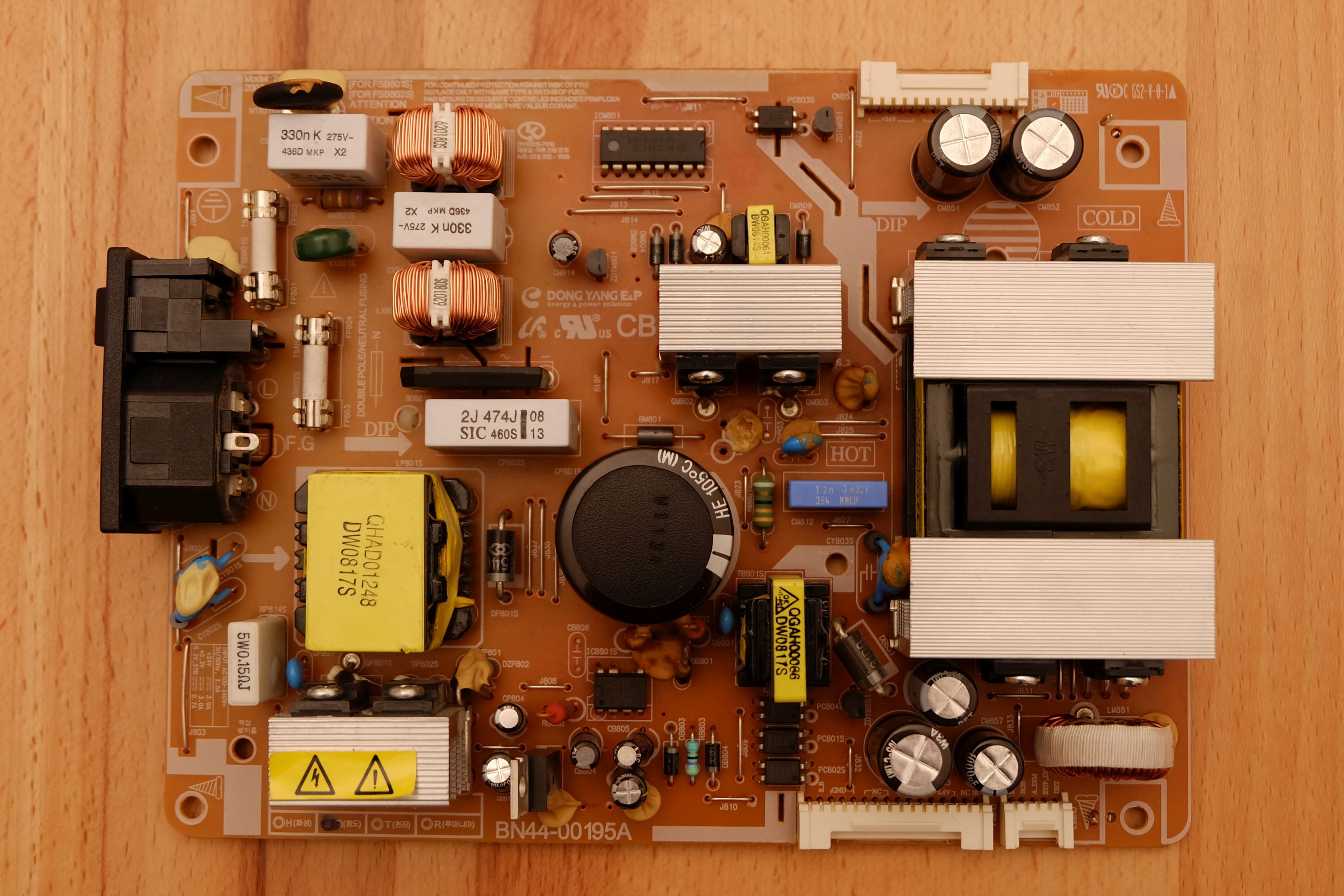

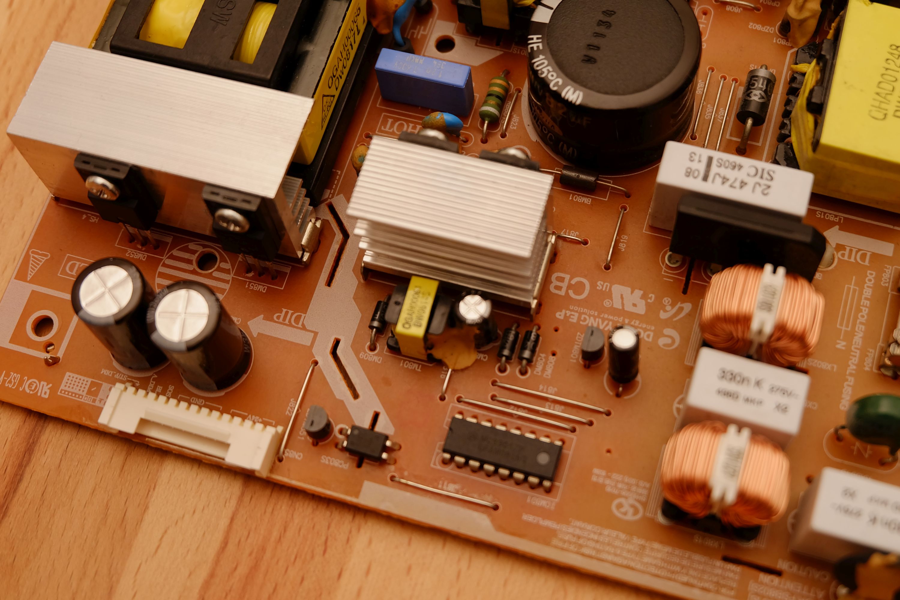

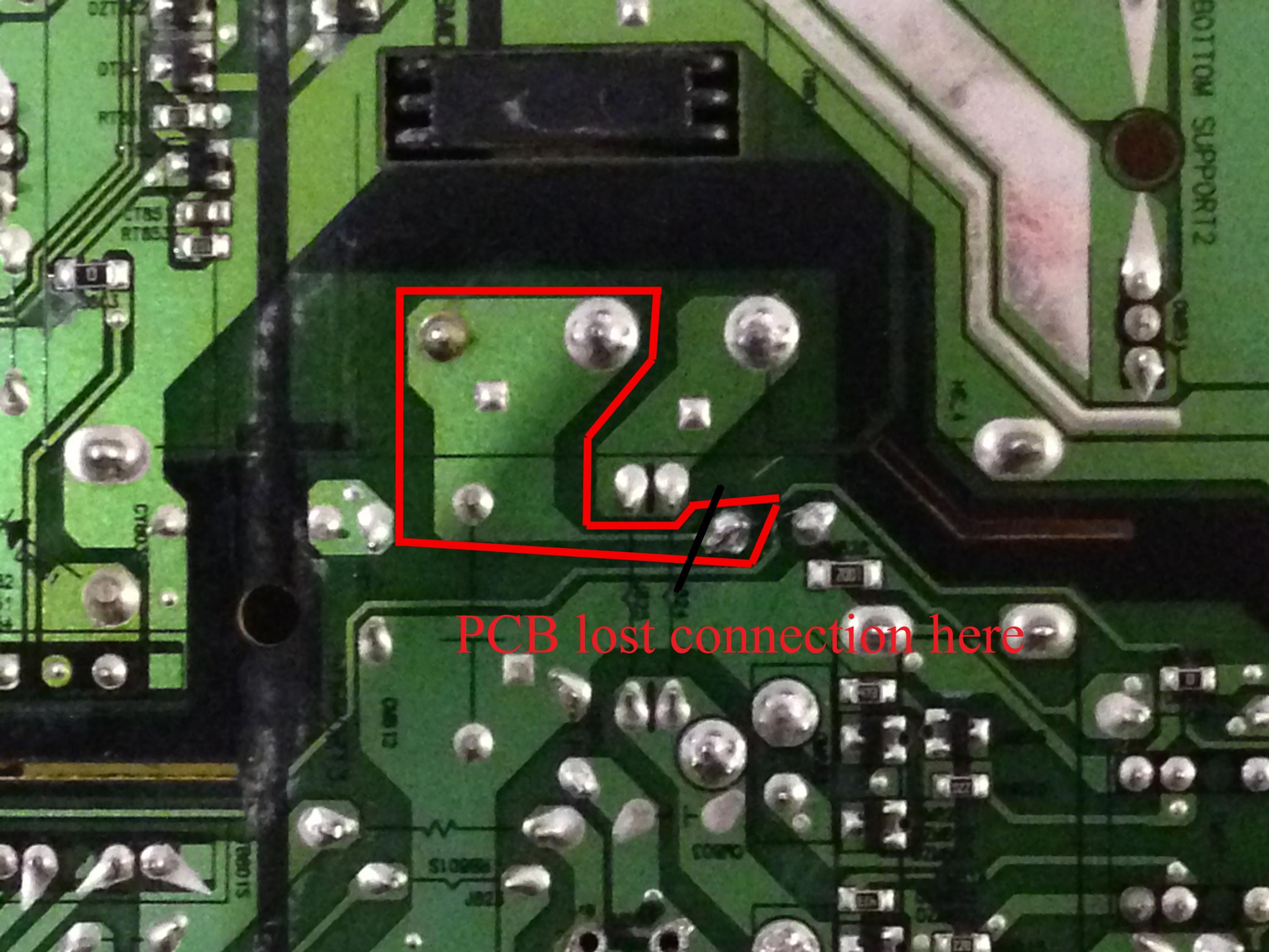

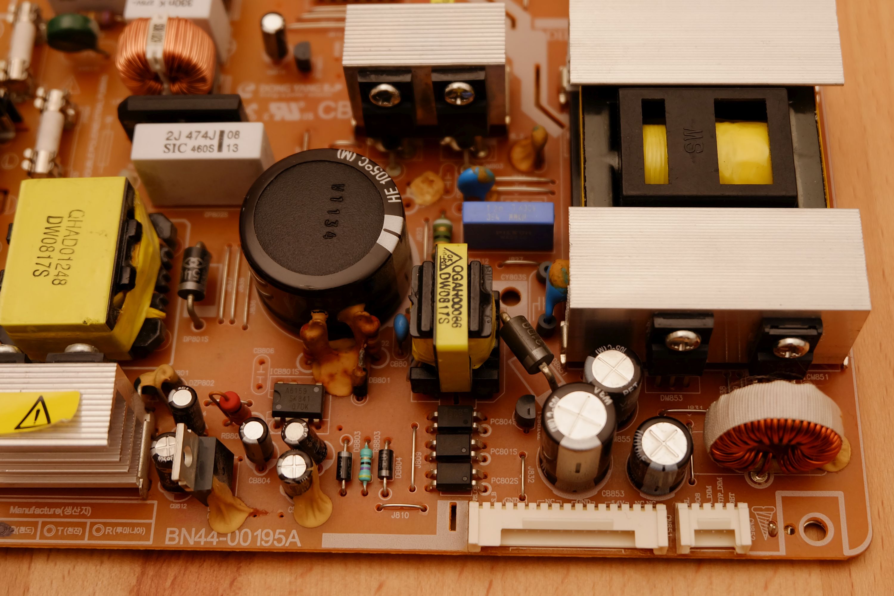

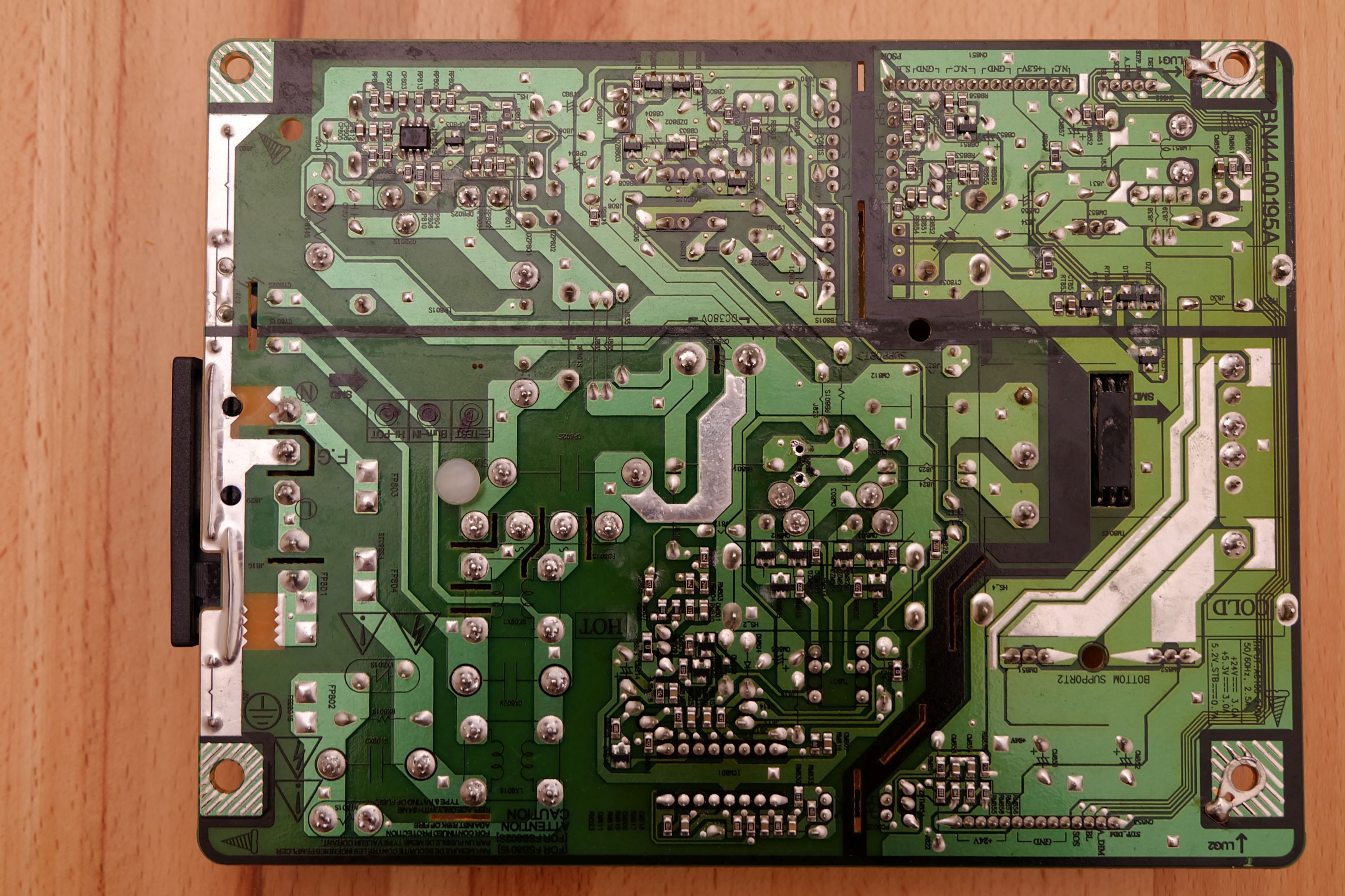

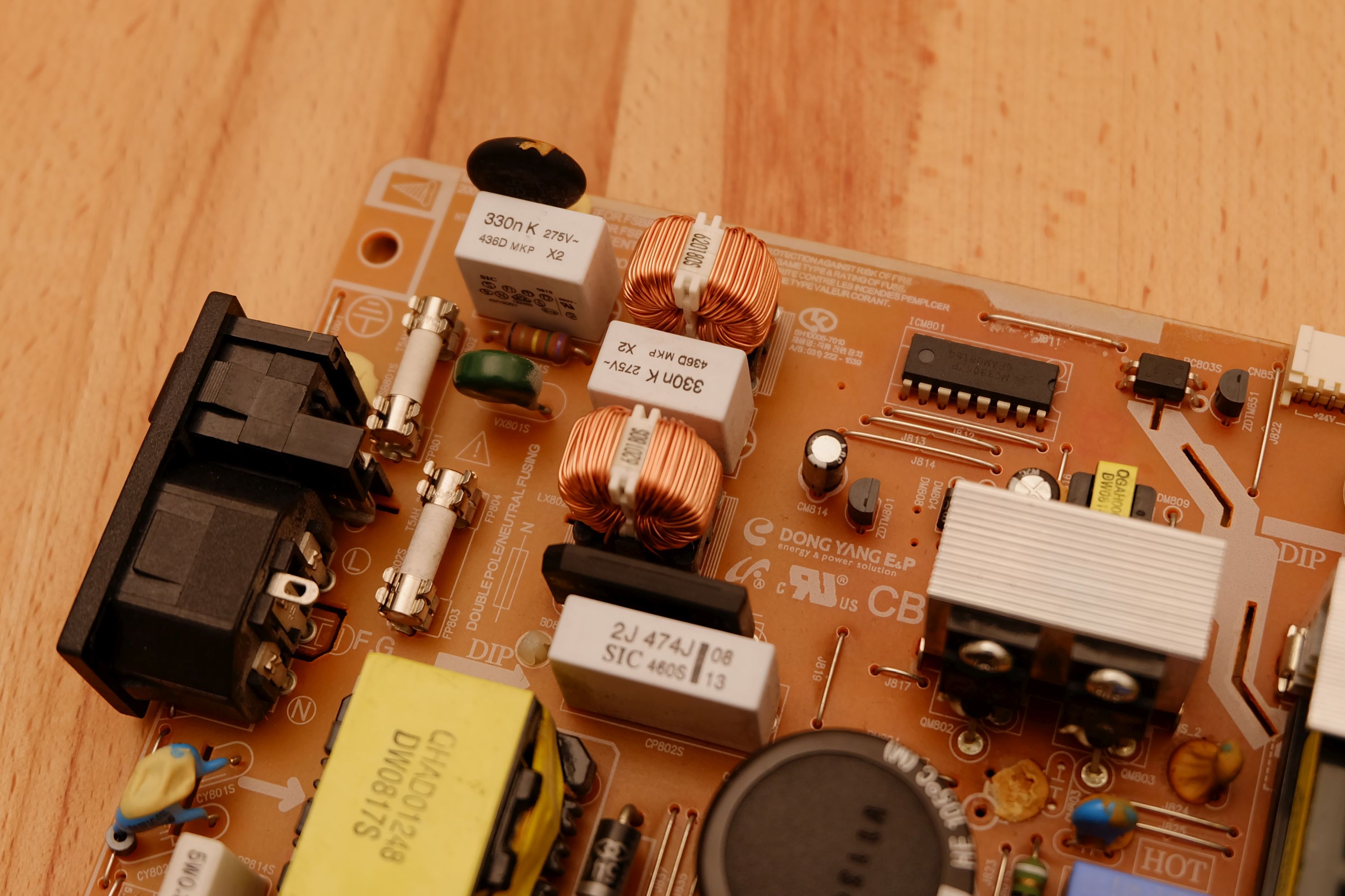

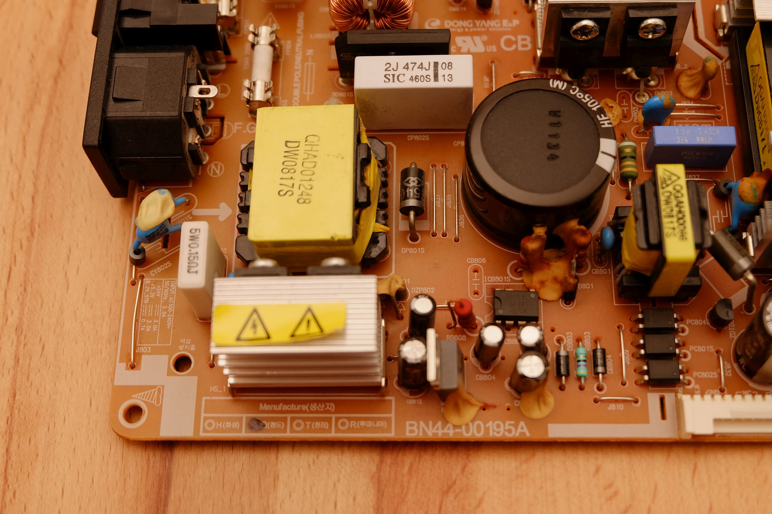

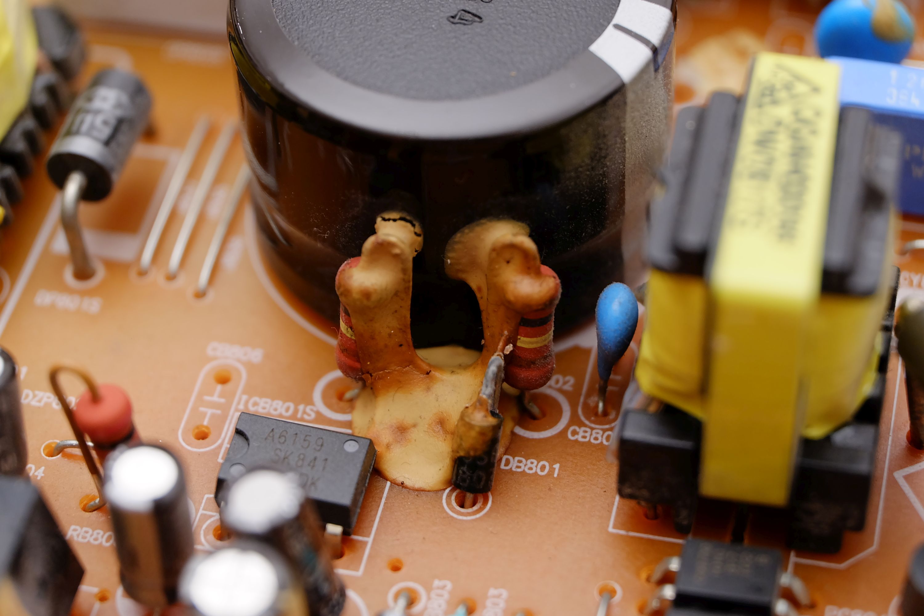

Re: [Syncmaster 245B Plus] Problems with power board BN44-00195A
So I can leave the MOSFETs in board for the measurment?
[Syncmaster 245B Plus] Problems with power board BN44-00195A
Re: [Syncmaster 245B Plus] Problems with power board BN44-00195A
As explained and as you can see the marking I made on the board, you still have shorted circuit on the board since the the Cm802 shows OL. You need to check those Two MOSFETs by checking the resistance between S and D pin for low resistance.
Btw, leave out the resistor for now when checking the MOSFETs.Last edited by budm; 10-26-2016, 12:10 AM.Leave a comment:
Re: [Syncmaster 245B Plus] Problems with power board BN44-00195A
So the cap CM802 did not show 0.5 Ohms reading off the board that means the short circuit has to be top MOSFET QM802 is shorted or the cap CM803 which is connected in PARALLEL with QM802 is shorted, but for sure QM803 is shorted for sure for you to get 0.5 Ohms on the CM802'S solder pads because QM802 is connected in SERIES with QM803.
"After replacing the fault transistor the new one burned instantly." So which fault transistor is that?
See the pictures to see how those parts are connected to form the circuit.Leave a comment:
Re: [Syncmaster 245B Plus] Problems with power board BN44-00195A
So the cap CM802 did not show 0.5 Ohms reading off the board that means the short circuit has to be top MOSFET QM802 is shorted or the cap CM803 which is connected in PARALLEL with QM802 is shorted, but for sure QM803 is shorted for sure for you to get 0.5 Ohms on the CM802'S solder pads because QM802 is connected in SERIES with QM803.
"After replacing the fault transistor the new one burned instantly." So which fault transistor is that?
See the pictures to see how those parts are connected to form the circuit.Leave a comment:
Re: [Syncmaster 245B Plus] Problems with power board BN44-00195A
"The varistor above J824 its CM809 and shows ~1.99 kOhm. There is a 2nd part which looks like varistor called CM802 which only has a resistance 0.5 Ohm. "
CM = CAPACITOR. You need to remove those caps to measure the resistance off the board, good cap should show open circuit.Leave a comment:
Re: [Syncmaster 245B Plus] Problems with power board BN44-00195A
Sometimes happens that pcb copper film breaks away, and then the only solution is to fix the circuit by soldering some wire. Of course must be careful that the connections are electrically similar as before. Some glue (non conducting hot melt glue) can be helpful in this situation too.Leave a comment:
Re: [Syncmaster 245B Plus] Problems with power board BN44-00195A
Sometimes happens that pcb copper film breaks away, and then the only solution is to fix the circuit by soldering some wire. Of course must be careful that the connections are electrically similar as before. Some glue (non conducting hot melt glue) can be helpful in this situation too.Leave a comment:
Re: [Syncmaster 245B Plus] Problems with power board BN44-00195A
"The varistor above J824 its CM809 and shows ~1.99 kOhm. There is a 2nd part which looks like varistor called CM802 which only has a resistance 0.5 Ohm. "
CM = CAPACITOR. You need to remove those caps to measure the resistance off the board, good cap should show open circuit.
Leave a comment:
Re: [Syncmaster 245B Plus] Problems with power board BN44-00195A
"The varistor above J824 its CM809 and shows ~1.99 kOhm. There is a 2nd part which looks like varistor called CM802 which only has a resistance 0.5 Ohm. "
CM = CAPACITOR. You need to remove those caps to measure the resistance off the board, good cap should show open circuit.Leave a comment:
Re: [Syncmaster 245B Plus] Problems with power board BN44-00195A
The SI-8008HFE is behind a coil, the one on right side. It has five legs. All other similar looking components on board have only three legs.
The most suspicious glue is there near the biggest electrolytic capacitor, it seems to have some color changes. I'm not a big believer of the 'glue theory', at least multimeter measurements (resistance) have shown nothing extraordinary. I think the glue must have had some enviromental changes (raise of temperature, burning) to become conductive. But I'm not a 'professor' in these things. If only a millimeter or half is the distance between component legs, and glue is located there 'connecting them', it might be better to remove the glue somehow using a knife etc.
I still have a spare '195A' (which is probably broken however). There seems to be different type of glue in the legs of FQPF9N50C mosfet transistors, which are in the middle of the board near the 'huge capacitor'. That seems pretty suspicious to me...I think there might be some glue in your '195A' too. I would remove that glue.
I have replaced some electrolytic caps and resistors of four 245B:s, each having '173A' board. Those have since then worked without problems. Never done any SMD repair for that version of power board.Last edited by euromatlox; 10-17-2016, 04:22 PM.Leave a comment:
Re: [Syncmaster 245B Plus] Problems with power board BN44-00195A
You can check the 8008HFE regulator if it's shorted or otherwise broken. I did replace that part in my '195A' expirement, since the readings I got using a multimeter felt abnormal. There are also three electrolytic capacitors quite near it, I recommend replacing them all, although they seem to be okay in the picture.
https://www.semicon.sanken-ele.co.jp...il/SI-8008HFE/
You might also want to check some SMD parts too:
https://www.badcaps.net/forum/showth...t=18966&page=2
https://www.badcaps.net/forum/attach...4&d=1476304736
Check the resistance between the two legs of that small blue cap covered all over with glue, it is just above jumper J824, that is one of the high Voltage section.
You also have lots of glue on the resistors by the ICB801S.
See what bad glues will do to your board.
https://www.badcaps.net/forum/showth...ight=bad+glues
The two resistors you mentioned are RB802 and RB801. one has 72 the other 75 kOhm. Seems fine to me. Anyway do you have a tip how to get rid of the glue without damaging any components? What do you use?Leave a comment:
Re: [Syncmaster 245B Plus] Problems with power board BN44-00195A
https://www.badcaps.net/forum/attach...4&d=1476304736
Check the resistance between the two legs of that small blue cap covered all over with glue, it is just above jumper J824, that is one of the high Voltage section.
You also have lots of glue on the resistors by the ICB801S.
See what bad glues will do to your board.
https://www.badcaps.net/forum/showth...ight=bad+gluesLast edited by budm; 10-13-2016, 09:14 PM.Leave a comment:
Re: [Syncmaster 245B Plus] Problems with power board BN44-00195A
You can check the 8008HFE regulator if it's shorted or otherwise broken. I did replace that part in my '195A' expirement, since the readings I got using a multimeter felt abnormal. There are also three electrolytic capacitors quite near it, I recommend replacing them all, although they seem to be okay in the picture.
https://www.semicon.sanken-ele.co.jp...il/SI-8008HFE/
You might also want to check some SMD parts too:
https://www.badcaps.net/forum/showth...t=18966&page=2Last edited by euromatlox; 10-13-2016, 03:44 PM.Leave a comment:
Re: [Syncmaster 245B Plus] Problems with power board BN44-00195A
Hi guys,
thank you for your replies. I added some pictures of the pcb. Tbh I dont know how I can remove the glue without damaging some of the components. Its very hard to remove all the glue with a screwdriver or something similar. The burned resistor is missing in the pcb because i soldered it out already.Last edited by FredFloete; 10-12-2016, 02:49 PM.Leave a comment:
Re: [Syncmaster 245B Plus] Problems with power board BN44-00195A
Did you remove ALL the glues?
Snubber cap CM810 not shorted?Leave a comment:
Re: [Syncmaster 245B Plus] Problems with power board BN44-00195A
After I took a look at the power board if found a blown resistor with the number RM801 (22 Ohm, 1W). The two fuses were also blown. I replaced the resistor and the two fuses and gave it another shot. What could I say. Seconds after putting the power back on the same resistor has been blown again.
So I tried to find more faulty components on the power board. It seems that the diodes DM804 and DM809 are also faulty. I tried to test them with my multimeter and current flows in both directions. As far as I can tell QM802 and QM803 are still fine.
So at the moment I've no clue what caused this damage and I'm sure when I replace the diodes too everything will blow up again.Leave a comment:
Re: [Syncmaster 245B Plus] Problems with power board BN44-00195A
I have installed '173A' inside a 245B plus, which model originally had '195A'. Very easy replacement, but of course must be careful, for instance that black plastic insulating piece under the board must not be forgotten.
SMD components are those very very tiny (and usually black color) components in the other side of the power board. In my '195A' it was a smd zener diode, which was broken. I replaced it and some caps - board worked for a while, but soon stopped working. I ended up using '173A' instead.
I have heard that the glue they use around the board can become conductive, that might be one explanation. Those carbon resistors are originally only 1W (power) resistors. In '173A' it's common that some of those three serially connected 68ohm 1W resistors will burn in (long) time. Recommended is to replace them with 68ohm 2W (or 3W) resistors. I have personally replaced also the other two 'upward' resistors (which usually have some glue in them) with bigger wattage ones.
If resistor burns immediately or very soon, and possibly with some smoke in the air, then it indicates some kind of short circuit somewhere.Last edited by euromatlox; 10-11-2016, 12:53 AM.Leave a comment:
Re: [Syncmaster 245B Plus] Problems with power board BN44-00195A
For BN44-00173A it is recommended to replace at least 4 electrolytic caps and three 68ohm resistors. To be more safe, some other resistors and caps can be replaced too. You can easily find information about this procedure.
It's common that that '195A' has some broken smd components too.
And what did you mean by saying the 195A has some broken smd components? In case of a failure or in general? Can you imaging what causes the error of the burning resister on my power board?Leave a comment:
Re: [Syncmaster 245B Plus] Problems with power board BN44-00195A
Best option is to use board BN44-00173A instead. Of course before buying/trying that it's recommended to check that other parts (boards) are ok. Those board also cost some money, and you must also decide what is your limit to spend.
For BN44-00173A it is recommended to replace at least 4 electrolytic caps and three 68ohm resistors. To be more safe, some other resistors and caps can be replaced too. You can easily find information about this procedure.
It's common that that '195A' has some broken smd components too. If you like to battle with that board, search some older information in this forum, for instance:
https://www.badcaps.net/forum/showthread.php?t=22008Leave a comment:
on this laptop hp g72 b52sf i have screen problems as you can see with the photo joined in attachments.
the used graphic card is "intel hd graphics" and the id of the integrated screen is : "monitor/SEC3354".
i verified the driver of the péripherals and they are ok. i verified the definition and settings of the graphic card and of the screen : definition 1600x900 and refreshment frequency :60hz. (they are the sames for the graphic card and the screen).
i don't understand the reasons of the white stripe at the bottom of the screen below the task... -
by HondamanRecently I discovered my SSD died (OCZ/Toshiba 240 GB). It was in a USB enclosure, attached to the Linksys WRT-AC1200 router. Since then I removed the USB enclosure and attached it to my Win7 PC (AMD 8150 CPU, 970 chipset, 64 GB RAM). I also gathered one or two other USB enclosures to figure out what is going on.
(I suspect that I lost quite a few MP3 and FLAC files I recently ripped from my audio CDs, I think I lost very little un-replaceable stuff.)
I think it is IMPOSSIBLE for Win7 to have any problems with a USB enclosure as long as Win7 knows how to speak to the...-
Channel: General Computer & Tech Discussion
by clabrNeed help to solve some problems with this laptop.
After working in bed with it one night and heating up too much (probably the cause of this problems) the sata HDD OS windows froze
After restart the original Sata HDD was not recognized anymore (but works fine in other laptops or PCs)
Tried connecting other good Sata 2.5 HDDs but not one is working in this laptop anymore (not the original nor others)
Before this had happened I observed some other problems:
When I tried replacing original mecanical HDD with a SSD HDD could not get them... -
by MandorHello people.
I have the samo problem as described in this thread:
https://www.badcaps.net/forum/showth...highlight=245b
The monitor was on standby and one day the screen (or just the backlight) would not turn on. Computer still recognized the monitor and was acting like it was there (5 screen setup). I switched the monitor off with the big switch by the cable, waited 5ish seconds and switched it back on. I heard a loud bang.
Both fuses blown, resistor blown, bad mosfets.
I checked most electrolitic caps in circuit and...-
Channel: Troubleshooting Computer Displays
by soopacrucialHi folks,
I'm new here and was wondering whether you might be kind enough to give me some advice on troubleshooting the following problem:
Quite a few years ago now, a couple of years from new, my Samsung Syncmaster 740BF LCD monitor starting playing up by making a buzzing noise and then the display would go blank. I seem to remember the blue power led would also go off when this happened but that I'm not 100% sure of. By pressing the power button I do remember I could at first get it working again but eventually the problem would come back. At the time I had read about...3 Photos-
Channel: Troubleshooting Computer Displays
- Loading...
- No more items.
Leave a comment:
