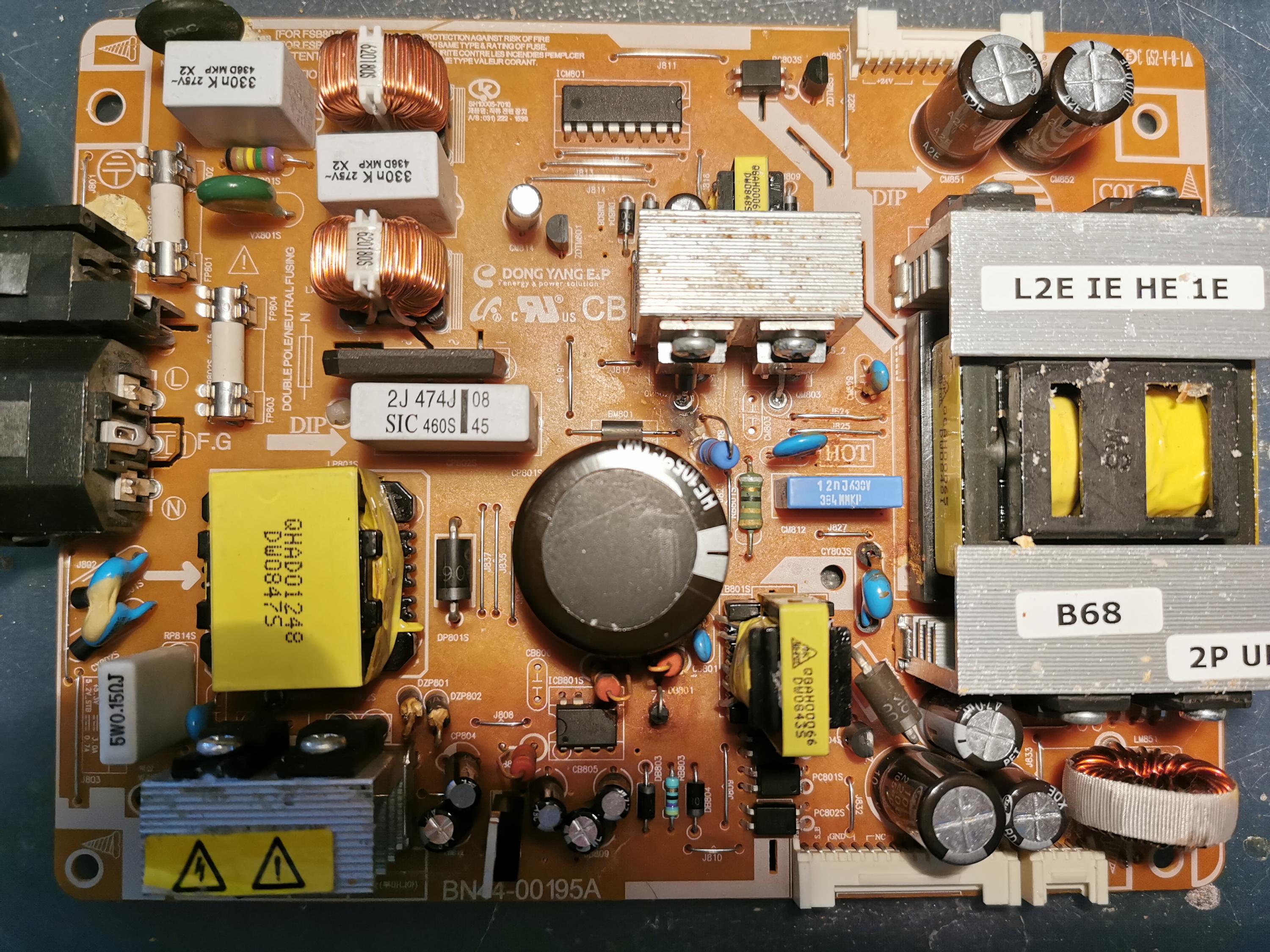

    Hello people.
    I have the samo problem as described in this thread:
    https://www.badcaps.net/forum/showth...highlight=245b
    The monitor was on standby and one day the screen (or just the backlight) would not turn on. Computer still recognized the monitor and was acting like it was there (5 screen setup). I switched the monitor off with the big switch by the cable, waited 5ish seconds and switched it back on. I heard a loud bang.
    Both fuses blown, resistor blown, bad mosfets.
    I checked most electrolitic caps in circuit and they show correct values.
    I have tried replacing all of that (user IRF840 I had laying arround - please don't judge) and it all blew up again when i turned it on.
    What do you guys suggest I check and should those things be desoldered first?
    Thank you!
    Re: Samsung Syncmaster 245b BN44-00195A
    First of all did you remove those brown glues? Those glues become conductive and corrosive and will eat up wires and traces, and since they are conductive it will also damage the circuits.

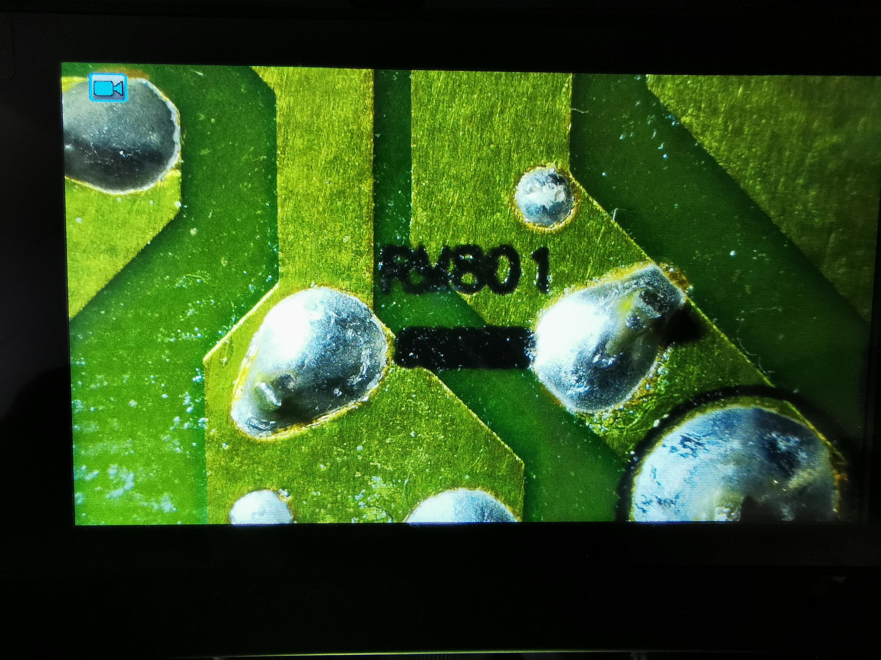

        The element marked BM801 is shorted both ways. Not sure what it is.

          BM801 is a ferrite bead on a wire, it acts like an inductor in the circuit, it will check shorted. The IRF840 are not insulated case like the original, so if used without an insulating kit, they will be shorted to the heatsink.

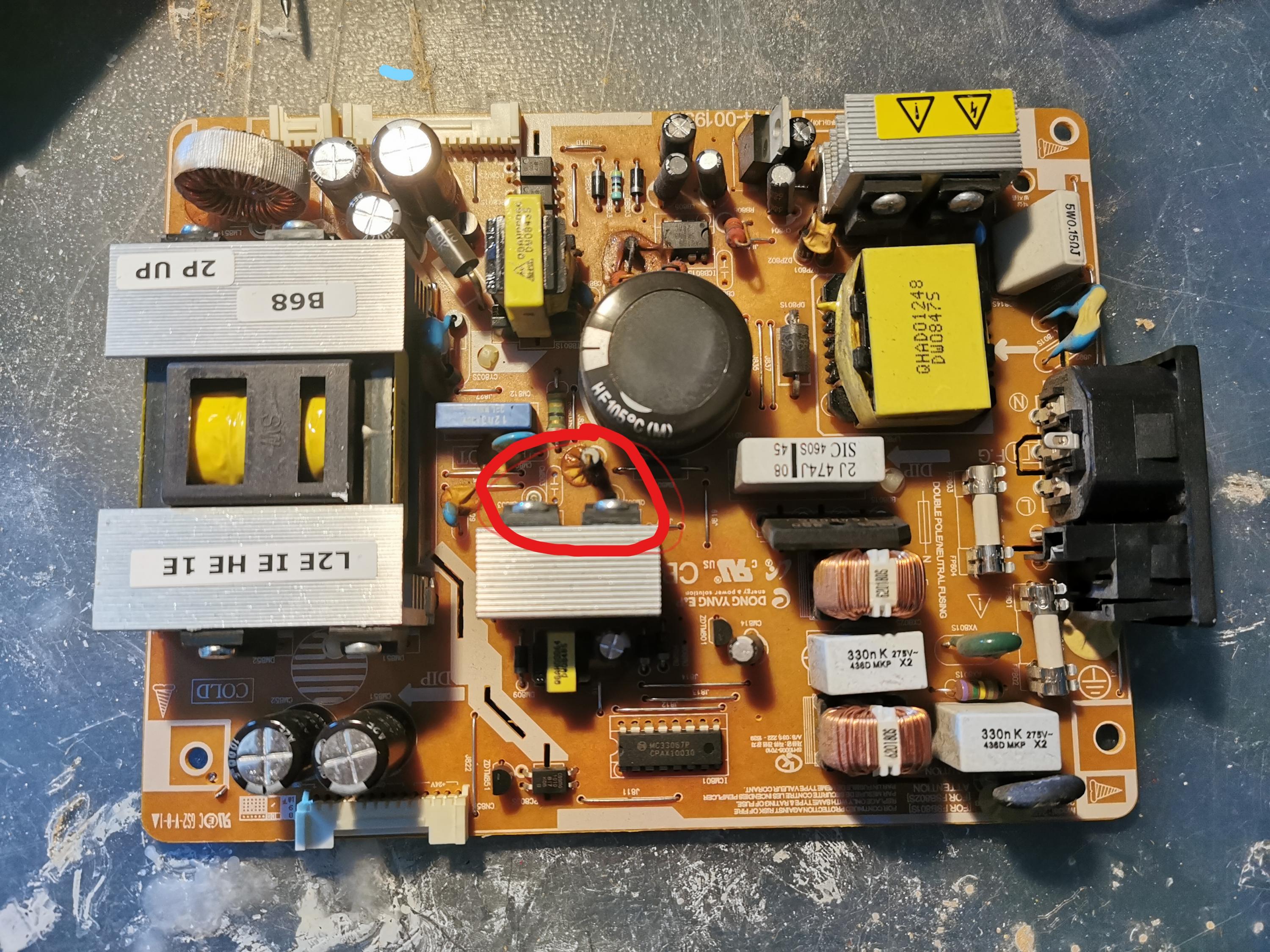

            I ordered some isolation pads and nipples as they call them.
            It was stupid to screw mosfets into heatsink without isolation.
            What else could I check? Why would the resistor be blown? I read it as 0,22 Ohm. Should I check anything else before I turn the power back on?
            In case it blows again even with all the goo cleaned up?

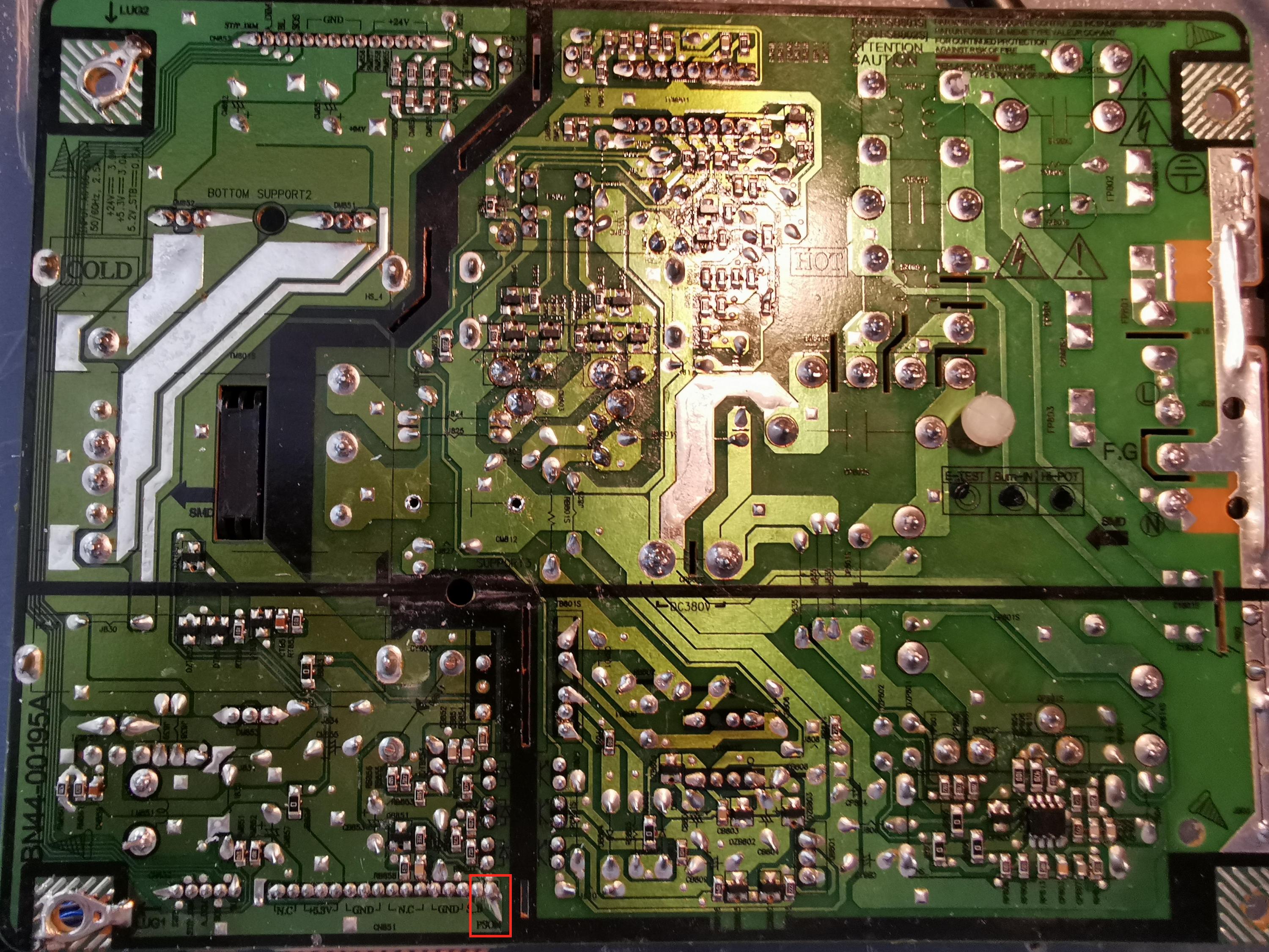

              I'm back at the biggining now. The power button is illuminated but no picture or light on the LCD. Windows recognize the monitor correctly.
              I tested the connector pins on the powerboard and i cant find any voltage between labeled gnd and 5.3V pins.
              Any bright ideas? It's been a long time since i learned this stuff in highschool, sorry if I sound like an idiot. :-)

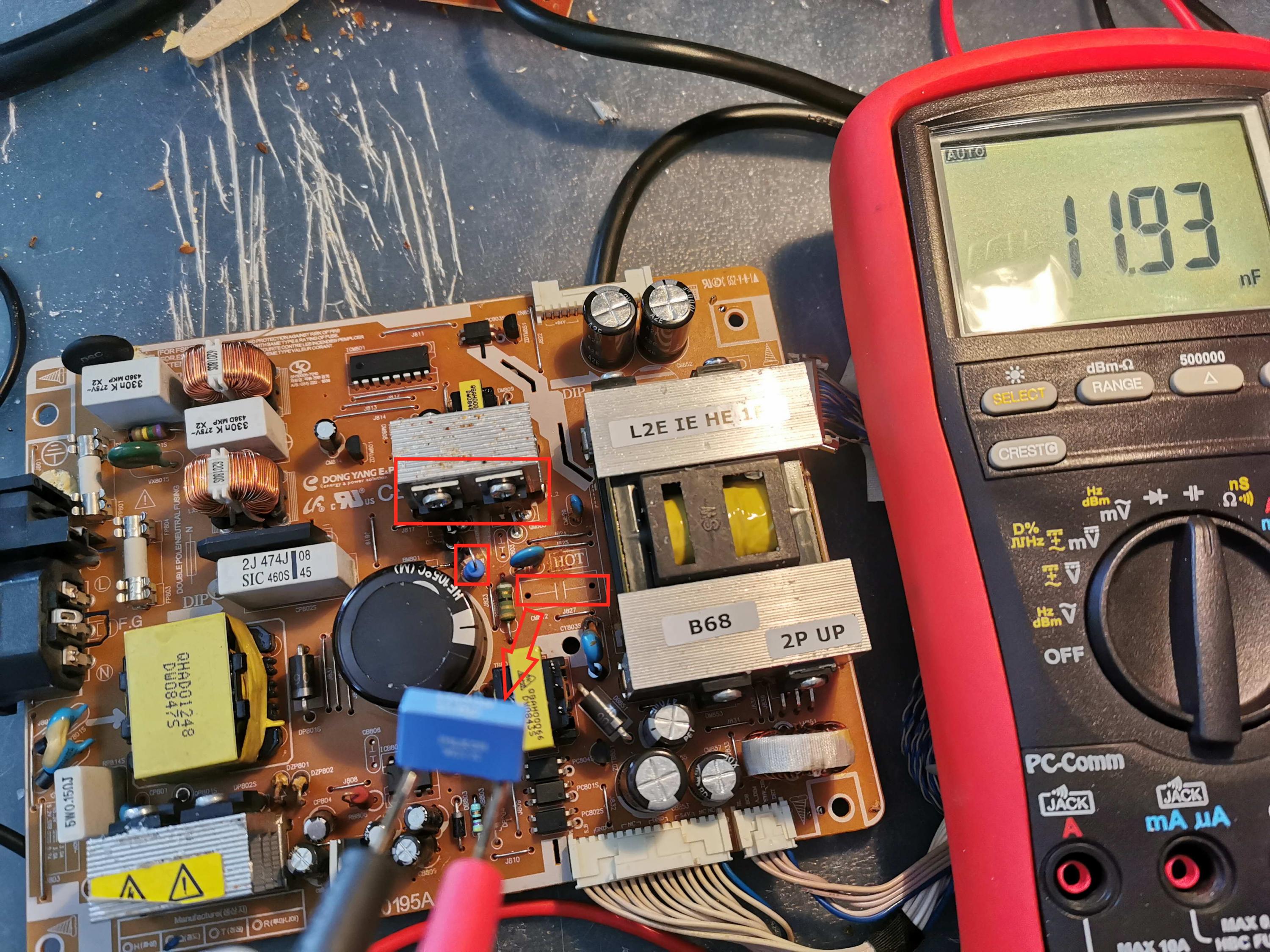

                  I think my board is a little bit different.
                  I Found the connector CN851 with fewer pins which has PSON and S_B. S_B has 5.23V.
                  The big electrolytic cap has 317V on it.
                  The only blue rectangular cap is CM812 12nJ630V measured out of circuit 12nF.
                  The new 0.22Ohm resistor measured in circuit 0.22 Ohm.
                  How do I go about verifying that PS_ON is present? PSON pin is 0.3V. I tried shorting S_B and PSON pins but big cap is stil 317V and not 380V and there is no voltage on 24V/5V pins.
                    You must disconnect the cable between the main board and the power supply board when forcing on the power supply or you may damage the mainboard.
                    With the cable connected, you should see the PSON pin go from .3v to 3~5v whenthe power button is pressed, ifit does'nt it is likely the mainboard is not sending the command.
                    With the mainboard/power supply cable disconnected, connecting S_B to PSON should turn on the power supply. if not you still have a problemonthe power supply board.
                    Check the voltage across CB806, it should be around 20vdc, then check the voltage across CP811, it should be around 16vdc when the power supply is forced ON.

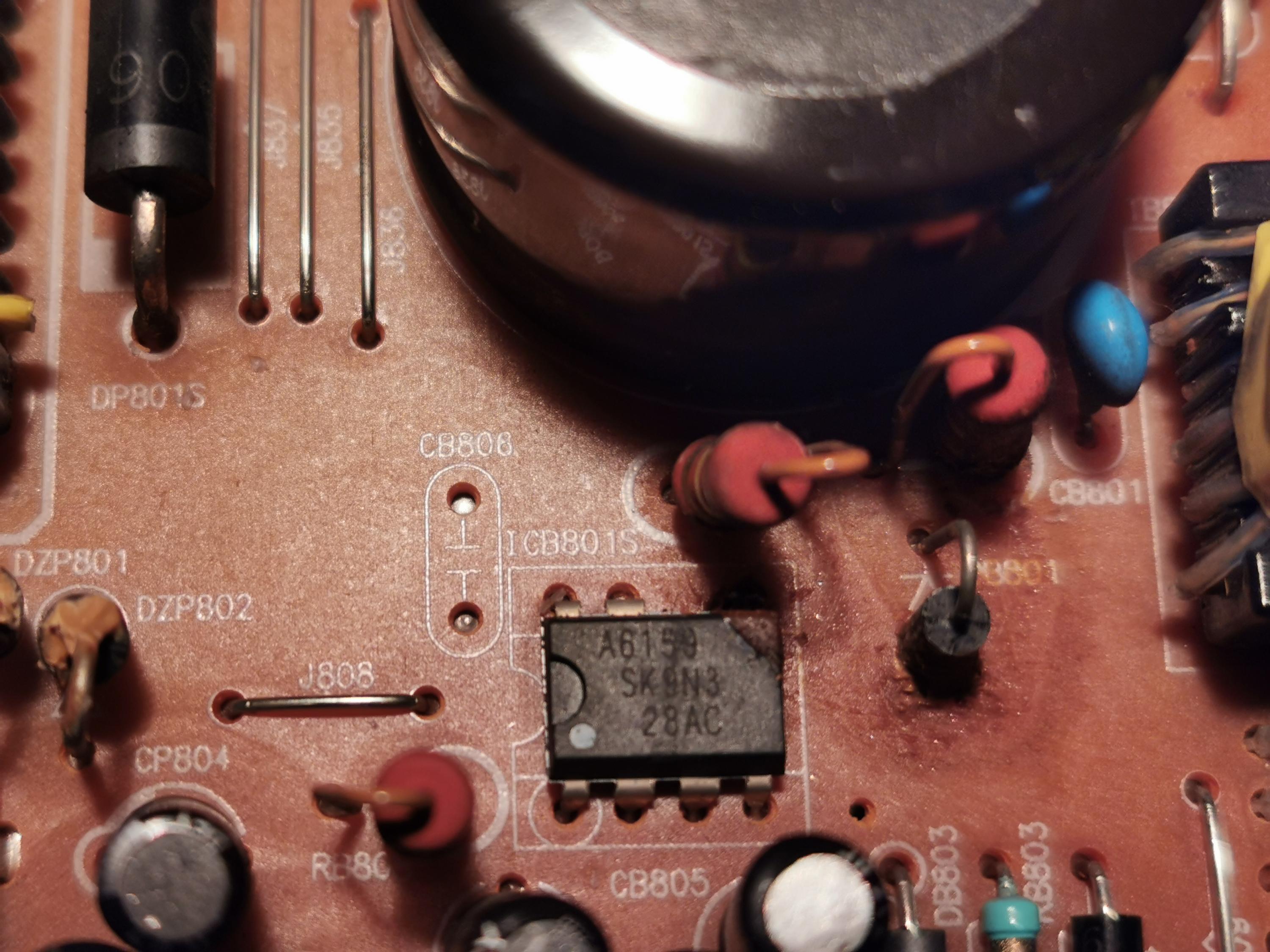

                          Check the voltage across CP804, this is the VCC for ICM801, (what is the number on ICM801)? is it MC33067?
                          The VCC should be on JB816 (use Hot ground to check this voltage)

                            ICM801 is MC33670P.
                            Positive side of CP804 is 10.43V relative to negative lead of big high-voltge cap. cap. It connects to VCC of ICP801S (pin 8) vis J806. ICM801 is on the other side of the board. ICM801 on it's VCC (pin 15) also has 10.39V. So i guess they are connected.
                            I think the jumper you are refering to is J816 on my board, not JB816.
                            I do have IRF840 insted original mosfets. The new 9N50C parts did arrive from Mouser but I don't know If I waant to risk blowing them yet.

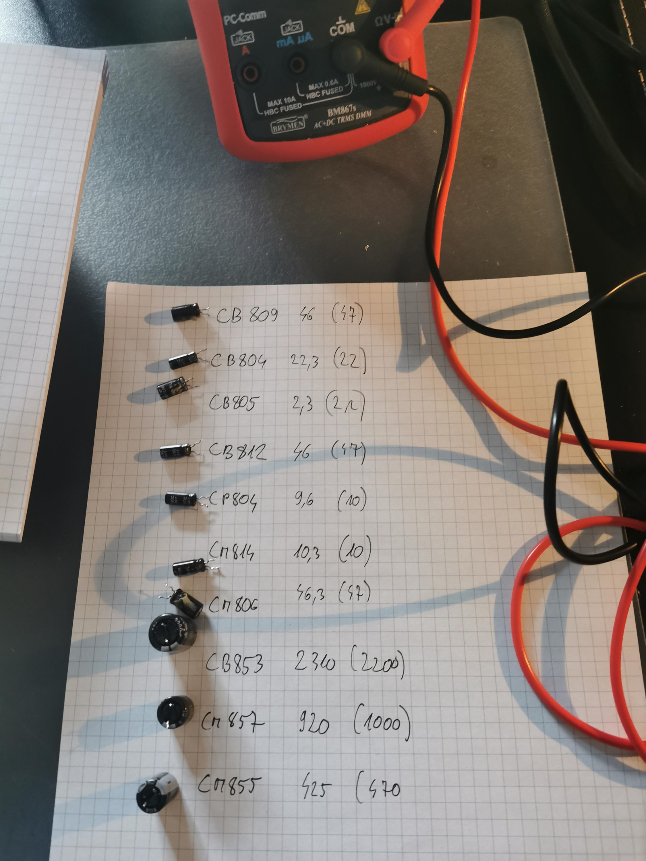

                                I took most of the electrolytic caps out and measured them and they all seemed fine on capacity test. Should i test in another way?
                                • R_J
                                  • Jun 2012
                                  • 9535
                                  Replace the ones on the VCC supply, Testers can show that the capacity is ok but in circuit they don't work
                                    Replaced all the electrolytic ones except the biggest one.
                                    Nothing changed.

                                      I also put in a new pair of correct mosfets. ICM801 and ICP801s still have 10.4V
