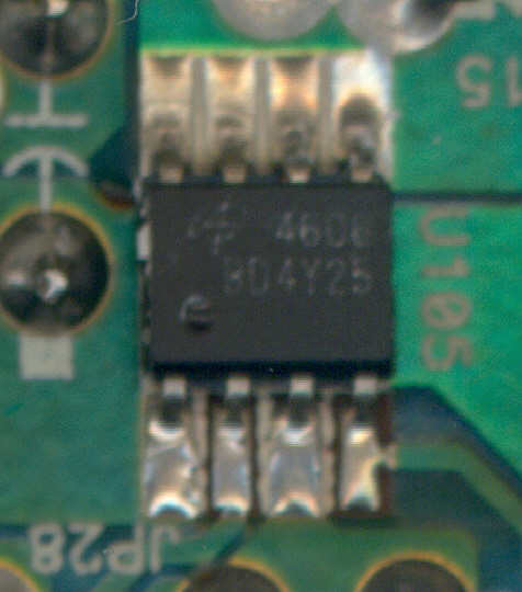

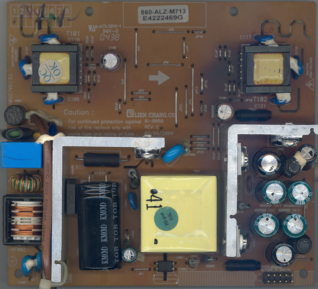

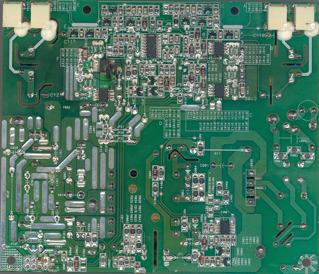

    I'm trying to fix the backlight inverter on a cecero 17" LCD EV-727 Model 700P
    The display works other than the backlight, it's fairly obvious what's wrong, there's a bulged cap, some cracked solder joints and a burned out IC.
    I'm having trouble finding information or a source for a replacement IC.
    The Backlight / Power supply board is a Lien Chang AI-0088.
    The failed IC appears to have the part number 4606 and BD4Y25
    Pictures atached.

        Replaced the blown IC with a NDS9435a and the board won't power up, some sort of protection kicks in. Removing the part lets the board power up.
          Re: cicero lcd inverter IC replacment needed
          Compairing the original IC to the replacement, I don't think I have the correct replacement.
          The NDS9435a has pins 1 2 and 3 conected together internally the original has 1 and 3 but not 2 conected.
            Hm, I did another googling and found this ebay seller selling the chip for $1 (http://cgi.ebay.com/ALPHA-AO4900-BD4...42.m153.l1262).
            Looking at the datasheet (https://cdn.badcaps-static.com/pdfs/...fd452f792b.pdf) you can see that pin 2 is the 2nd mosfet gate. So you would need a dual, not a single. appears to be pin comparable, however it does not have the schottky...
            Found one at International Rectifier (the IRF7901D1) but the fets are switched in the package so it might not work.
            Found another at Vishay () however it has much higher gate-source voltage (+-20V vs +-12V).

                        The discolored area of the component side is centered on the failed component on the solder side.
                        I've got an order going to dijikey anyway so I'm going to try the FDS8984 I'll order the ebay one if this one doesn't work.

                          I also have one of these Cicero displays with exactly the same problem. I replaced all of the bulging caps with new ones. I also had to replace the 47uF/25V cap on the primary side of the switcher. Now, the +5V and the +12V come up fine.
                          There are two separate backlight inverter sections, both controlled by the BIT3191. One of the circuits is fine, and the other is blackened, just like the photo that was posted. At least one of the dual-MOSFETs in that circuit is toasted. I have manually traced out quite a bit of the schematic for this inverter circuit. What I haven't confirmed yet is whether the dual MOSFET marked "4Y25" has two MOSFETs of the same polarity (e.g. N-channel), or whether there is a complementary pair - one P-ch, one N-ch. I will do some measurements over in the inverter circuit that is working. Obviously, we need to install the correct polarity device. It would certainly be useful to have a data sheet for that 4Y25 device.
                          By the way, I also noticed that the inverter power supply (using the BIT3191) has a shut-down function, if it sees disconnected CCFL lamps. The inverter runs for about one second, then shuts off.

                            I think the data sheet for the original IC is this one https://cdn.badcaps-static.com/pdfs/...c6e472ae00.pdf
                            It has one N and one P and Which would explain why the substitution ones I have don't work.
                            I have some and .
                            I just noticed looking at all the data sheets that I do have an N and a P version in separate ICs I think I'll try using two ICs since I already have them to see if there's anything else wrong before I order more parts.

                              With the two ICs wired in as a replacement the board powers up but the backlight does not come on. The BL (presumably backlight on) pin on the connector to the logic board has only .25v. I would expect a higher voltage.

                                    I have lables for most of the pins:
                                    1-2 12v
                                    2-4 Ground
                                    5-6 5v
                                    7 BL Which could easily be Backlight Level
                                    8 Ground
                                    9 Ground
                                    10 N/F
                                    I don't know what N/F is but the trace runs through JP4 to a surface mount transistor very close to the burned out IC.

                                      I obtained some samples of the Alpha & Omega AO4606, and replaced the one on my inverter board that was toasted (U105, I think, but I forgot to make a note of it; it was in the blackened PCB area). Connected the LCD panel back up, plugged in the AC, pressed POWER, and presto! the power LED went on and the LCD panel, after a few seconds, gave me a nice "NO SIGNAL" image. Connected it up to a PC video output, and the display works fine.
                                      So, to summarize:
                                      - replaced several bad/bulging electrolytic capacitors in the power supply secondary, including C013, C019,C027,C014, which were all 1000uF 25V CapXon KF types. I did not have exact replacements, so I used 470uF 50V caps.
                                      - One of the backlight inverter circuits had also failed (as a consequence of the failing power supply?); replaced complementary MOSFET AO4606 at location U105.
                                      As someone earlier in the thread mentioned, the AO4606 has both an N-channel and a P-channel MOSFET in it. N channel on pins 1,2,7,8 and P-channel on pins 3,4,5,6.
