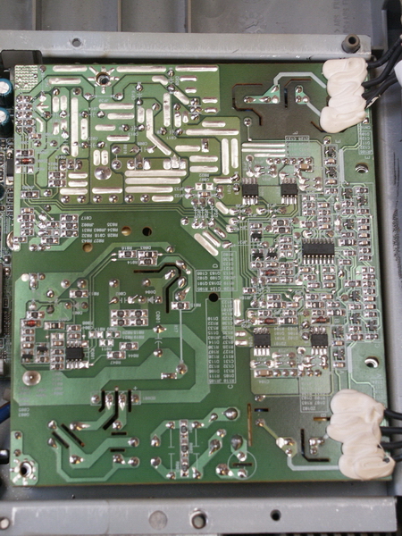

                  Hello to all!
                  This is my first post on this forum.
                  About one year ago I bought two second hand Fuljitsu-Siemens 19" LCD monitors from a friend (Scaleoview 900P).
                  I gave one to my son and one to my ex-girlfriend.
                  Both monitors just failed last week almost at the same time in a couple of days (no more power on).
                  The first one I checked was the one from my son.
                  The power board is a Mirage Electronics AD-1700 rev. F.
                  Obviously a bunch of caps (6x 470uF/25V & 1x 220uF/25V from the PSU, and the 2x 100uF/25 from the dual invertors) where screwed (bulging and even some leaking).
                  Replaced them all by Panasonic FM series low ESR capacitors and the monitor is working fine again.
                  Today I decided to have a check on my ex-girlfriend's monitor and I noticed that the PSU board is a AI-0088 instead of the AD-1700 (almost the same PCB layout).
                  This monitor started to have issues waking up from standby mode (several power off/on needed) to finally just not powering up anymore.
                  I again replaced the caps by Panasonic FM caps.
                  Weirdly I noticed that only two of the six secundary PSU caps are 470uF/25V, the other are 1000uF/25V (which unfortunately I didn't have on stock). Also the two invertor caps are 150uF/25V instead of 100uF/25V.
                  All caps seemed more or less in good condition (no obvious bulging) but I decided to replace them anyway.
                  Unfortunately the LCD still doesn't power up.
                  I also replaced the 47uF/25V near the the big 400V primary cap, still no result...
                  There are no other visible defective parts, only the PCB is a little brown around the invertors due to heat.
                  What could I check next?
                  Thanks for your input! (my ex-girlfriend has a modest income and cannot afford a new monitor at the moment...)

                    The first thing you should check is the batteries in your camera. Read this FAQ. Then attach pictures of the front and back of the power supply / inverter board. There are hundreds (thousands!) of models of monitors, only a few people here remember them all. I'm not one of them.
                    I'm wary of every monitor that has a 900P number, but you've already replaced the cap usually responsible. One thing to CAREFULLY test is the outputs of the power supply. The symptoms you describe are consistent with a bad power supply, but all too often we forget to go back to the basics.

                      Hi Plainbill, thanks for your reply.
                      I found a topic on this forum about the AD-1700 PSU board and the caps issue, although in my case it was obvious the caps were the culprit.
                      The only topic I found about the AI-0088 board was this one, therefore I thought posting here was a good idea.
                      Some pictures of the PSU board:
                      All caps, except the big 400V one have been replaced by Panasonic FM series caps.
                      - the two 150uF/25V in the invertor section (upper half side) by 100uF/25V
                      - the 47uF/25V near the 400V cap by 47uF/50V
                      - the 220uF/25V in the secundary power supply (right side) by 220uF/25V
                      - 4x 1000uF/25V and the 2x 470uF/25V (also right side) by 6x 470uF/25V
                      Powered on the voltage on the big 400V cap is about 315VDC.

                        I see you didn't read the faq.
                        It would be a good idea to have the power supply hooked up the board whicl checking the voltages at CN1.

                          @PlainBill:
                          The PSU board (AI-0088) is the same as the one from the topicstarter.
                          Pictures have been resized in the meanwhile (my son borrowed the cam and I didn't realize the resolution was still set at 1600x1200), sorry for that.
                          The output voltages on connector CN1 (+5V & +12VDC) are both at 0V with the video board connected, so it seems the PSU doesn't even start.
                          I'm quite good at electronics (I'm a graduated electronic engineer since 1976) but SMPS are not my thing at all, I'm really a newbie with them (my thing is digital electronics and microcontrollers).
                          Any hint to what to check next?

                            EE since 1976??? Huh!! You probably haven't worked on any REAL electronics - the stuff with vacuum tubes!!
                            I've seen LCD monitor power supplies rated for something like 5V, 3.15A. Usually they regulate the 5V supply and just let the 12V supply track (more or less). A 10 ohm resistor across the 5V output will provide sufficient load for stable operation.
                            I usually use a 'divide and conquer' approach. The first thing to check is the voltage across the large cap (typically 100uF, 450V) with the power supply connected to the monitor's logic card and AC power applied (in that order). It should read about 1.4 times AC voltage, or about 165V in the US. If that isn't present, likely causes are blown fuse, usually caused by a bad rectifier; sometimes caused by a shorted power FET.
                            If you do see the 165 volts (or whatever), you have two choices. I usually look for the data sheet for the SMPS controller (8 pin IC on the bottom of the board). Many of them show a typical application circuit. Start by checking for voltages on the SMPS controller. The other choice is to attach a 10 ohm resistor across the 5V output, just in case the problem was a shorted load. Also, check the 12V output. If the inverter is shorted, that MIGHT stop the SMPS from starting up.
                            Double check the orientation of the caps you installed. One common trap is one or more small caps by the SMPS controller. These provide startup and run power for the controller IC. If they are bad, the SMPS won't start. Many designs use a high value resistor directly from the rectified AC to charge a cap to provide start up power. Run power is from a tertiary winding on the smps transformer. These designs are very sensitive to startup load. And don't forget to check for shorted diodes on the output. It's rare, but does happen.
                              Yes, since 1976 , but I never worked in electronics, always as an IT engineer.
                              During the first year of my EE studies every course was based on vacuum valves, fortunately they changed to semiconductors and TTL logic the year after.
                              OK, mostly like a computer power supply.
                              315VDC is present on the big 400V cap (230V mains here in Belgium).
                              3.15A fuse is OK.
                              Will check power FETs.
                              OK, will check SMPS controller voltages and try a 10 ohm load on the +5V.
                              Can I disconnect the invertors for testing?
                              Orientation of the replaced caps triple checked. Unfortunately the values of the replacement Panasonic FM caps are not identical to the original values (6x 470uF instead of 4x 1000uF and 2x 470uF, and 2x 100uF instead of 2x 150uF for the invertor caps).
                              I bought all replacement caps for the AD-1700 PSU board in double, presuming the 2nd LCD monitor would have a AD-1700 board too...
                              Will also check small caps and high value resistors around the SMPS controller, and any diode present on the outputs.
                              Thanks for the hints!

                                i also have a defective AI-0088 inverter. MosFET U101 roasted and some bad caps.
                                I replaced:
                                - U101 with a FDS8858CZ
                                - C101, C105 with 150uF / 35V Panasonic FM Series
                                - C011, C012 with 470uF / 25V Panasonic FM Series
                                - C020 with 220uF / 25V Panasonic FM Series
                                But i didnt have a replacement for C013, C014, C019 and C027 (1000uF / 25V / 105°C / LowESR / 10x20mm).
                                I thought about:
                                - EEUFM1E102 , but physically doesnt fit (12.5 vs. 10mm diameter)
                                - EEUFM1C102 , fits but only 16V
                                - ECA1EHG102 , fits, 1000uF / 25V / 105°C, but not LowESR
                                Is a low ESR type absolutely necessary here?
                                Btw. here is a schematic of the inverter: click
