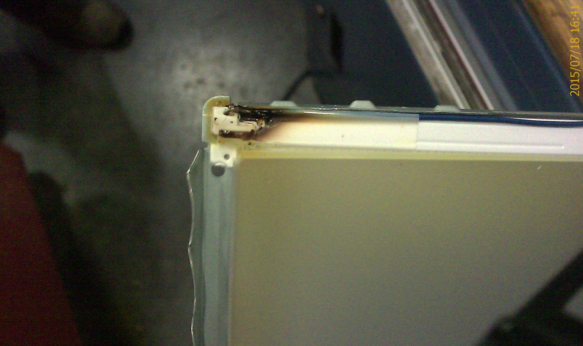

    Re: HP LA1905WG lcd monitor no backlight
    just took one apart down to backlight...it appears top left corner of plastic frame around backlight is melted/burned
    • shelby5041
      • Feb 2009
      • 1504
      • united states of america usa
      #42
      will post a pic later...left corner of glass backlight metal frame burnt bad...actually its an end of a ccfl tube....fried........i just peeled it apart and its a tube thats on the uppermost part of frame.....

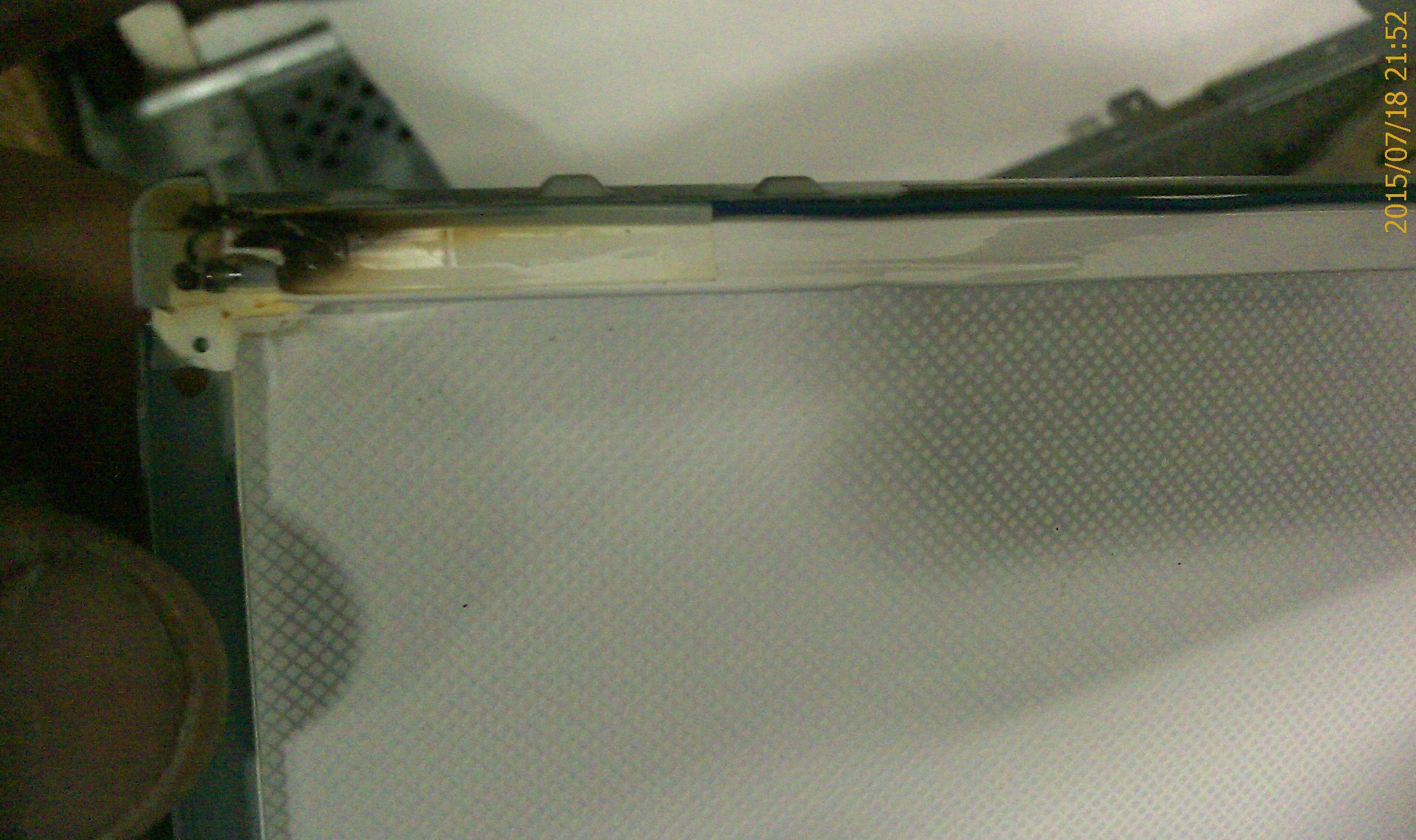

        #43
        yep...just took another one apart.....left corner fried where ccfl wire around metal frame.....ccfl fried

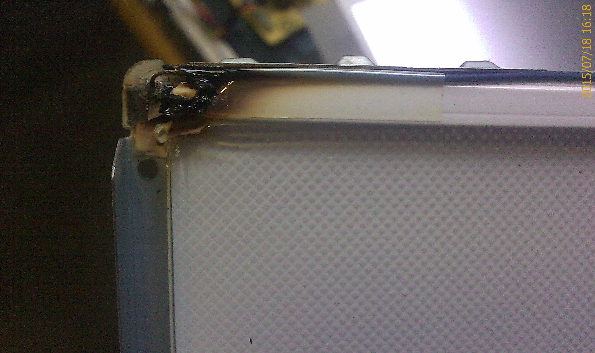

          #44
          ok this thread is done
          here are pics of backlight assemblies for the 3 monitors that backight would power on for 2 seconds and then off
          all 3 had electrical failures within the backlight circuit
          seems to have to do with metal frame shorting out on power cable to ccfl

              #46
              if you remove the melted tape & clean it up, you may just need to replace the wire section.
              btw, this is not a surprise, the one i had (17 version) had a cracked tube!
              HP overdrives the tubes in these monitors to get the brightness.
              • shelby5041
                • Feb 2009
                • 1504
                #47
                no.....the end of tube fried....broken./cracked..the reason its like this is these monitors are used in a manufacturing environment....lot of vibration and they are mounted on a fixture that moves back and forth 1200 times a day......thats what csused the problem.....broken monitors are ever day here.....we have about 500 in circulation.....and broken ones are a daily thing.....they throw them away and i sometimes take them....we now have all led style lcd monitors....they work great as lights when screens cracked
