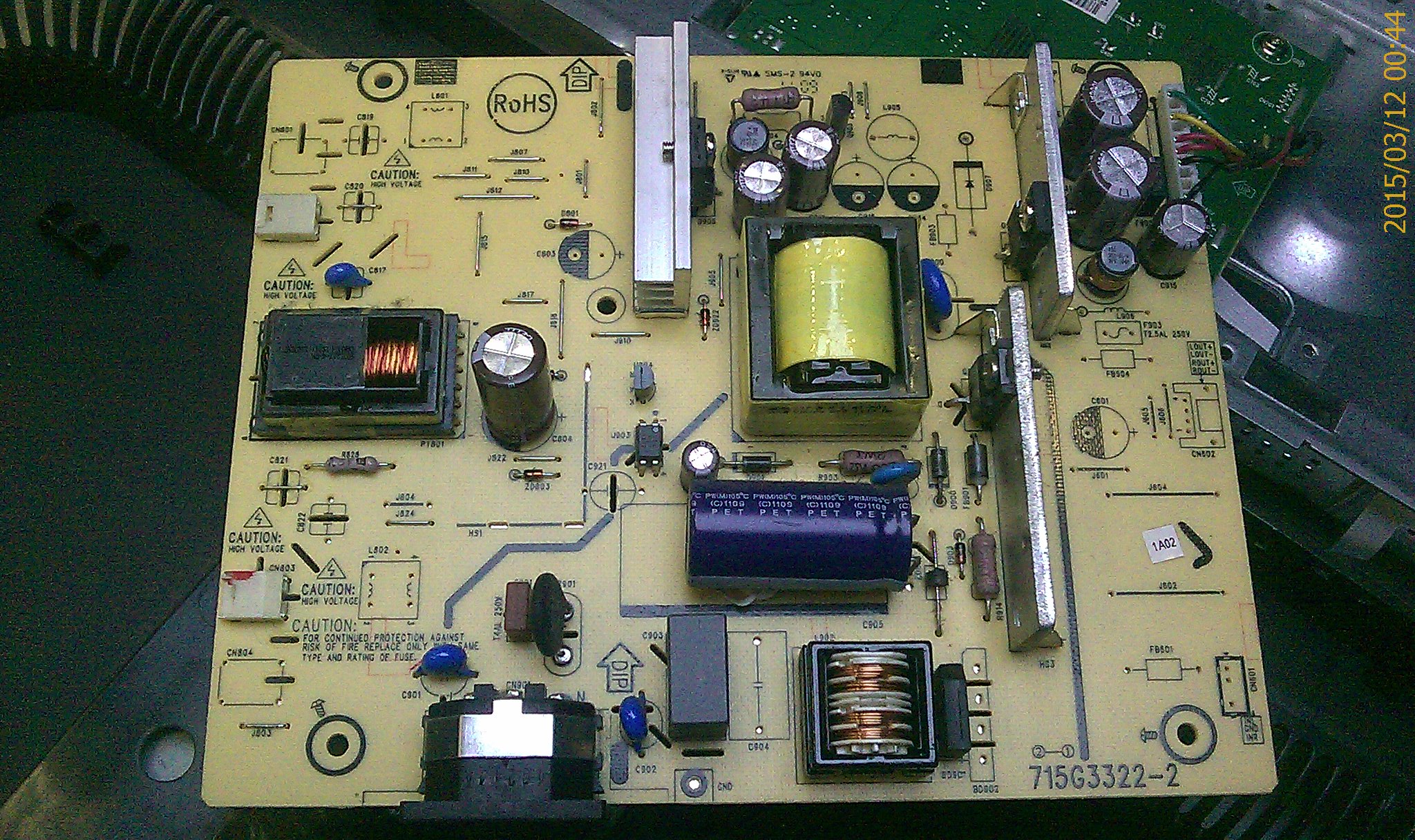

    hi i have 4 of these monitors manuf 2011
    all 4 do not have backlight.....backlight does come on for 2 seconds but then goes off......
    you can see the image but no backlight
    i have repaired hundreds of lcd monitors 99% of the time its just bad caps but on these the caps are all good
    and its just weird they are all same model# and all have same problem
    im hoping someone can help me....i would love to find out what component is causing this issue....must be common
    thanks

    Re: HP LA1905WG lcd monitor no backlight
    here is a photo of power board
      could be the ransformer or a bad tube.
        You can make two test lamps to test the inverter circuits.

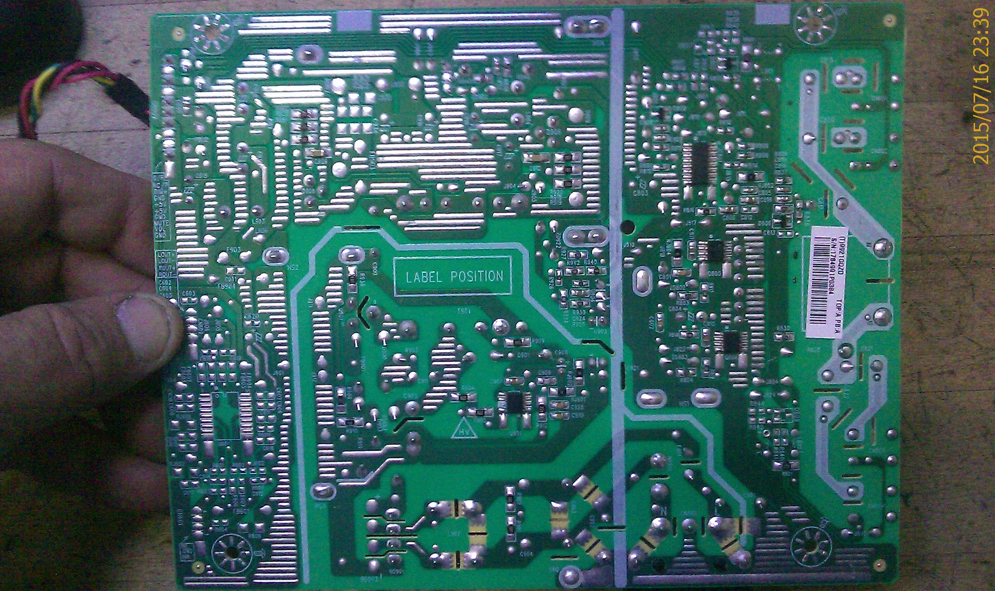

          hi...thanks for replying the tubes are good i tested them a while back....im just trying to get back to this repair....have time now
          so it has to be a power supply inverter issue........
          the 1000uf cap in front of transformer to lights is good....how can i test the transformer?
          here is a pic of underside of board
            What is the P/N as printed on the inverter transformer? Did you also check those two SMD 8-pin MOSFETs that drive the inverter transformer?
            Check the two legs on the right side of the transformer as show in you bottom view of the board.
              hi no i havent checked any mosfets...how do i test the 2... 8 pin mosfets? underside board
                  Get the P/N as printed on top of MOSFET and then do the search to get the spec sheet that will show the pinout, then you check the resistance between S and D pins.
                        OK, on the transformer, just check the resistance between the two legs on the right of the transformer.
                          seems on 8pin mosfets one side has 4...d and other side 1 s and 3 g
                          ok trans has 2legs one end and 6legs other end.....check res between 2legs one end?
                          what value would be good?...and bad?
                                transformer 2 pin...resistance is 442 ohms on all 3boards
                                  mosfet may be APM4548A
                                    on mosfets getting 17 m ohm s-d on all of 3boards
                                      17 m (mili) Ohms = 0.017 Ohms.
                                      Or you mean 17 M (Million) Ohms.
                                        meter read 17M ohms
