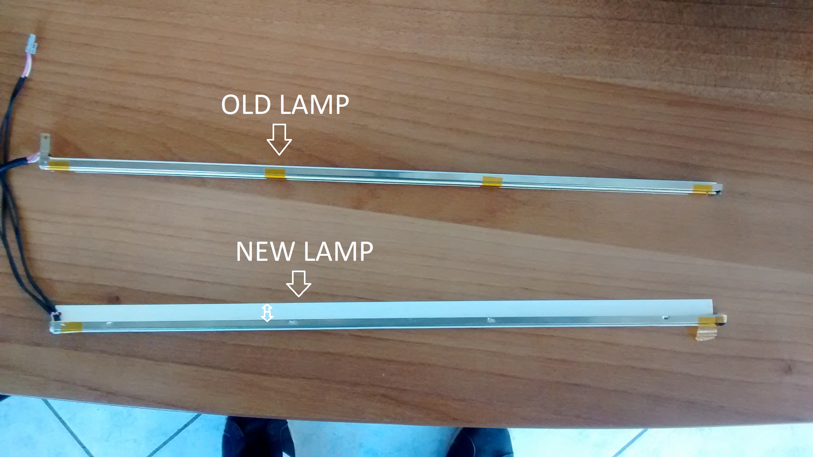

    I ordered some lamps from internet but the frame that has the lamps is bigger.
    Is there anyway to cut the frame without hurting the lamps. Or anyway to fit those in the monitor(maybe I am doing something wrong)

    I'd swap the lamps themselves in their frames. Just be careful. These 3mm glass tubes are extremely fragile.

      I am trying to avoid swap the lamps because I broke 4 lamps in the past.

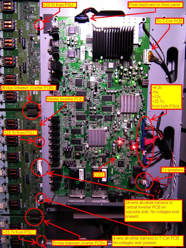

        IMO removing the lamp is easier than say cutting the metal frame with tin snips. Hard to tell from your picture if the tubes are potted in or just placed there on some double sticky tape. If the latter then it should be fairly easy to remove them by gently heating up the metal frame with a heat gun. I use this awesome precision heat gun for everything from peeling off stickers and scotch tape to heat shrinking insulation tubing to even desoldering IC chips from printed boards:
        Off topic: which program do you use to insert callouts into jpegs? I'd rather not build pdf documents for this purpose if there is a simpler alternative.

          I finally swap the lamps but now my screen has blue light in a part of it at the begiining and then it kind of fadi and then a white box go up and down ( I think it's the no signal box).
          Does anyone knows what could be that?

            Re: Wrong ccfl lamp frame
            ok I've got it. I didn't put a cable correctly.
            Thanks all for your help.

                              I use callouts extensively in my posts like for example here. For that I have to resort to creating pdf documents which are time consuming create and clumsy to open. I tried making callouts in graphic editors like for example FastStone but they would come out blurred. The callout in the OP looks sharp and crisp, that's why I asked the OP which program he used.

                                that link shows a pdf with a high res foto in it, i dont see any added text, arrows, circles etc.
                                    Interesting. I have attached a snapshot of that pdf the way it appears on my screen.
