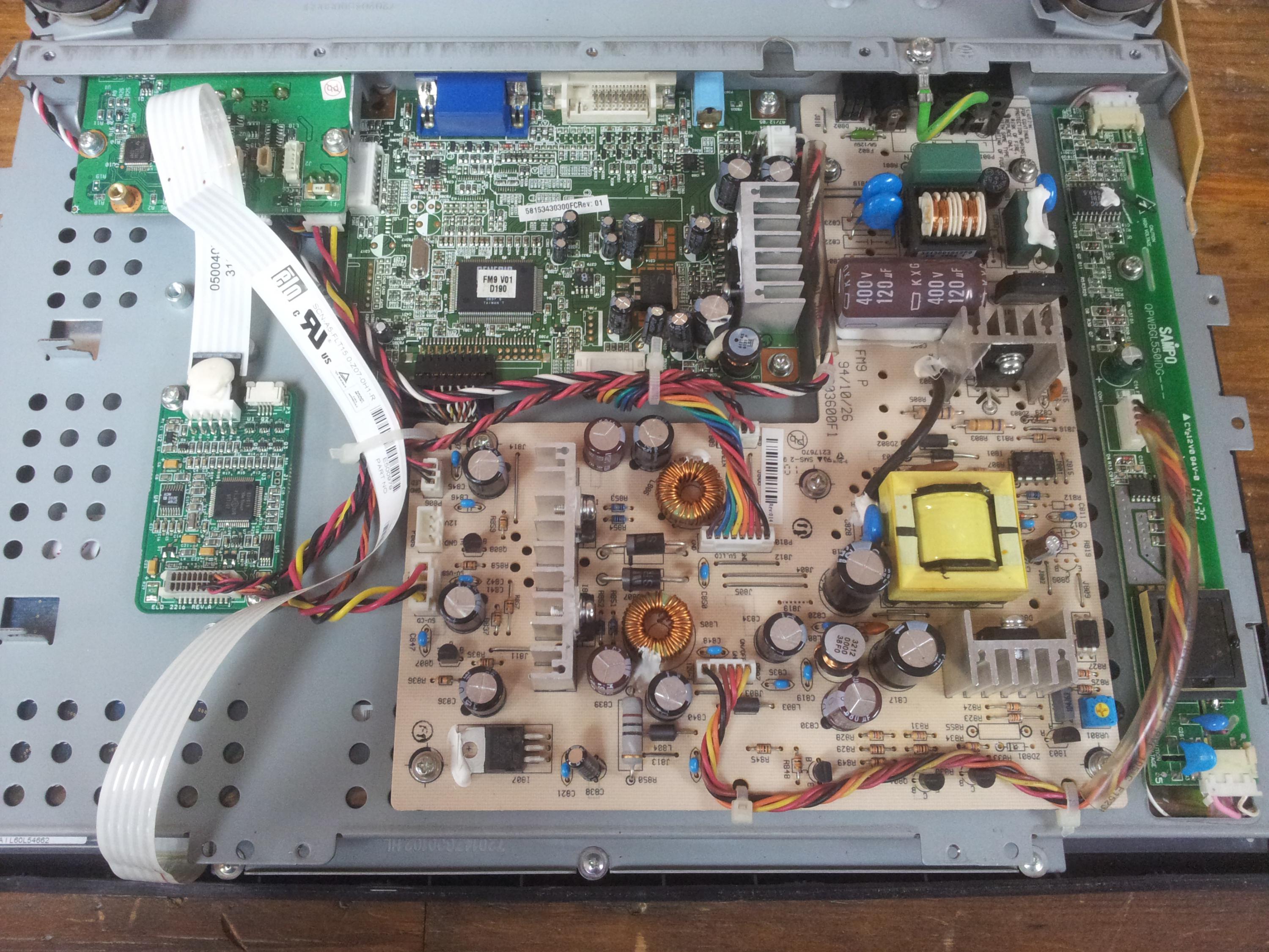

          • Iceman_GER
            • Jul 2014
            • 21
            Re: Elo 1529l
            here is a picture of the other screen. I think all redish caps have been replaced at some point.

              • selldoor
                Slow Learner
                • Dec 2010
                • 7870
                Re: Elo 1529l
                Hi - On the socket that goes to the inverterboard I see a pin marked on/off.
                While the set it being powered up can you monitor the voltage on that pin
                Meter on vDC20 -you can just use a ground pin on the same socket for the black probe.
                Also many sets wont stay on without a source signal so it may need to be connected to a working pc via the vga socket.

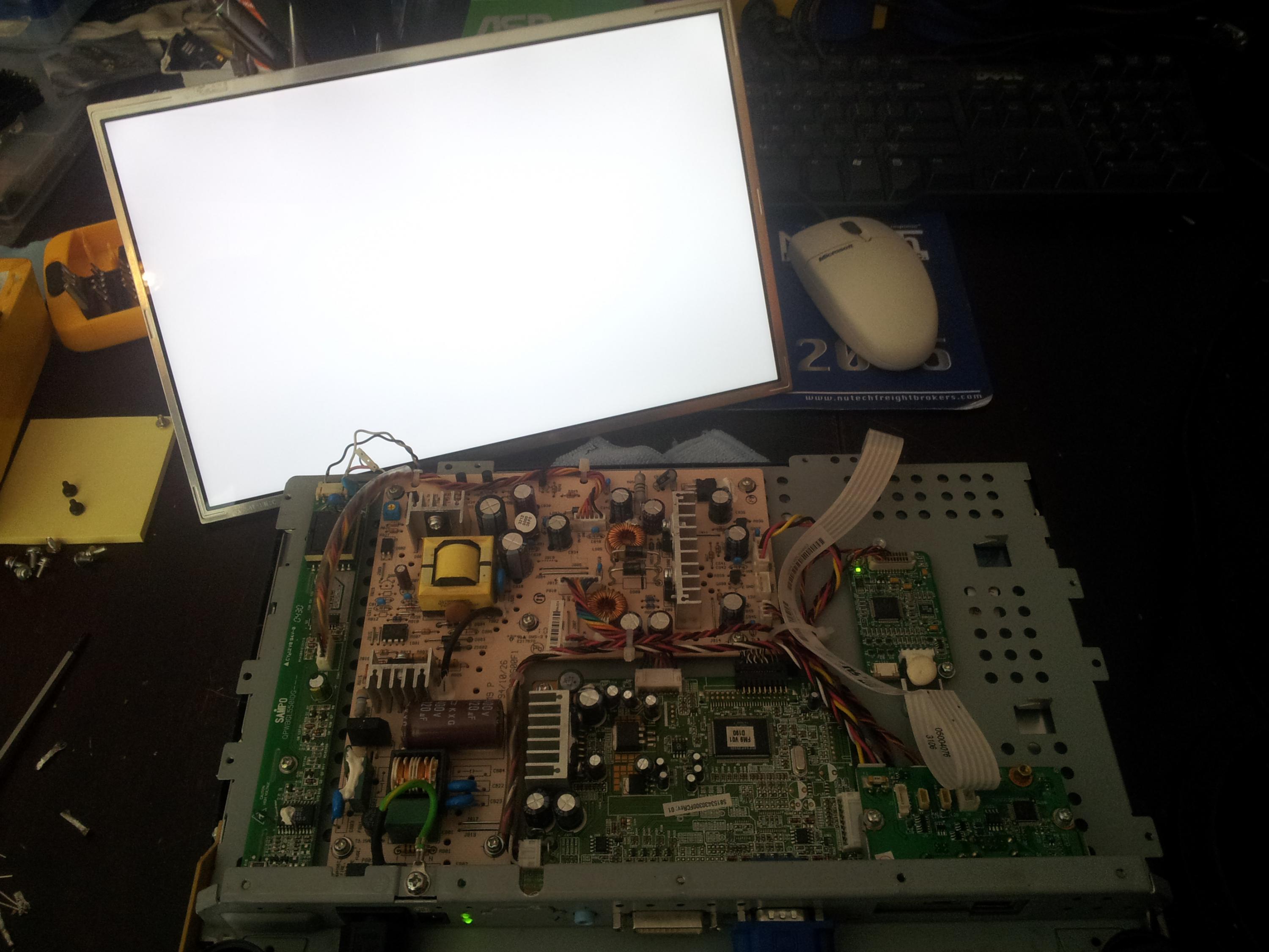

                    Re: Elo 1529l
                    Finally had some time to test. sorry for the delay.
                    i used an old 13" screen to test the inverter. works like a charm, see picture.

                      Ok - that is great - so can you do a test using one bulb lead from the original and one from the 13"test?
                        • 30963
                        Re: Elo 1529l
                        is that driving 2 tubes at the same time using both invertor outputs?

                          • Iceman_GER
                            • Jul 2014
                            • 21
                            Re: Elo 1529l
                            no, used one
                              • 30963
                              Re: Elo 1529l
                              that's not a proper test.
                              you powered one tube with a circuit designed to power two.
                              obviously it will be able to overdrive the tube.
                              i think it's tubes.
                              both monitors are the same age, and get a hell of a lot of use.
                              if you research the chip used on the invertors, you can bypass the protection circuits and run the tubes till they burn the wiring or break at one end if that's really what you want to do.
                              why dont people understand that cfl's are no different to the lamps they light rooms in the house with,
                              they dont last, they fail after 30-50,000 hours of use. (HP's numbers, not mine)
                                Re: Elo 1529l
                                since you can use the other lamps of another panel to test your inverter board and the lamps stay on, so that means you have the lamp problem.
