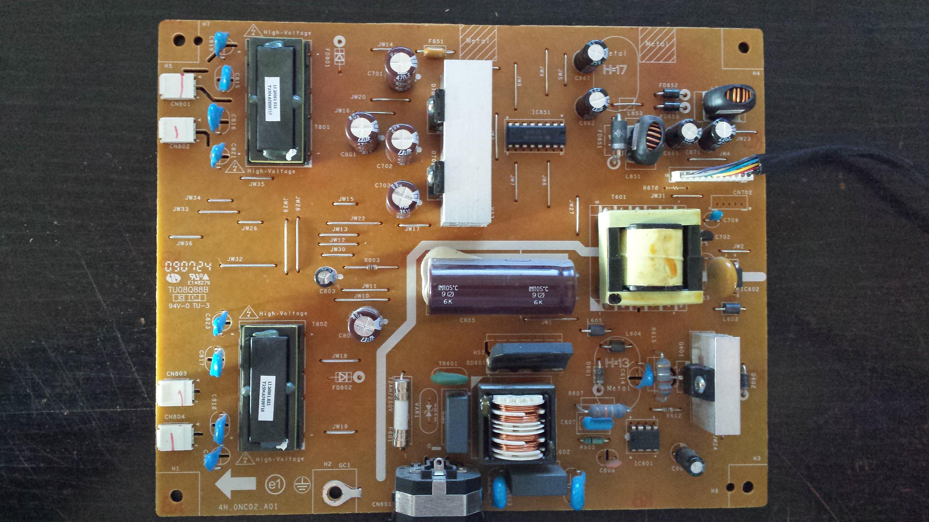

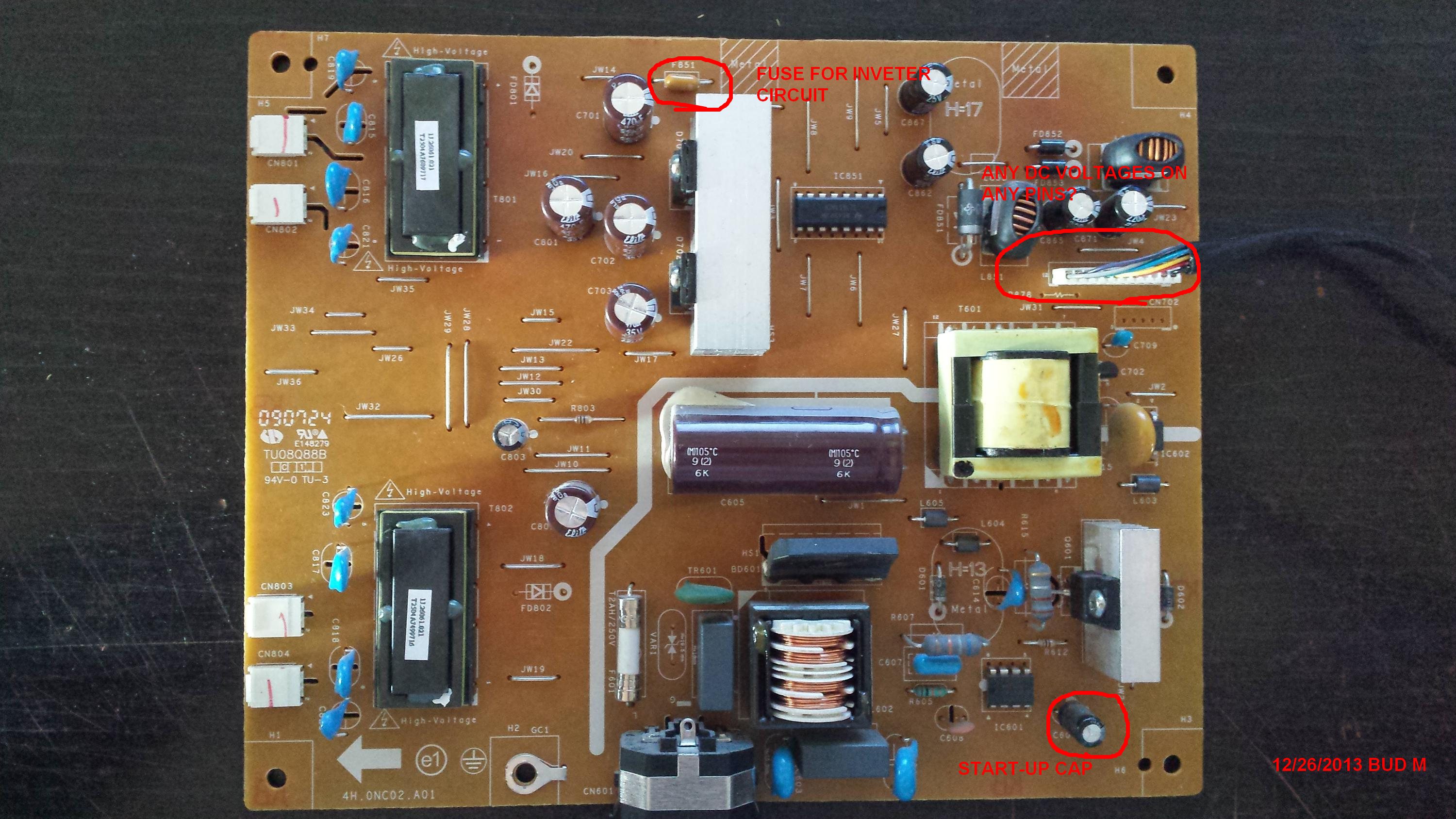

      I'm sorry for being vague. Absolutely nothing happens when I plug in the monitor. Pressing the power button does nothing, there is not power at all, no LED status at all.
      You are right, I was suspicious that FD851 was a fuse (As it looks like a DIode) I must have read it wrong in the post.
      I did locate F851 and I'm reading low ohms at .3, same as the white fuse.
      The board is exactly the same as the OP pictured. I will get a picture up when MY camera is done charging.

        Ok Better - and nice picture can you do the other side of the board.
        FD851 is a diode and both fuses test good.
        Quck test - HIGH voltage so care - Set meter on vDC600 and with just this power supply
        board plugged into mains test the voltage on that BIG black Cap C605
          I will post the picture of the back when I get back.
          But the C605 Big dark brown cap, reads 160V (Im in the US, if that matters).

            Voltage on big cap is probably acceptable so now to follow the tests carried out by the first poster. Connect it all up switch on and test the voltages on the
            connector to the main board (try the sewing needle trick)
            You can also test the voltage on both ends of the F851 fuse - use a ground screw for the black probe.
            You can also try the hairdrier trick on the startup cap warm it gently, then
            plug in and switch on. (always worth a try)
              Re: Asus VW246H will not power on
              Fuse F851 is for supply B+ to the inverter circuit, it will not stop the main board from functioning if it has gone open circuit. See red lines in the picture.
              The power supply may be in the safety shutdown right now or just dead due to bad start up cap or bad SMPS IC, MOSFET, ETC.

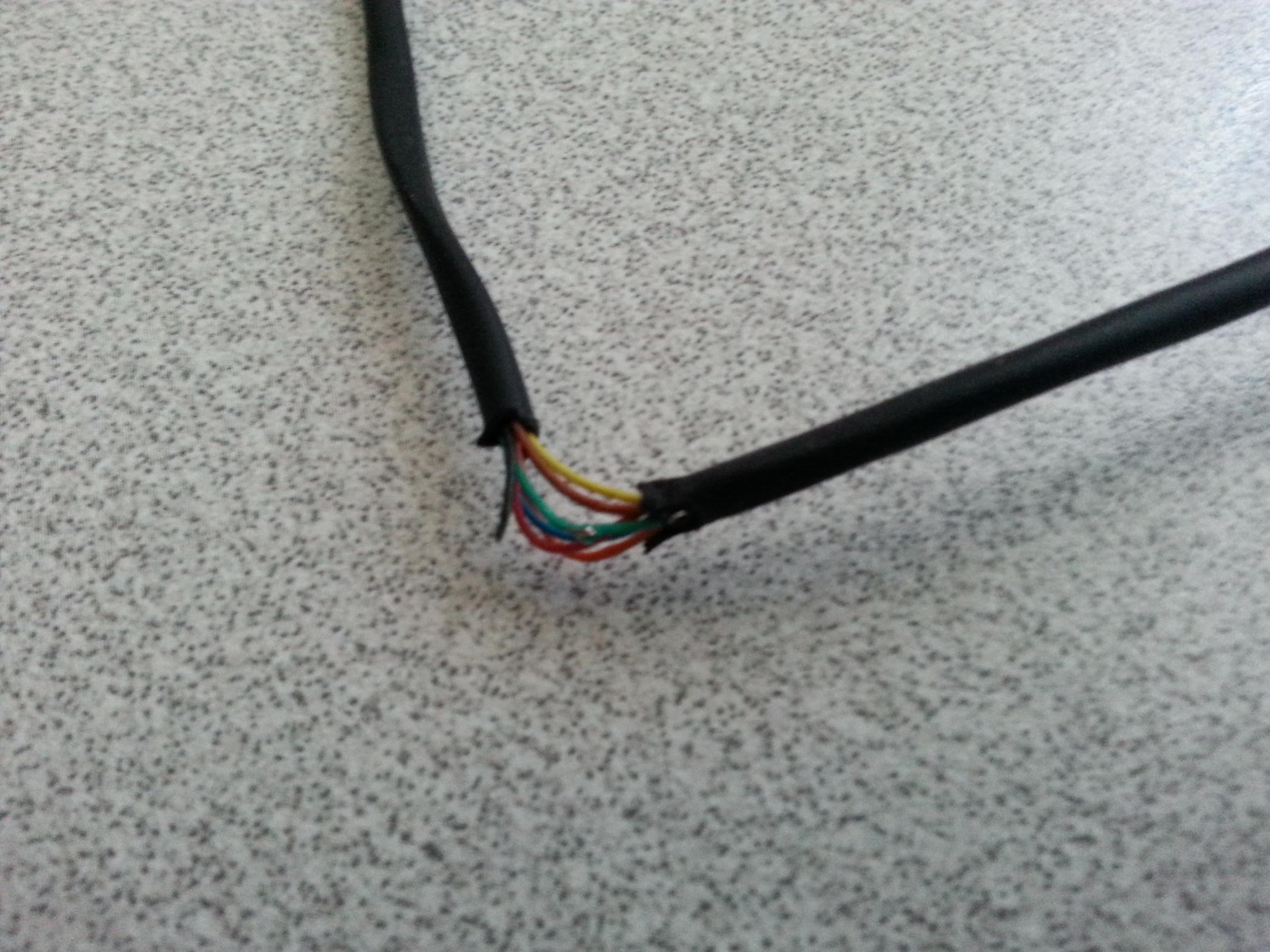

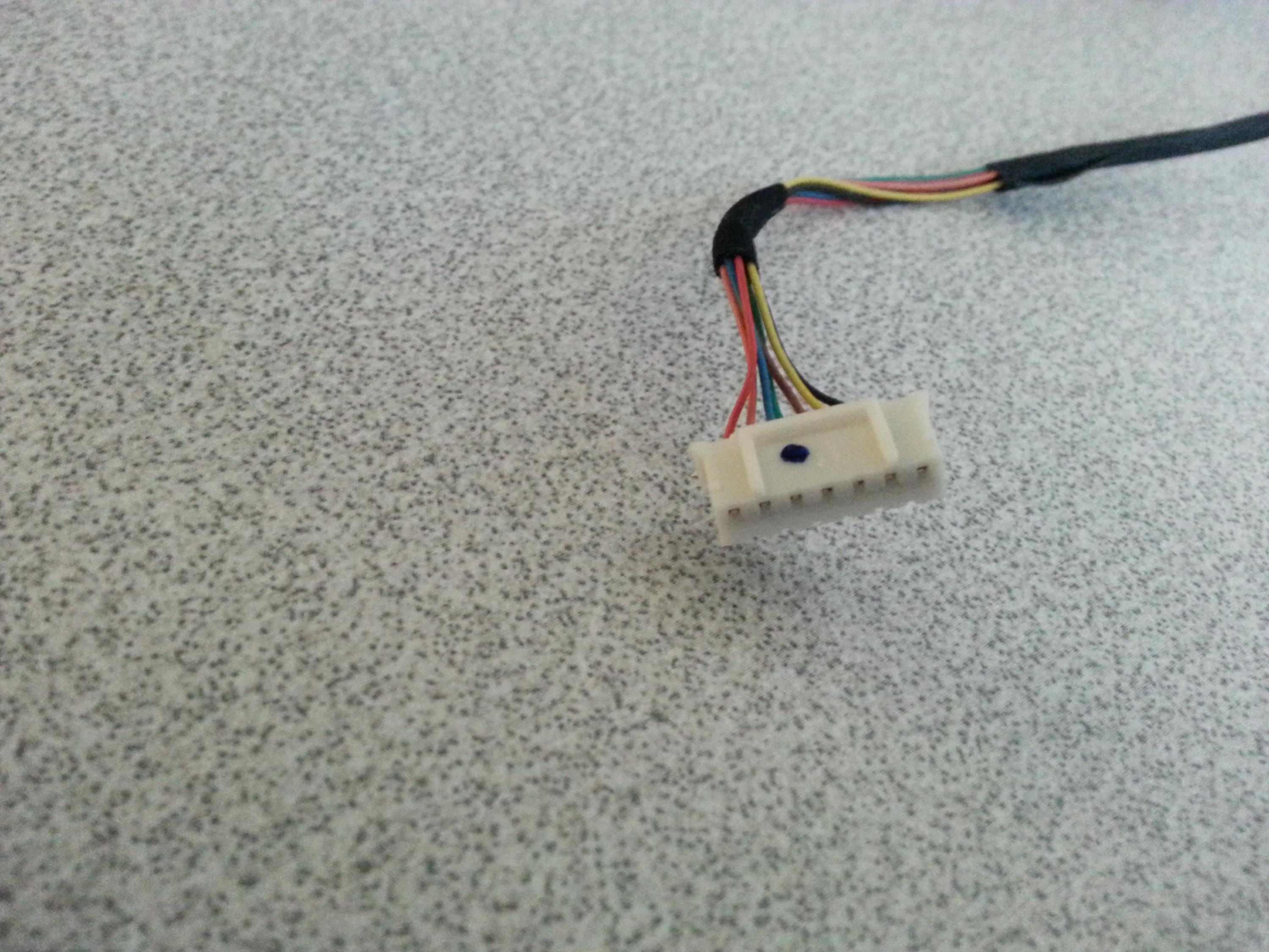

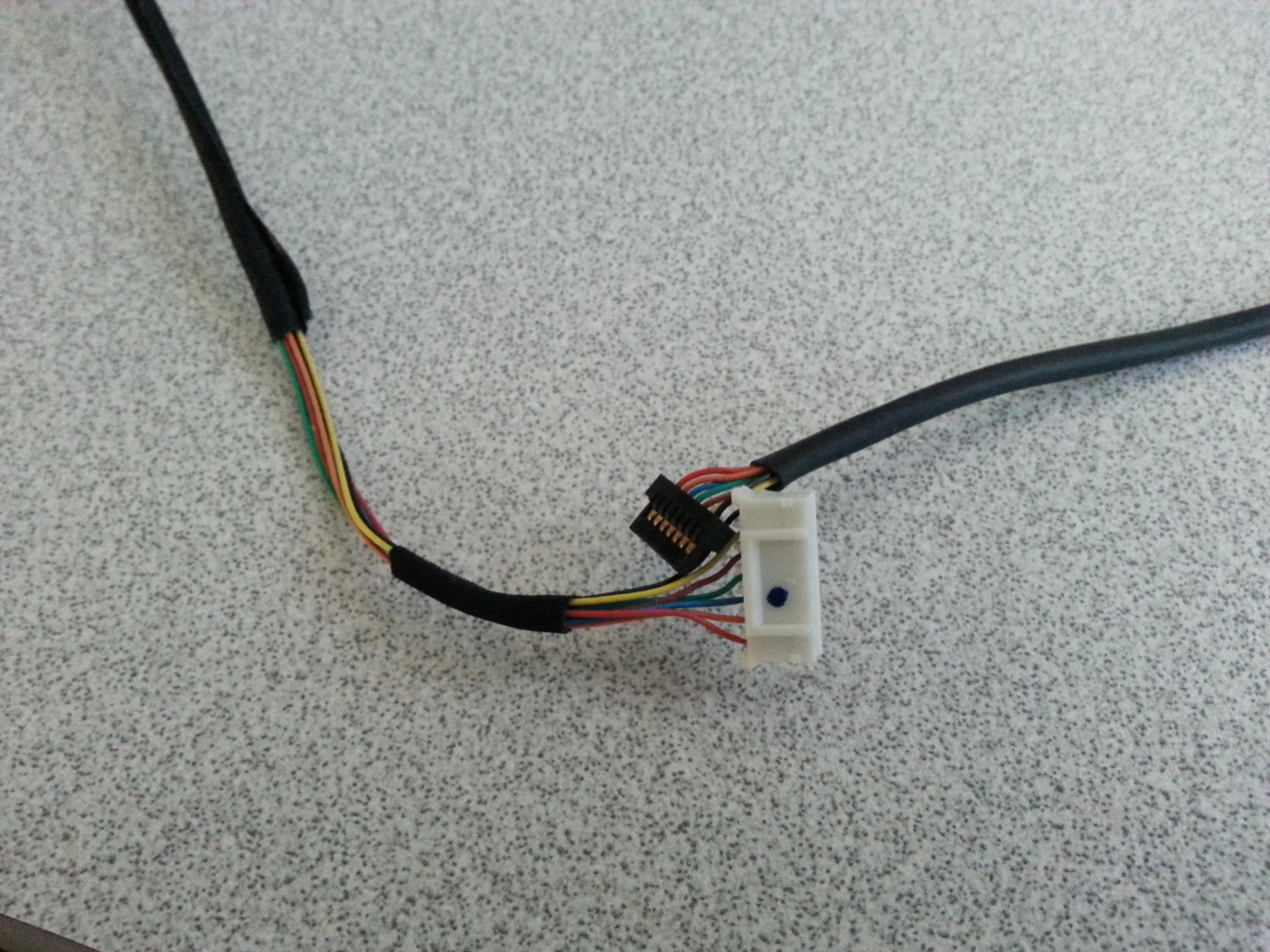

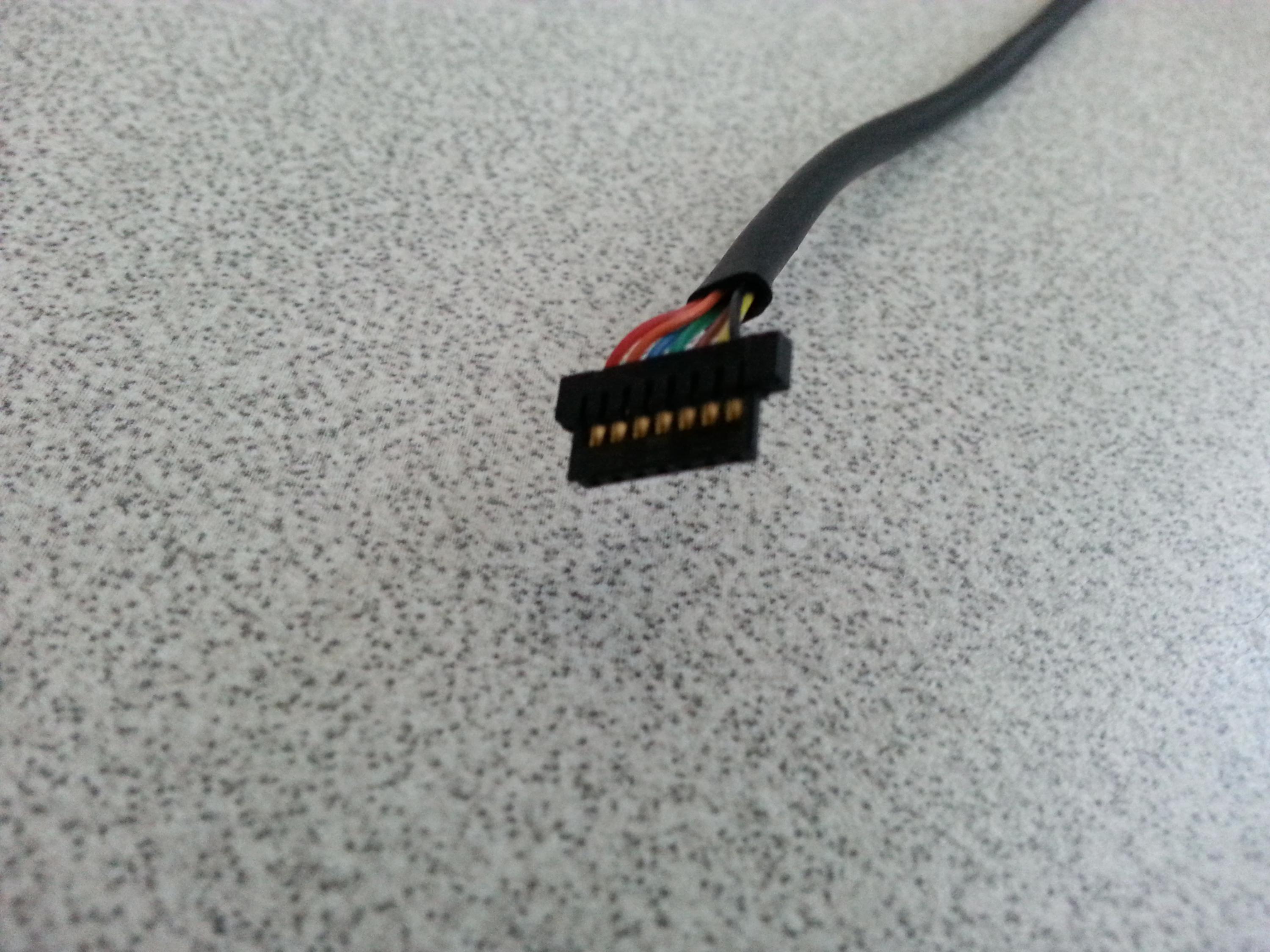

                I just joined today, and while I don't have the same issue as the other two people, I'm still using the same monitor.
                My issue was the backpanel, one of the pieces broke loose and only 3 screws could hold the monitor up while mounted. I decided to fix this, did what I needed to do, and was able to mount it. Plugged everything in, monitor turns on, asus screen shows up.
                Noticed that the power button won't turn on, unplug it, plug it back in, asus screen shows up, tells me no DVI is connected. Decided to open it again to make sure I didn't mess anything up. I noticed that when I screwed the monitor on the back, I screwed through that cable that is attached to the button circuit board thing.
                Pictures show the damage, and for the life of me i don't know what that part is called, and how to get a replacement of a similar length. I'm not sure if I should make a whole topic for this or not, but I figure that technically, my VW246H does not turn on D:
                  It looks like the damaged wire can be splice back together. it only has about 3.3V on those wire so it is not hot voltage, they are just for sending the signals to and from the switch assembly to the main board. You can ask local repair shop to do the work easily.

                    didn't think it would be that simple, thanks for the fast reply!

                                    It's a thin track to follow but i would check if it arrives voltage at the right pin of the pwm ic, start from the + leg of bigger cap and follow the path, it arrives on 1 or 2 resistors with high value that comes in the chip, that is the leg where you must find an high voltage , maybe around 300v i don't know sorry.. have you ever tested psu output/s in this off state?
                                    • Davi.p
                                      Hobbist Tech
                                      • Sep 2009
                                      • 4513
                                      • Italy - Milan
                                      #38
                                      i see now the photo, the pin is n.8 and the resistor is r605
