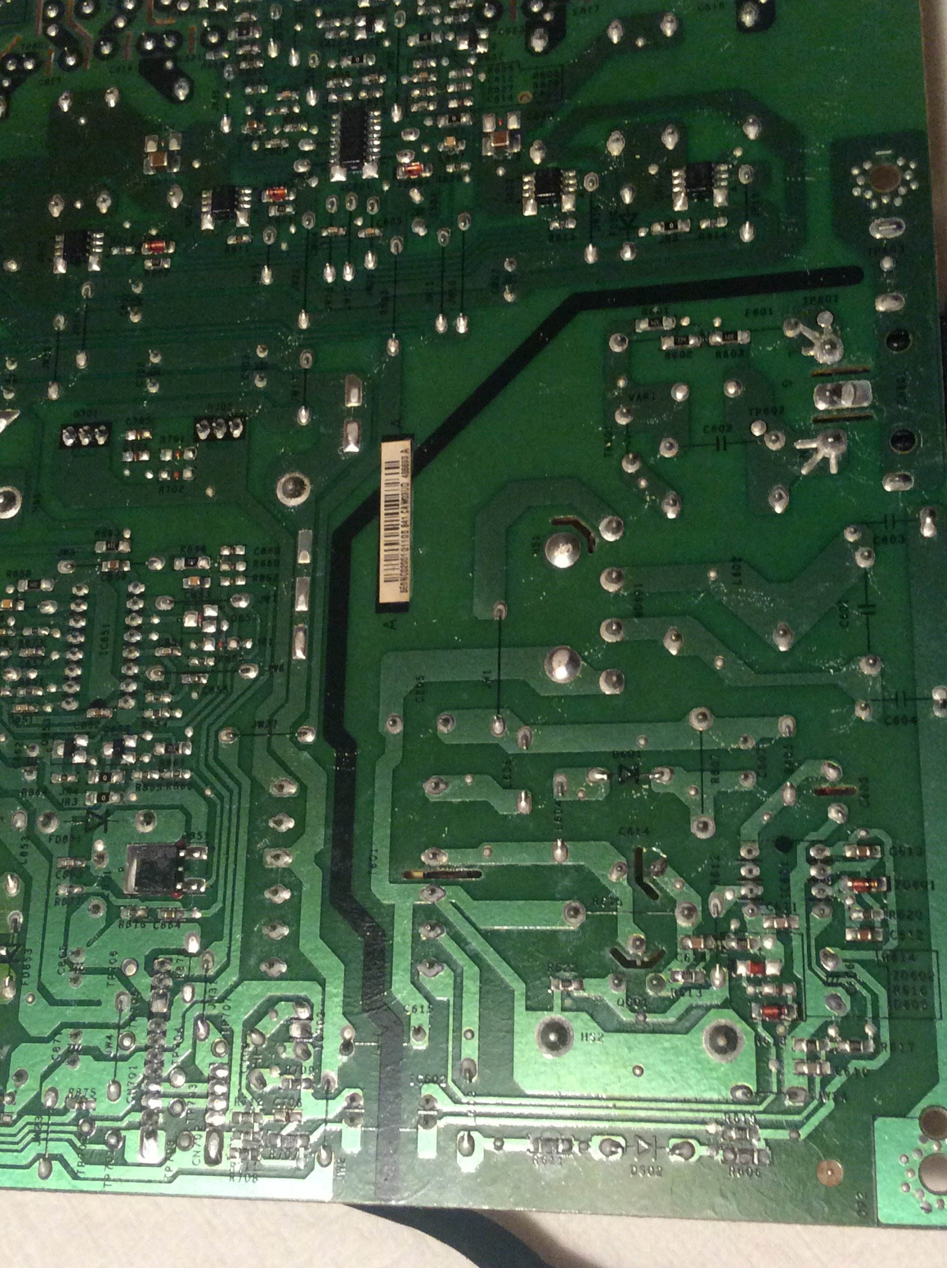

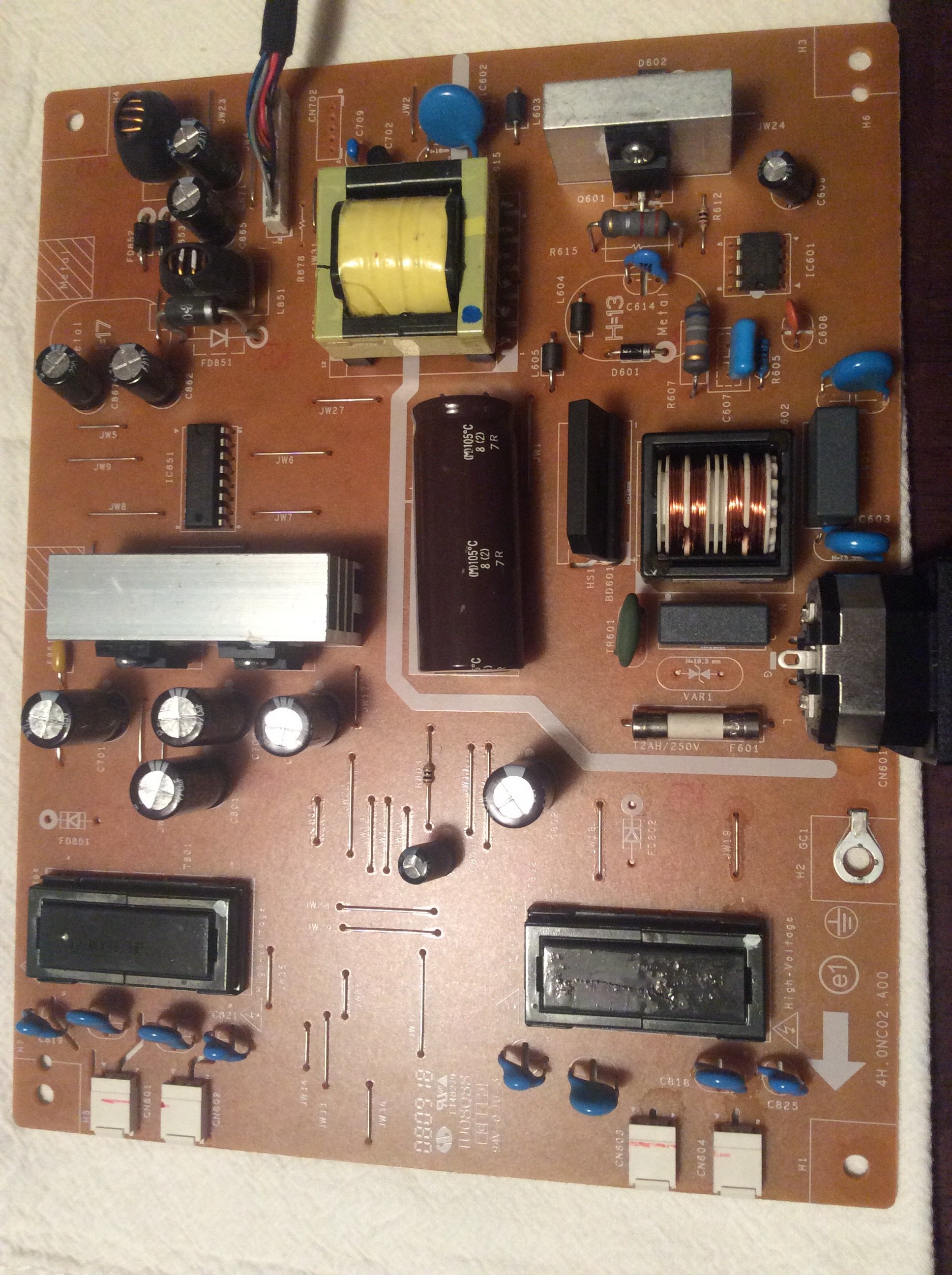

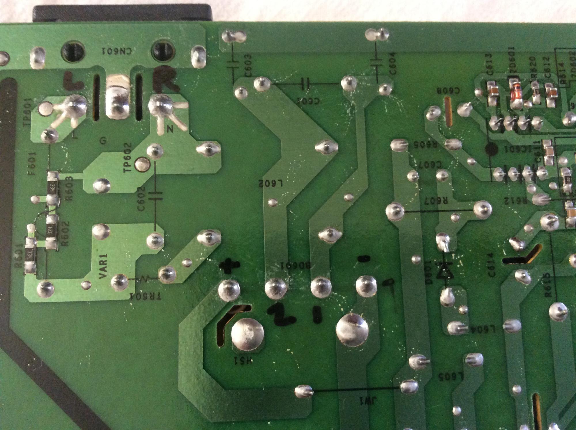

                  Re: Asus VW246H will not power on
                  I just got the PM.
                  Check the resistance of resistor R615, it should be less than 1 Ohm.
                  BTW, Can I get good clear hi-res straight shots pictures of the whole top side and bottom side of the power supply board? The one in your post #63 I cannot use it to trace the circuits.

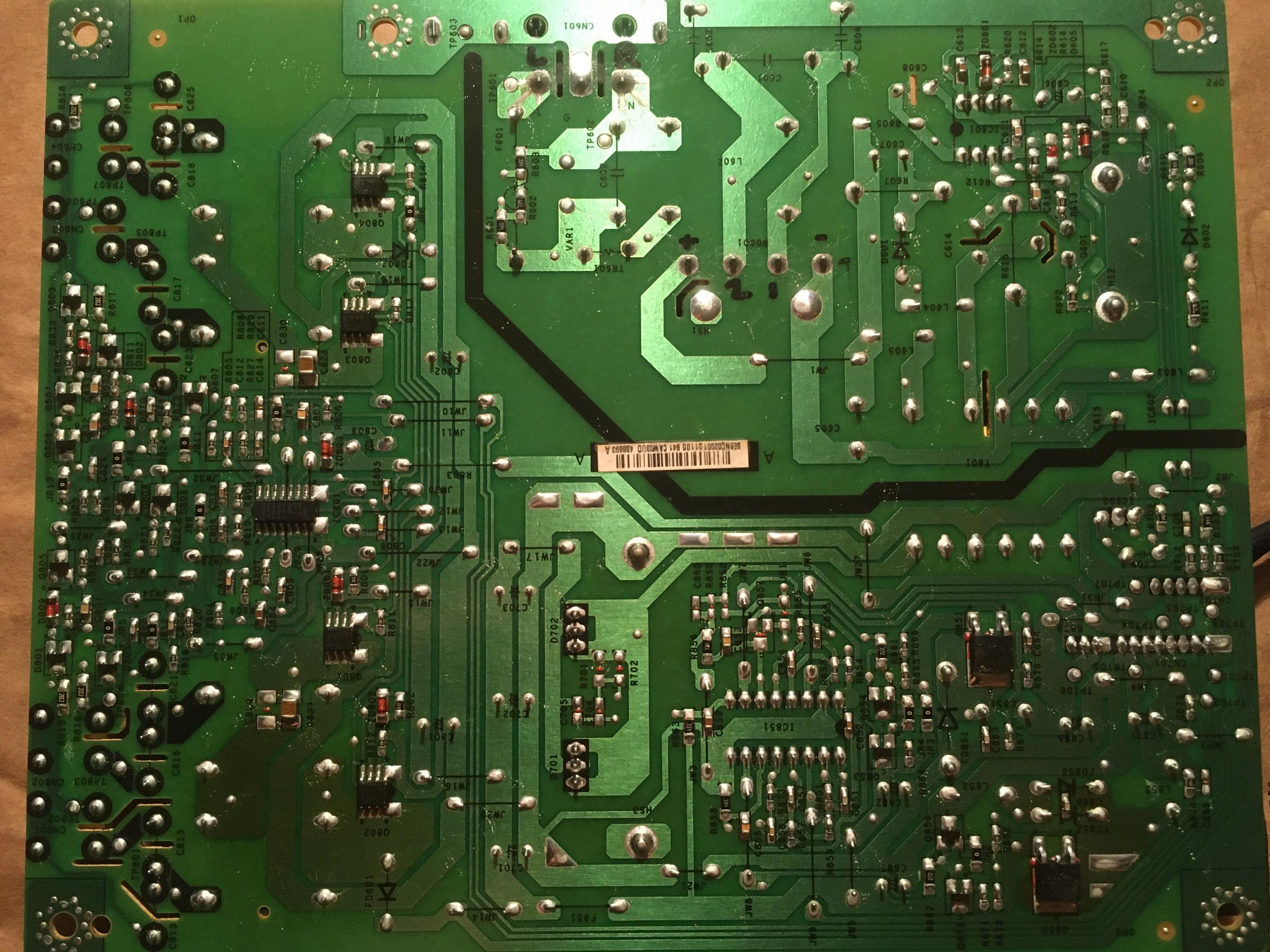

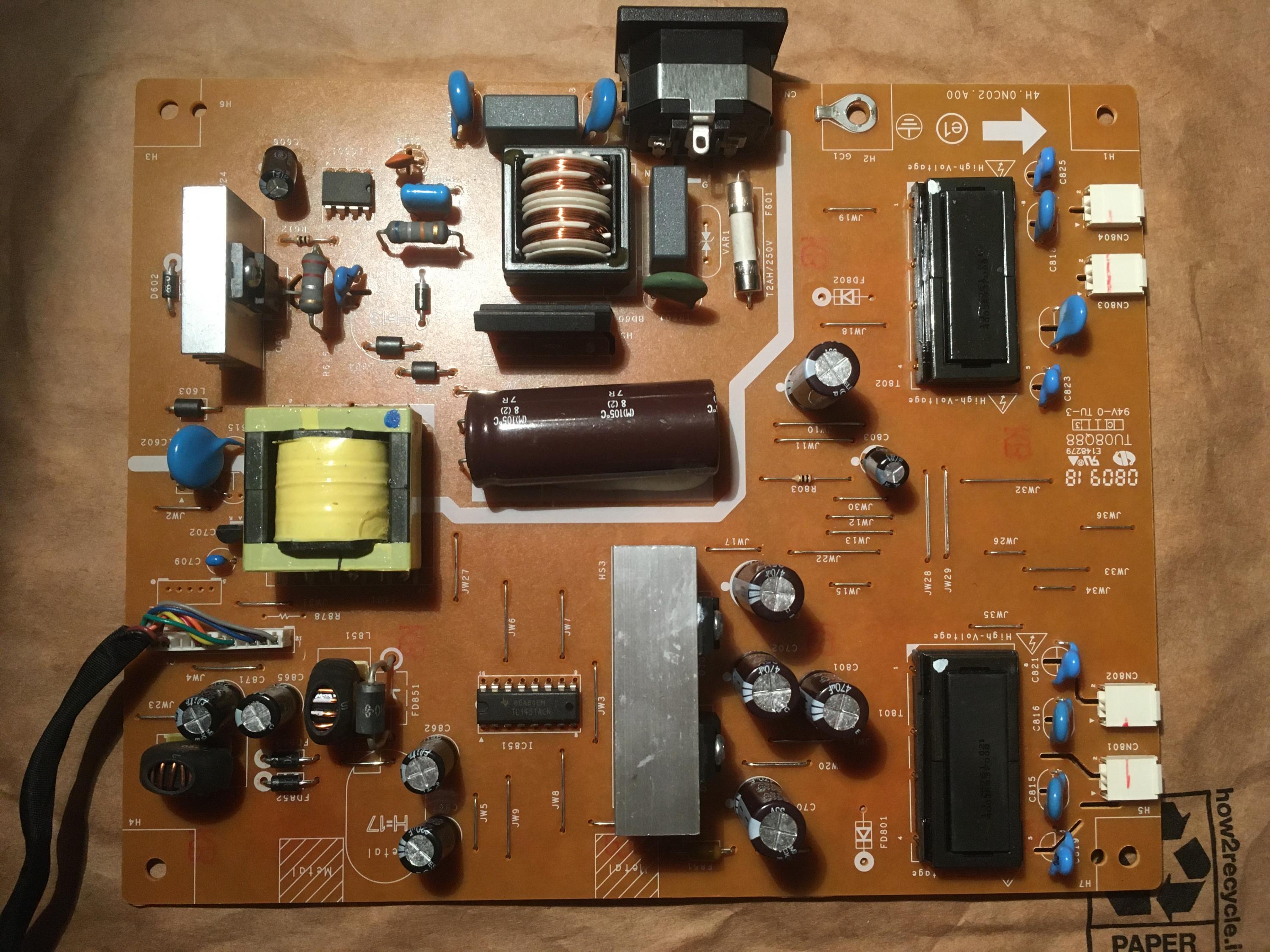

                    #69
                    Bud,
                    Thank you for the reply! The R615 resistance was 0.3 ohms. Attached are pics of the board. Also, just want to make sure that testing the solder points on the green side of the board is effective as testing the top of the board.
                    Thanks again!
                      #70
                      Originally posted by swofra View Post
                      Bud,
                      Thanks again!
                      OK, thanks for the pictures, I will download them and mark the test points for you to test tomorrow, it is 1AM my Bay Area time right now and very busy with so many people every nights, so good night for now.

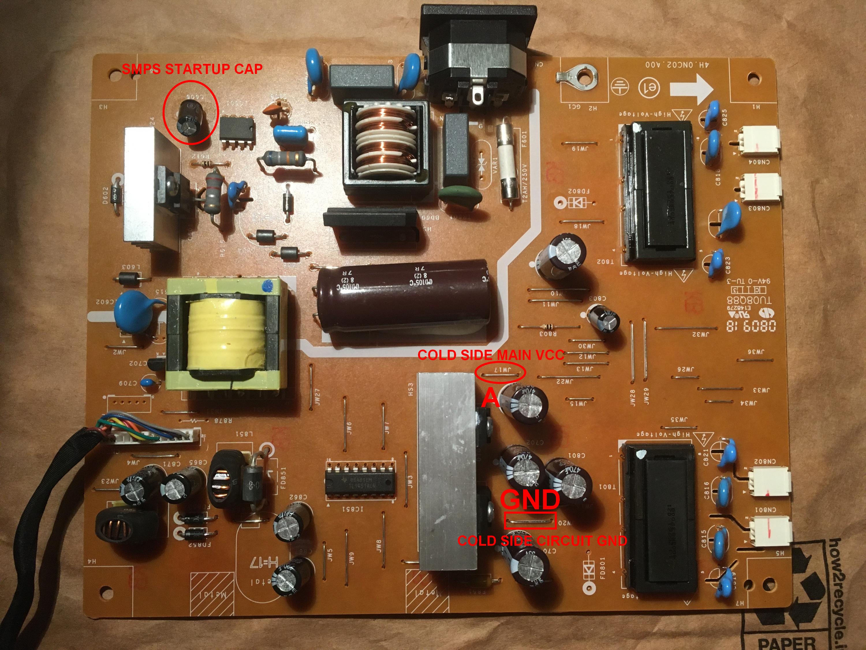

                          Notes: do not touch anything on the board with your hands or body, you to need to at least plug the board under test into the GFCI outlet to protect yourself.
                          OK, just power up the power supply board by itself without any cable connected to the main logic board, then check DCV Voltage on the top side of the board between 'GND' (jumper JW20) and point 'A' (jumper JW17 to see if you have any DCV there or not.
                          Do you have any 22 ~ 47uF with 25VDC rating or higher? If you do not get any Voltage reading from the test above, you can try replacing C606 start up cap to see if the power supply will start up.
                            #73
                            Firstly, hope your dental surgery went splendidly, or as splendidly as something like that could go.
                            I plugged in the board to a GFCI without it connected to the logic board (logic board cable still attached to power board but its not to logic board - hope that doesn't matter).
                            Tested the VDC between the output terminals of the bridge rectifier and got 160VDC to verify my meter and power connection was working.
                            I tested the VDC between GND JW20 and Point A JW17 by putting one probe on each. I tried reversing the probes as well and also tried doing it on the green side by touching a probe to one of the solder points on JW20 and using the other probe to touch one of the solder points on JW17. All tests showed -0 VDC after about 2-3 seconds. i would imagine that would mean there is zero power between the two.
                            I take it from your suggestion that not getting any VDC somehow means that C606 could be bad and I should replace it? I will look to see if I have any 22 ~47uF 25VDC caps on old boards I've saved, if not, is your recommendation to order one? Looking at that cap, it says 47 uF 50V, do I need to match that exactly?
                            Thanks again!

                              My surgery got cancel due to complication so it will be next Tuesday instead.
                              Just try the caps that have just for testing just to see if you get any Voltage reading at all when you try the test cap., I f you have two 22 you can connect them in parallel, or parallel 33 and 22, it will be close enough.
                                #75
                                Partial success! Thank you so much! I swapped a 47uF 100v into C606 and immediately had roughly 19VDC between JW20 and JW17. How did you figure out the startup Cap was C606 and had something to do with JW20/JW17? I completely hooked up the rest of the monitor and had power on the logic board and the standby board. However, the monitor would only come on with a complete white screen flash twice and then go back to standby. I took VDC readings on the logic board connector receptacle from the power board and to the monitor control panel from the logic board. Not sure how to tell which power terminal does what but they either all read 5-5.4V, 3.3V, some low mv...except one on the logic board terminal heading to the standby board that reads 4.47 VDC

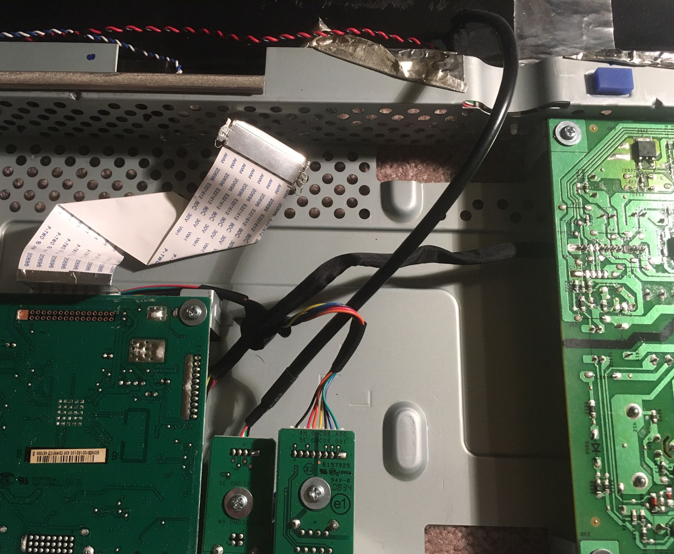

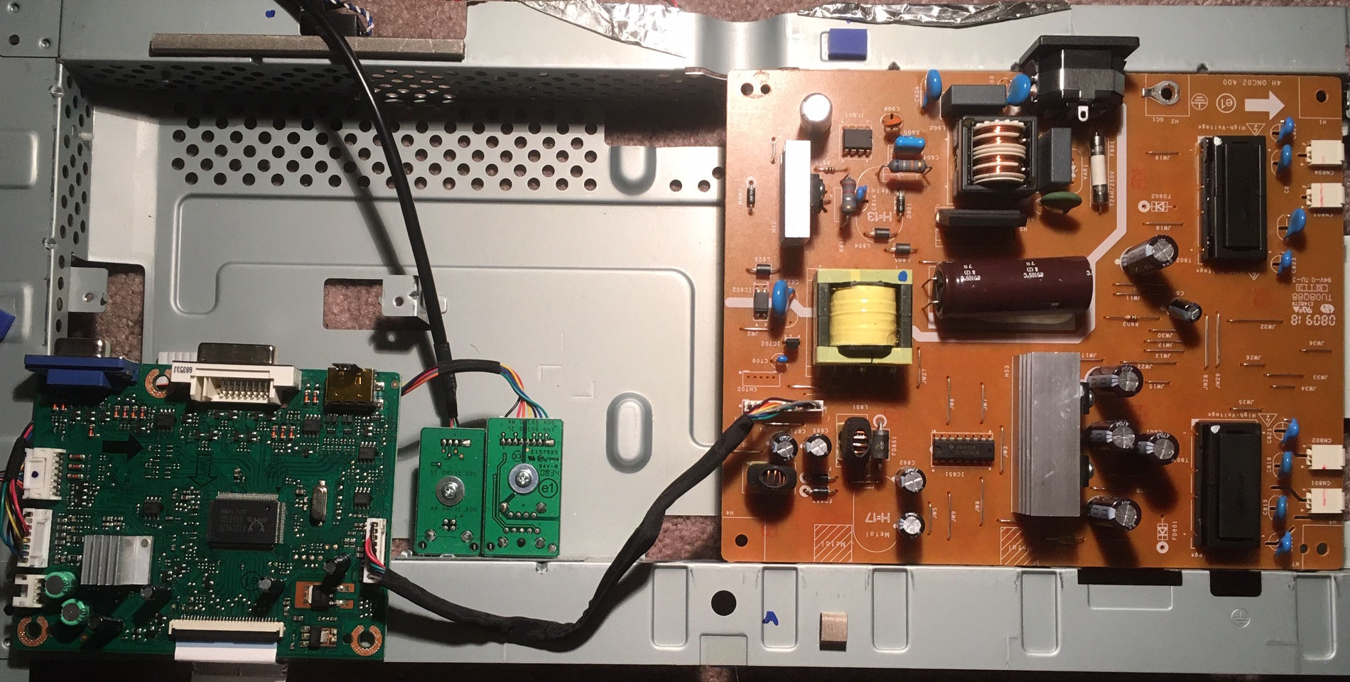

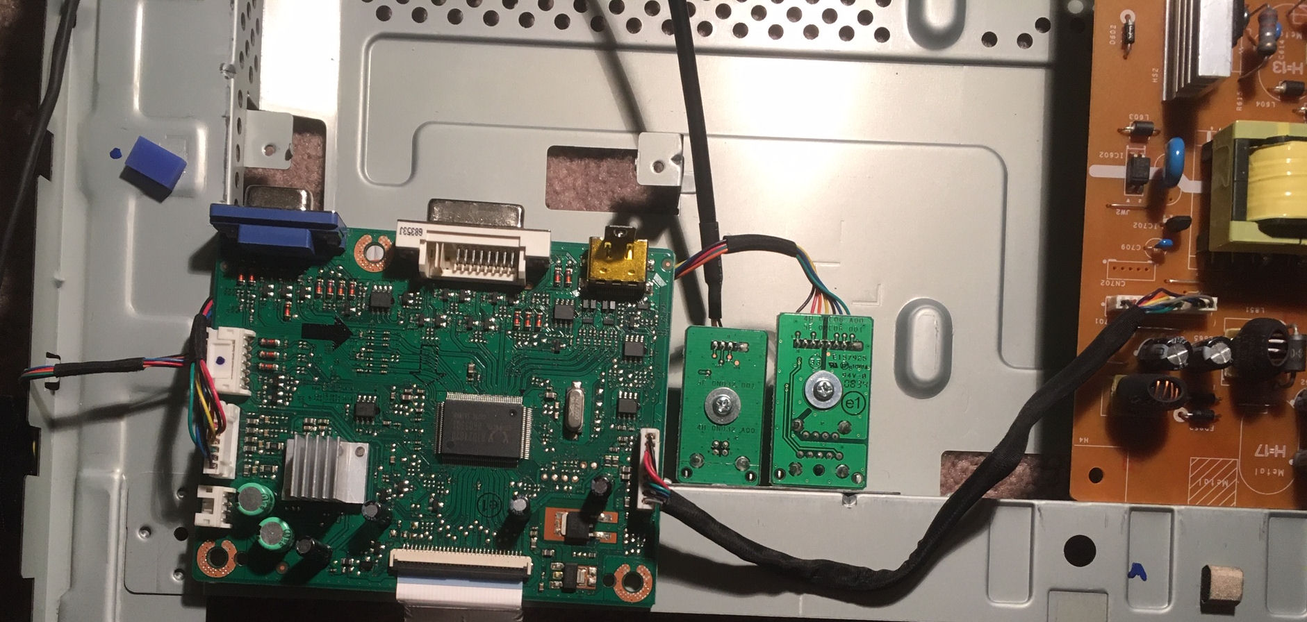

                                      So the 3.3V on the logic board is steady, correct?
                                      Can I see how all the boards and screen are connected together?

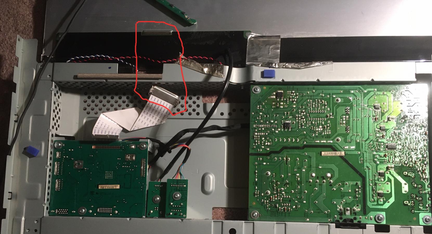

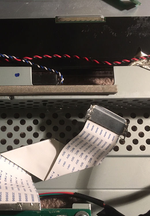

                                        #79
                                        Here are photos as best as I can get. I had to disassemble to get the photos.
                                        To see the other sides of the boards I had to disconnect the pcb/panel ribbon from the screen. The pic with a red circle on identifying the PCB/screen ribbon where it is normally attached when fully assembled. The 4 inverter lights on the right side of the board are also normally plugged in but you can't see those on that view of the boards either. Hope this is close to what you wanted. oh, and don't worry, I have anti static measures and only placed on carpet because it was the best lighting. Thanks again!!
                                          #80
                                          "I completely hooked up the rest of the monitor and had power on the logic board and the standby board. However, the monitor would only come on with a complete white screen flash twice and then go back to standby"
                                          Does it stay on if the ribbon cable to the LCD panel not connected and the monitor is also connected to the running PC?
                                          https://www.badcaps.net/forum/attach...9&d=1598068094
