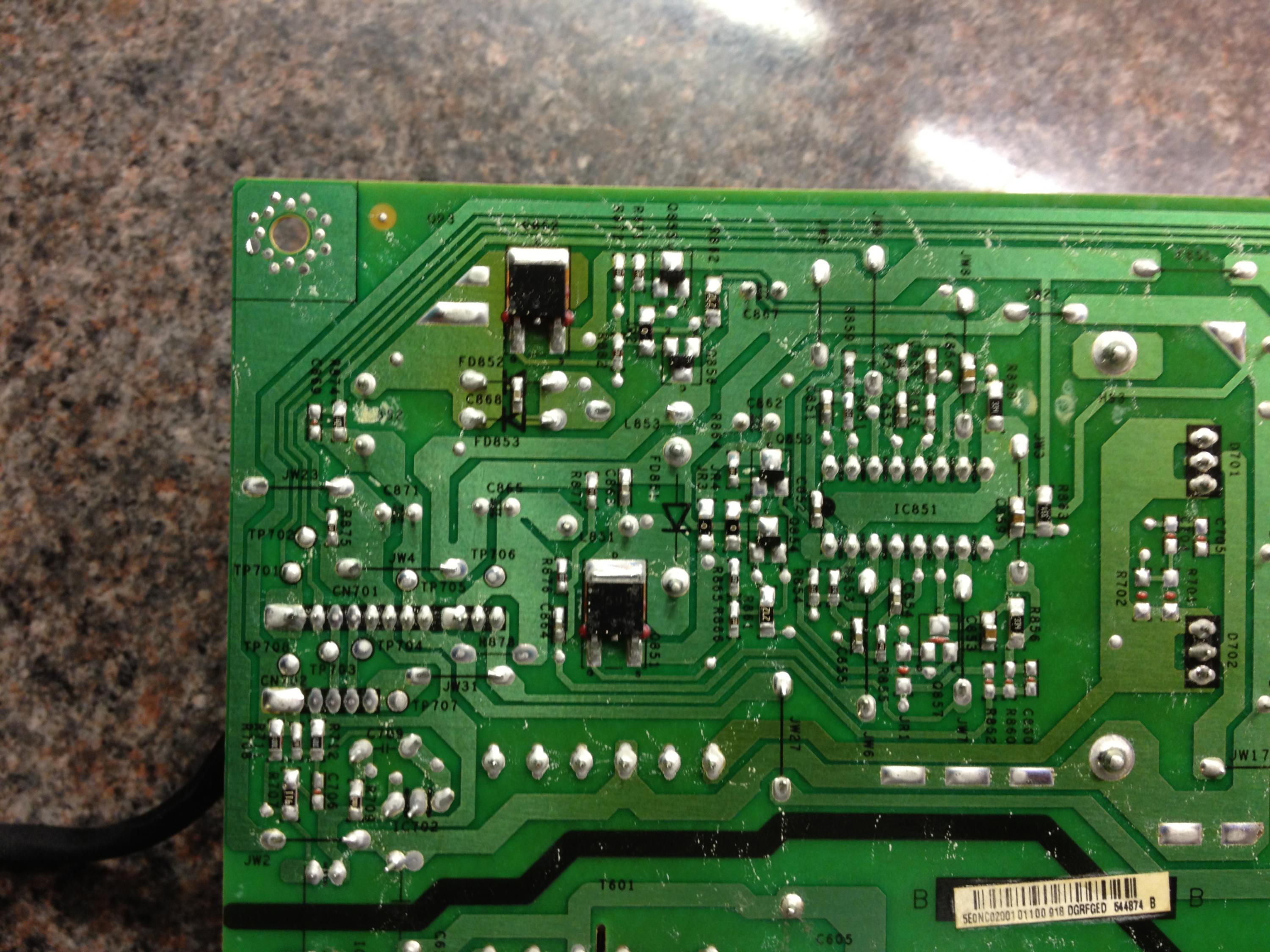

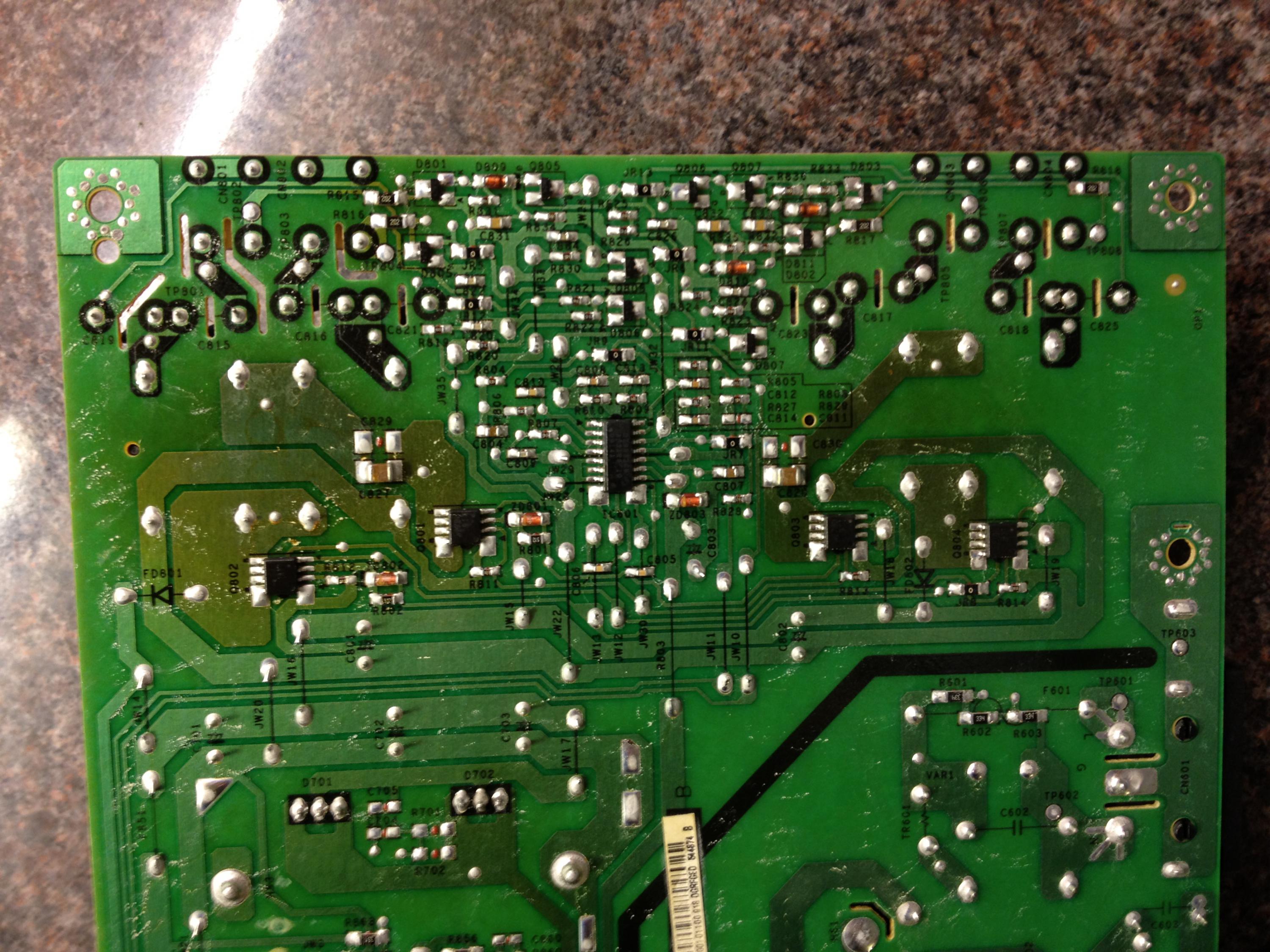

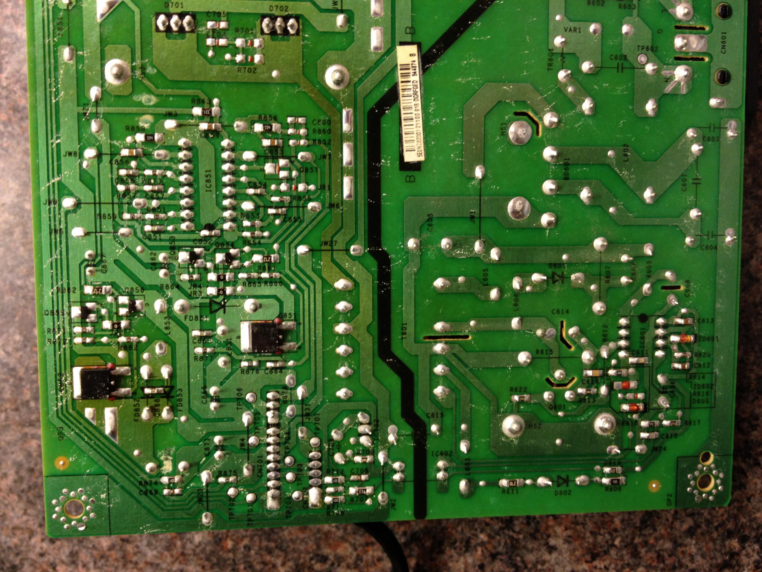

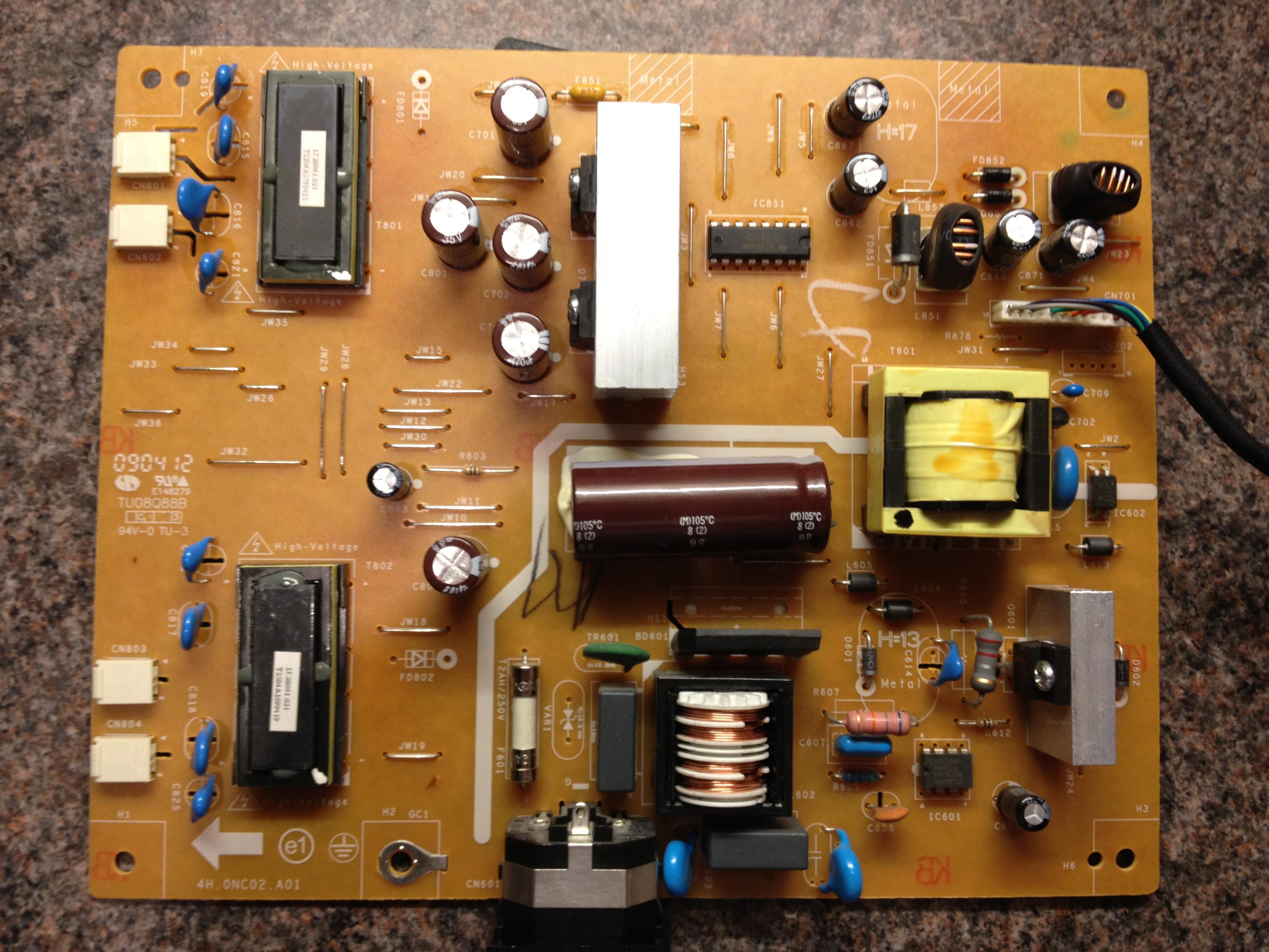

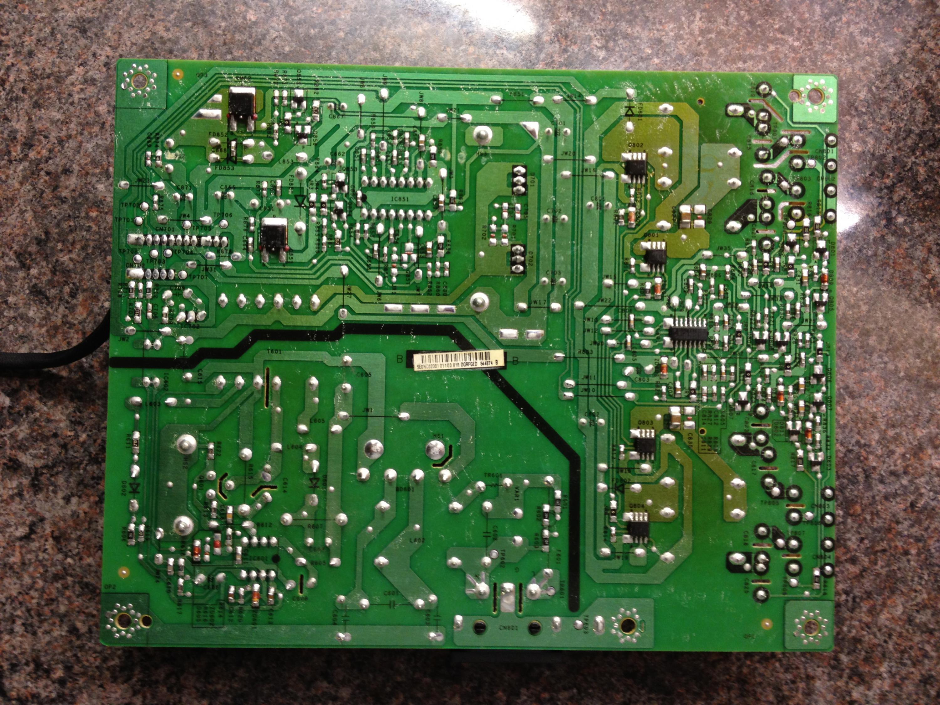

    Asus VW246H will not power on
    I have been reading quite a few posts in the past couple of days and I am amazed at the level of help offered on this forum.
    So many people, giving so much time to help others is outstanding.
    Some of the content is waaay above my head, as I am a complete novice when it comes to electrical components, so please be gentle.
    Anyway if you could help me to diagnose the issue with my monitor - Asus VW246H it would be greatly appreciated!
    The monitor will no longer power on, no power LED - nothing.
    It has been playing up for a couple of months. Would power on & off using the power button OK. Unless the mains plug was switched off.
    If this was switched off the monitor would not come back on unless I disconnected all of the cables overnight. Then the next day it would power on again.
    Now it has stopped altogether.
    I have taken it apart and cannot see any obvious signs of the caps being faulty. None of them have 'blown' and although parts of the board do look slightly brown, nothing obvious appears to have blown.
    I have seen a replacement power board here: http://parts-lcd.com/asus-parts-c-2/...01-p-1025.html which if it comes to it, I am prepared to buy.
    However, I would like some further diagnosis this is at fault before spending the cash.
    I only have a multi meter available to test components, which I understand is not enough to test the caps properly.
    I hope the attached photos are good enough quality to help, if not or others needed please let me know.
    Please help! Where do I start??

      Ok, excellent first post. That helps a lot. I'll start with some basic tests since you admit you are a novice (we all were too once). From your symptoms it sounds like it could be that startup cap on the lower right (C606?). That big cap should show some very high voltage. Around 230v * 1.414 = 325 or so. Notice that thick white line to the left of the plugin? That is the "hot" section of the power board. If any of the components in that area are out then you won't get 325v to the main (big brown) cap. Here's the way I would start out...with power board unplugged..
      1. Test the white F601 fuse (use lowest ohm setting and look for low ohms)
      If the fuse is good.....
      Now you have to plug in the power board and be cautious...
      2. Check for voltage on the main cap leads. There should be a marking for the + or - on the board. You'll need to set the multimeter to DC, high voltage.
      You could also order a startup cap (lower right -- C606?) if it passes both of those tests.
      If it passes both of those tests then let us know and we can move on from there.
      Just be real careful on the main cap test. I usually put my elbows on the bench to give me steadiness with the probes. Good luck mate!

            Re: Asus VW246H will not power on
            Fuse and main cap are ok...
            Lets check voltages at the connector from the PSU to the Main board.
            DMM set to 20VDC black probe to chassis (screw hole is good) and red probe to each pin and post results.... Also check for any markings near the connector that would indicate the correct value for each pin... Take a photo of it for us too

                  Hi - Iam just on my way out but another quick test would be on the yellow/orange torpedo fuse at the top of your first picture designator is F851.
                  NO power to boards meter on ohms 200 should read the same as holding the probes together.

                    Ok Robster. Let me translate; since I remember what it was like to be a novice.
                    Selldoor - is asking you to check the fuse F851 just like you checked the white one earlier. Should show very low ohms if its good.
                    Newtothis - is asking you to see if you have any voltages going to the main board. The connector is CN701 and it's the white plastic thingy with the wires coming out. Set to 20 volts dc and put the red probe into the holes where the wires are. The black probe goes to a screw on the main board (cold ground). You should see voltages like 5v, 12v. Any voltage at all. I doubt you will, because I don't believe your power transformer is starting up at all.
                    You can disregard the comment about the ccfl's because they won't cause a no power/led problem.
                    Also you UK guys. He needs to be able to get a low esr 47uF 50v capacitor in the UK. Just in case it does turn out to be that little startup capacitor.
