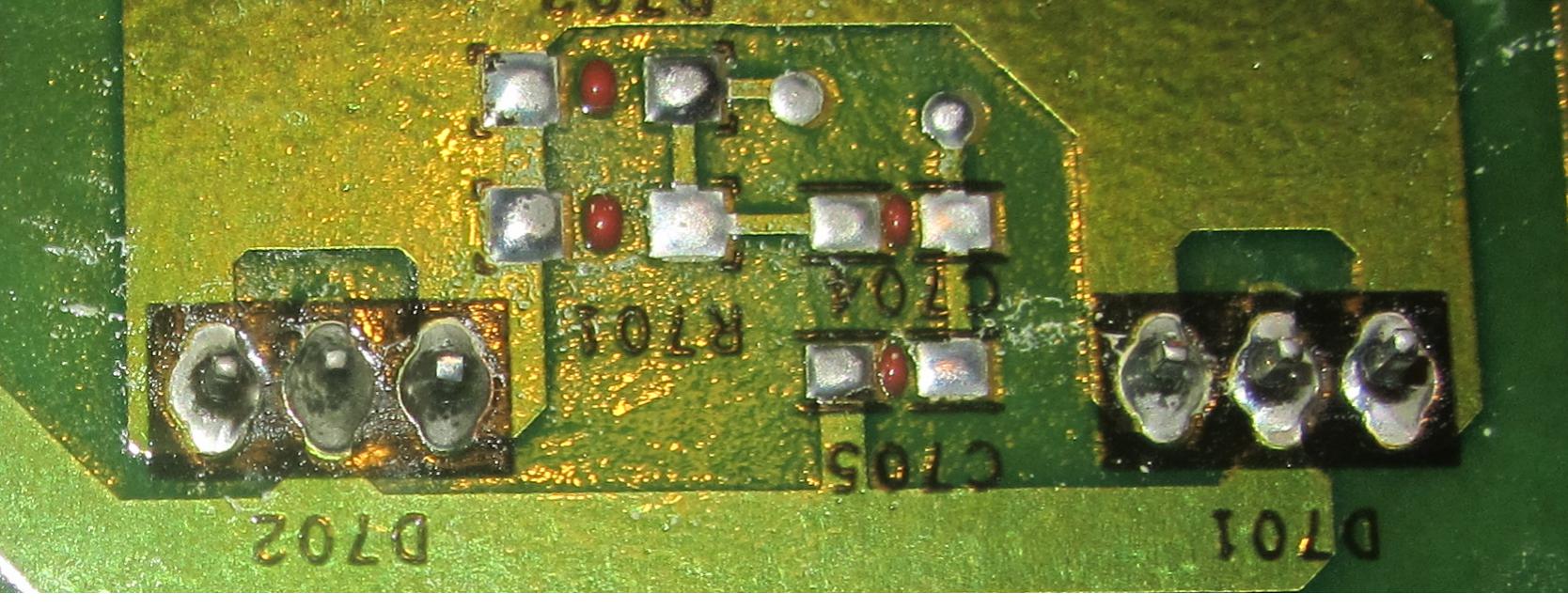

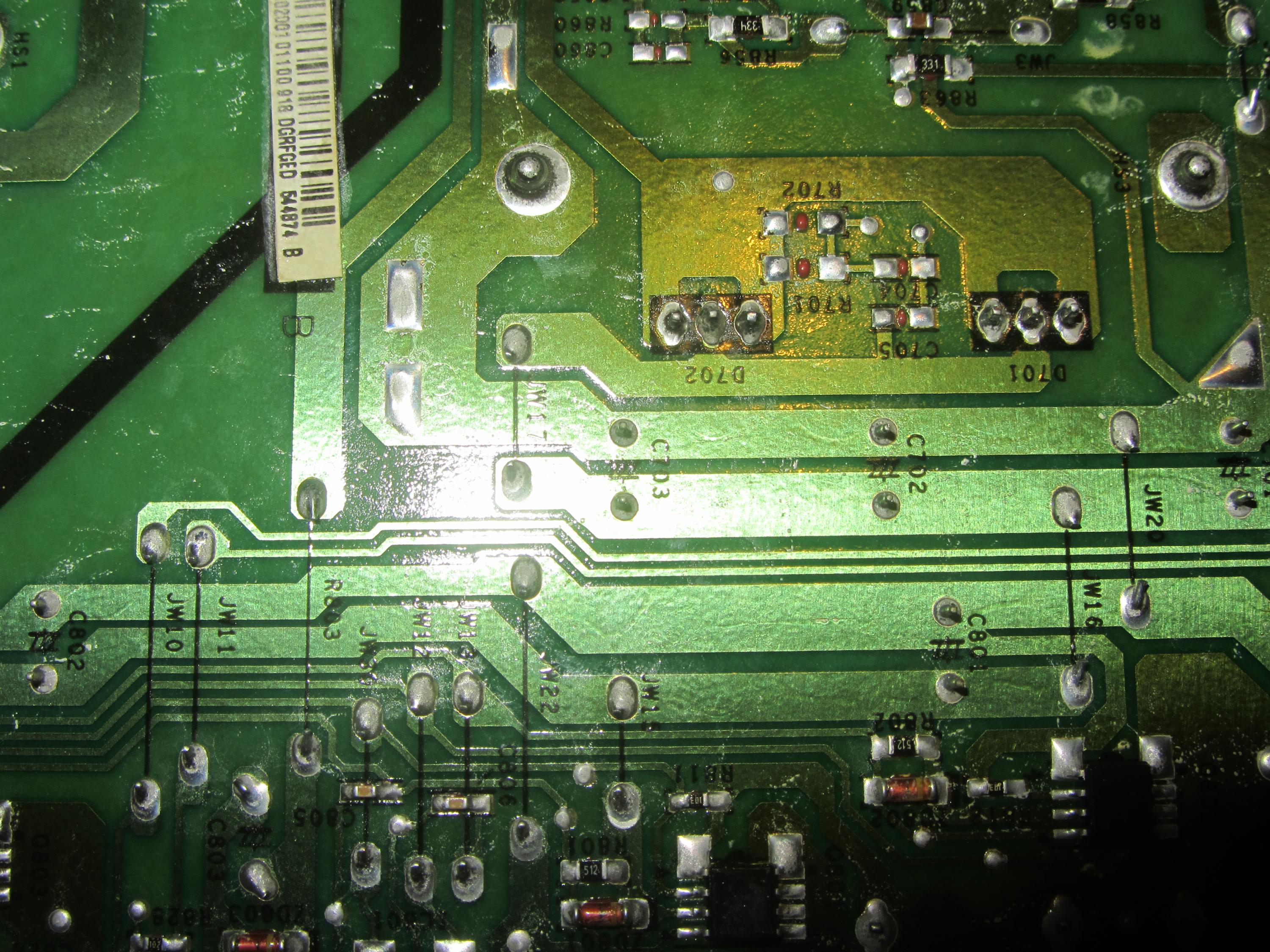

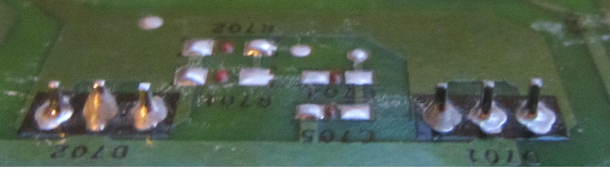

            I have inspected the underside of the board, and have found the attached images.
            I have only the research I did on Google to try to identify a 'cold solder joint'.
            The first picture shows the component attached, which looks like two items attached either end of a heatsink.
            Are these the diodes Davi.p mentions?
            Then I have tried to get the best pictures I can of the underside.
            I know they are not the clearest images, but do they look like cold solder joints?

              #46
              Re: Asus VW246H will not power on
              "Are these the diodes Davi.p mentions?" Yes. I don't see cold joints.

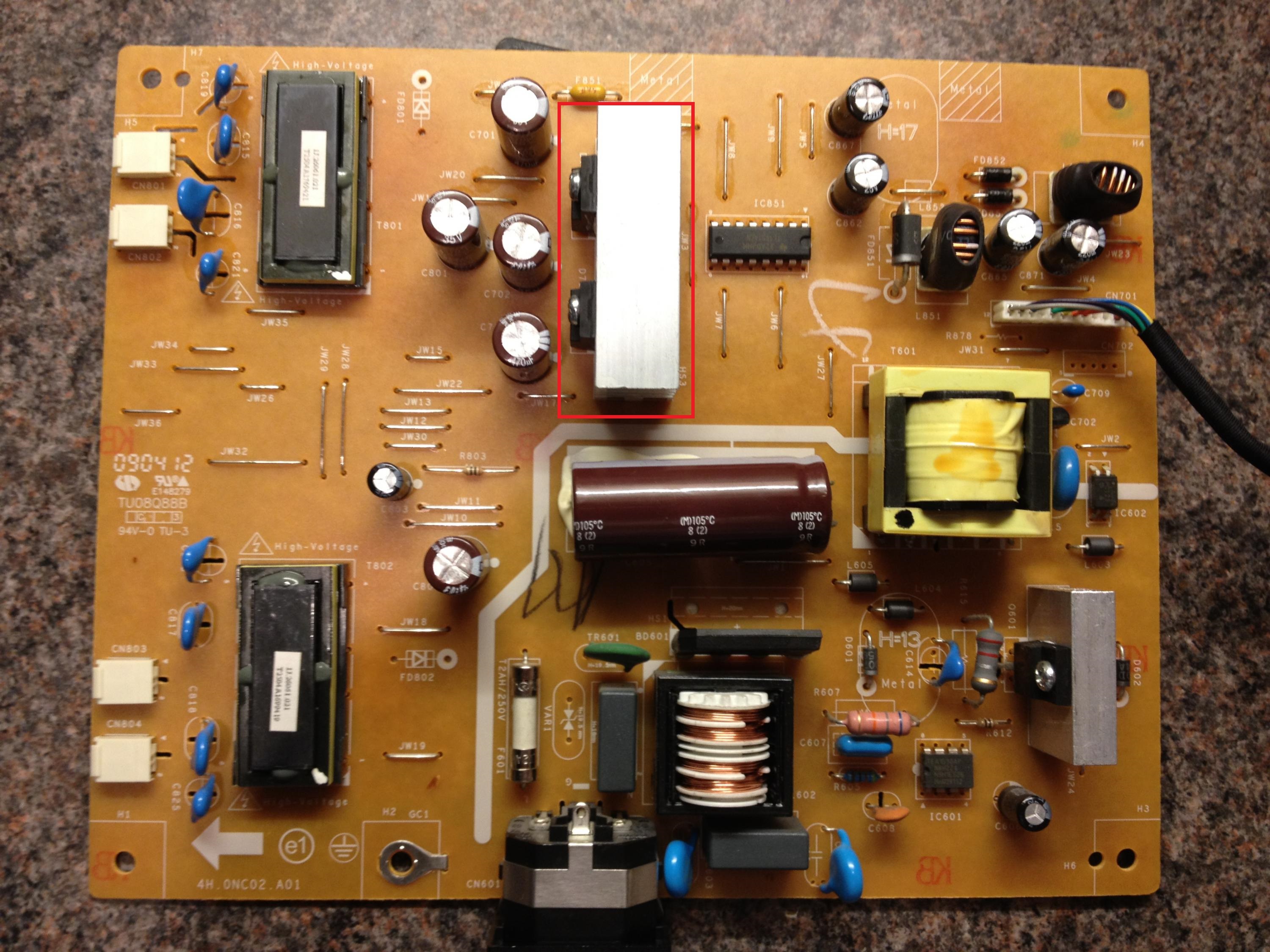

                    Hi all.
                    Long time lurker first time poster.
                    Have same monitor as above with same problem.
                    Unplugged and will not power on again.Monitor did this back in july but after sitting for a week it worked again until now when i had to kill breakers to replace outlet.
                    When I plug it in, power light will flash once and thats it. if i unplug and replug right away it will not flash. If I wait a minute to replug it will flash again.
                    I replaced all caps with new panasonics even the main big cap and it still does the same thing.
                    I have 157 volts on big cap (Im in the USA).
                    I have checked all diodes and resistors(still in circuit, ya i know) and they appear ok.
                    I have not pulled and checked the mosfet(Q601) yet.
                    On the 12 pin connector I have some strange voltages when checking to ground lug on board.
                    Pin numbers and voltages below.
                    1 45v ac
                    2 45v ac
                    3 unused
                    4 unused
                    5 45v ac
                    6 45v ac
                    7 45v ac
                    8 45v ac
                    9 unused
                    10 45v ac
                    11 45v ac
                    12 6.5v ac
                    I have nothing as far as DC volts on any pins.
                    Can any of you gurus advise me on what I should check next.
                    My father was an electronics engineer and I worked in his place for a while so I do have a little knowlage.
                    I am also certified in soldering so thats not an issue.
                    He passed away a few years ago and i have nobody to repair this for me anymore.
                    Thanks for any help or insight you can give me.

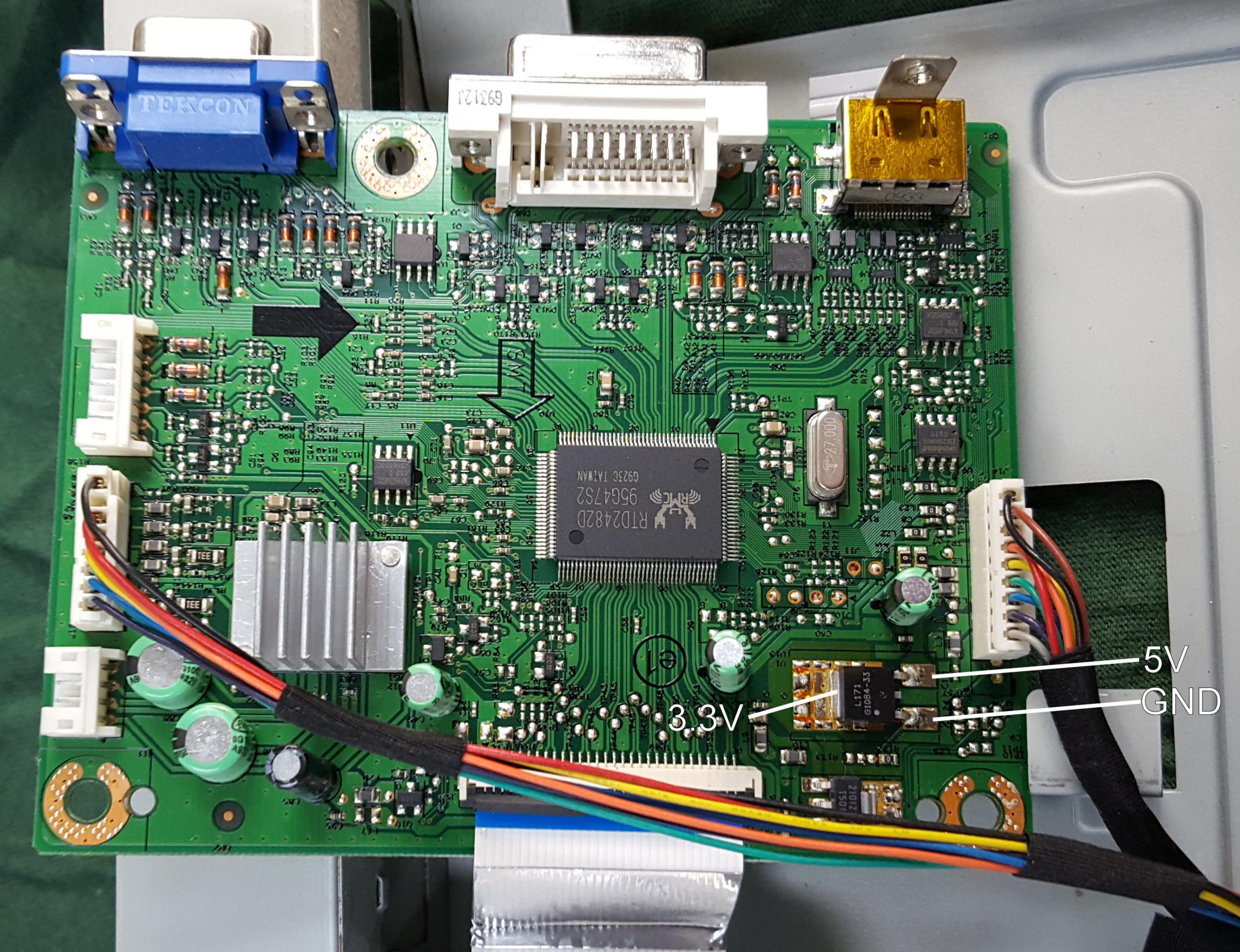

                        Hi Hammer034,
                        I just fixed my Asus VW246H. It had periods when it would not turn on until it had a rest for a few days. It finally failed to turn back on after a black out in our area. I checked the power supply board and had the same 5v DC voltages at the connector to the main board as you indicated. On the main board I found a 3.3V regulator (G1084-33) this had 5v coming in but no 3.3v going out. So after replacing this regulator my monitor is working.
                        I hope this will help you.

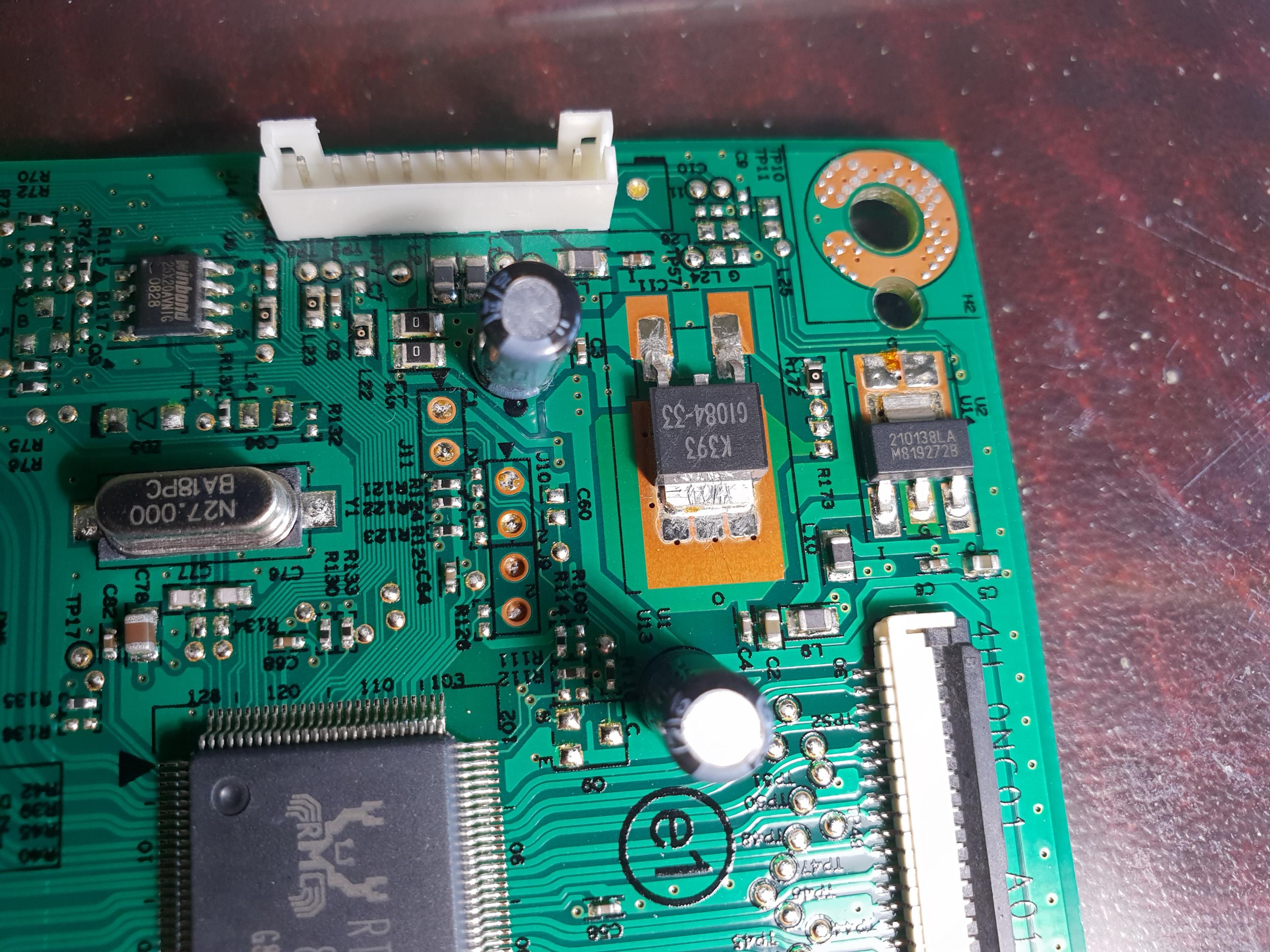

                            #53
                            Sorry I forgot I had a photo.

                                #55
                                Thanks to jadgtiger777 my monitor is workin again.
                                It was the g1084-33 regulator on the mainboard (logic)
                                The regulator wasnt puting out any voltage.

                                      Hi Luke
                                      The second regulator if my memory serves me right takes the 3.3V and puts out 1.2V that the push buttons use. So if the 3.3V regulator isn't working you will not get the 1.2V.
