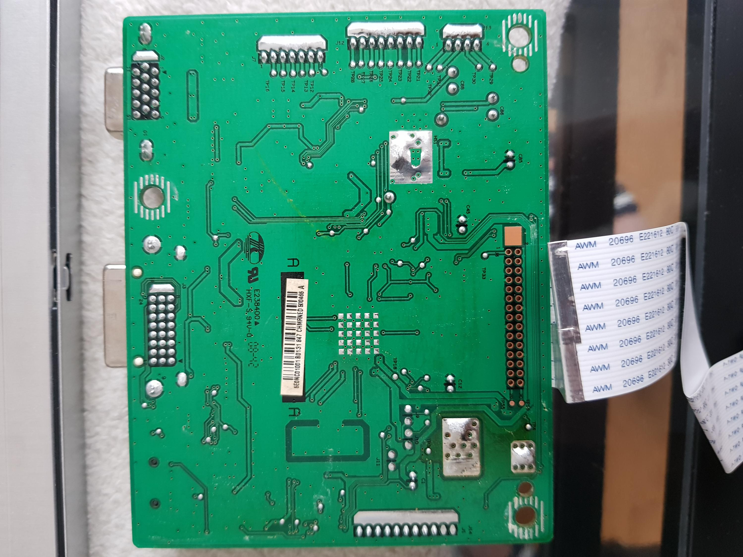

              Hello Guys from Germany! I have the problem that my VW246H will not power on. I used a hair dryer to heat it up a little but and it worked! Afterwards it put outside (0° degrees) for 20 minutes and then it didn't work. If I understood correctly correctly this means there is a cold solder joint on the boards.
              To locate the part where the heat has an effect I decided to heat the parts separately (Plate with buttons, main board, power supply). The procedure was to remove one item, heat it up, install it and try it again. It came out that when I heat up the main board the everything worked again. Due to that I would say there is a cold solder point on the main board. I checked the board visually, but I cannot identify anything "abnormal" (To be honest I am noob).
              Do you agree that it must be cold solder joint or could also be something different? Would it make sense to renew all the solder joints on the backside of the MB?
              Regards
              Jan

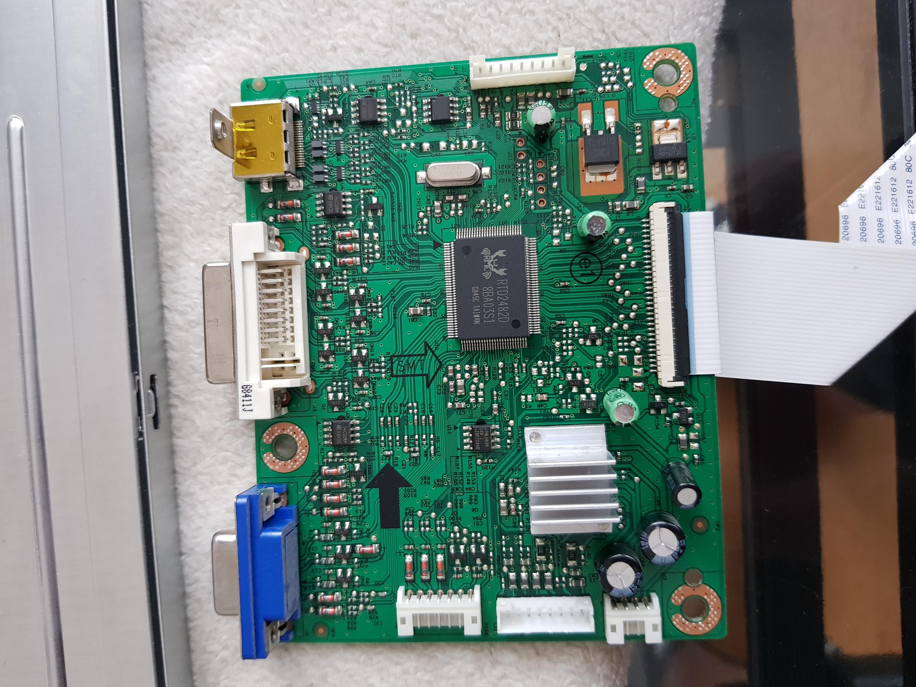

                  #88
                  Re: Asus VW246H will not power on
                  Hi Jan and welcome to the forums!
                  It could be a colder solder joint, indeed. However, I am more inclined to think the issue is related to bad electrolytic capacitors. In particular, I see what appears to be two voltage regulators at the upper-right corner of the board shown in this picture:
                  https://www.badcaps.net/forum/attach...1&d=1610274625
                  If you look carefully, you can see that the PCB around and under them has become darker, likely due to the regulators running hot. This doesn't mean the regulators are bad. Linear regulators do tend to run hot, so this could be normal. However, the heat from these regulators can (and often does) make cheaper / inferior quality electrolytic caps go bad over time.
                  The two small green caps (looks like Lelon or Ltec brand) close to those regulators likely filter power from the regulators. So my suggestion is to start by removing those two capacitors and checking their ESR - if you have a capacitor meter, that is. If not, just replace them. While at it, you may also want to replace the other electrolytic caps on the logic board too, as they could be starting to fail too.
                  When replacing electrolytic capacitors, make sure to use a good quality brand and low impedance / ESR. For an application like this on the logic board, ESR/impedance is not too important, so anything from "entry-level" to "very low" ESR should be OK.
