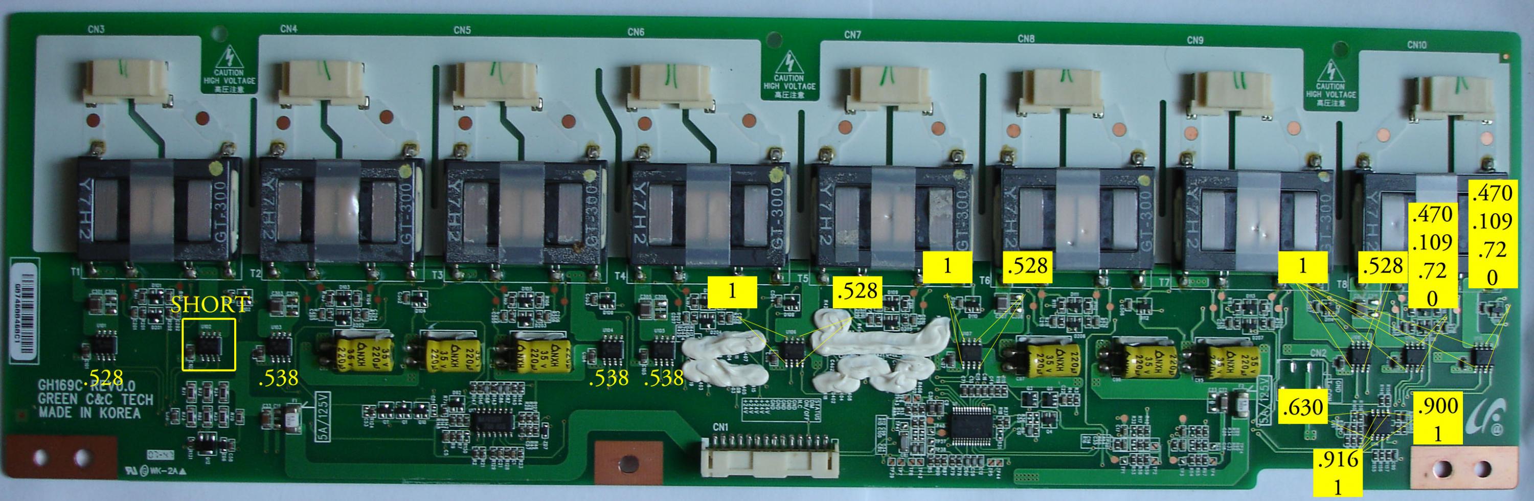

      Let's see. So I have to measure pins:
      1-5 / 1-6
      3-7 / 3-8
      (2 MOSFET from LEFT to RIGHT) short S2 - D2 pins / S1 - D1
      This is definatelly bad.
      (6,7, 9, 10 MOSFETS) "1 aka OL" S2 -D2 at first trial but will charge after a few attempts to measure them.
      Last two MOSFETs (9, 10) - first time I got short only between S1 - D1.
      After a few trials I found out that last two give me a few readings.
      0.72 / 0.450/ 0.470 / 0.270 / 0
      Picture attached.

          budm. I think so, alot of them, all in the first row have the same code.
          Tried your method with 200 Ohms scale.
          Now it show "1" everywhere with one exception - 2nd MOSFET. The one I was sure it was bad.
          Can you verify if these are the right pins?
          1-5 / 1-6
          3-7 / 3-8
          Thanks.

                  By the way:
                  "Can you verify if these are the right pins?
                  1-5 / 1-6
                  3-7 / 3-8"
                  This is how the pins are setup:
                  Pin 1 (dot) =S2
                  Pin 7~8 = D2
                  Pin3 = S1
                  Pin 5~6 = D1

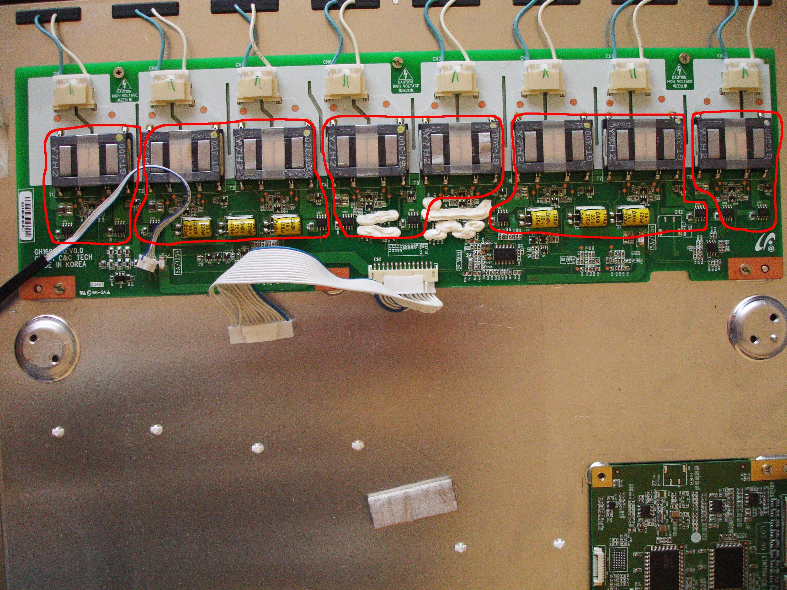

                    Re: Samsung 305T Plus black screen
                    OK, I look at the inverter transformer drive circuits setup.
                    There are 5 sets of transformer drivers.
                    The set at both ends of the board uses one set of MOSFETS to drive one transformer, the other 3 sets have the transformer's primary windings connected in parallel and driven by one set of MOSFETS per two transformers.
                    I would inspect the two MOSFETs on the right side of the board since it is setup the same as the set on the left side of the board that has shorted MOSFET.

                      Hi budm. Thank you for corections. I forgot how to read pin order but multimeter was used the right way.
                      Now that you're mention there is something strange with those two MOSFETs on the right side (S1/D1 only). If you see the last picture I got a few random readings . In 200ohm mode everything is fine "1" but if I switch to diode mode and I measure them a few times at some point I get "0". and if I go back to 200 ohm mode fast there is "0" also for a few seconds.
                      I just now measured S1/D1 in diode mode:
                      0.67
                      0.147
                      and last 0.532 which is the quite usual for other S1/D1 MOSFETS.
                      Both give me identical readings when the value change.
                      Another strange thing is that a couple of MOSFETs show "1" for S2/D2 in diode mode. "1" is to low I think.
                      Should I use the gate to charge/discharge the transistor first to get a good reading?
