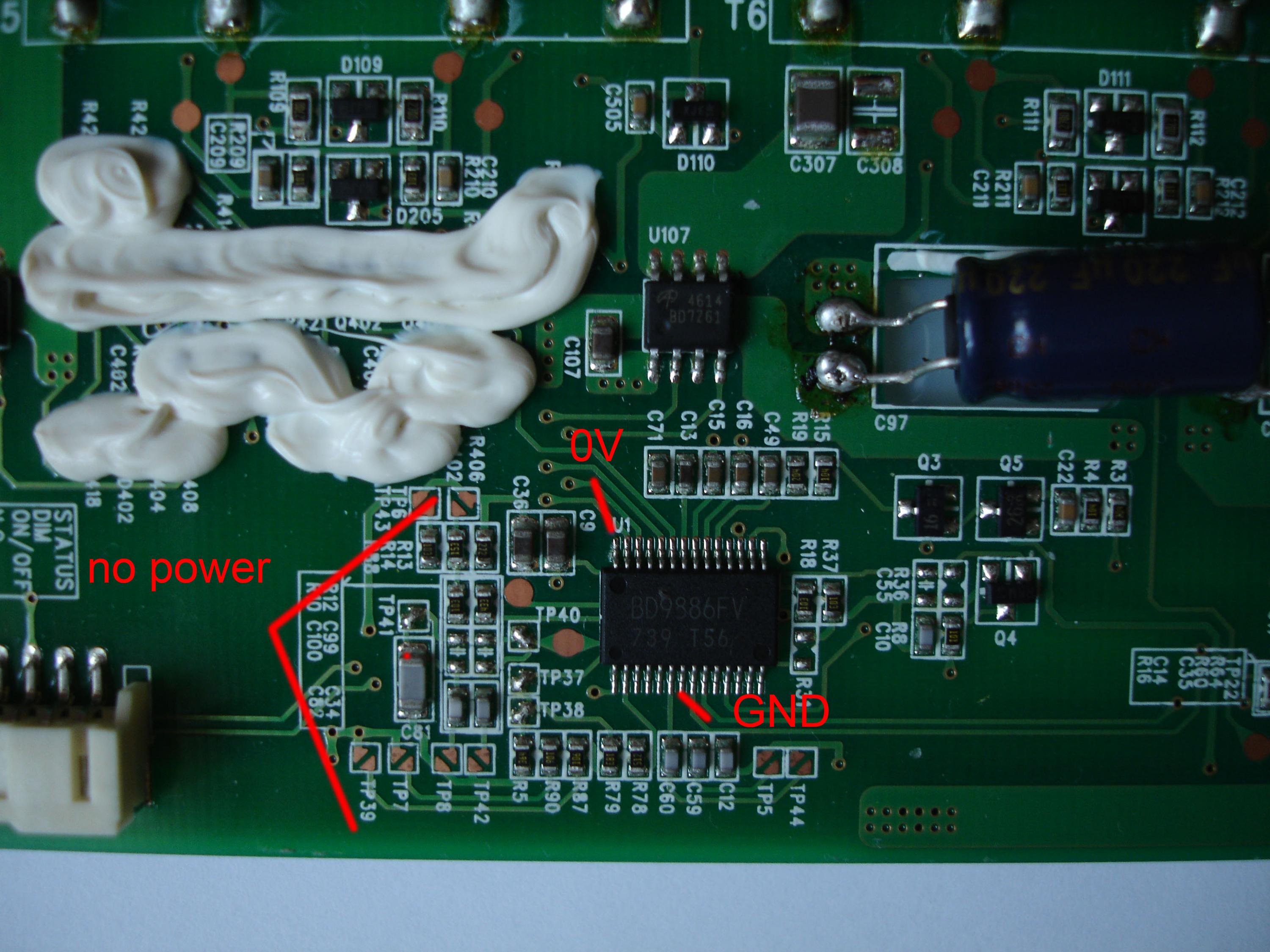

                I'm back with another question if somebody want to help me. I did everything that was told and seams that i'm moving in the right direction.
                From mainboard:
                BL_EN = 2.7V
                Status = 3.3V
                all 24V lines are ok.
                Problem I found: The inverter IC (BD9886FV) has no input voltage (pin 28).
                Look at this pictures for an obvious bad capacitor or maybe you have a clue from where should I start tracking the problem. Thank you.
