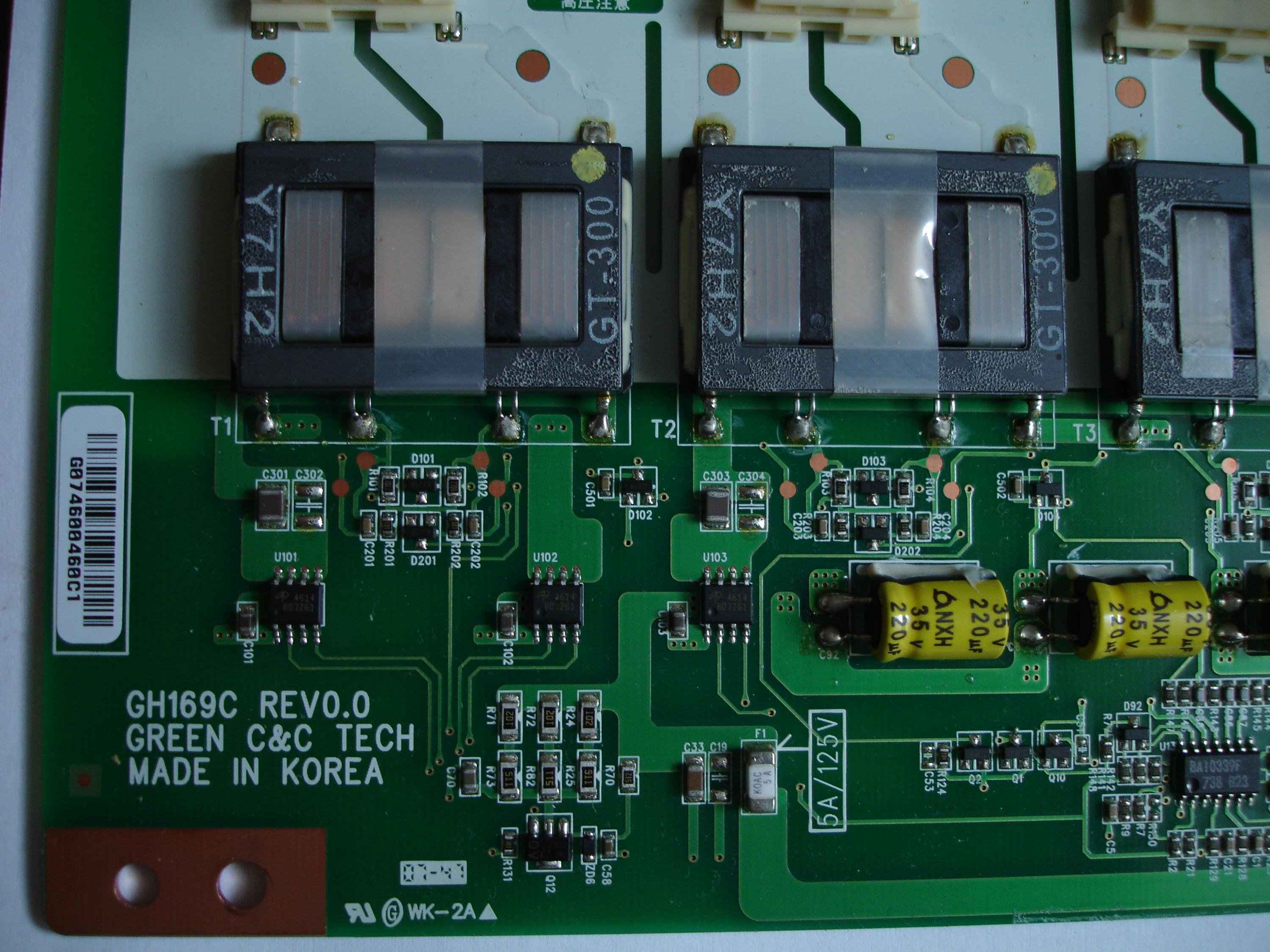

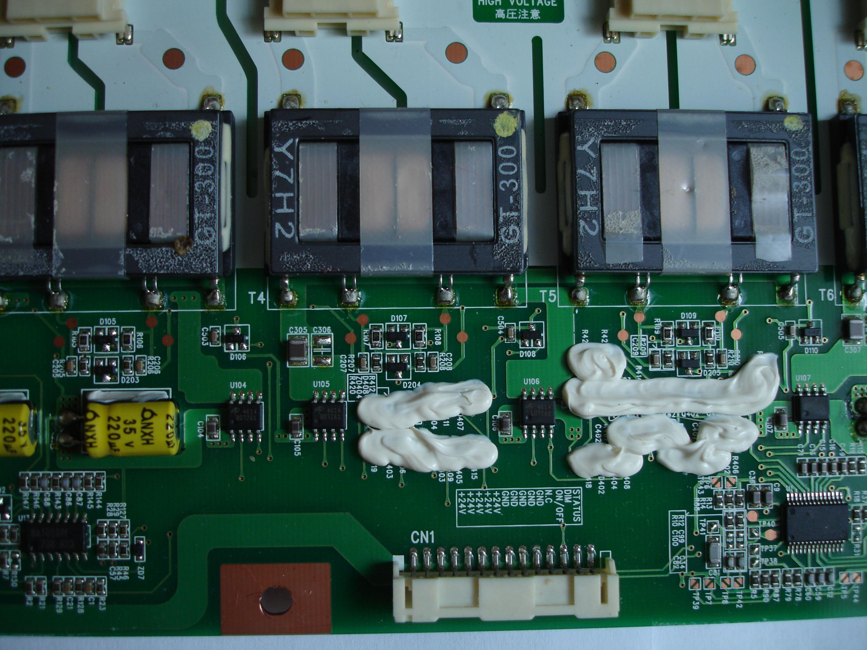

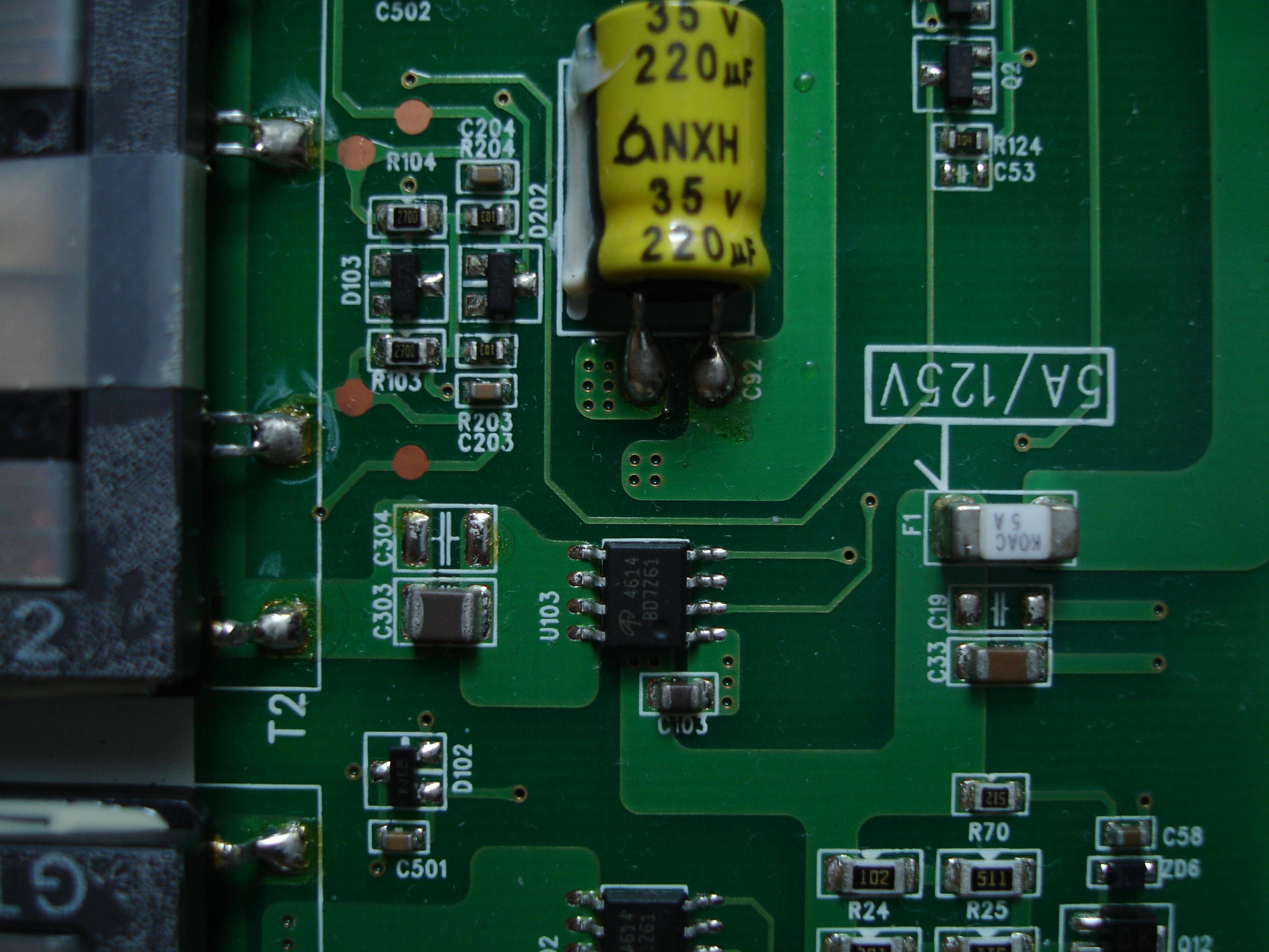

                    ok start easy - on the inverter there are at least 2 fuses small white
                    Power OFF Meter on ohms 200 one probe to each side of fuse.

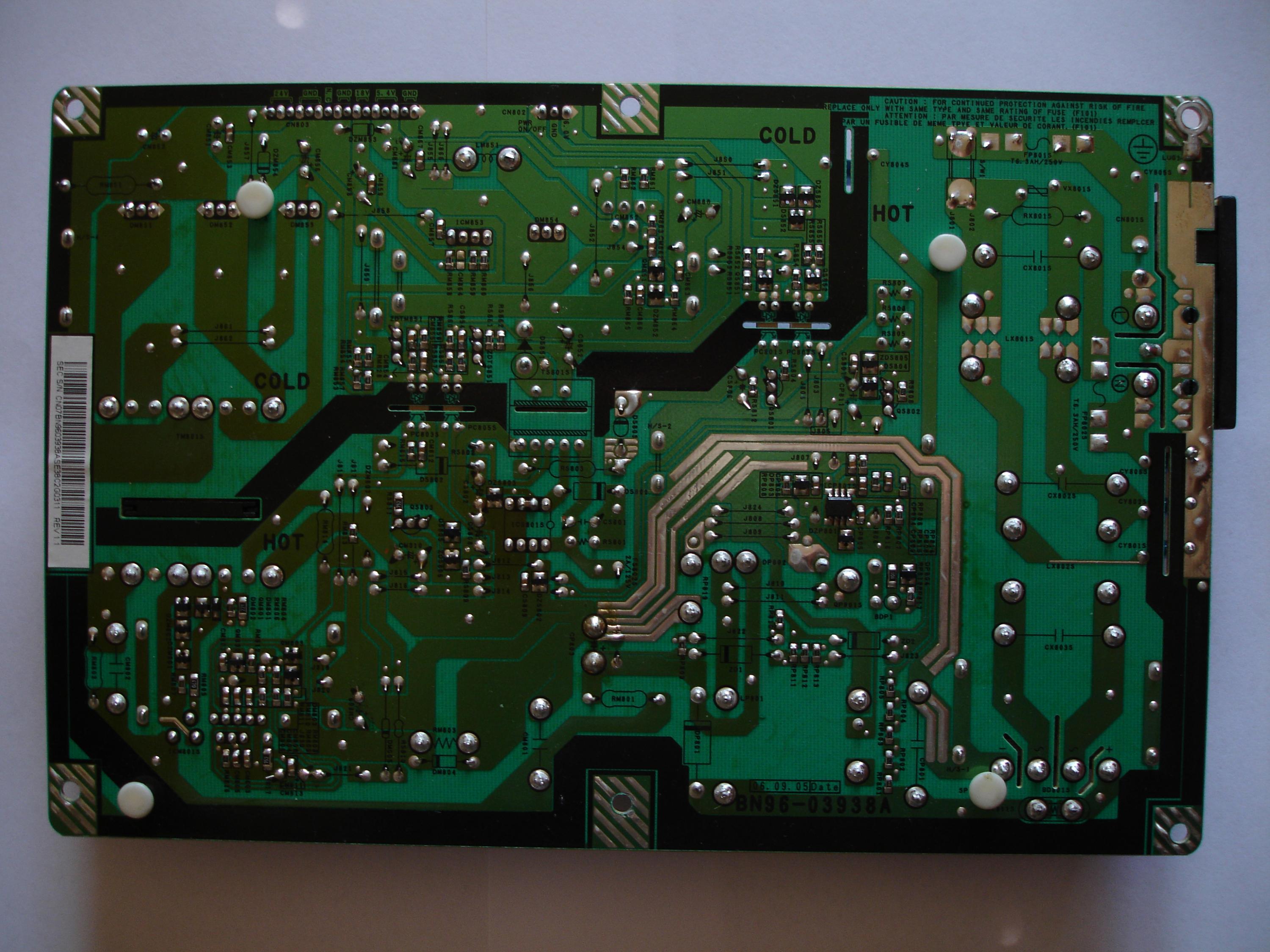

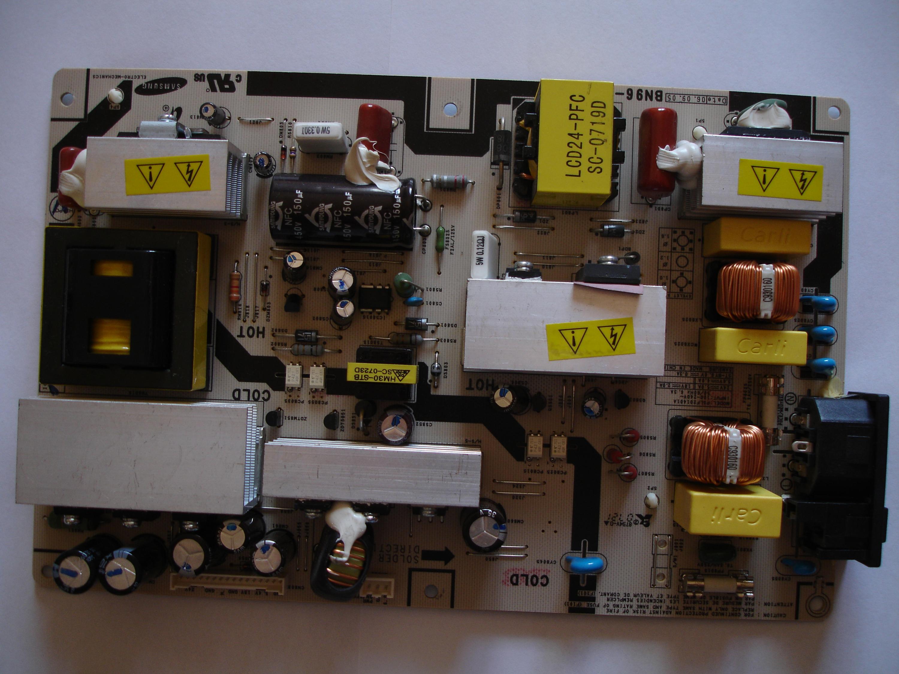

                    In Pic 1 - Power supply in the middle near the legs for the BIG cap there is a green fuse.
                    Same test as above.

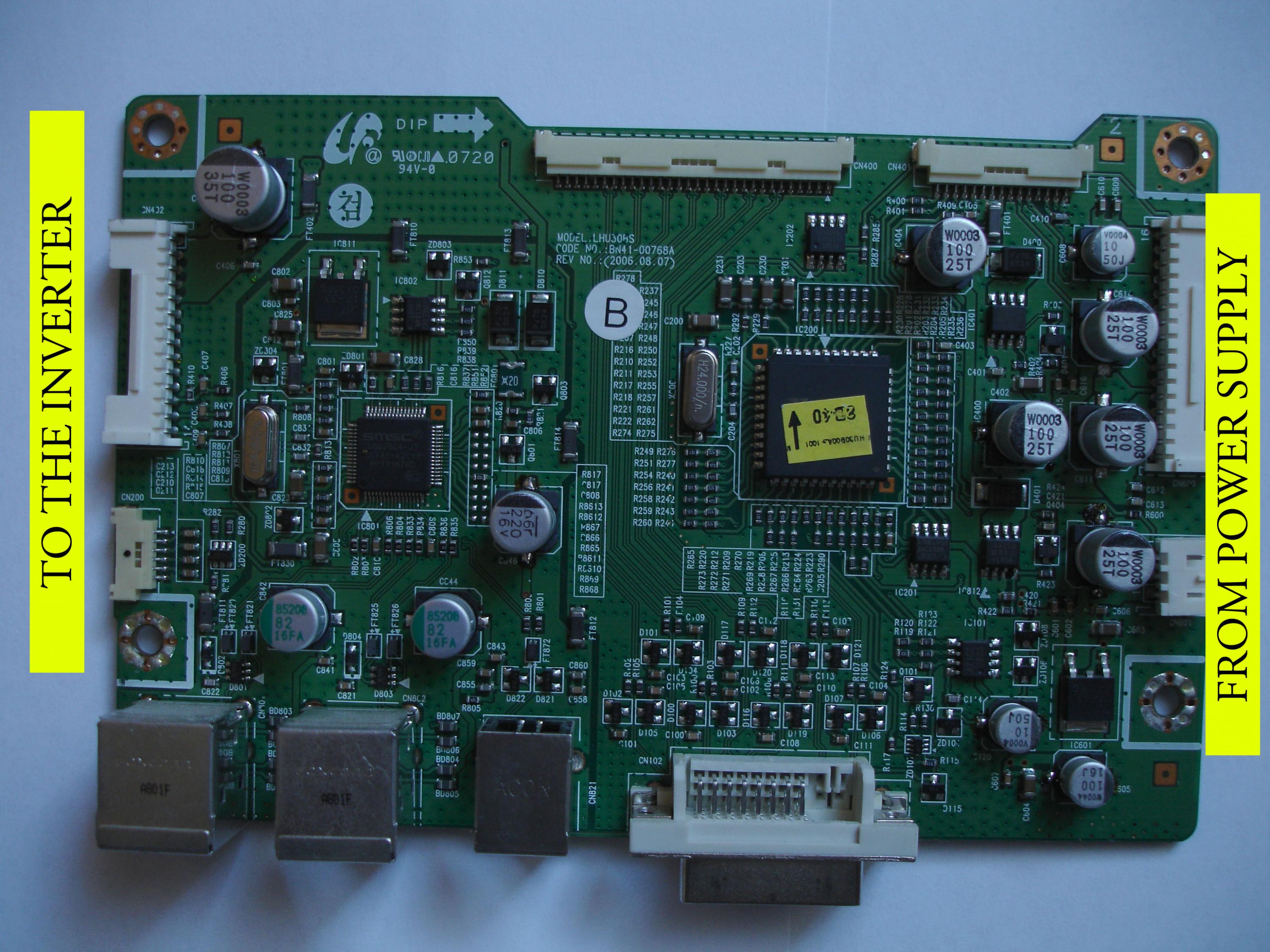

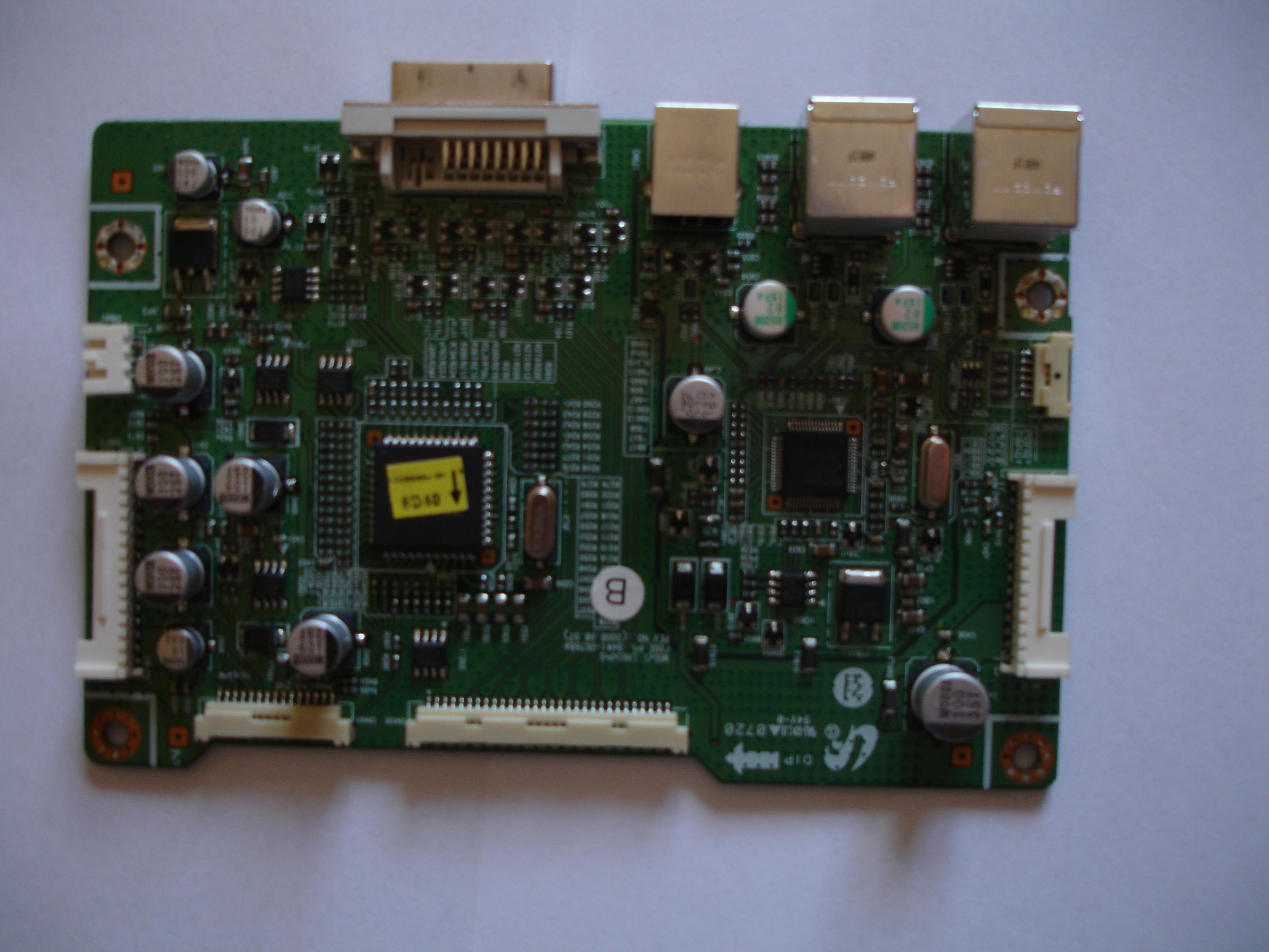

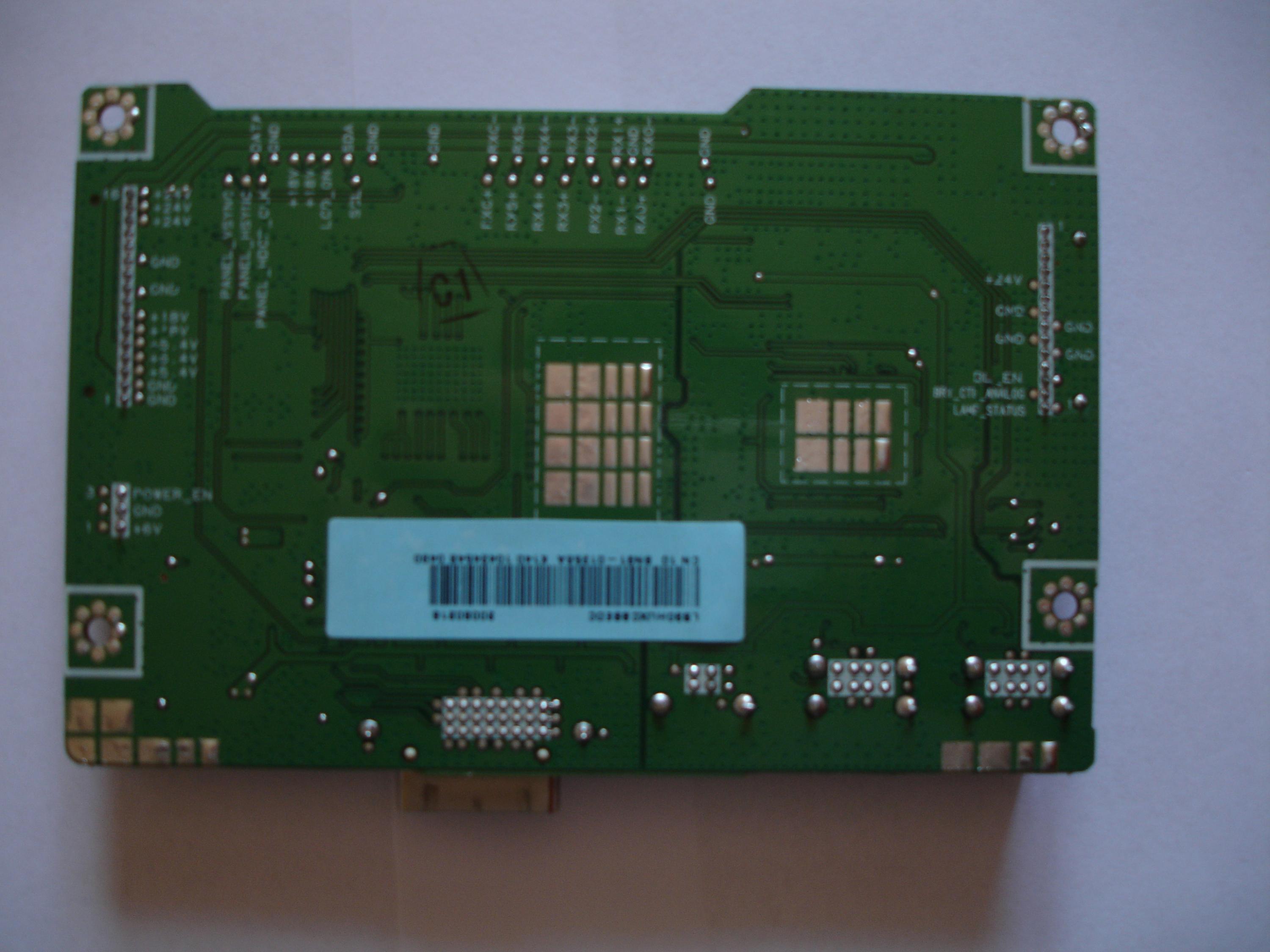

                    Main board pictures are not good enough too dark and out of focus
                      Same test as above.

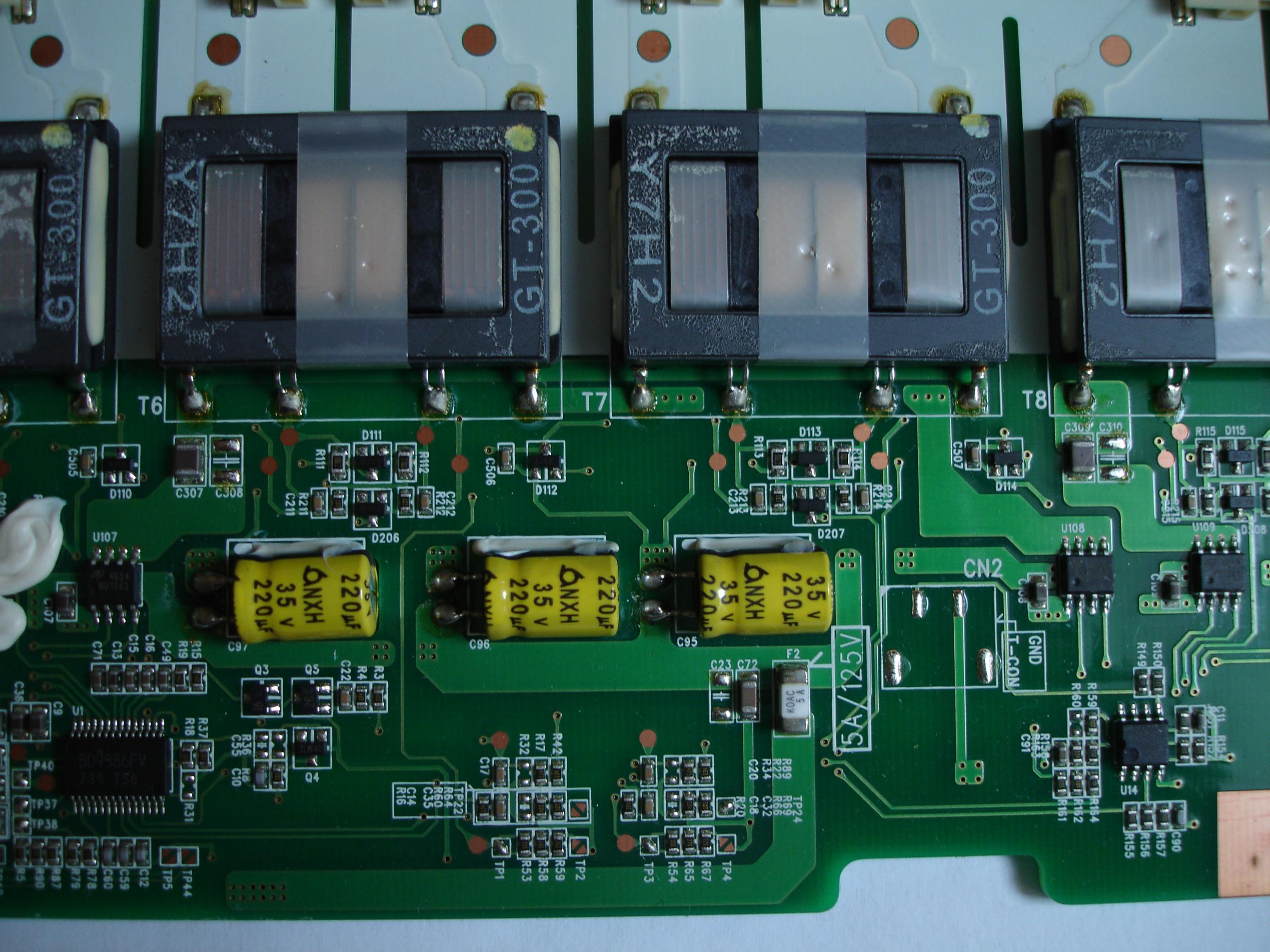

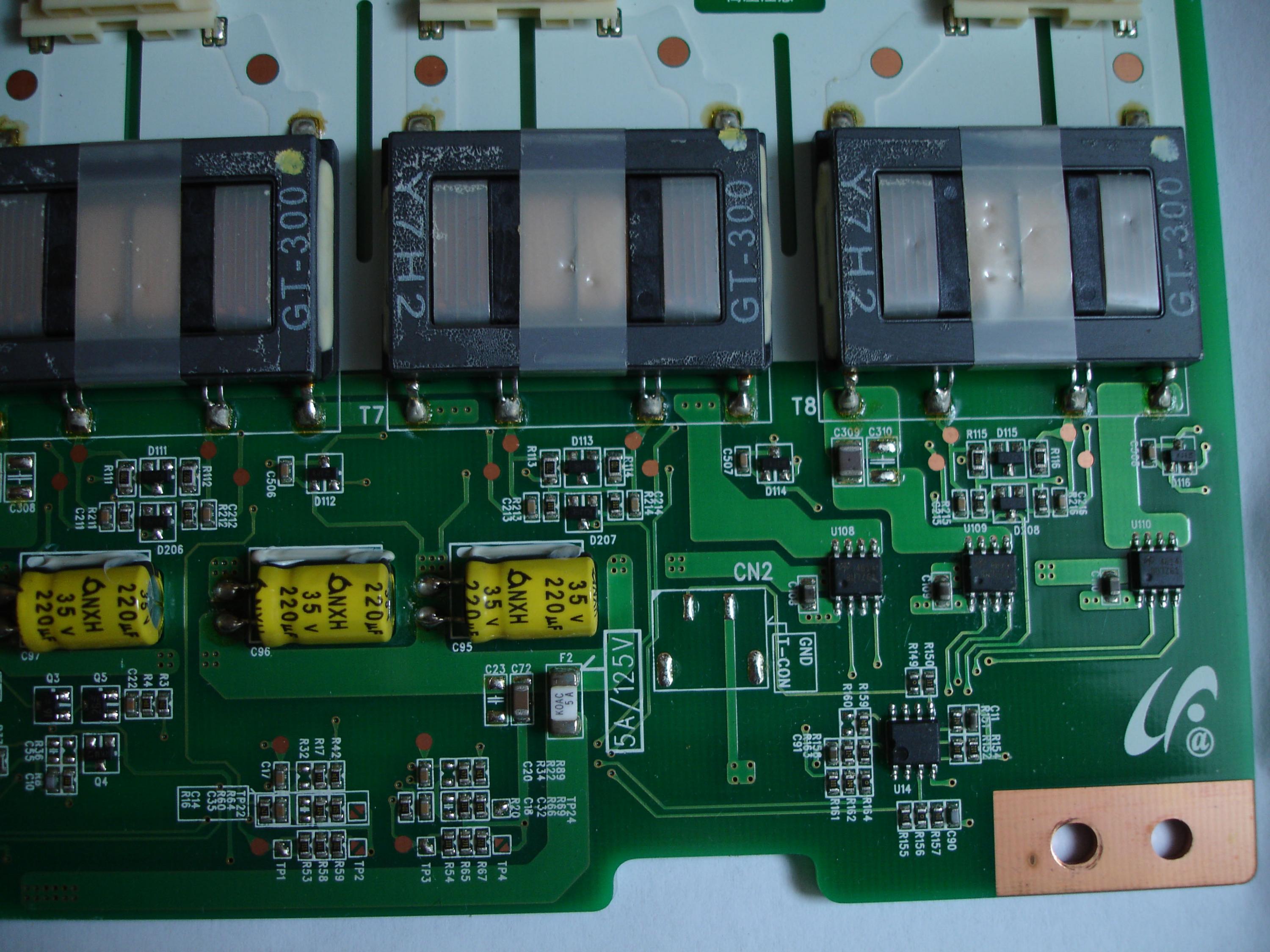

                      Hi selldoor.
                      powersupply - The green fuse is good.
                      inverter - I found two white rectangular devices with silver endings (there is a text on the motherboard pointing to them [5A/125V]. I don't get any readings. (tried both diode and 200ohms methods).

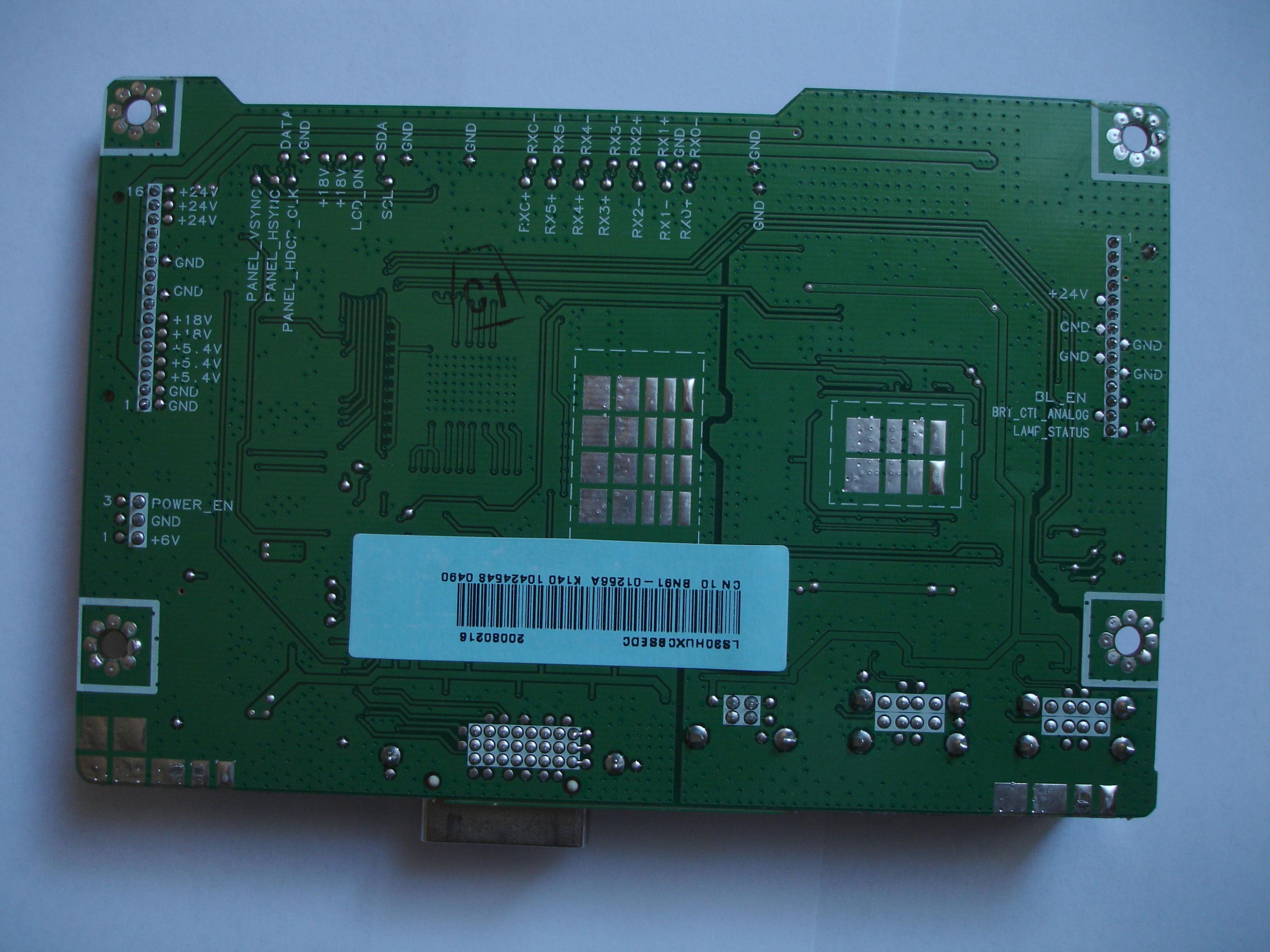

                      New motherboard pictures:

                        Re: Samsung 305T Plus black screen
                        Yes those are the fuses.
                        There is no such thing as "no readings" unless your meter has died and you have a blank
                        screen on it.
                        We would expect your meter to read 0.00 or close (is that what the green fuse read)
                        OR it will display a 1 or OL on the left hand side of the meter?
                        On the main board near the B sticker there is a Green rectangle with X20 on it.
                        That is a re-settable fuse- measure the same as before meter on ohms 200.

                          Sorry...I mean "1" - so those fuses are bad.
                          X20 - good.
                          Thank you for helping me selldoor .
                            Yes.
                            They are not that easy for many people to get hold of and postage makes them
                            quite expensive.
                            If you are very careful (for test purposes only)you can get away with 5A Car fuses, Well Insulated and wired up. You can solder them
                            to the existing fuses, saves wear on the board.
                            When you get the proper fuses they can also be piggybacked on top of the old fuses, again it seems easier to solder and saves making an error on the board.

                                You are correct but I suspect it will be very difficult to trace.
                                What I suggest is you set your meter on ohms 2000 and test from each side of each fuse to ground. (if it goes to "1" move up the range)
                                These fuses are often rated quite close to the amps on the board so they do blow quite frequently. I am wondering if they have been put under extra stress
                                as the caps are Samyoung so may well be shot ( are only reckoned to be mediocre at best. I cant tell from the picture if they are bulged at all - inspect them .Perhaps replace them whatever.

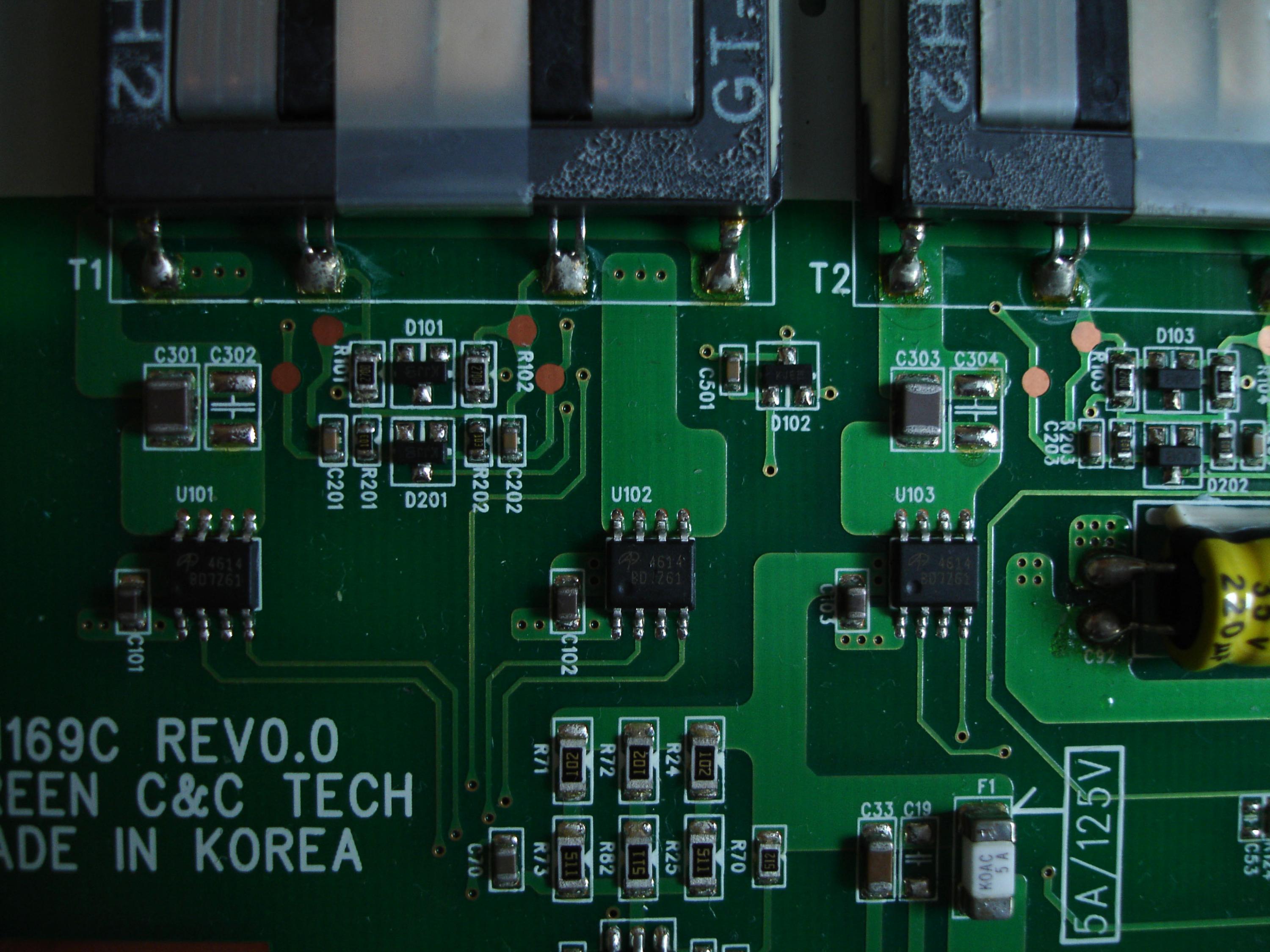

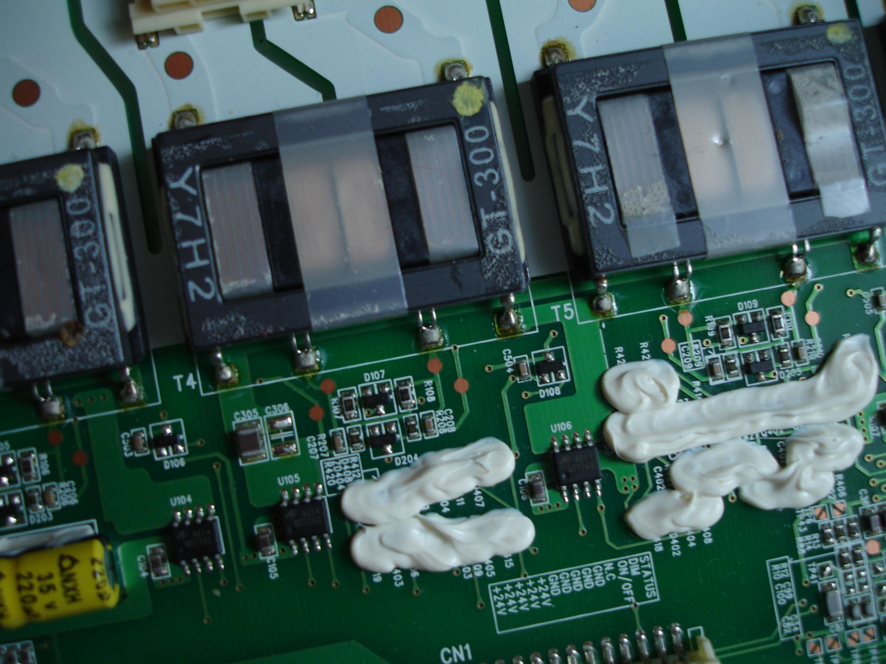

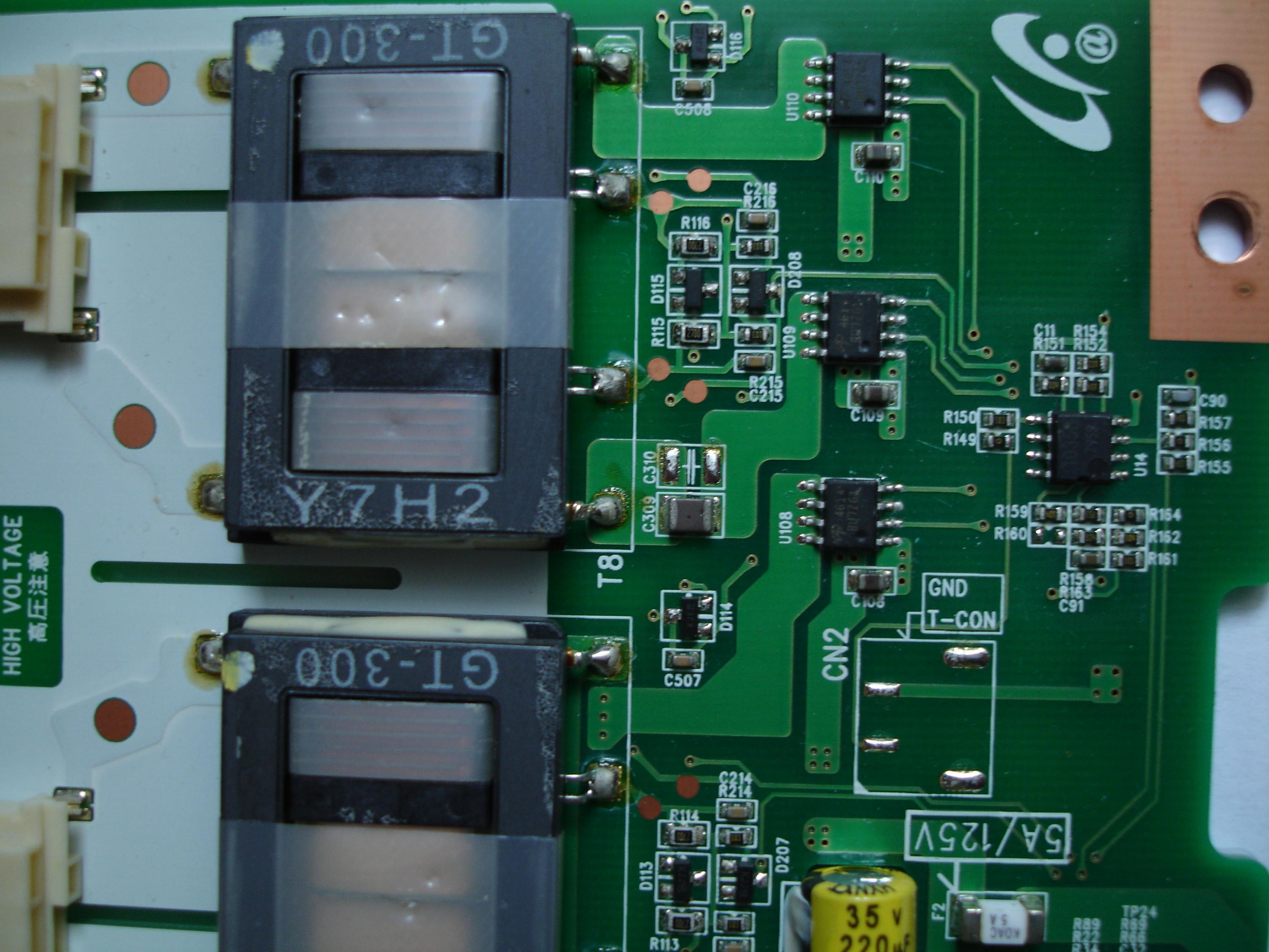

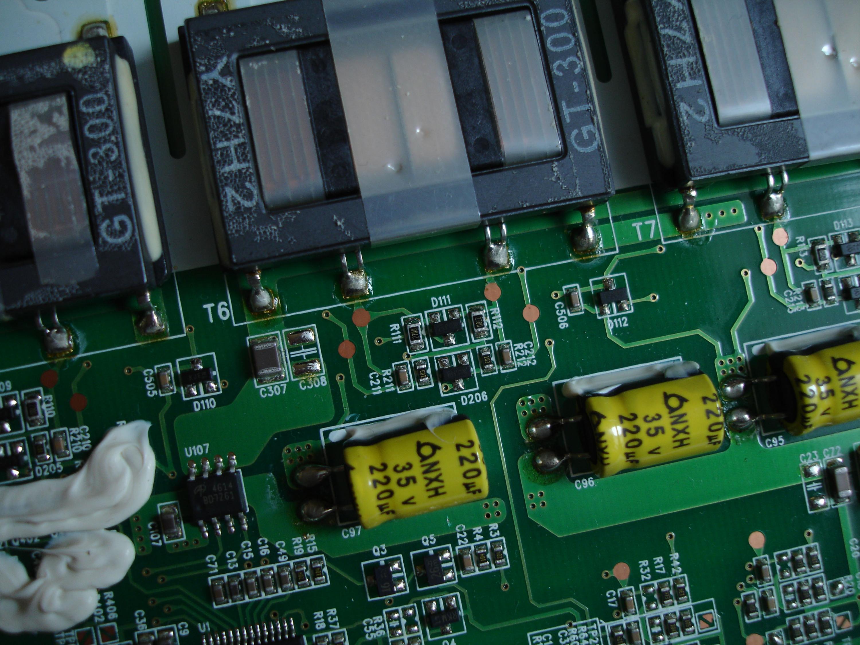

                                    I can see at least 10 MOSFETS that drive the inverter transformers, they should be check for Source to Drain short.
                                    We need good close up pictures of the inverter board.

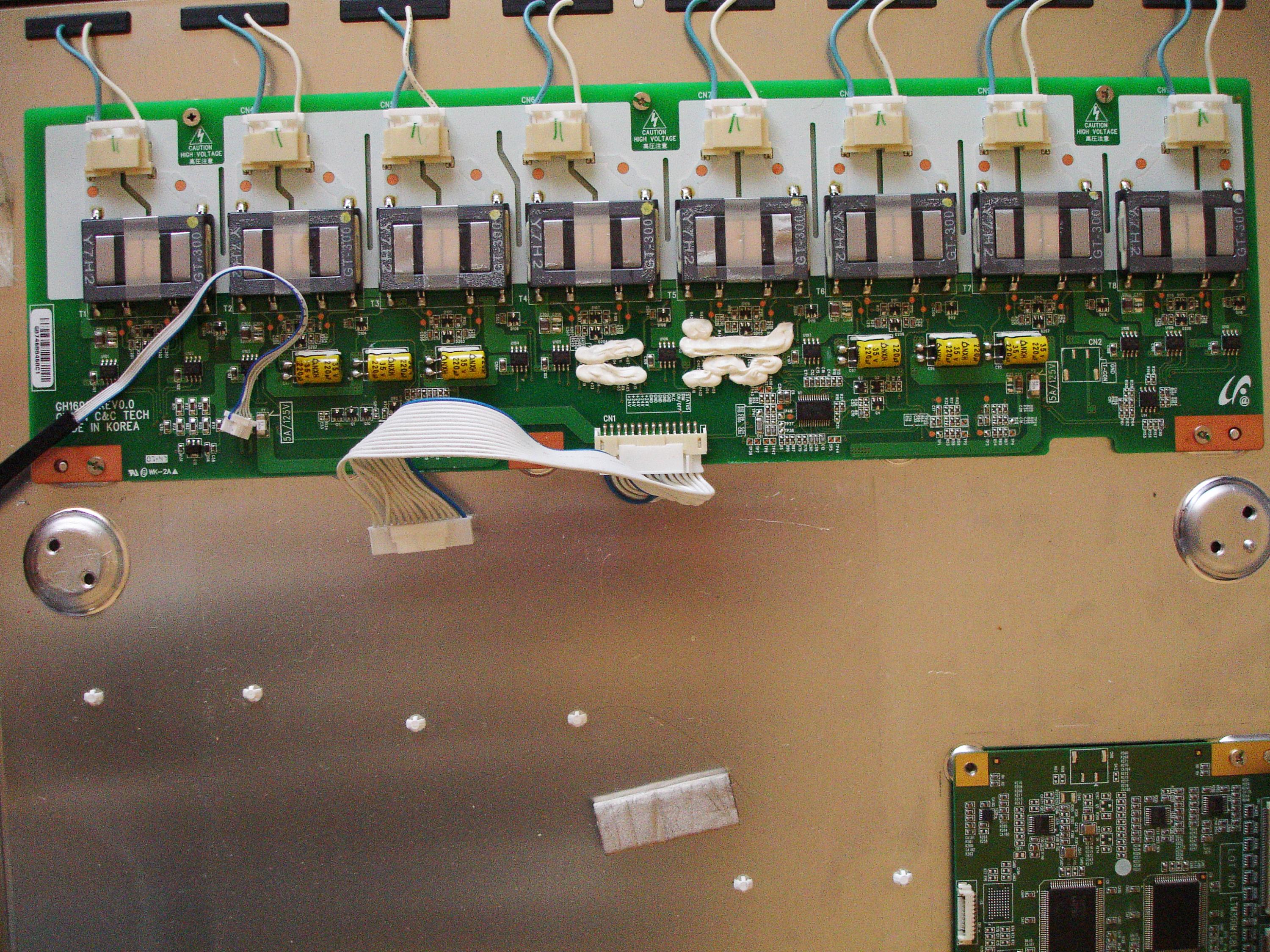

                                      So the white fuse on the left side of the inverter board is out. And the white fuse on the right side is out too? In my experience bad caps or a bad mosfet will only take out one fuse. The side that has the bad cap or mosfet. I wonder what would take out the fuses on both sides?
                                      Andrew, can you test them both again and make sure they are both out. Thx.
                                      And test those mosfets and get some good pictures like budm asked. As soon as we can determine what caused the fuse(s) to blow. We should be able to get you fixed up. I love fixing electronics and bringing these dead monitors back to life. Hope you do too
                                        Lumberjack777. Both are out. I tested them a few times. I even tried to scratch the surface in case someone applied some transparent resin there. This monitor was good a few weeks ago not sure what happened. If we don't have any luck I will call a repair centre but for now I want to learn some basics about electronics and this is the best forum I found around the internet
                                        One more thing: I don't know how to test those mosfets. If I recall was something like: pin 1-2 ,2-8, 4-5 can you explain the whole task and multimeter settings?
                                        Pictures attached.
                                        Correct order from left to right (first four pictures, in order)
                                        jpg names: <--- leftside, second, third, rightside --->
                                        You can see better the numbers on the mosfets in the other pictures. closerview1, closerview2...and so on.
