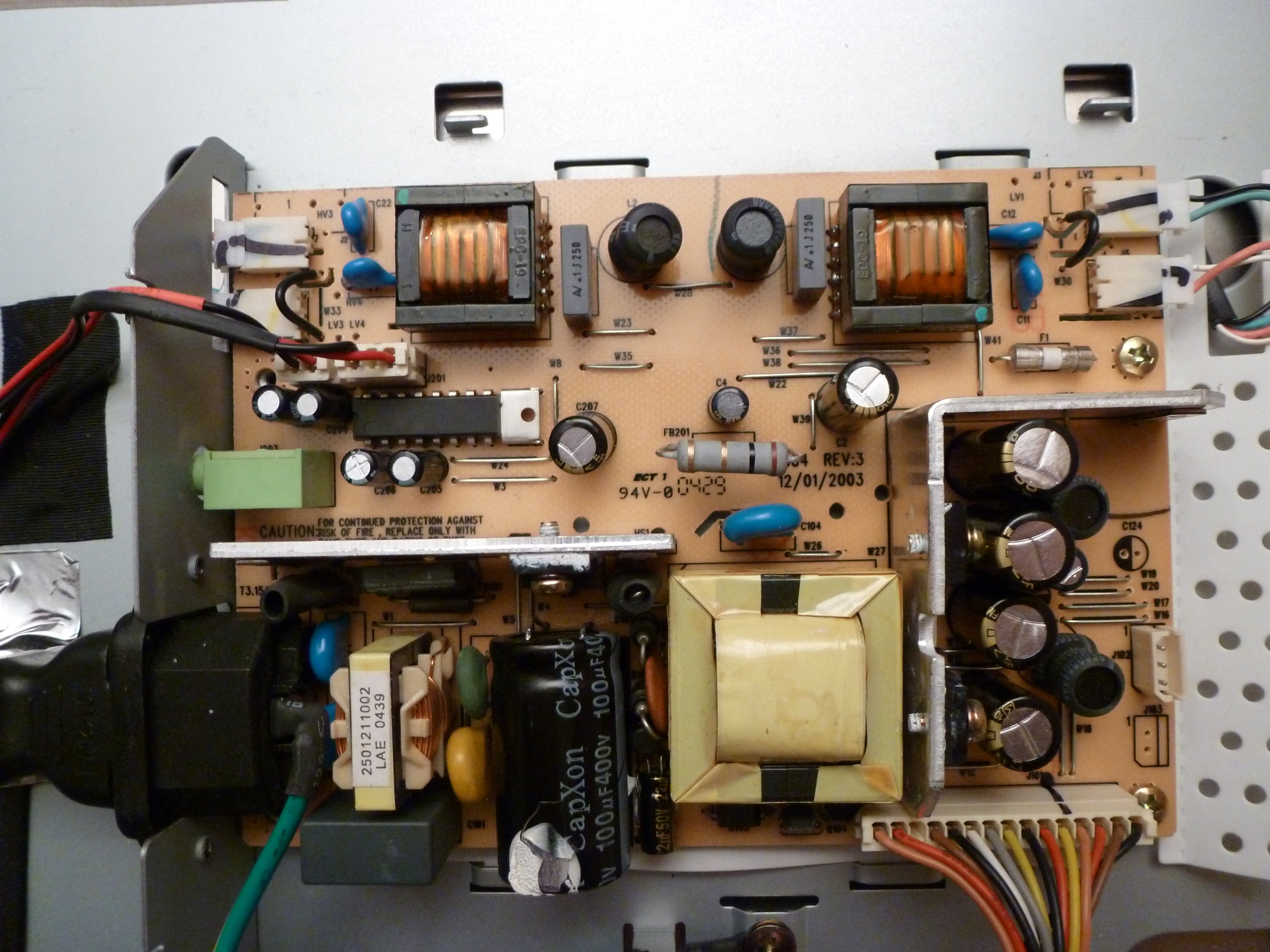

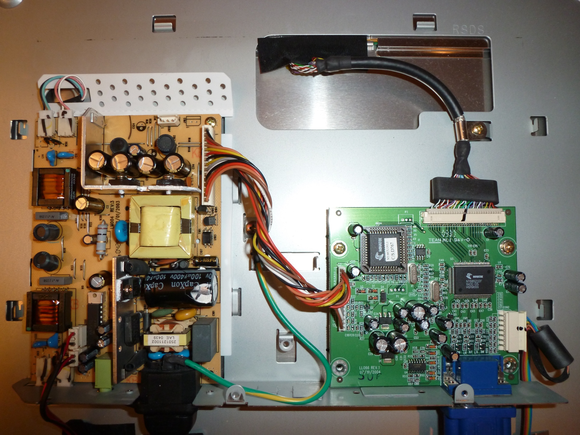

    DCLLCD DCL7A - quick flash of the back lights only
    I have a DCLLCD DCL7A that when turned on shows a very (and I mean VERY) quick flash of the back lights and then goes to a black screen. I have read several threads on badcaps.net concerning the LM004 Rev:3 inverter board. I have replaced all of the electrolytic caps with Panasonic FM / FR and have even swapped out the big capacitor with one of equal value. I have resoldered the pins on the two transformers and also the grey block capacitors near the transformers (one of the legs of one of the capacitors had a cracked joint).
    I have measured the transistors as follows:
    Q6:
    0.599 kohms
    1.930 kohms
    1.212 kohms
    Q7:
    0.600 kohms
    1.929 kohms
    1.212 kohms
    Q11:
    174.6 ohms
    128.5 ohms
    90.6 ohms
    Q12:
    174.8 ohms
    128.8 ohms
    90.4 ohms
    The voltages on the connector to the input board from top to bottom (in the overall picture of the boards):
    0 VDC
    4.84 VDC
    4.84 VDC
    0 VDC
    4.87 VDC
    4.87 VDC
    4.87 VDC
    0 VDC
    0 VDC
    4.03 VDC
    0 VDC
    0 VDC
    no wire
    0.657 VDC
    4.72 VDC
    The voltage across the main capacitor is 160.1 VDC
    The voltage across the start-up capacitor is 13.73 VDC
    Forgive me for the pictures since it's been raining here for the last two days and I couldn't take them outside in natural light. The back side of the input card is a little blurry and I can take it again if someone needs any information from it.

      Re: DCLLCD DCL7A - quick flash of the back lights only
      Try disconnecting the cable from the main board to the panel. Do the backlights then stay on?
      Have you check the secondary windings on the inverter transformers

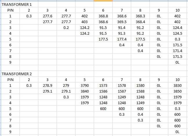

      • jayoung
        • May 2011
        • 172
        Disconnecting the cable from the main board to the panel makes no difference.
        Attached are the measurements for the transformers in ohms:
          Q11:
          174.6 ohms
          128.5 ohms
          90.6 ohms
          Q12:
          174.8 ohms
          128.8 ohms
          90.4 ohms
          I regard the above readings are in the "gray" area. They are not 100% shorted, but they are a bit suspicious compared to Q7 and Q6.
          Did you check fuse F1 to see if it is open?

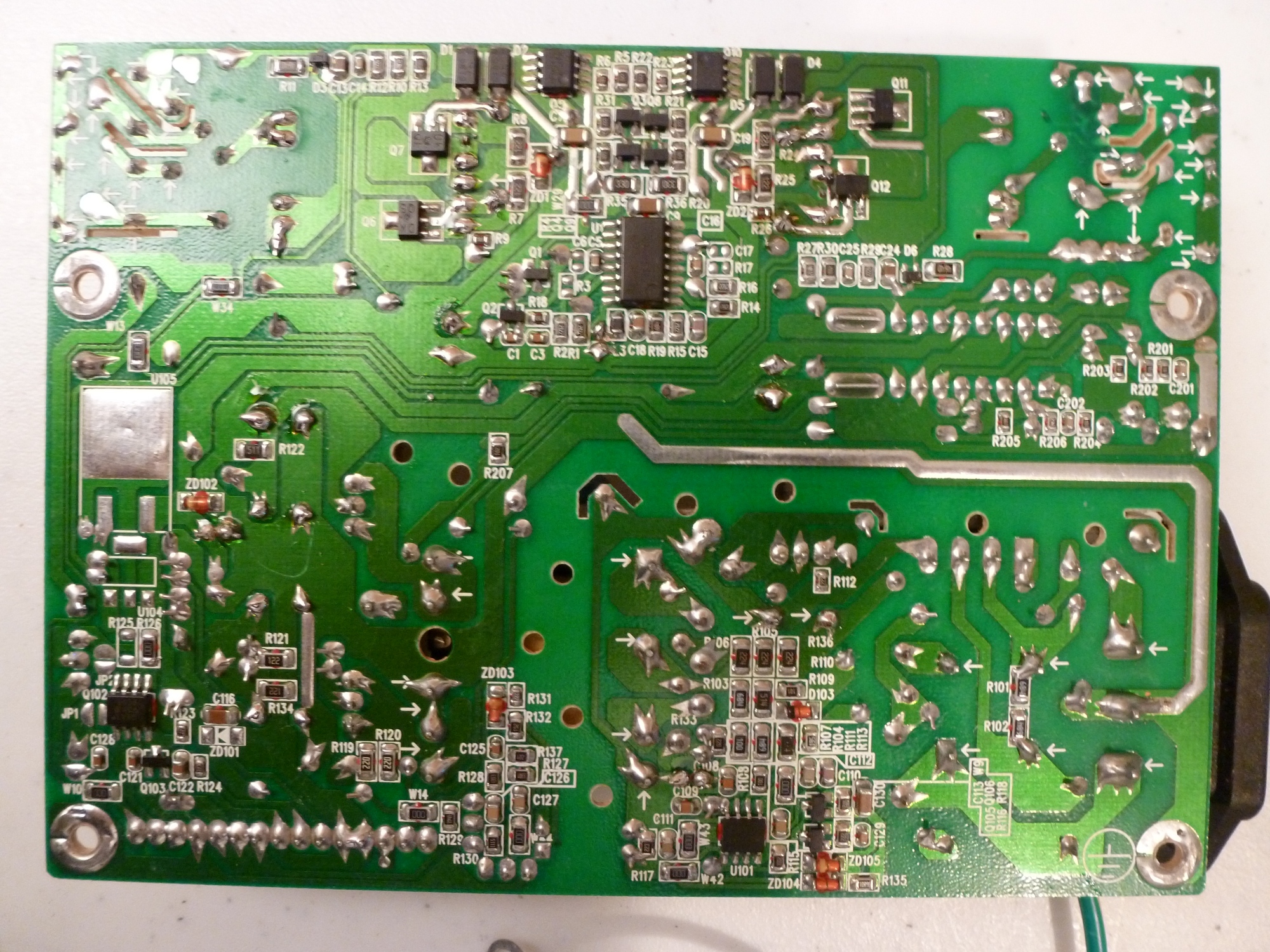

            See if Q9 and Q10 are shorted.
            --- begin sig file ---
            --- end sig file ---
            • jayoung
              • May 2011
              • 172
              Maybe it's too late or my eyes aren't working, but I can't find F1...
              I don't see a label for Q9 or Q10, but if they are the ones below Q8, they don't appear to be shorted.
              Q9:
              2.733 kohms, 10.39 kohms, 12.11 kohms
              Q10:
              2.592 kohms, 10.46 kohms, 12.20 kohms

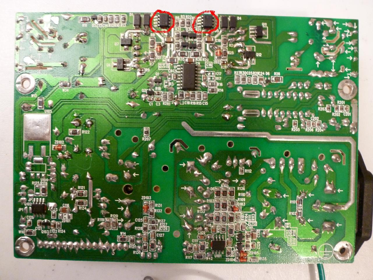

              • retiredcaps
                • Apr 2010
                • 9271
                See circled.
                  See circled.
                  Fuse measures 0.3 ohms
                  Do I just check each pin to all other pins on Q9 & Q10?
                      See my 2 seconds to black guide starting with post #19, there is a procedure on how to test the mosfets.
                      I've used that document more times than I can count and I thank you for your work on that.
                      The datasheet can be seen here:
                      pins 1, 2, 3 are designated as S
                      pin 4 is designated as G
                      pins 5, 6, 7, 8 are designated as D
                      I've never checked one with more than 3 pins and this one is not designated with S1, G1, D1, S2, G2, D2, etc.
                        Then check pins 1-4, 4-5 and 1-5.

                        • retiredcaps
                          • Apr 2010
                          • 9271
                          Your readings for the 2 transformers are radically different. Can you doublecheck your measurements and posting?
                          Also, what is the part number of the transformer?
                            Because the resistances of Q6 &Q7 are very different to Q11 & Q12,AND there is a significant difference in the transformer readings,as they are interlinked with the Q mosfets,then you really need to take the transformers out and measure them, and then decide if it is one of them or the pair of mosfets that are faulty.
                            • jayoung
                              • May 2011
                              • 172
                              Q9:
                              1 -4: 9.88 kohms
                              4-5: 14.55 kohms
                              1-5: 1.91 kohms
                              Q10:
                              1 -4: 9.99 kohms
                              4-5: 10.56 kohms
                              1-5: 0.60 kohms
                              I double checked the readings, they appear to be correct ( I did however have them labeled in reverse - Transformer 1 is actually Transformer 2 and Transformer 2 is actually Transformer 1)
                              The part number on the transformer is EPC-19
                                        Hmmm .....
                                        Pardon me for butting in ...
                                        Rtech is spot on for noting the differences in readings between Q6/Q7 with Q11/Q12.
                                        This is a royer circuit. Those Q6+Q7 or Q11+Q12 is a Rohm part 2sc4672 (available from Digikey). The way the circuit is interlinked, if Q11 is shorted, Q12 readings will also be affected (and vice-versa). The only way to confirm is to test off-circuit.
                                        Also while you're at it, check the tuning polycap tolerance. If its out-of-specs, that new transistor replacement will bork again.
